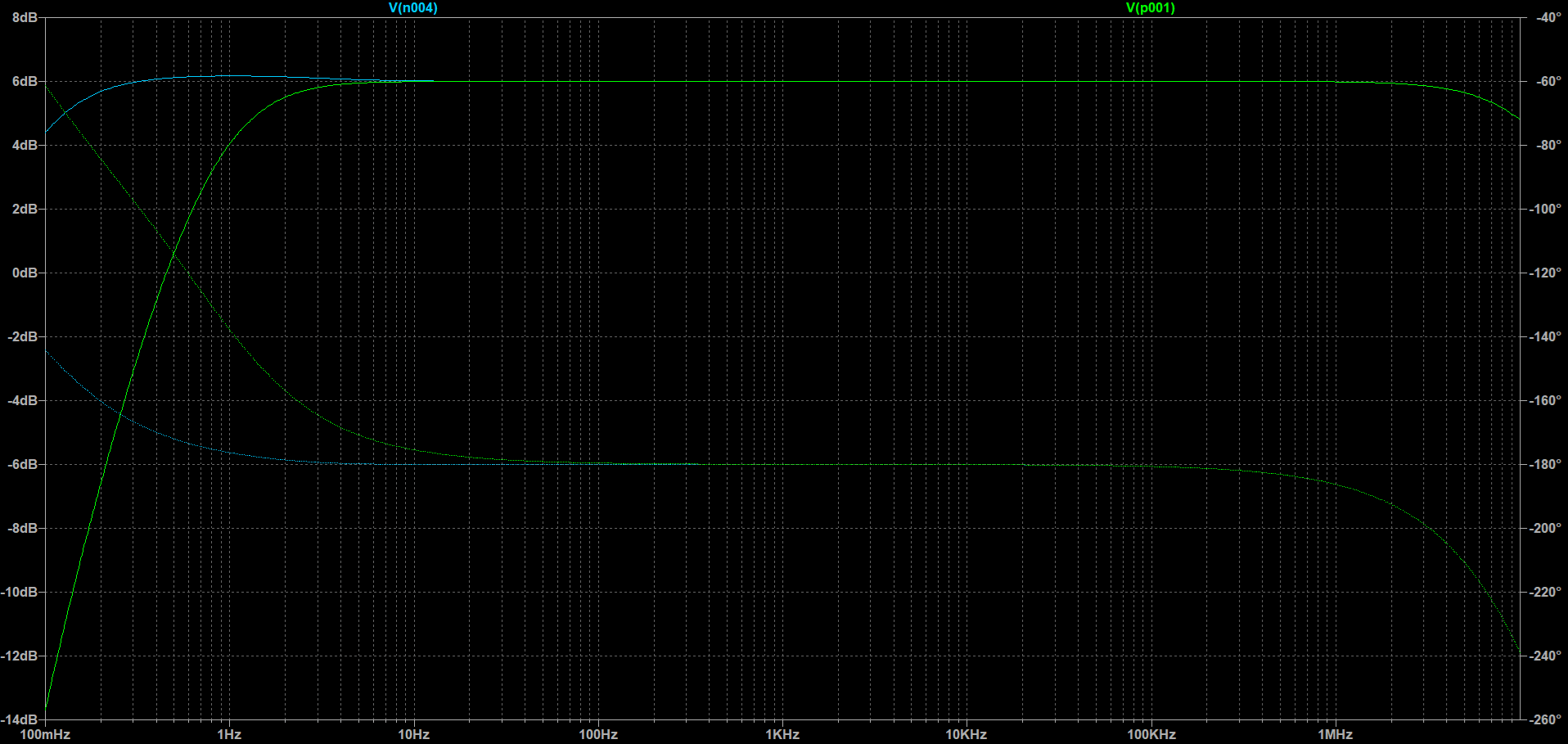

Yes and no.FWIW I think I am right about the caps though.
Yes, they do cause a phase shift.
No - the inclusion of the coupling capacitor between the difference stage and the input to the MUSES chip creates a high pass filter and phase shift is at very low audio frequency (<10Hz)
V(n004) is pre-capacitor. V(p001) is at input to MUSES72323.
Having added the coupling capacitors into the circuit (as per the MUSES data sheet), the dc servo part is pretty well redundant although it does ensure even clipping if you overdrive the whole circuit (not that we would of course!).Another thought that came up is what the exact use of the DC subtraction circuit is when there is a coupling cap further in the line. Add one in the second leg and the whole situation around the TL072 can be omitted. Given that many sources have output caps or DC servos and this design having coupling cap(s) anyway omitting the subtraction circuit would make the design and PCB simpler and more compact. Just 2 extra caps result in 22 Parts less even.
I haven't tried it but, as I said in one of the earlier posts, with the dc servo doing its job we probably don't actually need the coupling capacitors.
With the coupling capacitors in place, we could easily remove the dc servo, save 22 parts and free up a pile of space. As they say, you pays your money and takes your choice. 🙂

From our recent posts, we've deduced that, with the coupling capacitors between the difference stage and the MUSES input, we no longer need the DC servo / subtraction circuit. Also, following a request for larger resistor and capacitor SMD sizes, I've re-laid out the board to use 1206 SMDs in place of the previous 0805s This also means that MMELFs can also be used if you so wish.
As you can see, having removed the 22 components of the servo / subtraction circuit, there's now a large area where onboard ultra low noise LDO regulators could be fitted. Any preferences?
