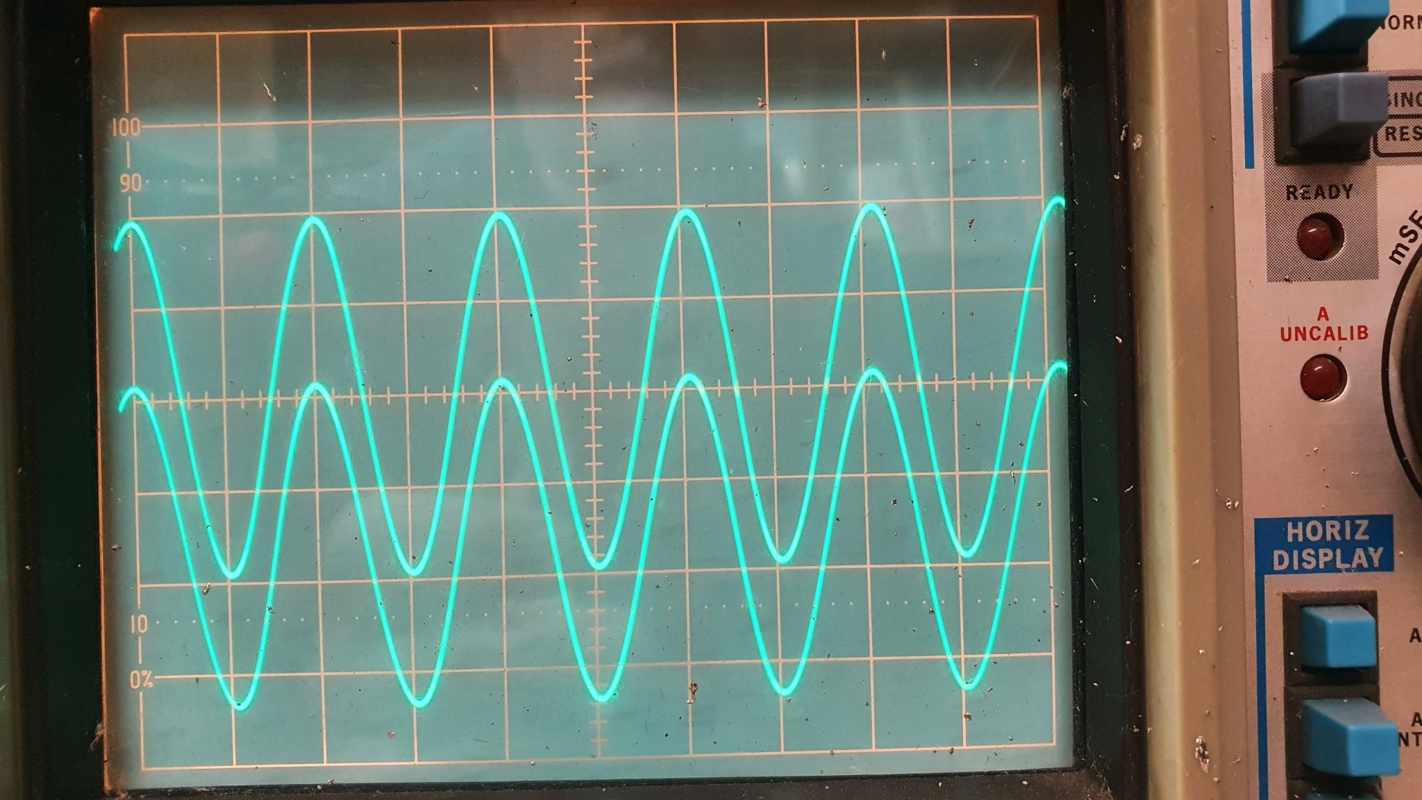

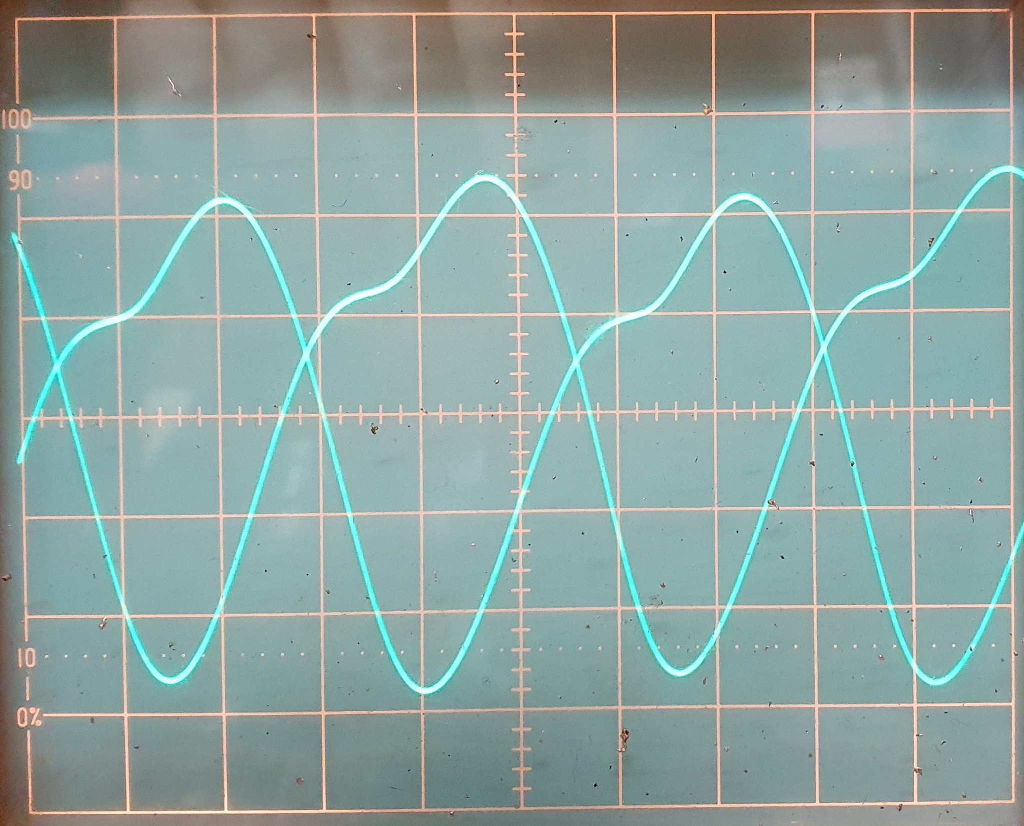

I connected g2 to anode (triode mode) and the spurious oscillation stopped. Cathode feedback is still in place. However, I see badly distorted waveform on 8 ohm load at 1 kHz and above. 100 Hz is about acceptable. See the signals on the anodes. Horizontal: 0.2 ms/div, Verical: 50 V/div. Input signal: 1 kHz / 2.2 Vrms. The driving signal on the 807s' g1 is perfectly clean. Could it be due to the leakage or stray capacitance in the output transformer?

Could you trace the grid signal and the cathode signal on the two traces with 0V in the same place please.

I double checked the cathode feedback signal polarity, it is opposite to g1 like it should be. The output signal is distorted only when 8 ohms load is applied. It is clean without any load. And it is distorted asymmetrically, I wonder why.In #24 Bigun advised to swap the cathode leads. Your symptom may be attributed to PFB into the cathodes instead of NFB.

Cathode feedback should be the same polarity as the grid, to be negative.

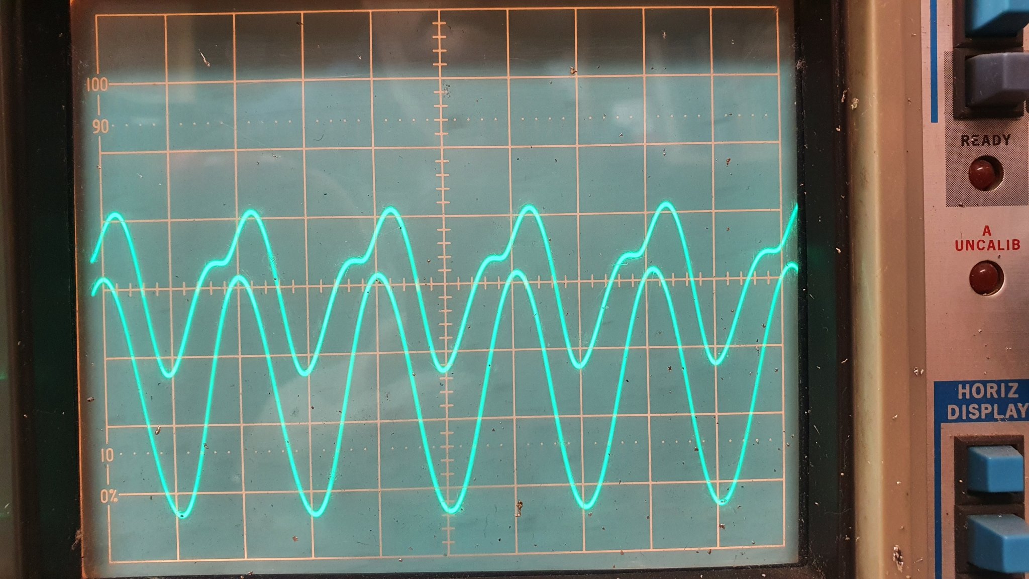

Here are the signals without and with dummy load. Upper trace: signal at the cathode of one tube, 5V/div. Lower trace: signal at the g1 of same tube, 20V/div. Input DC coupled. The CFB is indeed the same polarity as the grid signal. I can get similar waveform in LTSpice when I increase leakage and/or self capacitance of the trafo.Could you trace the grid signal and the cathode signal on the two traces with 0V in the same place please.
Thats good to know. I guessing the kick is when the opposite tube goes out of conduction and the current in that half of the primary gets to zero. If you can replicate in LTspice you some way to understanding the issue. If you were to use a separate FB winding does it occur.

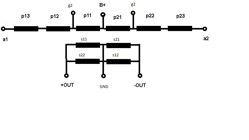

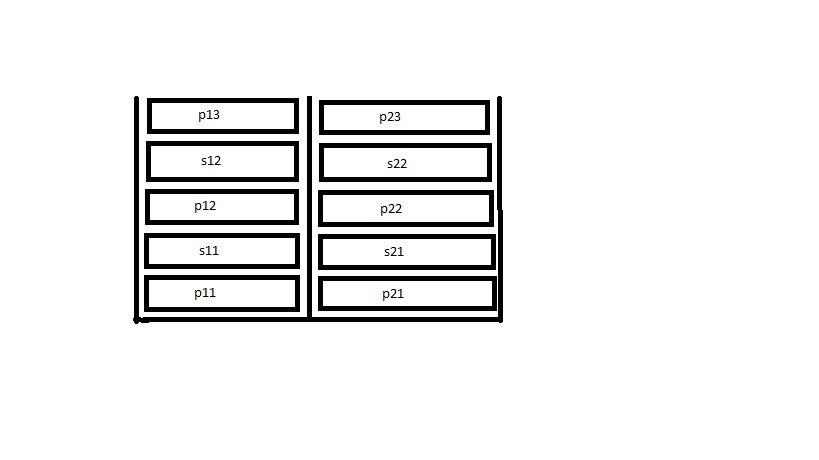

I experimented with the primary and secondary connections. The definitive best connection is: p11-p12-p13 in series (also the other chamber p21-p22-p23), B+ is connected to the inner coil. s11 and s22 connected parallel (also s21 and s12). See attached drawing.My transformer also has two chambers. In each chamber the winding sections are P1-S1-P2-S2-P3. All windings in a section belong to the same tube. P1-P2-P3 are connected in series, S1-S2 are connected parallel. Would it be better to interleve P1-S1'-P2-S2'-P3 where S1' and S2' are from the other chamber? Or some other mix?
The previous problems were caused by incorrect connection of the secondaries (s11 || s12 and s21 || s22). That connection caused loose coupling between the primary and secondary, resuting in high leakage inductance, oscillation, asymmetrical distorted waveform.
Now I restored the CFB and UL, everything is stable and the waveform is nice 🙂
Exactly. The upper cutoff frequency at full output (about 15W @ k=1%) is 75kHz. Now I will listen to it as it is now, and then apply GNFB as you advised earlier.Excellent so you've mixed the secondary so each side comes from both primaries whereas before each side only came from one primary.
