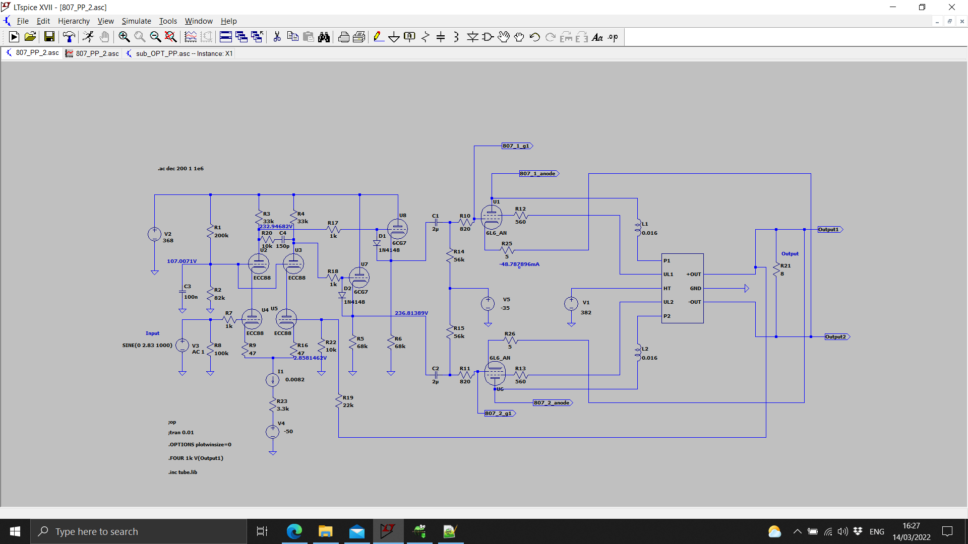

Class A triode PP is exactly what I am suggesting here. It offers all the benefits of SE but eliminates many of the issues. It's the base assumption that PP amps can only be built with pentodes which is the problem here. Vacuum States PP amps are an exercise in what can be achieved if you reject that assumption. The sort of logic that is applied to SE designs is equally applicable to PP designs it's just that in the early days of valves power output was always the driving factor.P-P pentodes need feedback to work well. Ultralinear or triode strapping is a form of feedback. Local instead of global, but feedback nonetheless. There are complete feedback-o-phobes, and global feedback-o-phobes. The first kind balk at triode strapped EL34’s, which can sound quite good even in P-P with no GNFB. Make no mistake about it - there IS feedback.

The amount of global negative feedback is 12dB. Did I calculate correctly? The open loop gain is 12dB higher than the closed loop gain.
What I measured is that the THD is about 0.2% up to the point where visible clipping occurs. But the main argument for GNFB is the increased DF (=lower output impedance) that helps damping the bass resonance of my speakers.

The 6L6-oids definitely do make ESSSSSS-loads of h5+ While developing the Vixen design, I ran it open loop. The Twin-T test showed a residual that looked like a sawtooth at three times the fundamental frequency (1100Hz). Listening tests showed no obvious distortion, but there was something as irritating as finger nails on a black board. It was worse with some program materials, but always there. 807s def need help in the form of lNFB and gNFB. The designer of the type (Schade) recommended feeding back 10% of the plate signal to the grids (~7dbv local NFB) gNFB finishes the clean-up.The main reason why i would use gNF in this case is because the 807 has a poor distortion profile with lots of higher order harmonics. Without feedback I would expect them to sound quite nasty.

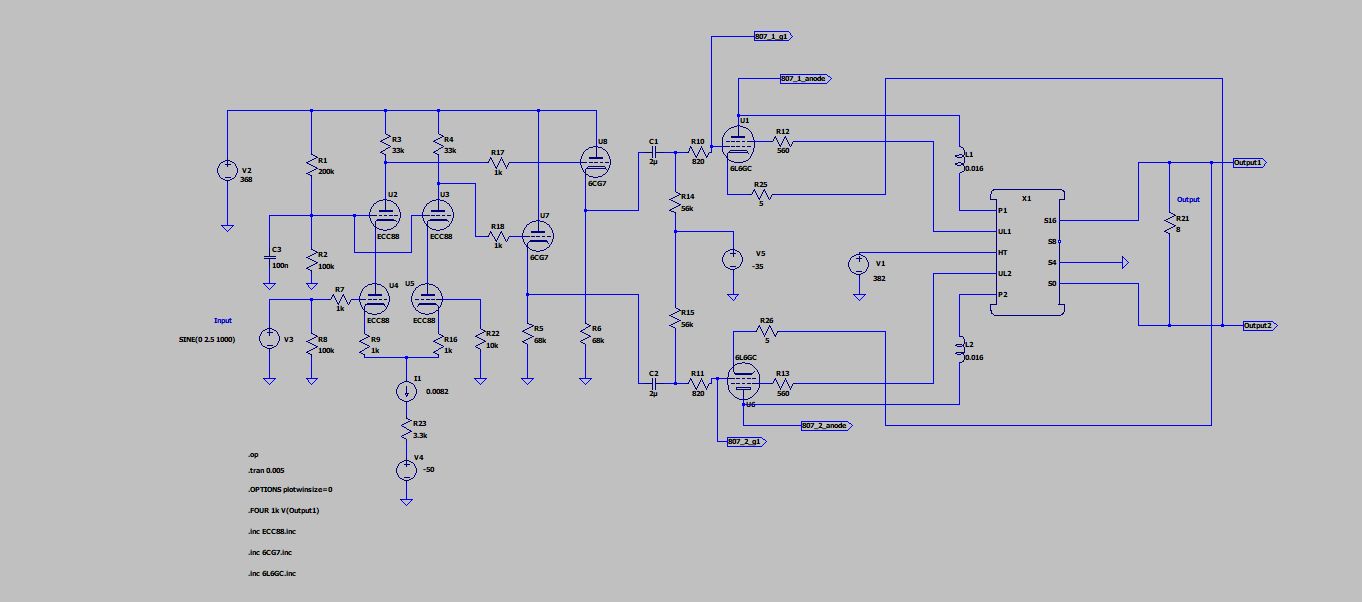

How about this (attached)? I wondered for quite awhile why the designer selected 6BQ6s for the finals in this no gNFB plate modulator. You'd expect to see 6L6s for this power class. The 6BQ6-oids have no audio pedigree; there is no mention of any use as an audio final in the spec sheet. After doing some audio loadlines, it still wasn't obvious. The estimated THD came in at about the same level as the 6V6-oids. Anyway, I decided to do the Le Renard design based off this modulator project.Zero feedback Push Pull amps can be the best of both world - but there are almost no examples of them around so most people assume that all PP amps have to have loads of feedback to work - which is a very wrong assumption.

Then it bacame obvious: open loop, the Twin-T test showed a residual 3X the fundamental, its ampulitde was higher than what I saw with 807s, but it was a slightly distorted sine wave, suggesting mostly h3 with a trace of h5. Listening open loop produced no pentode nastiness, just an overly "aggressive" sound that gNFB tamed easily. The no NFB plate modulator woukld sound good enough for ham work, and without all that harmonic distortion going over the air. You can consider the 6BQ6 (and likely other TV HD finals) as 6V6s with 2X+ the output.

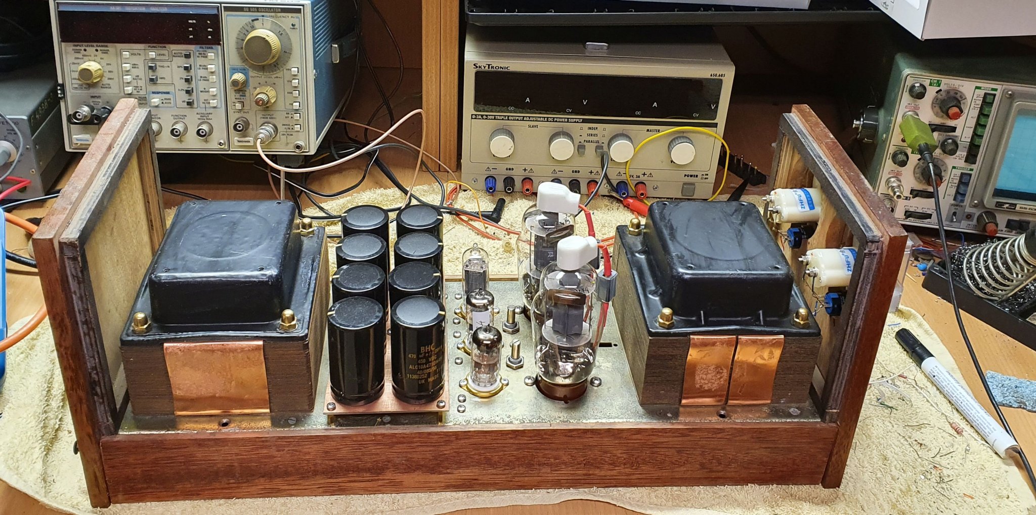

My first serious amp design was a 807 PP Tabor clone using 6AU6 drivers and high levels of Schade feedback. I used a VR tube to supply the screens. It sounded OK and I still have it boxed up in storage in my workshed. Might pull it out and have a listen some time. I moved onto similar designs to the 6BQ6 amp you shared but using 6080 as the finals. That really was a fine sounding amp and I seriously am thinking about rebuilding it.
