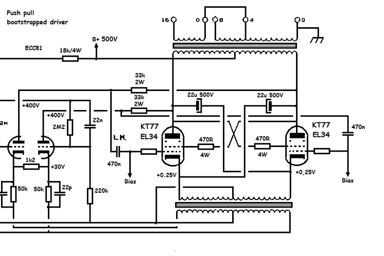

The EAR509 is using cathode feedback, and has some caps from one output tube anodes to other output tube cathode ...
I have a Michaelson&Austin TVA-10, also designed by TP with a similar output topography. It rocks!
The two windings do not need to be bifilar wound, because the leakage inductance
between the two windings can be eliminated by use of shunt C across ends of anode and cathode windings with the
same phase and amplitude of Vac. EAR used 22uF elcaps, but I found 2uF plastic caps were entirely adequate.

Question to ask, why would you not use the S8 tap. With S4 grounded, it would then be symmetrical, correct?Let me share my current project, a push-pull amplifier with 807 output tubes. Since this is a rebuilt of my old construction, I wanted to reuse some parts, especially the chassis, power transformer and output transformer, at least the iron. I set some design rules for myself:
B+ should stay below 400VThere will be no global negative feedbackLocal feedback in each stageThe output tubes will be driven from cathode followersPerfectly symmetrical driving of the output tubesPossibility to connect in ultralinear, triode or pentode operationAB1 class of operationAround 10W or more output powerBelow 1% THD at full output if possibleI know the 807 shines at 600...800V anode voltage, but I wanted to build as simple as possible. Also I don't feel comfortable with that voltage level.
The simulation is promising, see attached circuit diagram. I will add some measuring data later.

I don't know. You have thought about this. I think I would be sweeping the transformer with the correct primary and secondary load measuring gain and phase. First thing it to analyze the problem.

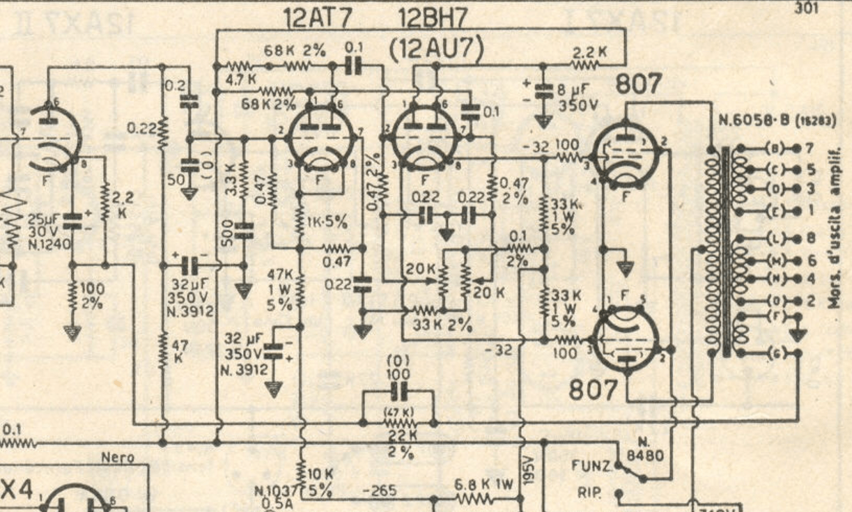

Maybe interesting. Was looking at an ad on an auction site for a PA which had an interesting schematic, using 807s and cathode followers.
Geloso G-273a
Geloso G-273a
