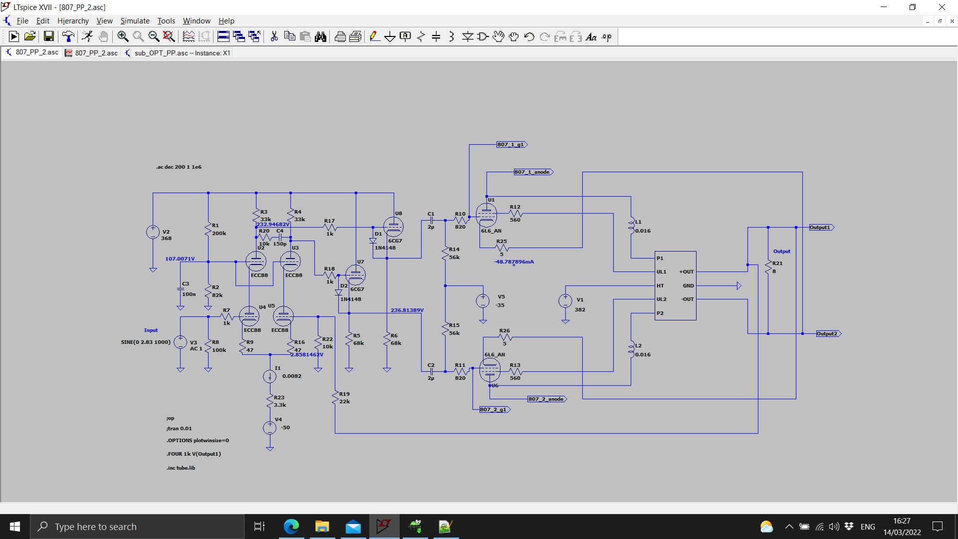

Today I turned on the actual amplifier, and wanted to measure around, but there is oscillation in the output stage. I have 820R at g1 and 680R at g2, and also a ferrite on the anode lead. The oscillation remains if I remove the other tubes. What do you recommend? A ferrite bead at g1 perhaps? Or increase the resistor at g2 to 2.2k or more?

I will try removing the resistor at g1 so that the output tube sees lower drive impedance from the CF.

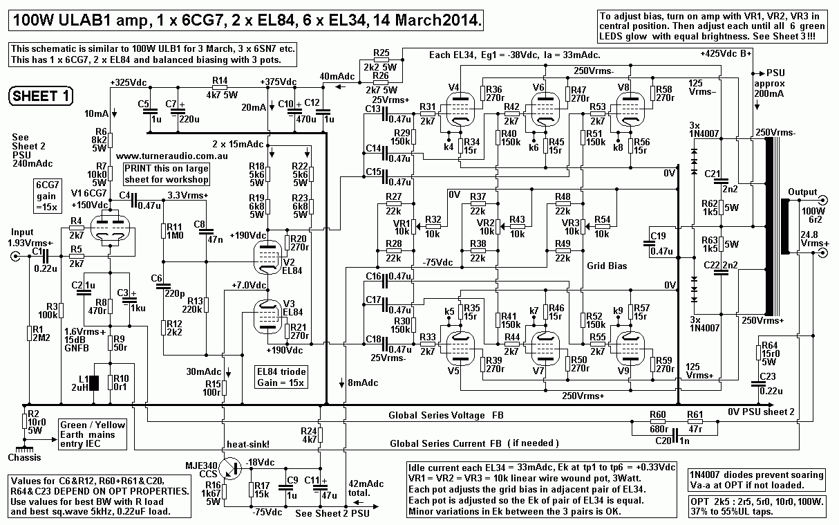

You could try a 100n across the CF, on the base from anode to cathode, might need a different value if roll off of HF is too much. You could also try an 100r on each 807 top cap as well as an RC from anode to ground like shown on this schematic (C17/18 R55/56), see attached. These are all fixes with no idea of actual oscillation frequency , better to do a frequency sweep of your front end and CF drivers 10hz to 100khz or higher looking for peaks at certain frequencies with increased distortion, then fit LPF where needed. When your front end and drivers are stable repeat for whole amplifier.

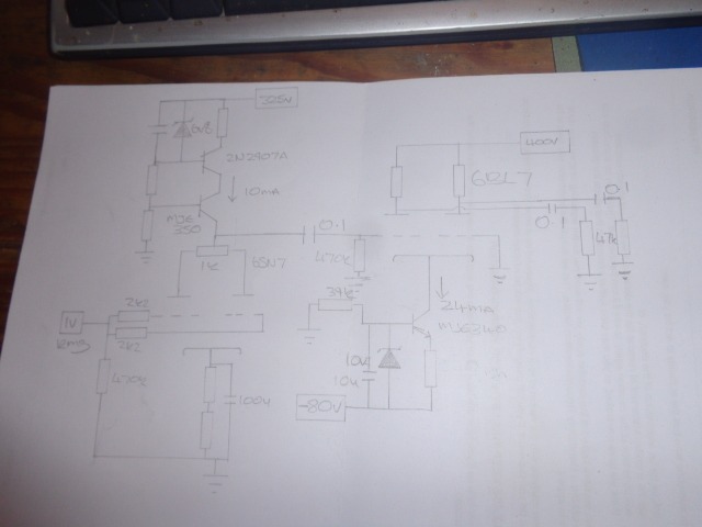

I'm building an 807 amp, considered a cascode or differential cascode with direct coupled CF's, in the end I've kept it relatively simple, DET20 with active anode load and 6BL7 LTP with CCS which can drive four 807's at twice G1-G1, see schematic. You'll see A paralleled 6SN7 as the front end, changed to single DET20, OP gain nearly the same at 18.5.

C21/22 and R62/63 you mean? Anyway this is too complex for me, but there are some ideas to pick from. Please shae your experiences with yor build.
Try the output stage with the 807 cathodes not going through the OPT initially. What frequency is the oscillation?

Yes, sorry. C21 & R62 form a LPF with a cutoff frequency of 48.2khz as do C19 & R57and probably other RC networks. When an amplifier is unstable you have to find out at what frequency it's unstable at, so you do a frequency sweep looking for where the frequency peaks, or goes up in amplitude. For instance a sweep shows a peak at 70khz say, with an amplitude of 7v RMS, you might also see a corresponding increase in THD, say of 32%. To stop this you attach RC LPF's in various places, the usual is place is across your gain stages anode resistor, however Pat Turner in the schematic I attached put LPF's across the OP stage and OPT secondary. Another place is your FB RC network, so, belt and braces.C21/22 and R62/63 you mean?
To make sure an amplifier is unconditionally stable with all loads you do a frequency sweep at low power with a capacitor as load, 22n say this is for HF stability. To test LF stability you test with no load but at very low power. Pat's website is no longer there, but there's a thread on here with a link to the contents of his site. If you drop me a PM with your email address I can send you (hopefully) the article he wrote on testing amps.
Hope that makes sense, so inna nutshell find what frequency your amp is unstable at. Andy.

The oscillation is about 10...15 kHz. There is no oscillation if I connect the 807 cathodes to GND. It seems the cathode feedback is the culprit.Try the output stage with the 807 cathodes not going through the OPT initially. What frequency is the oscillation?
