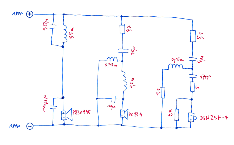

I made a little sketch of your crossover for better understanding with my unexperienced electronic eyes.
hope you don't mind i post it here...

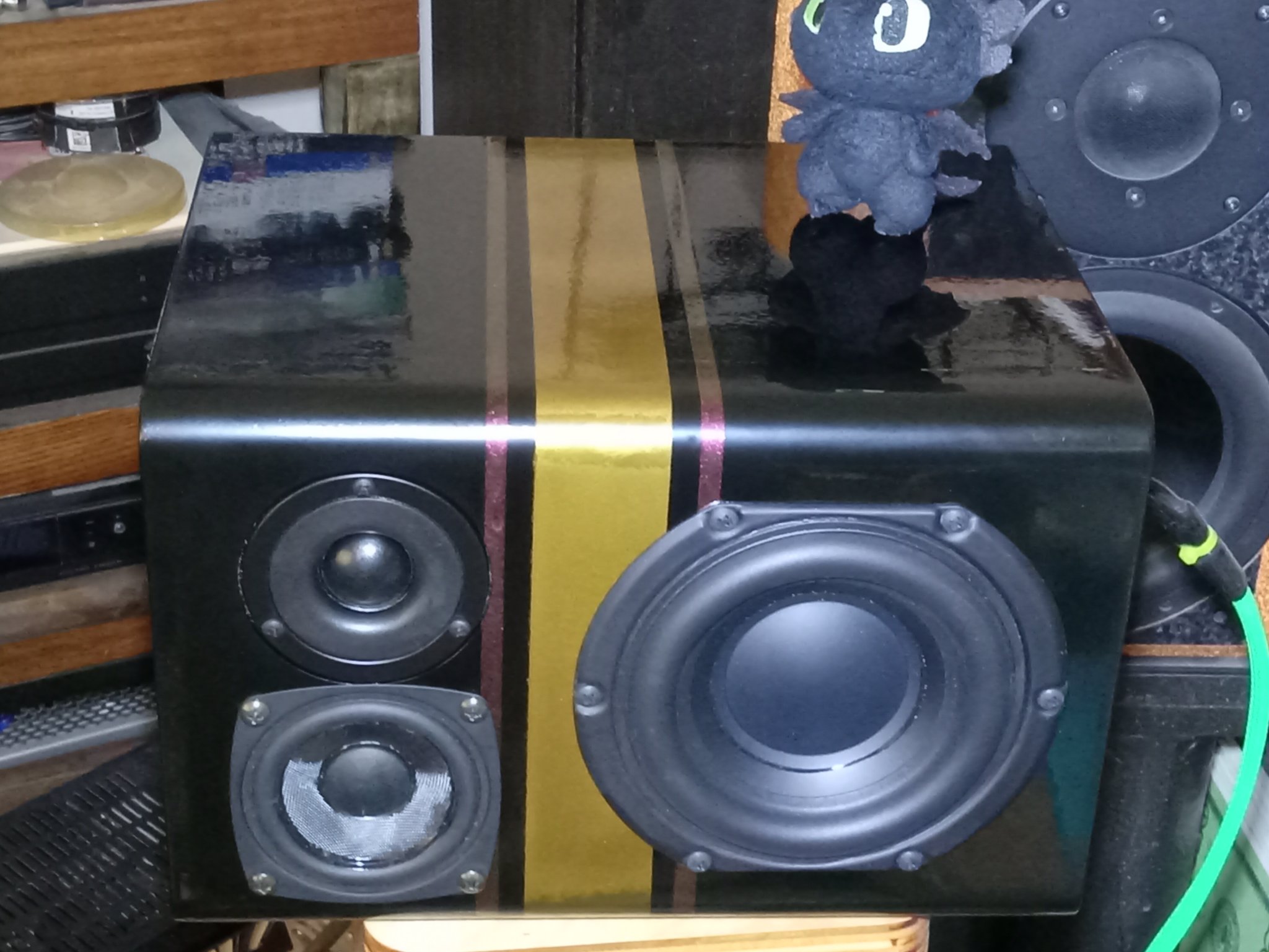

Funny you say that. What I saw that I liked was a Dodge Charger with racing stripes of gold and the car was a really nice raspberry or dark cherry. Looked great to me so I transferred that onto the black. It needed something besides just basic gloss black.
Colors are Krylon 18kt gold and Rust-Oleum chameleon pink/gold.
Base is Rust-Oleum chalkboard followed by VHT Night Eyes. Clearcoat is Duplicolor 1k.
I think I chose wisely! Thanks for the compliment!

I have one worry regarding C1+C3 basically providing a short at high frequencies to the amp. Some amps might not like that, and be prone to oscillate. Maybe it would be possible to add some resistor in series with C1 to be on the safe side?
