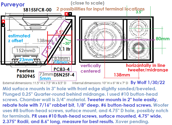

The cabinet cutaway drawing tells the dimensions and mountings, etc, below the images.
Tweeter is flush, all else surfaced.
I had a cardboard cutout in the boxes the PRs came in, as it rested in it in the package. However, I didn't realize this, and measured the dimensions. I listed the radius of the end semicircles and the rectangle in the middle. Treat the length as the maximum, and then cut the arcs with the circle jig. Then draw a line across the circles and cut just shy of it (with a jigsaw for example) and test for best results.

Hi Wolf,
I'm finally getting rolling on your Purveyors! All parts needed are on the bench, cabinet cutting and assembly will be the first tasks to be done.
Couple of questions about cab construction:
Thanks in advance 🙂
- Surface mounting the drivers is not visually appealing to me so I would like to recess all drivers and PR but not the midrange due to its flange shape. If this is done will the XO need any tweaking?
- Should any sound damping materials be applied to the interior walls or polyfill added?
Thanks in advance 🙂

You can recess the drivers if you like, but the Peerless is made to be surface mounted with a thin edge just like the midrange.
In the midrange chamber, I placed two slabs of Bonded Logic vertically and tight into the rear corner, and lightly filled the rest with Premium polyfil or similar to Acoustistuf. Do not pack it in tightly.
In the woofer compartment, I loosely placed about a total 1.5" thick folded, layered, or stacked wool batting vertically between the woofer and PR. Dacron or foam would likely not be as effective. Use something open-cell with wool content if possible.
Good luck on your new shoehorn! It is a tight fit. Let me know if you have more questions.

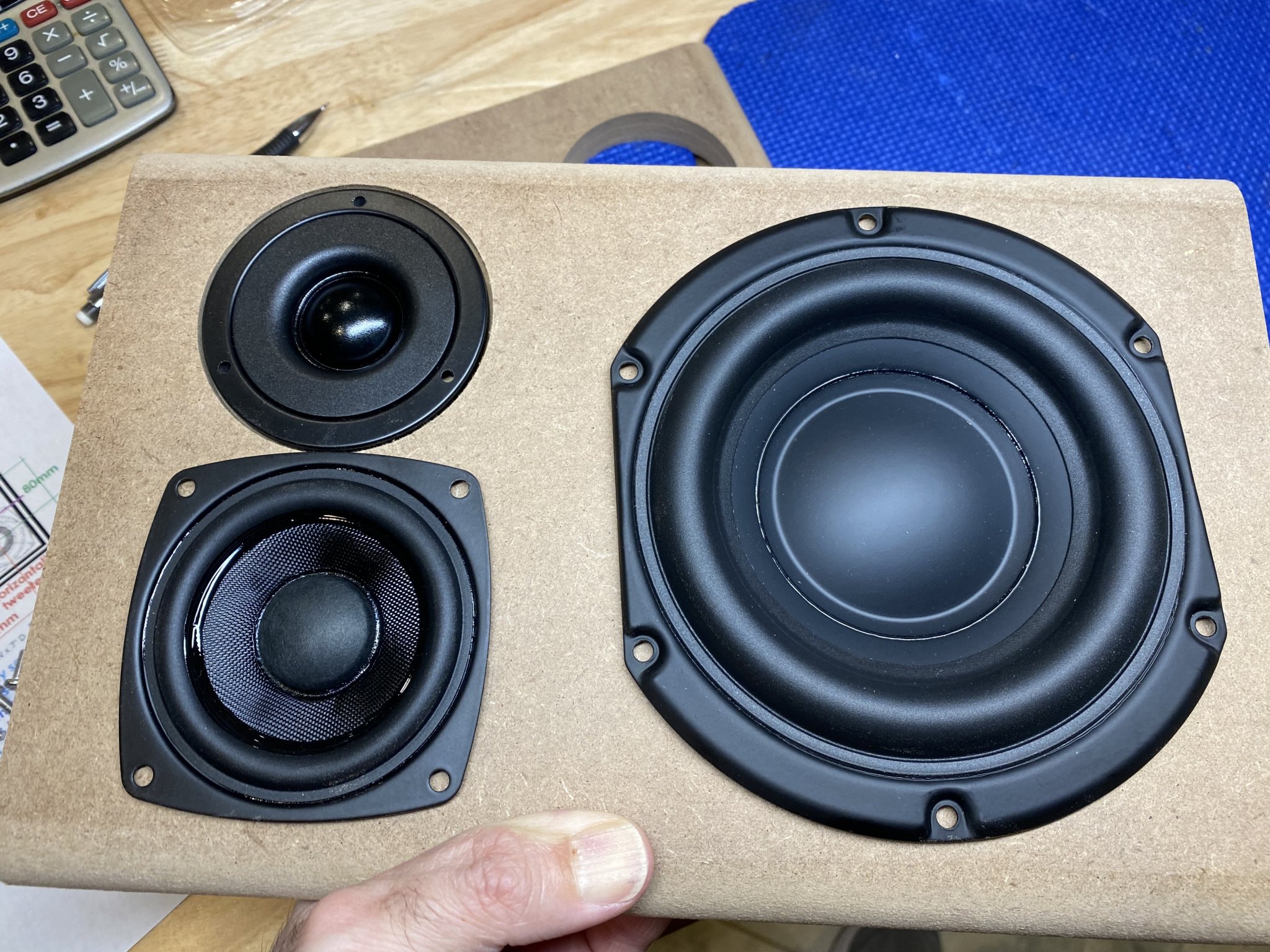

Thanks for the cabinet dampening details Wolf.
Laying out the baffle cuts and internal divider, man you ain't kidding! These are smaller than a shoebox 🤣

Good to see the progress Vunce, and hopefully you will get more done during the weekend and get these playing music soon. 🙂
