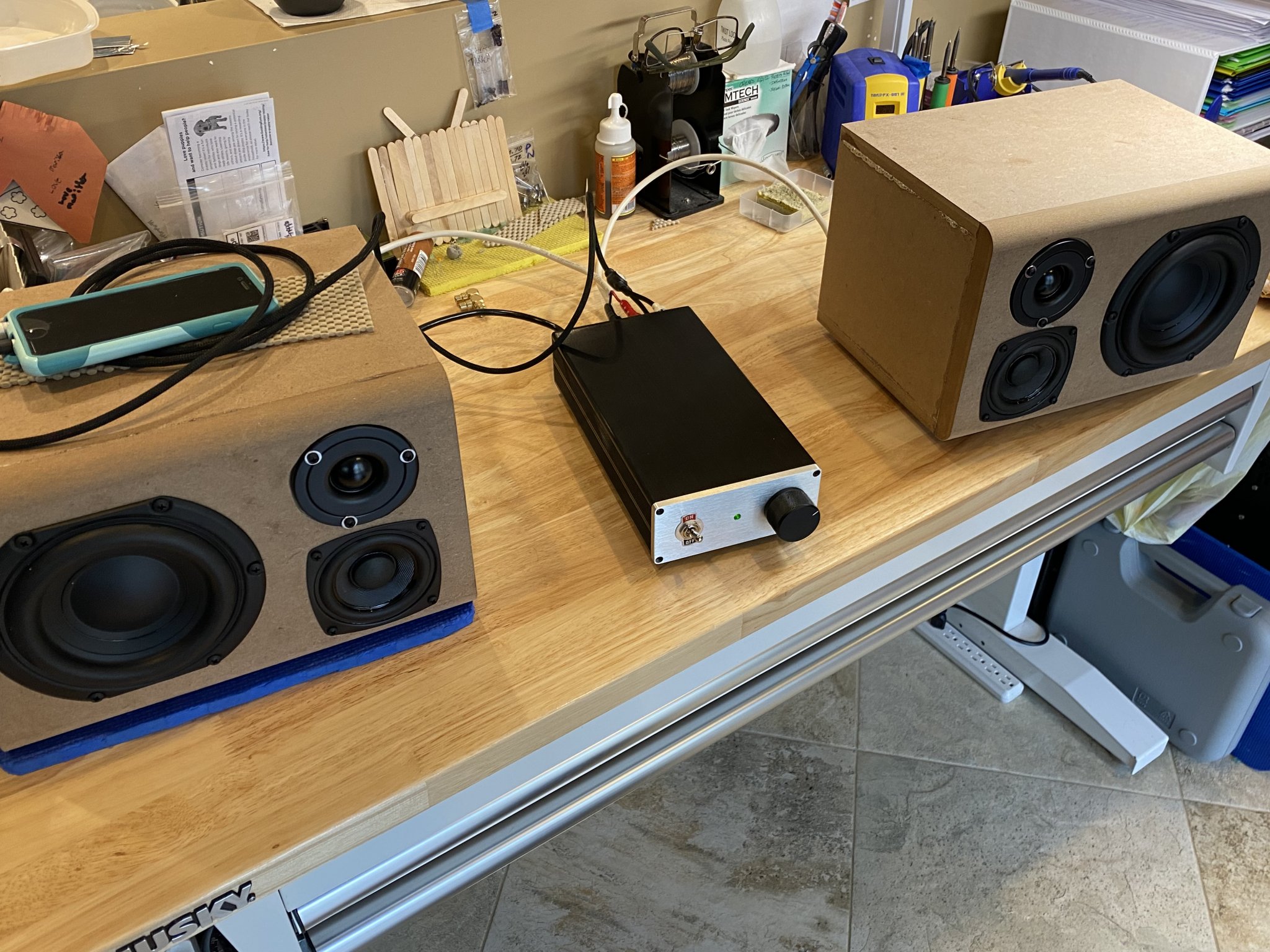

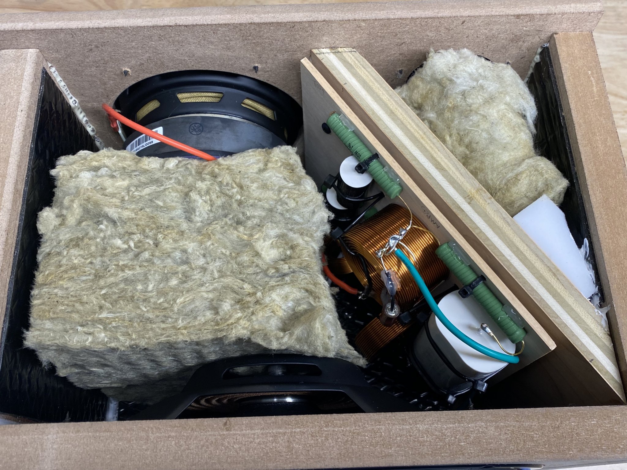

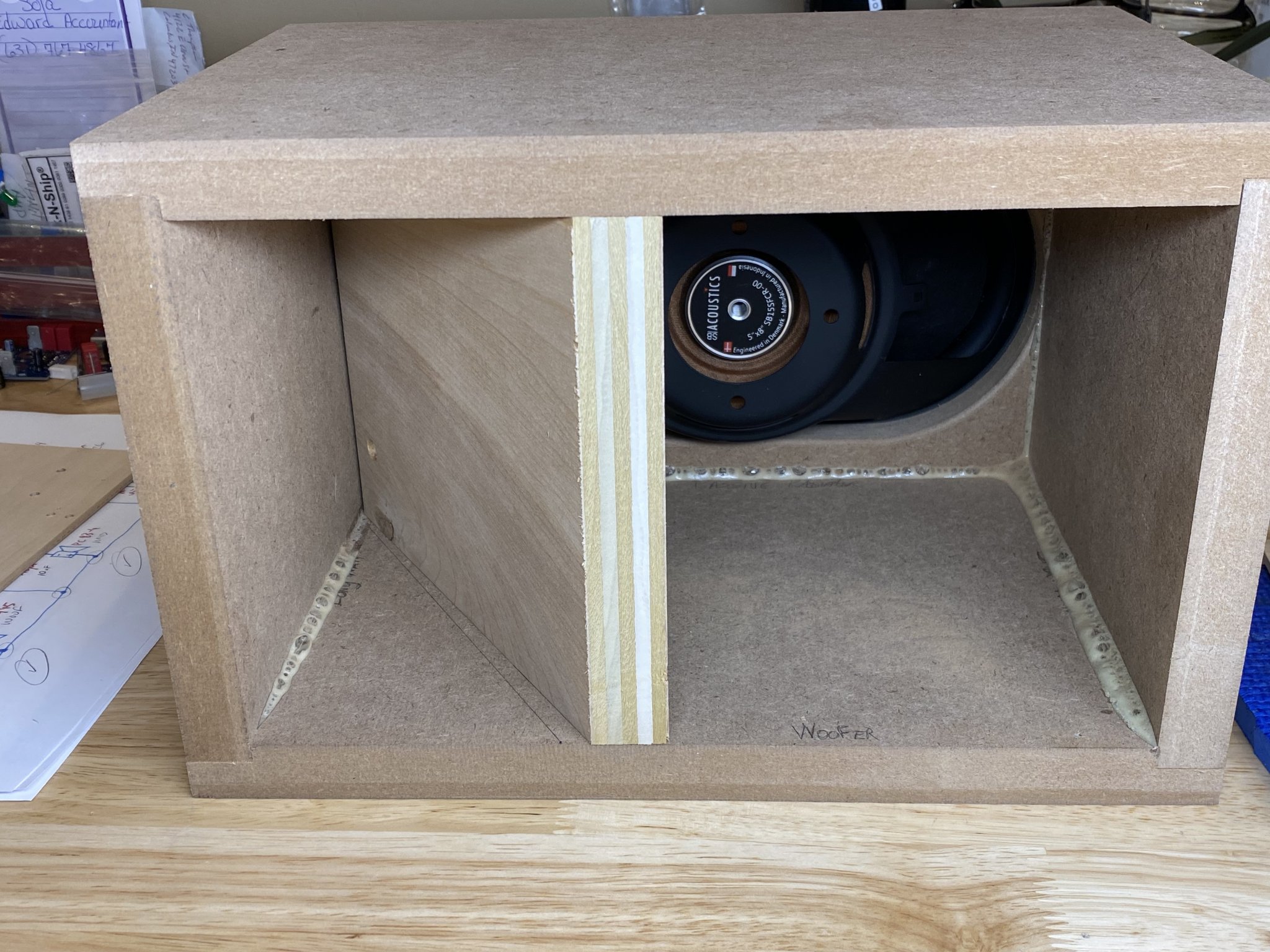

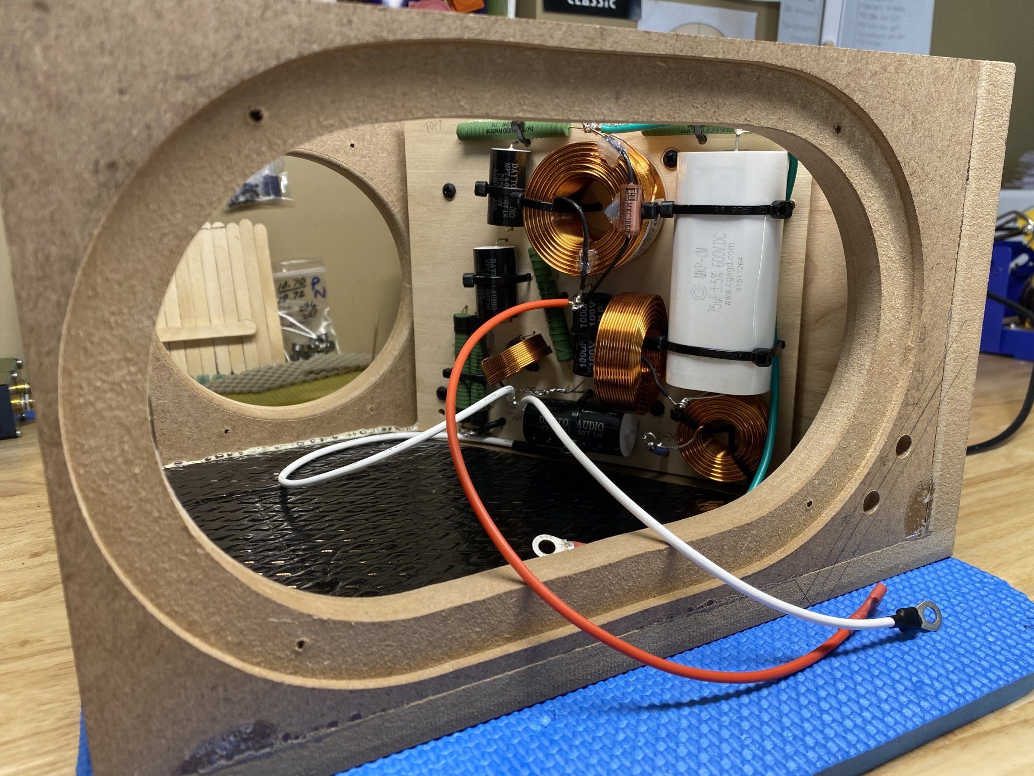

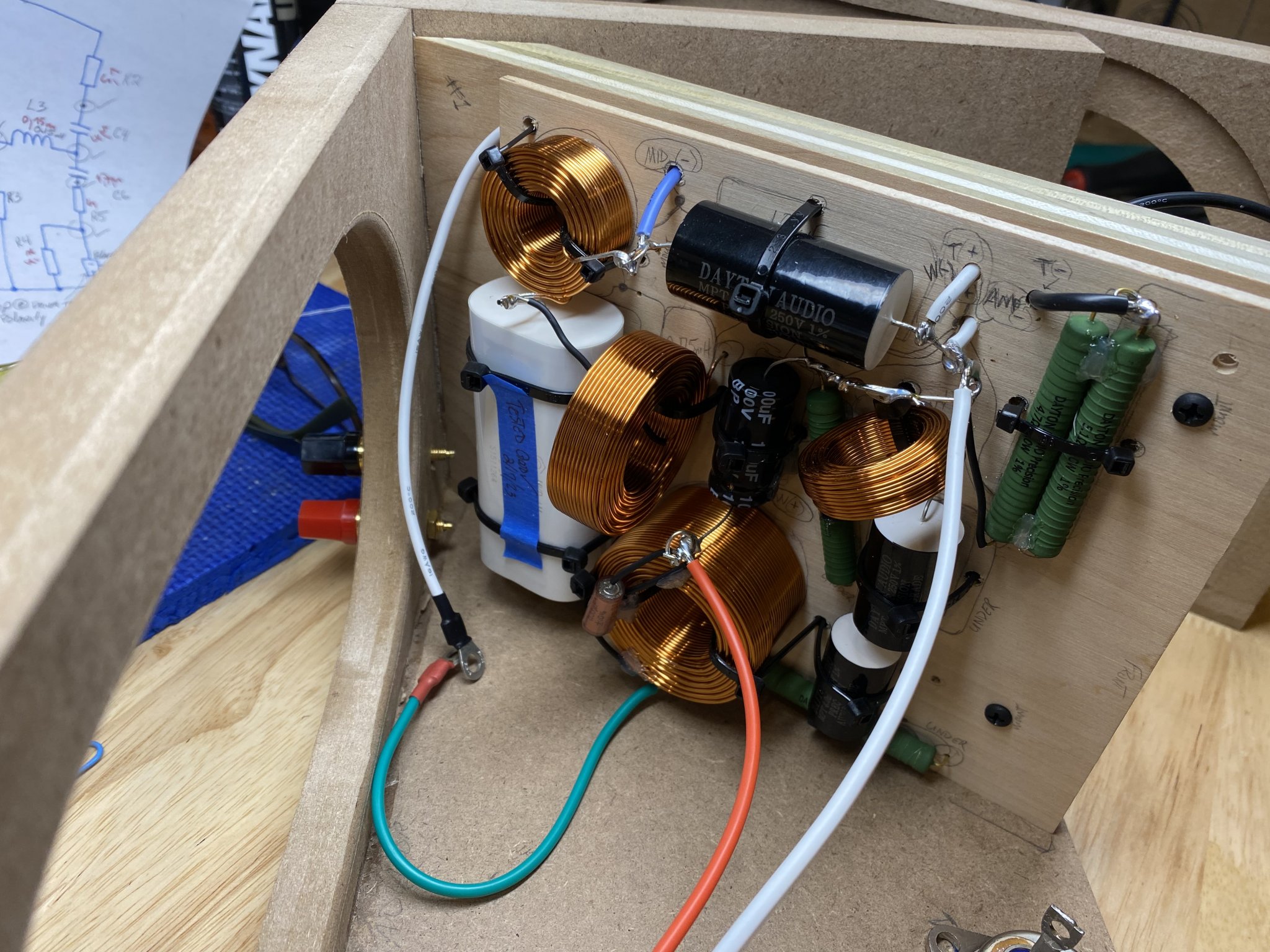

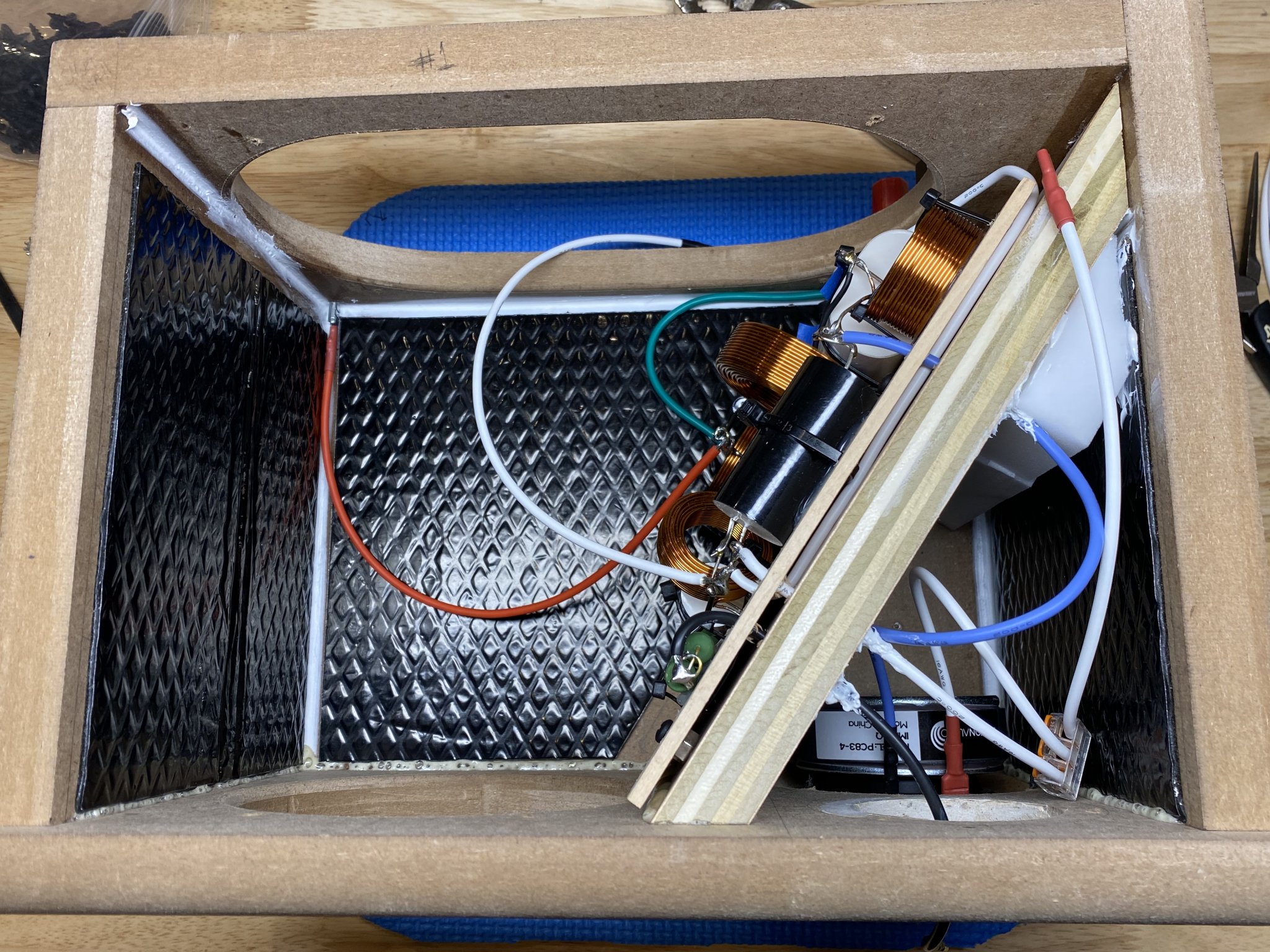

It was a slow go with a few bumps in the road, but the Purveyors came to life today. This was a challenge to make sure everything fit inside the small cabinet but it all worked out, your illustrated cab diagram was a perfect reference. I was able to squeeze a set of binding posts on the rear panel to the side of the off-centered passive radiator. The XO was tested before installed onto the chamber dividing wall. My plan was to be able to service the XO once the speakers are assembled but I don't think the XO will every be removed. I played around with some sound deadening materials and ended up with Noico sheets applied to the walls, base, lid and a chunk of ROXUL between PR and woofer and loosely packed in the mid/tweet chamber. All seams and drilled holes were sealed up, the chambers are independent and airtight. This made a big difference in sound, tightening up the midrange detail. Unfortunately, I will not be able to prime, sand and paint until the weather warms up. I don't have access to a ventilated climate controlled indoor space for proper paint curing.
These speakers like some power! 25W Class A amps are a no go here, I've whipped out the AB and D's to drive these :ROFLMAO:.
Thanks for sharing this stout, compact 3-way speaker Wolf!! This has been a very enjoyable and fun build. Best of all, the Purveyors sound very good with just about 8hrs of playing so far.....
