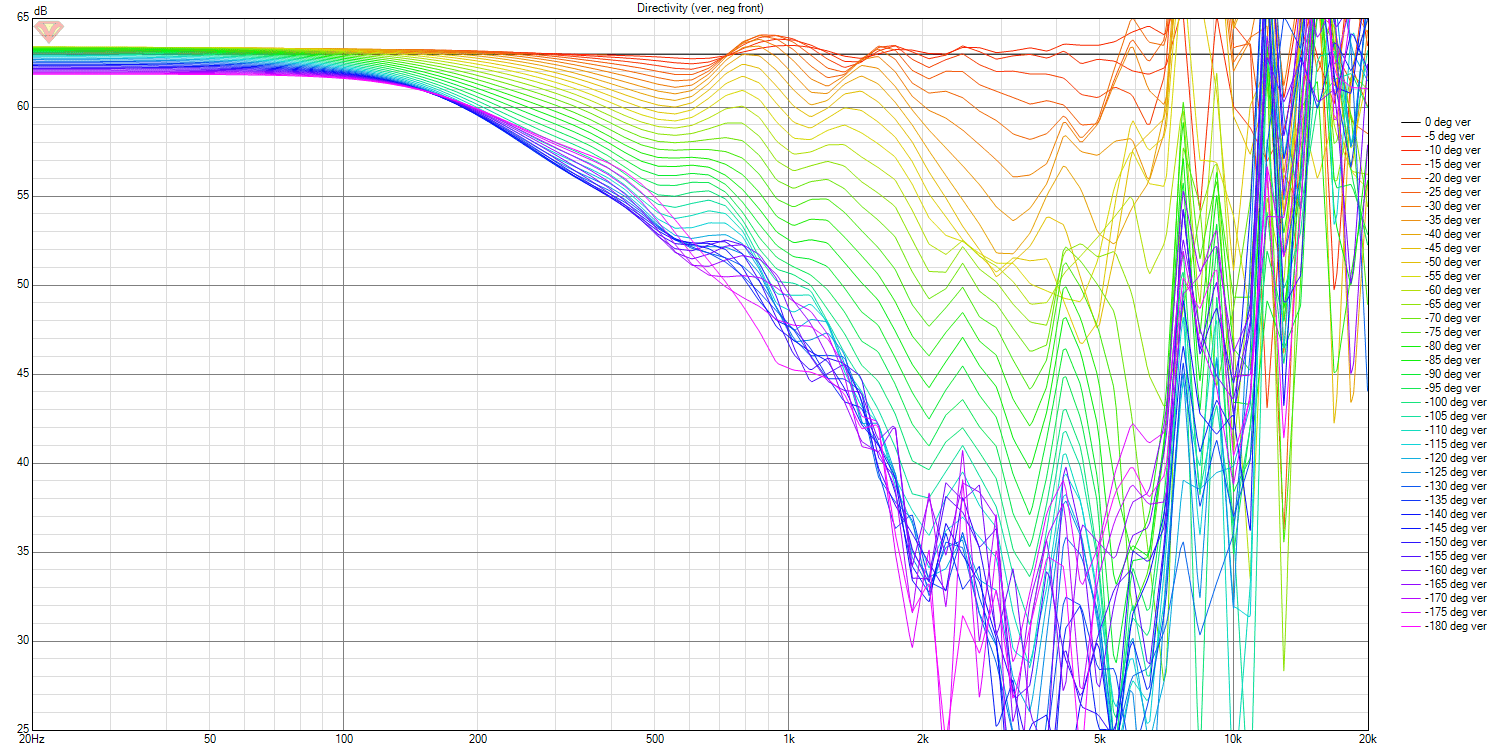

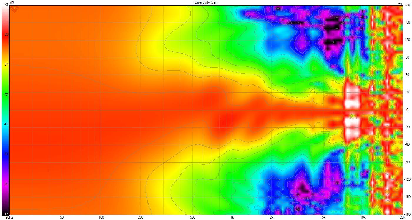

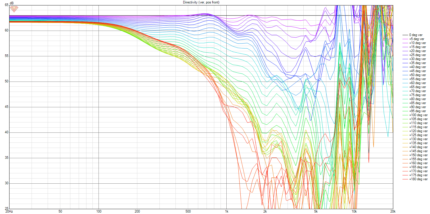

Hello Jim,
I have seen this step around 500 Hz a thousand times, actually, in my case it was a little lower, around 400 Hz instead. I saw it on the sonogram and it made me sad, because I knew it would mess up my DI. These horns ...
So the saddle, on the horizontal angles at least, was obviously around 400 Hz:
It leaves this pronounced and ugly step in DI, made more obvious here by only including horizontal angles:
However, turning to vertical, this is a totally different story. The positive vertical angles of a two-way cabinet, pointing upwards:
... and negative angles, pointing downwards:
and as sonogram:
DI for vertical angles has a very different pattern. Smooth around the discussed frequency, with a much sharper narrow-wide peaking higher up:
All angles:
This is obviously simulation data, from the well known ath software. At post 10,005 I had even once complained about the phenomenon in my data. Sitting at the wrong computer, I cannot give you the correct dimensions of the enclosure. It must be something very close to 32 x 60 x 27 cm (w:h:d). The simulated driver that generates these data has the SD of a PHL 3411, a ten inch driver. Not the same, but similar box: https://www.diyaudio.com/community/attachments/box-png.1046323/
My point being: This data does not include edge surround phase, and yet a step is visible, especially for horizontal dimensions. I assume this is related to diffraction and / or back wave cancellation.

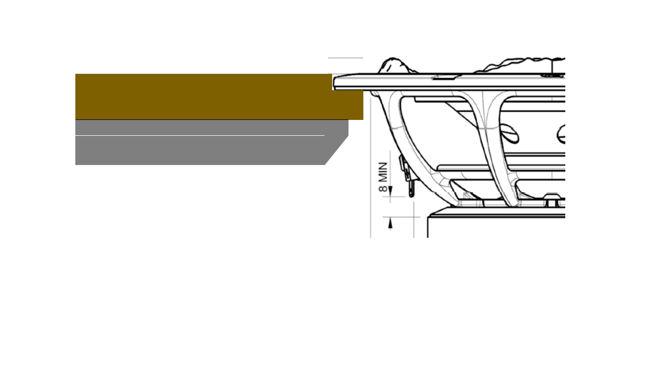

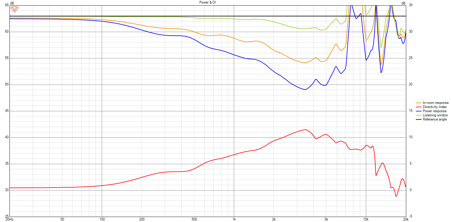

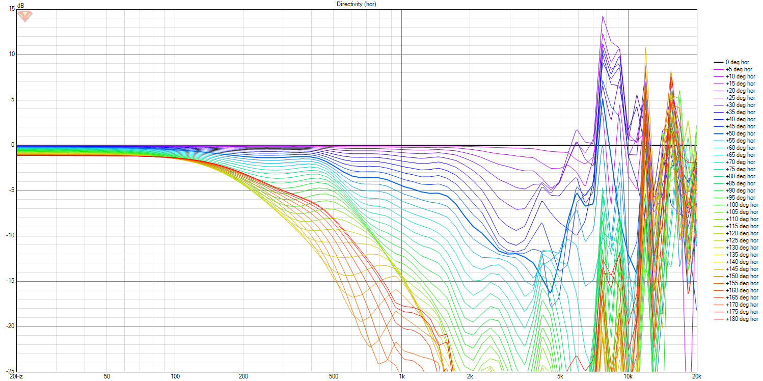

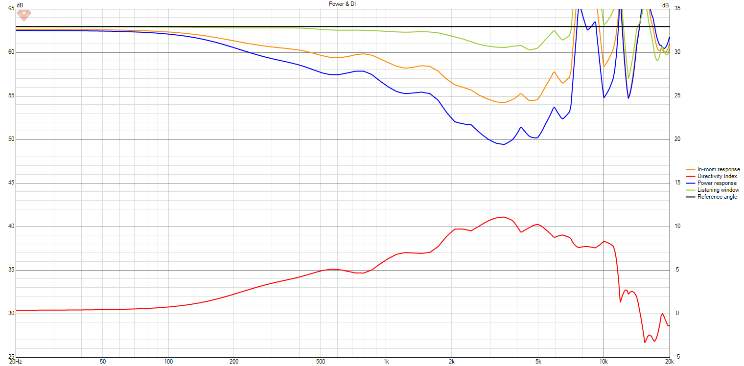

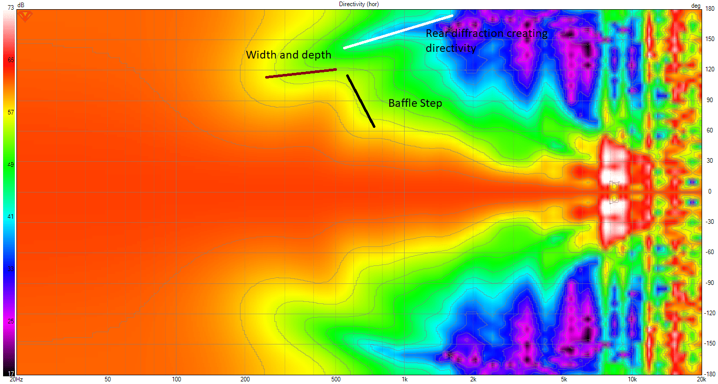

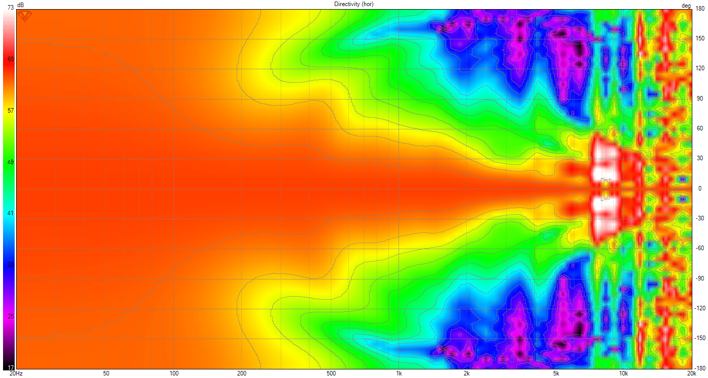

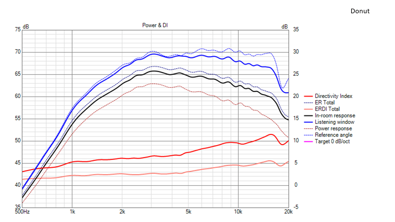

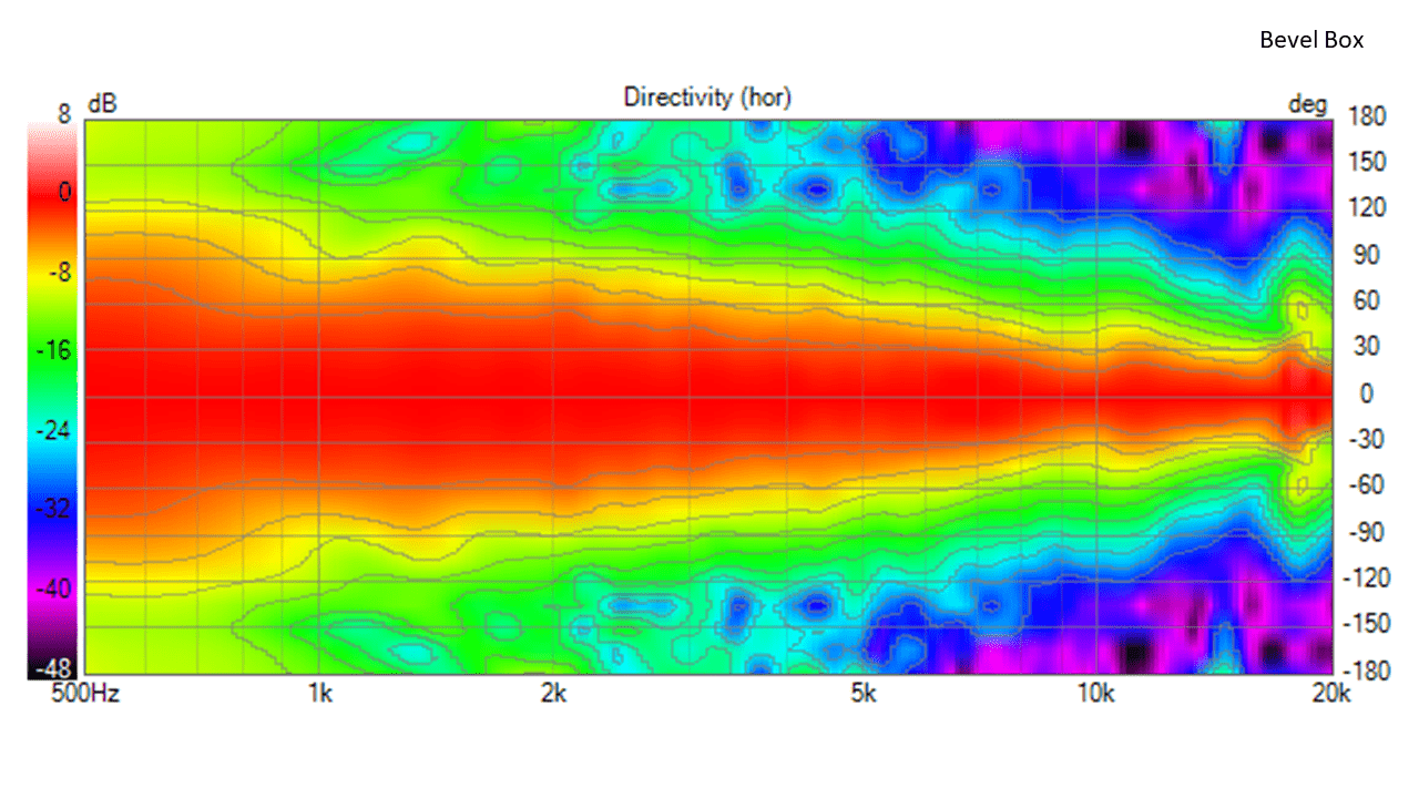

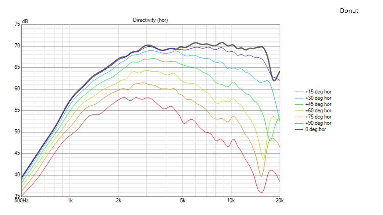

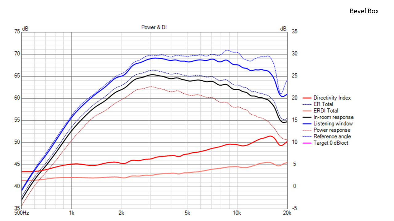

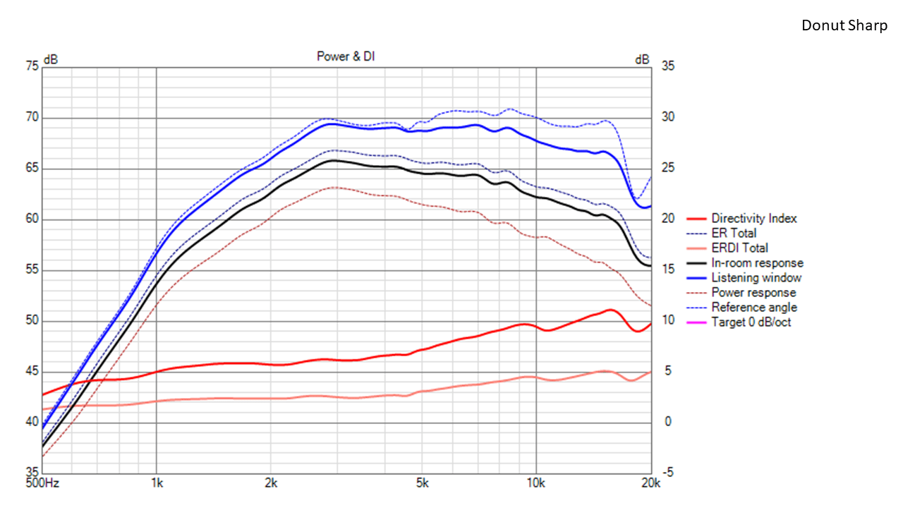

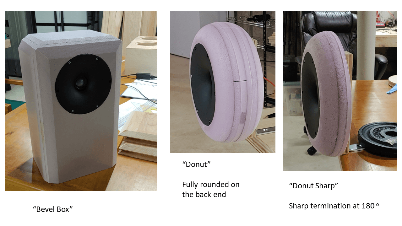

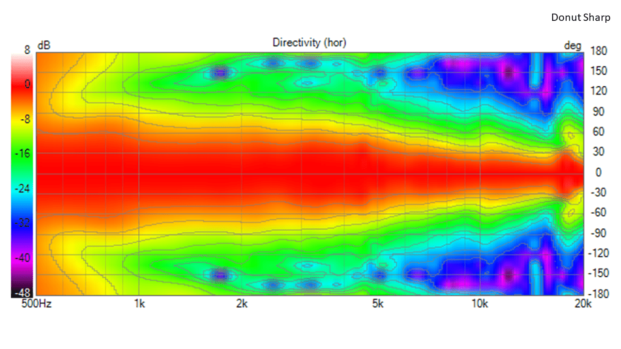

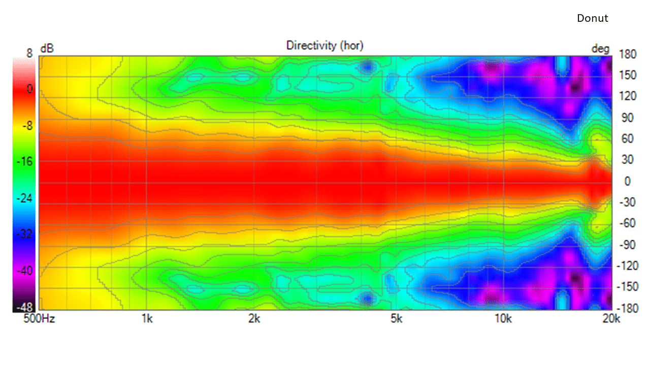

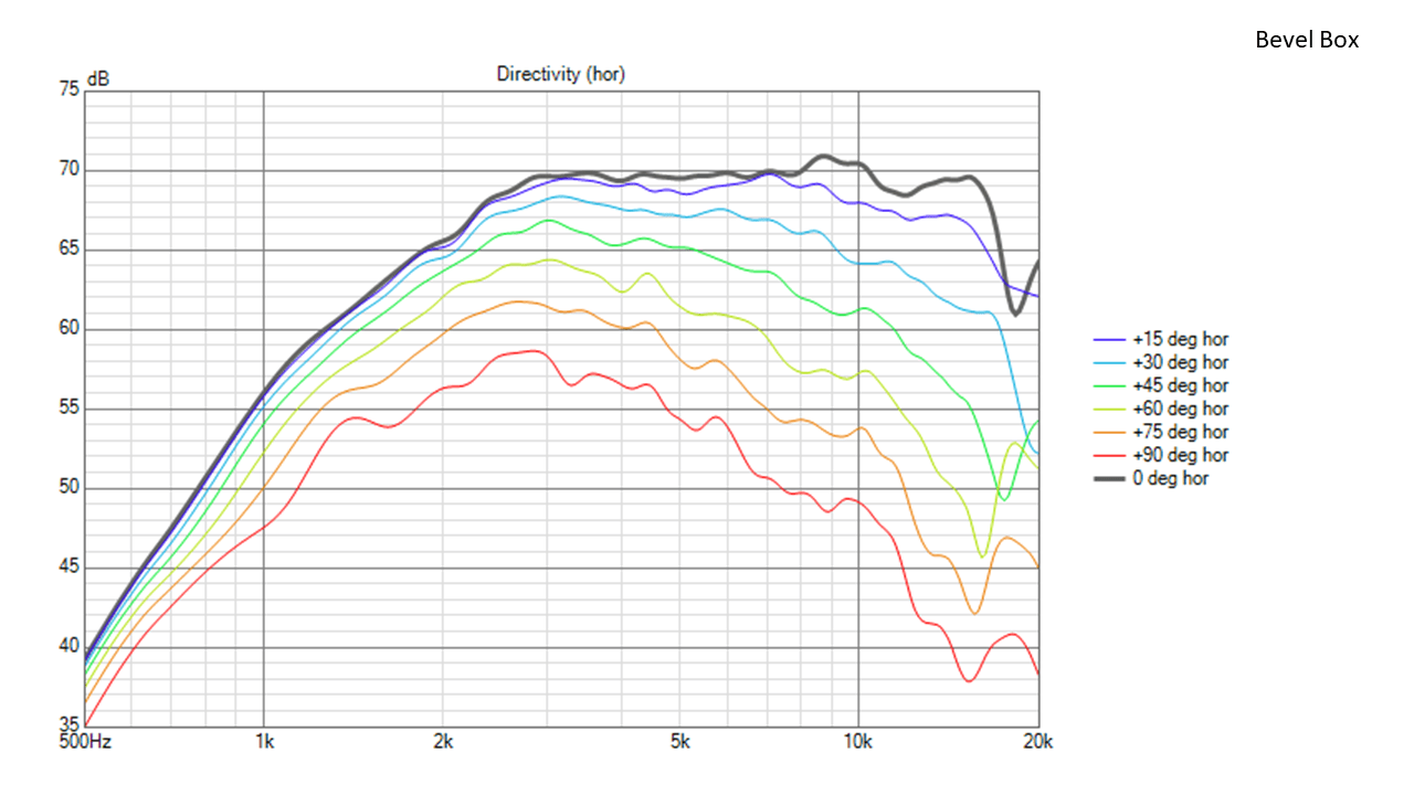

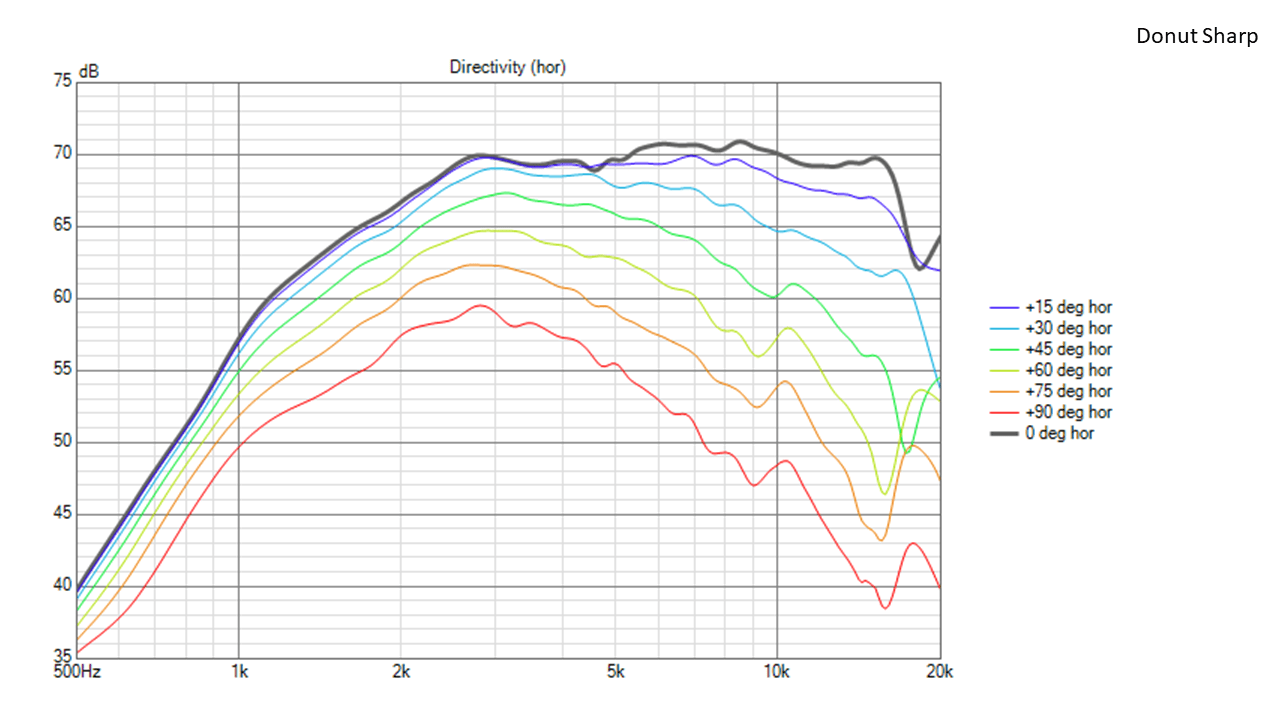

A visual guide to the features seen in the polarmap. Width and depth and rear diffraction are not modelled in spliced nearfield measurements using basic diffraction simulation. So a simulation like this has the potential to be more accurate than a real measurement in this regard.My point being: This data does not include edge surround phase, and yet a step is visible, especially for horizontal dimensions. I assume this is related to diffraction and / or back wave cancellation.
In post# 111, I showed a modified tweeter housing, the Donut with a sharp termination at 180 degrees. I decided to remeasure all my tweeter housing options under the same conditions to get maximum consistency. I made 0 – 180 degree horizontal measurements, in 15 degree increments. I completed this latest round of measurements a few weeks ago, but vacation and other things got in the way of posting.
I am showing the bevel box data just for documentation purposes. At this point I am committed to a free standing waveguide, so after this point I will no longer be doing any development work on the bevel box concept.
When I loaded the data into VituixCad, I applied a first order high pass filter at 7.5 kHz to all the data. I find this flattens the waveguide response and makes it easier to visually evaluate. All the data you see below is filtered this way.
The differences between the three options are fairly subtle. Nothing stands out as a defect in any of the three. I believe the “Donut Sharp” has a better response than the “Donut”, and that is how I am proceeding.

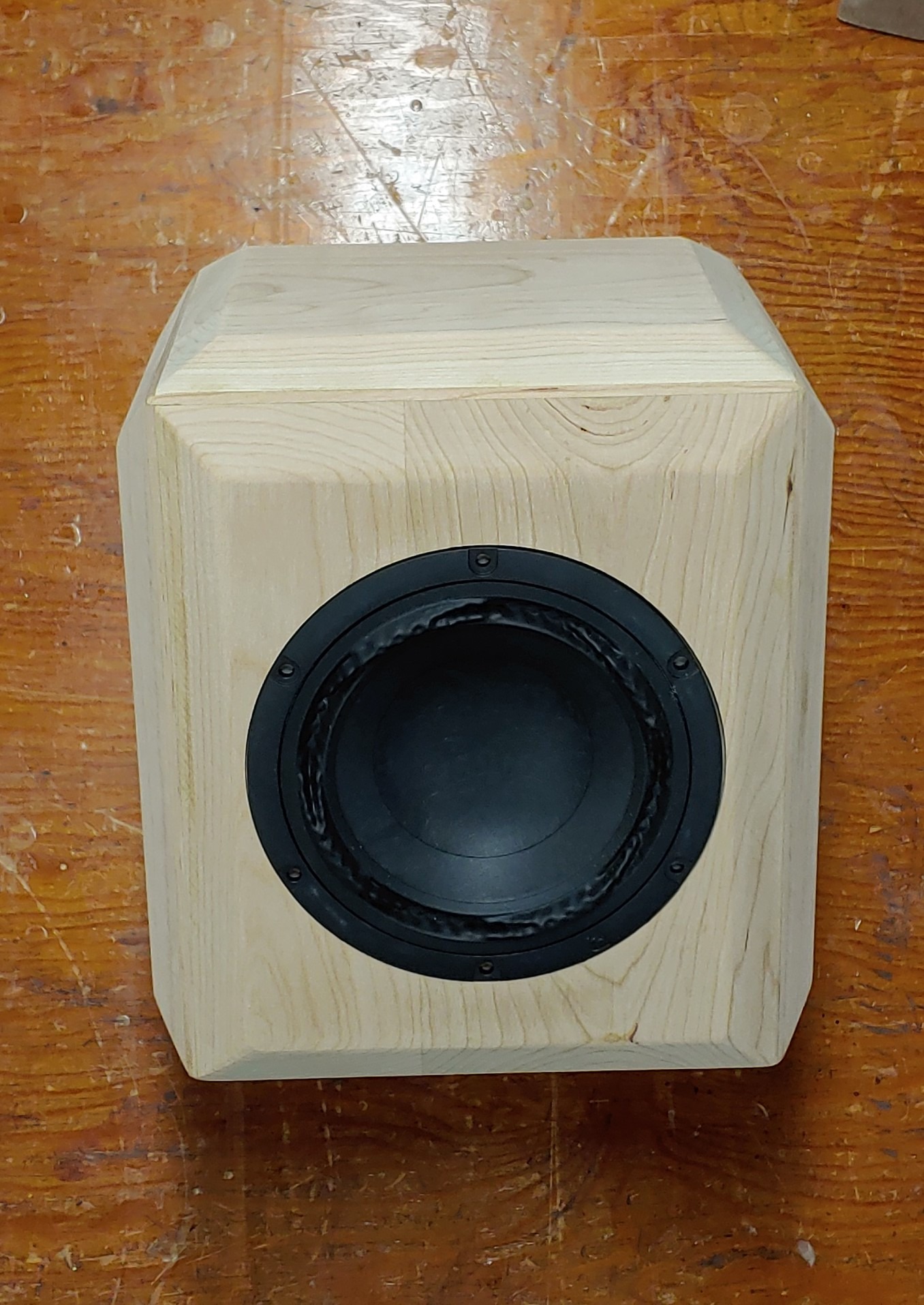

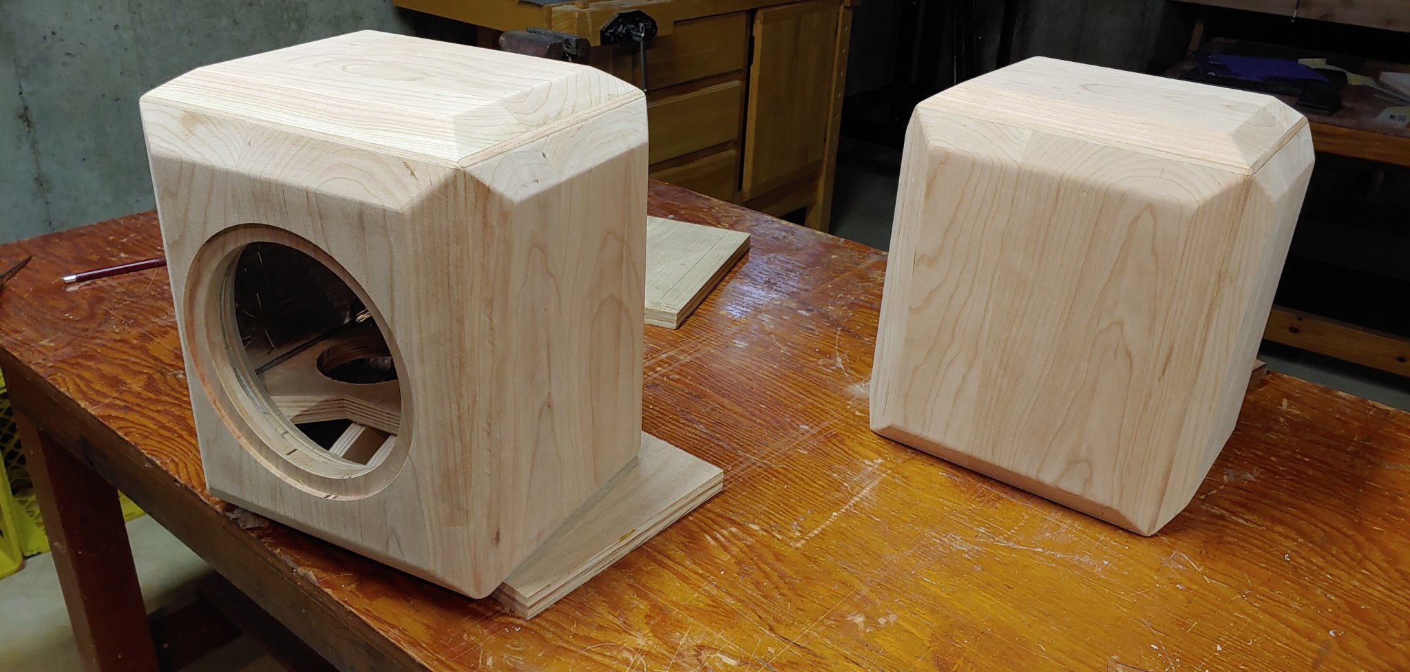

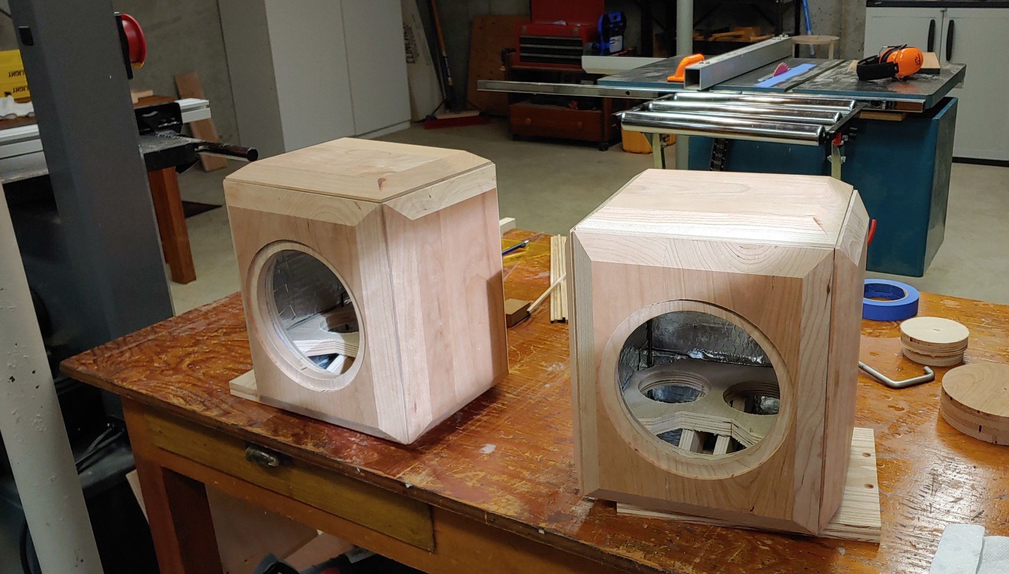

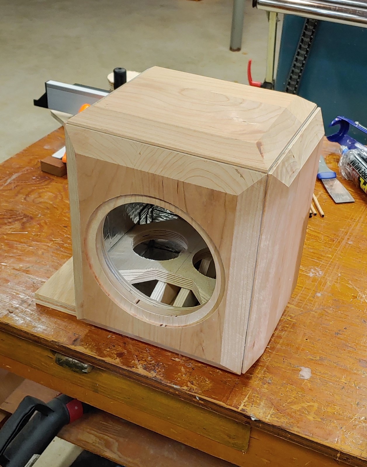

The midrange cabinets are constructed. I have some cosmetic trim to add at each corner, then I am going to profile them with a block plane and sandpaper to remove all sharp edges.
I used a tenoning jig on the table saw to cut the bevels. I bonded the cherry panels to the plywood box with construction adhesive. I was concerned I would have trouble maintaining the position of the panels since I have no mechanical interface or index between the panel and the inner box. I did a few mock-ups, and found it would be no problem, and it wasn't... I just pressed the panels down into place, applied a 50 lb weight, and let it cure. Total wall thickness is 1.5 inch.
The next step will be constructing the tweeter housings (free standing waveguides). My foam "donut" was 255 mm diameter. After applying the 37 mm radius roundover, there was about a 6 mm flat spot between the edge of Satori waveguide and the start of the foam donut radius. I will reduce my overall diameter to minimize that flat spot.
j.
j.
The waveguide housing will be constructed of laminated layers of cherry. Someday I would like to fabricate an entire waveguide from laminated wood, but I think I need a CNC router for that. It's good to have future projects lined up !
The midrange cabinet has been profiled, and trial fit with the PTT6.5M.
j.
j.
