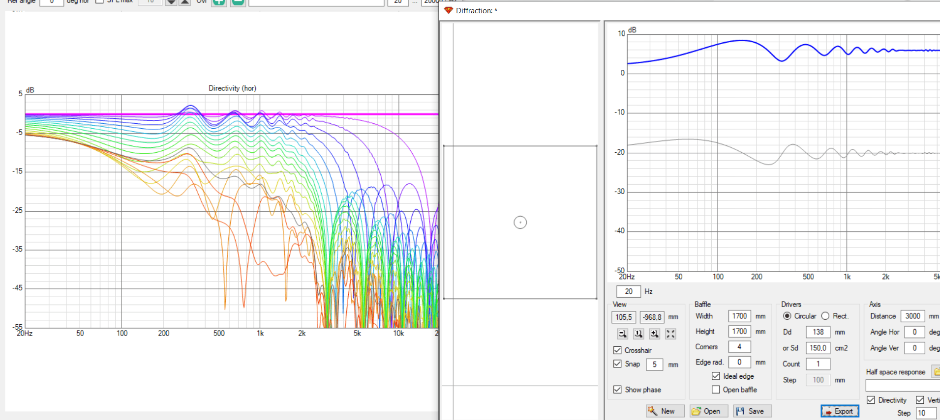

Quick test with Vcad diffraction tool. If driver was measured on a ~170cm square baffle there would be similar effects in the normalized response as in hifi compass measurements, bump off axis around ~300Hz.

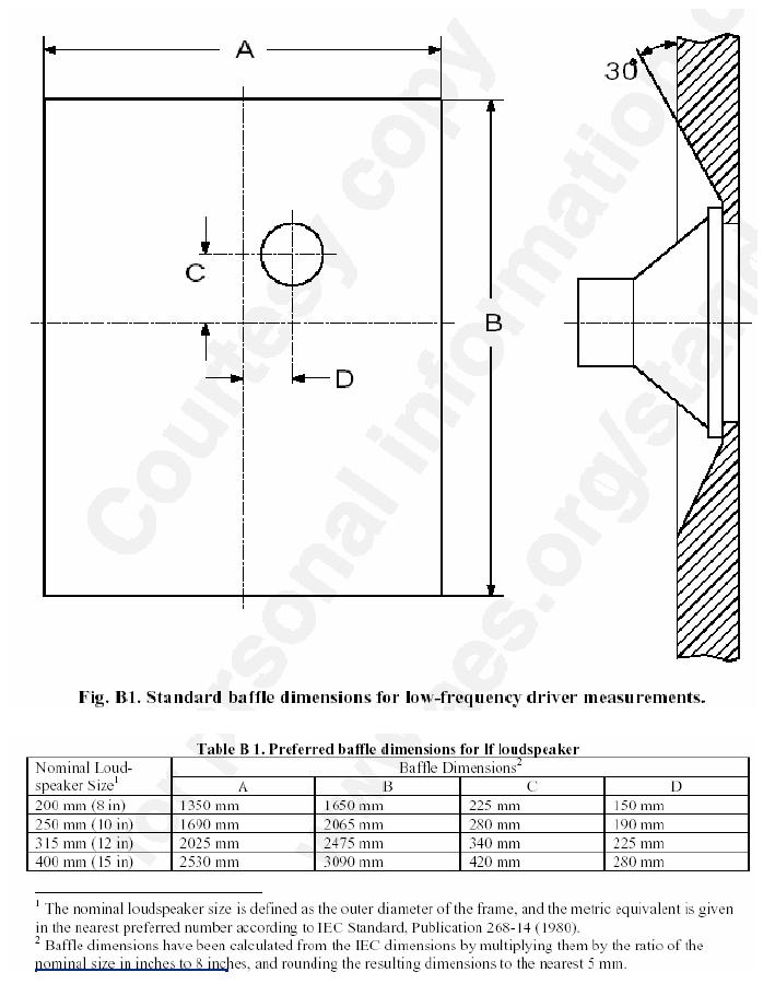

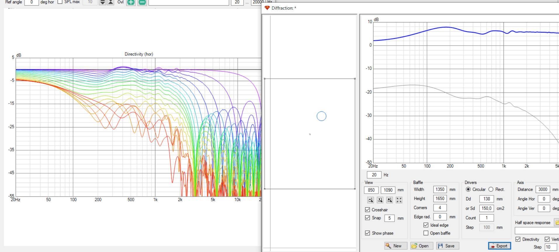

Here is some dimensions of the IEC setup which is probably used "always with proper measurements" http://www.rjbaudio.com/Audiofiles/IEC baffle.jpg , Hificompass probably uses IEC setup more or less accurately. Here is approximation of that
How would the above sim relate to the differences measured between the different drivers?

Not a bad guessIf driver was measured on a ~170cm square baffle there would be similar effects in the normalized response as in hifi compass measurements, bump off axis around ~300Hz.
From Hificompass site
Measurement setup specification
Test baffle size – 1650x850 mm

JanRSmith, when there is difference between drivers I suspect the measurement setup or processing of the measurements differs somehow. It could be the baffle vibrates in case of IEC measurement. In case of different drivers on same box it could be difference in measurement procedure or window settings while processing the impulse responses to frequency responses. Or something along the lines.

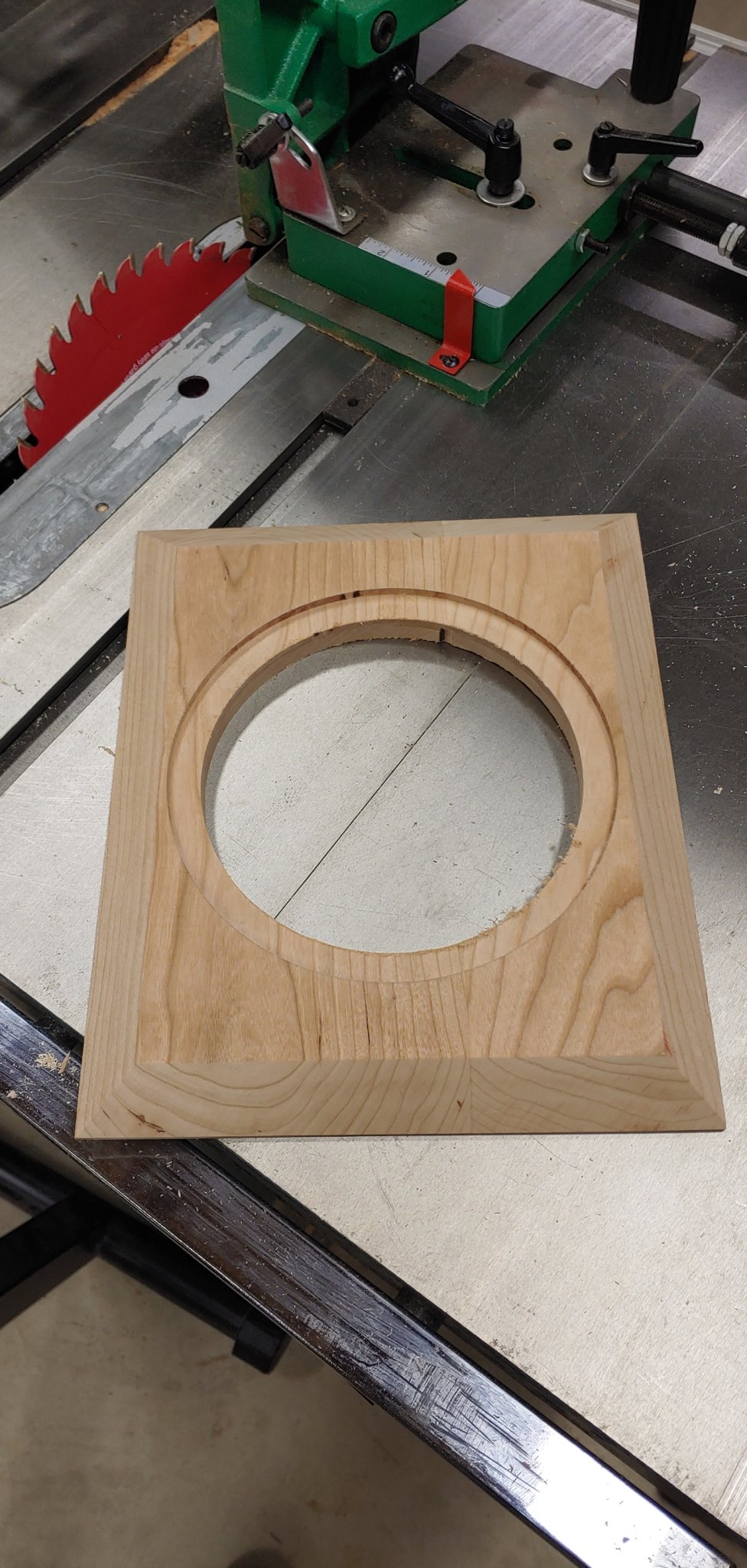

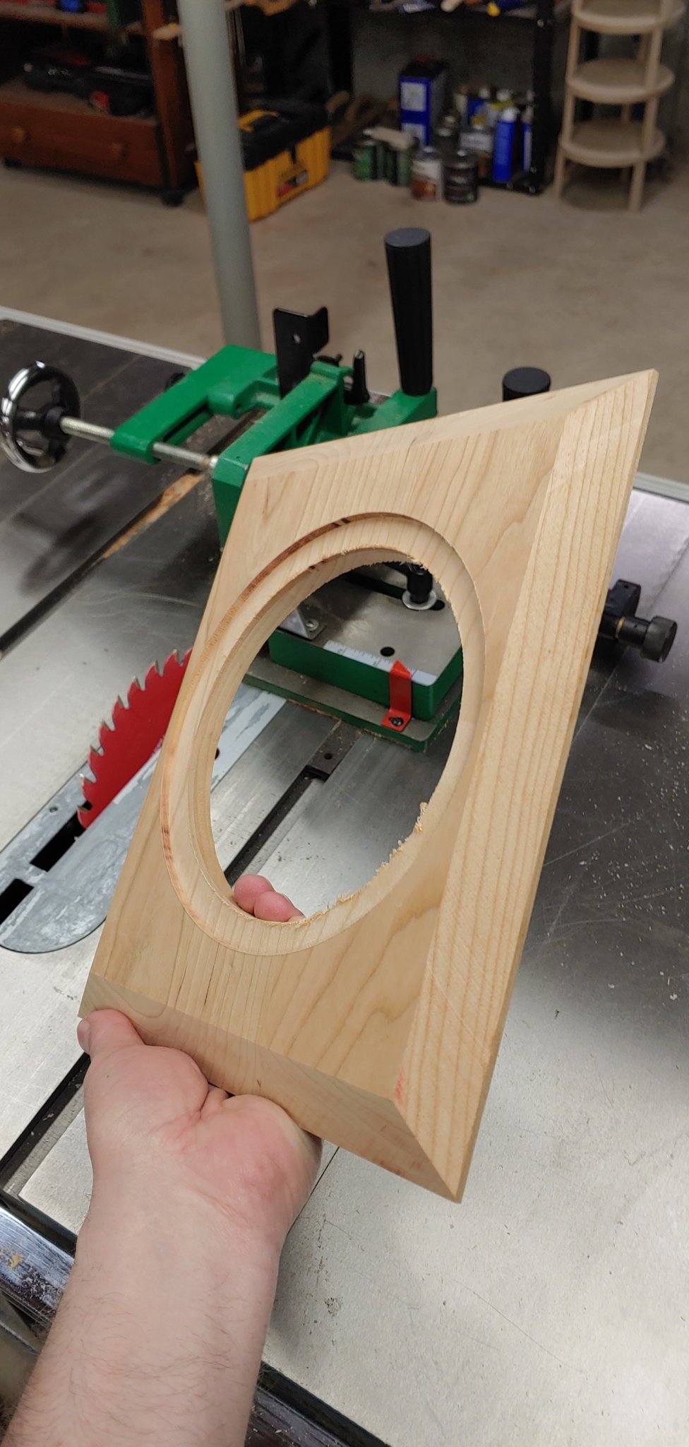

in other news, construction is continuing. I have made the cherry panels which will encase the midrange cabinet. It is so nice to work with hardwood again. So much less dust than working with plywood (or MDF which is worse). Less heat build up in the tools.
The front baffles have been routed and profiled, the rest of the panels (sides, rear, top) will get profiled tomorrow. Final profiling will be done on the fully assembled box, and I anticipate it will be a well-rounded shape with 2" radius compound bevels on all edges.
