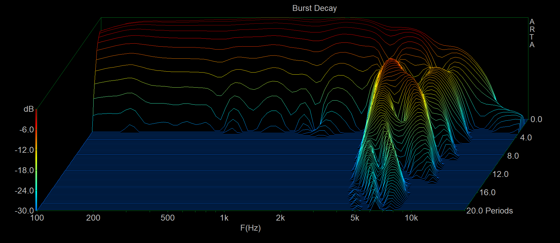

Did you do a near field measurement of the woofer and investigate the burst decay plot? That should reveal any problematic standing waves inside the enclosure (and the driver).
The cone breaks up at 4kHz. That seems rather low to me, with rather down to earth drivers like the RS180 or AL170 the trouble starts at about 6k. I don’t see the breakup in your filtered response. The low pass slope of the mid is clean, which puzzled me.

Cone break-up of these drivers can be compared to many third party measurements (incl datasheet).Did you do a near field measurement of the woofer and investigate the burst decay plot? That should reveal any problematic standing waves inside the enclosure (and the driver).
Like HifiCompass, AudioXpress, Erins Audio Corner etc.
On the other hand, there aren't many other acoustic issues that will have something resonating at 4kHz, that is pretty high.
This woofer is so well documented at this point, that I would just go along with all those third party measurements.
In those other measurements, a peak around 4kHz can clearly been seen as well.
Even in the datasheet this 4kHz peak can be seen actually.

Burst decay plot of Near Field PTT6.5M

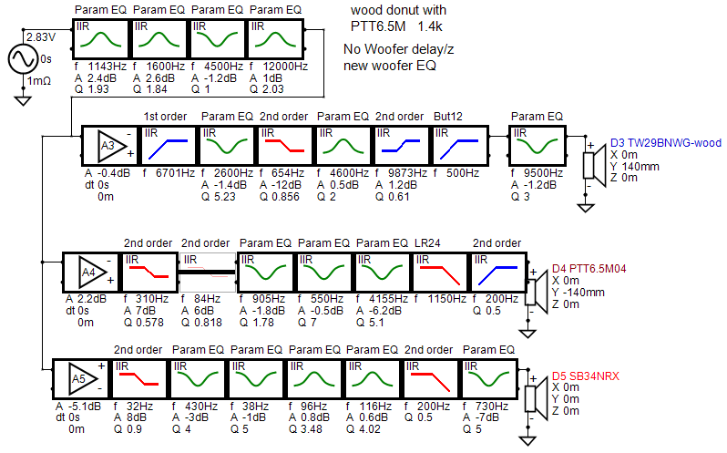

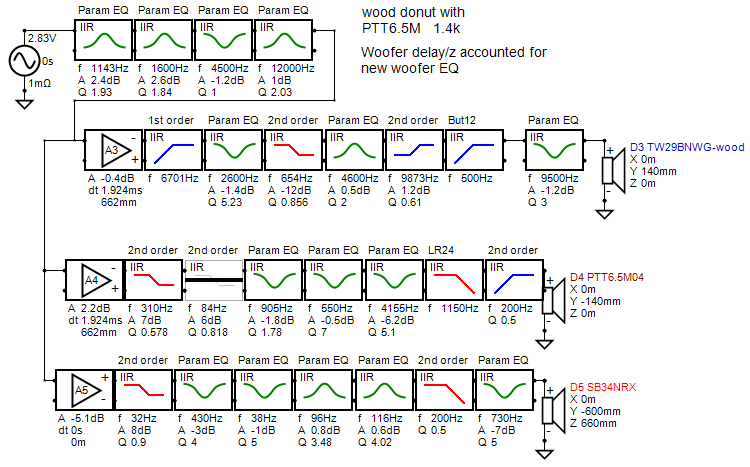

I can see why you would think that since the 12" woofer is at y=0, z=0. In truth, the reference axis is midway between the midrange and tweeter... the tweeter is at y= +140, the mid is at y= -140.Nice work @hifijim. Interesting that you chose the woofer as the reference axis. How come?
When I properly account for the position of the woofer, including the time delay, it makes very little difference for the purpose of crossover design, and it complicates the situation when looking at phase. So I simplify the simulation by making the woofer at 0,0,0 with no time delay.
Here is how the filter would be actually implemented in the Hypex amps... this includes position and time delay. Since the woofer is 660 mm behind the mid-tweeter, the two upper drivers need to be delayed by 1934 us. This makes the phase plots goofy.

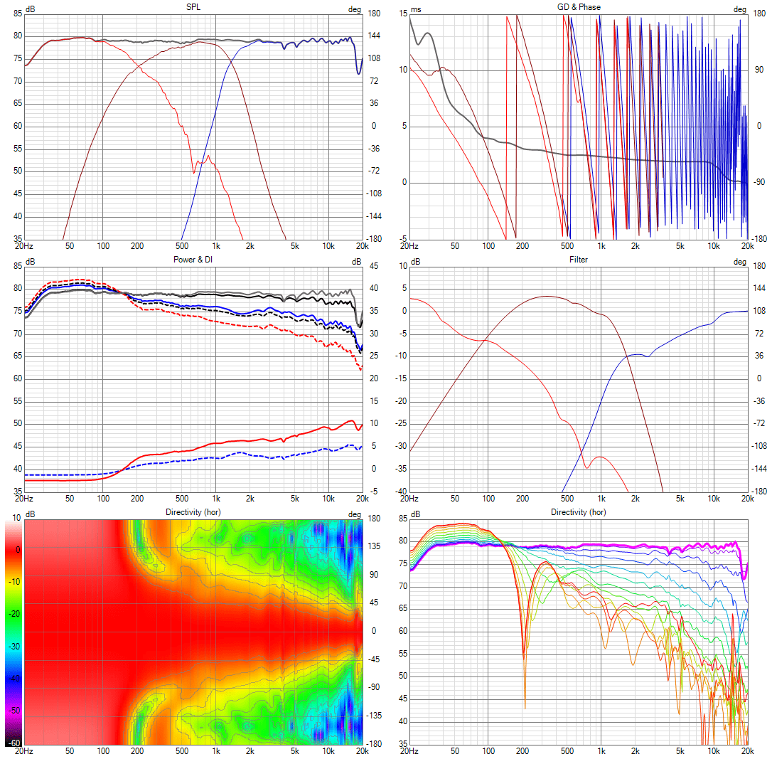

At this stage of simulation, my goal is to optimize the PIR (predicted in room) curve. At this point, the goal is a slope of -1 dB/octave from 100-10k. All of this is just to assess the feasibility.And what were the reasons for having a down-sloping on axis and listening window?
When everything is assembled, I will take the final set of measurements. This will capture any interaction between the mid and tweeter, such as cavity resonances, and spillover of midrange frequencies into the waveguide [ @fluid alerted me to this phenomenon in post #103
https://www.diyaudio.com/community/threads/purifi-waveguide-project.394174/post-7293406 ]
At that point, with final measurements, I will design the filter for maximally flat on-axis response. This is the easiest/best way to get the driver levels and delays dialed in, and the best way to do quality control checks to ensure that the intended filtered driver responses match the Vcad simulation and sum together as intended.
The maximally flat on-axis filter will probably sound a bit bright and forward, but it is a great starting point for the subjective voicing process.

I usually optimize for 15 degrees as a starting point. With a close look on 30 degrees followed by 0-degrees.
The reason has mostly to do with diffraction artifacts. When focusing on just on-axis, the overall tendency is to under compensate. Which very often results in (way) too much energy, in most cases around 800-3000Hz area (depending on width of baffle).
In general, the overall global response is far more important than little details. Especially when those details are dips.
When that is all set, one can start tweaking the details. In the end that's almost always subjective.
