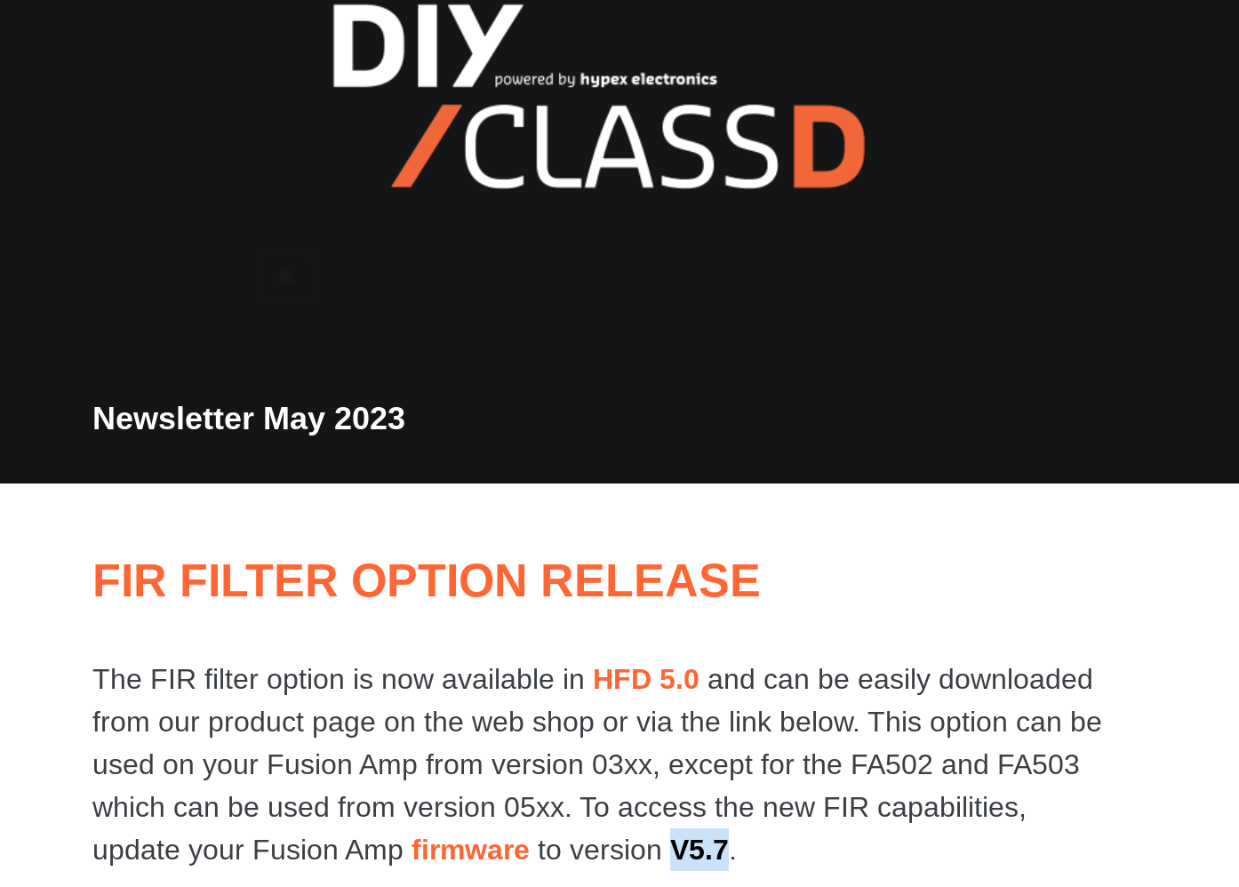

Yes, hot news!
My FA123 does not accept the firmware tough, sadly. Only v1.51, which is also included with the HFD 5.0 download. Already emailed them to find out whether the possibility exists to exchange the DSP boards.

I find it kinda bizarre news, why on earth it took SO long?Yes, hot news!
Their SigmaDSP IC's support this out of the box.
That is an interesting observation, Juhazi - I have also found that differerent speakers will sound nearly the same if they are eq'd to have the same on-axis response (at least when listening on-axis)... but all of my experiments have been with speakers that have very similar radiation patterns. In your experiment, the AINO and coax have very different patterns...They sound amazingly similar, biggest difference is in treble "sharpness" and stereo imaging.
I assume a mixture between pandemic parts shortages, price increases and investment models. There was a short discussion at ASR but I do not remember if their staff making this statement.
@sheeple
All those things don't have anything to do with a simple software implementation?
They still use the same ADAU145x chip, even with their older ADAU170x system this could be done (just extremely limited, but doable)
But yes, those IC's were a totale pain and impossible to get for a while (I had to cancel quite A LOT of projects for that same reason)
My limited understanding of the capabilities of the chip made me believe in a statement of another user in the Hypex-thread, that FIR was introduced with the ADAU1452. And previous discussion revolved around the calculation power to provide enough taps. All of which I do not understand much about ... 😛
Anyway, I wont pay another 900 EUR only to acquire FIR capabilities, to buy again a product that I already own. That's just a tad too steep.
It's in the release notes of Hypex Filter Design v5.0:
"- FIR implemented (4500 taps for one FIR filter at the input or 1500 taps per channel on the output)"
Sampling rate is what the digital section of Fusionamps uses, 93.75 kHz.

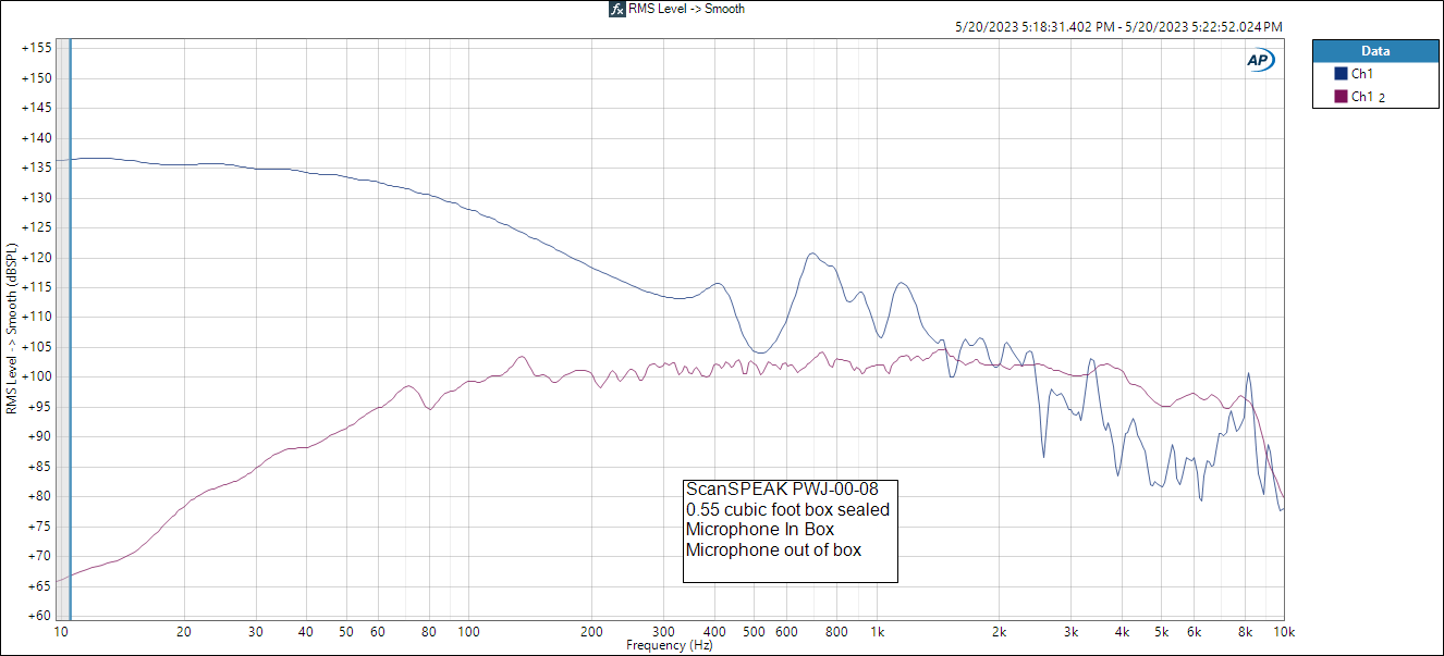

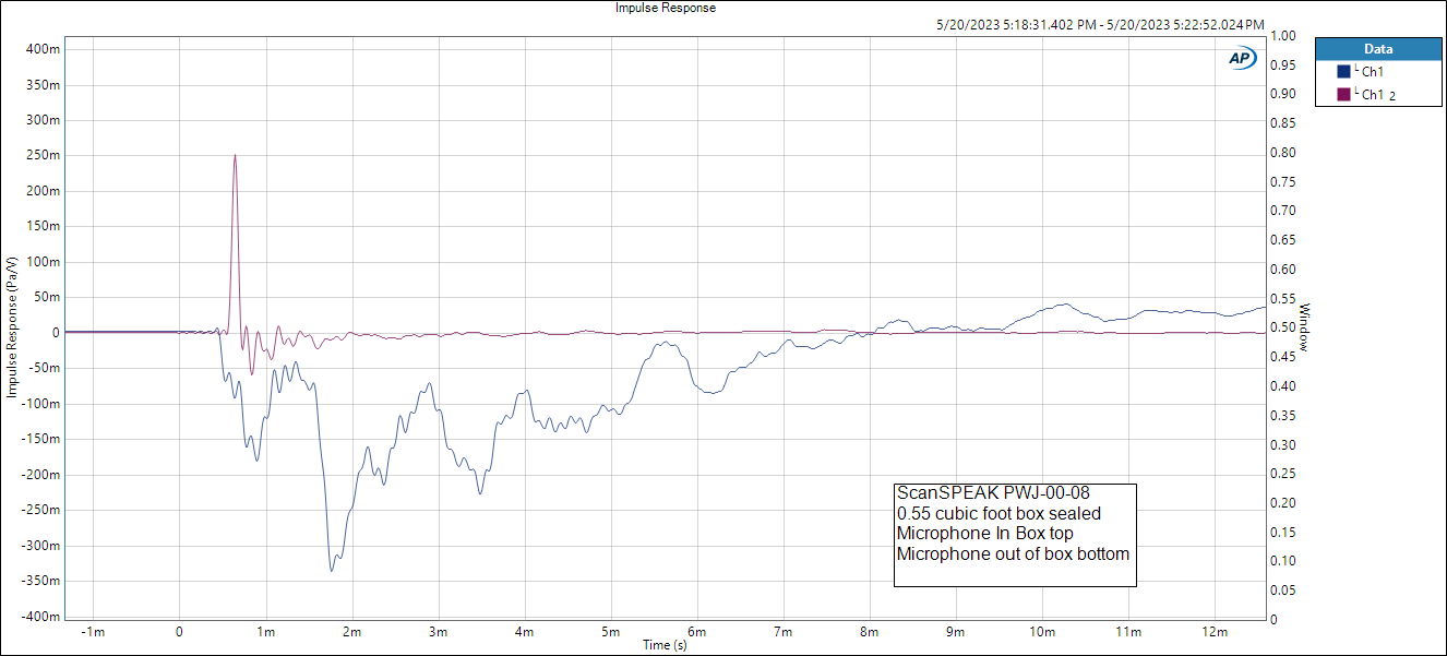

Today I have been playing with a ScanSPEAK PL17WJ-00-08 Mid-Bass driver in a sealed Denovo 0.55 cubic foot enclosure.
I drilled a 5/16 inch hole in the front Baffle where a tweeter will be installed, if there will ever be one. I ran the APx500 Acoustic software add on, including impulse, both with the GRAS pressure microphone inside the box and outside the box about 10 inches away from the center of the driver.
It is interesting to see the dB SPL measurements inside and outside. At 2.83V input the dB SPL inside inside the box was up at 135dB ish. This would overload many microphones. The impulse bounced around inside the box for 7 times longer than in the room with the microphone outside the box. The ringing inside the box may may have affected the speaker response in the room. That is for future consideration. There are more impressions and observations yet to be considered.
The dB SPL measured outside the box was much flatter than inside. The pressure inside the box drops of quickly with increasing frequency. First impression is that the measured in the box pressure modulates with the ripples in the impulse response.
Next time we will see what happens to the impulse inside the box with some sort of vent in the box.
I used this new old stock off the shelf driver to avoid upsetting someone about their current favorite driver.
Thanks DT
Edit: Oops mistake labeled the impulse plots backwards.
The top trace is measured out of the box.
The bottom trace is measured in the box.

If you correct the mib measurement with a upwards slope it will show a high pass high pass curve op to ~ 300 hz like the outside measurement.
Above that the the internal reflections/standing waves are visible.
Encouraging such experiments, I wonder what your objective is here. Wall resonances occur typically around or above 400Hz. There is hardly anything like a balloon effect at low frequencies. If you’re interested in measuring standing waves inside the enclosure, best place the microphone in a corner.
