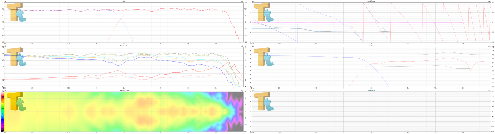

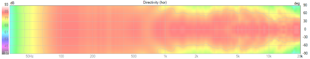

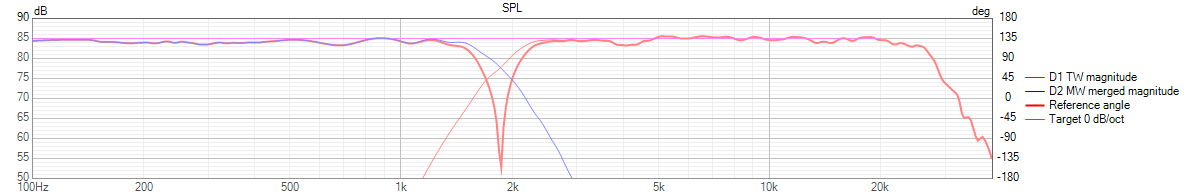

Here’s is example of what can or cannot be done; regardless of the crossover:

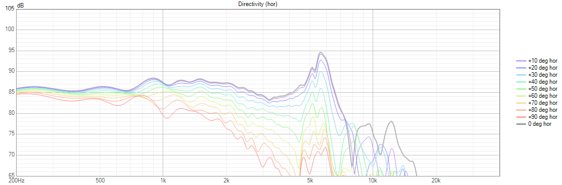

5” hard cone midwoofer, in box; with a relatively well defined resonance.

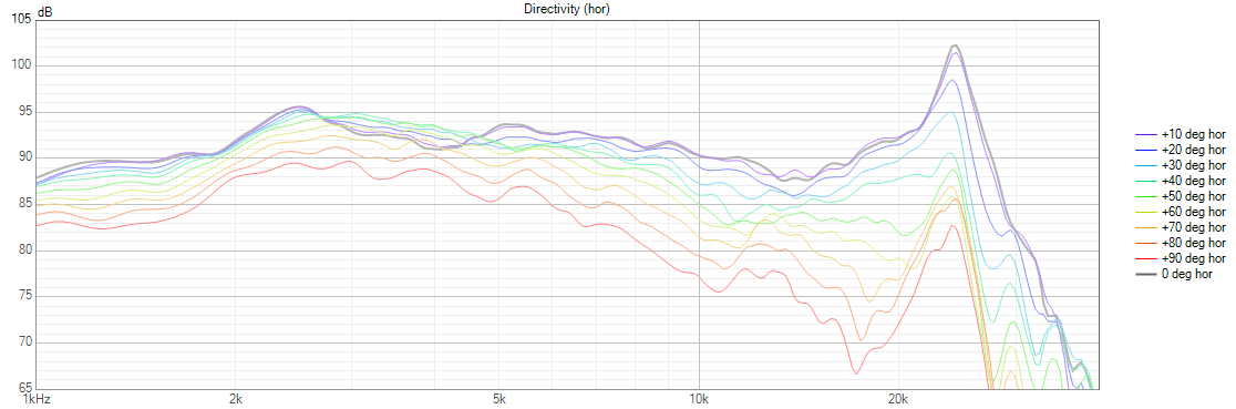

The tweeter:
Company’s own DSP based crossover:
That’s a bit odd.Can I do better?
Let’s try LR8 @ 2K:
Ok so now I’ve reduced the wide narrow wide problem. A little.
But the tweeter can’t handle LR8 @1.8K (not shown- data on another computer I’ll try to show later
Let’s try acoustic LR2 4KHz:
Ok so I reduced the directivity mismatch.
But the wide narrow wide is still there.
Is it better? Yes.
Is it worth the recommendation to the engineers. Perhaps.
Or perhaps the more well behaved midwoofer (eg. Smooth response past 6-8K) and waveguided tweeter would be better)
But then the direction of the HF is typically 40-50 degrees.
Erin @ ErinsAudioCornrer; who has measured (and listened) to over 100 speakers with his Klippel NFS, recently stated he clearly prefers wider directivity in the HF:

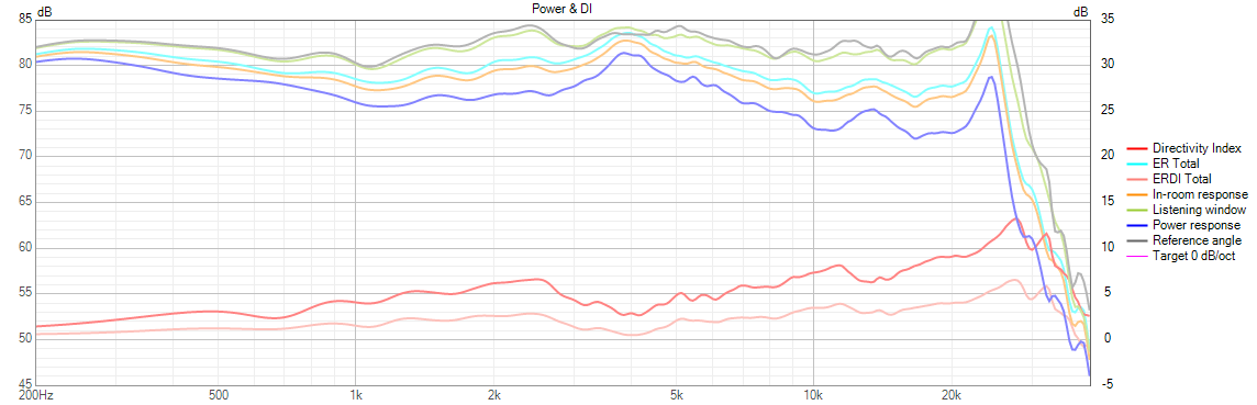

The …. which use a dome tweeter on a flat baffle - have a average horizontal radiation width of about ±70° on average which is much closer to my subjective preference compared to the Arendal’s ±40° thanks to their waveguided design. This provides more room interaction which I find pleasant and yields a typically wider soundstage at the expense of pinpoint imaging. Tradeoffs.

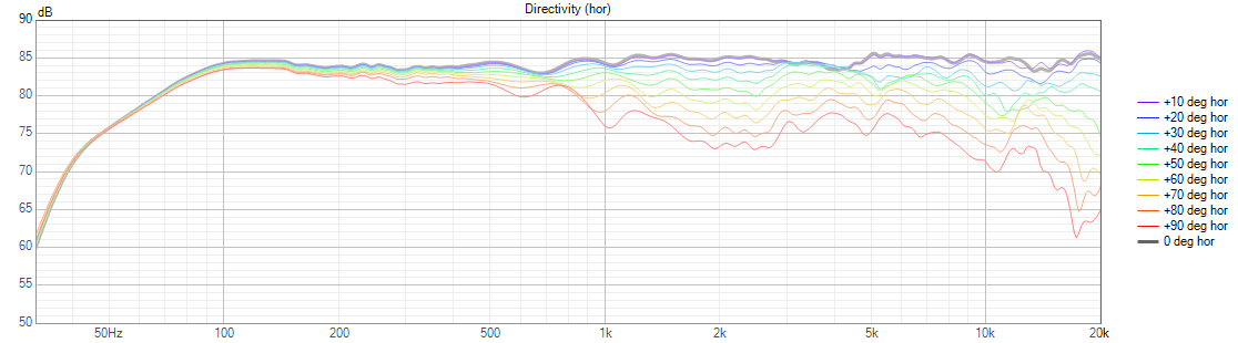

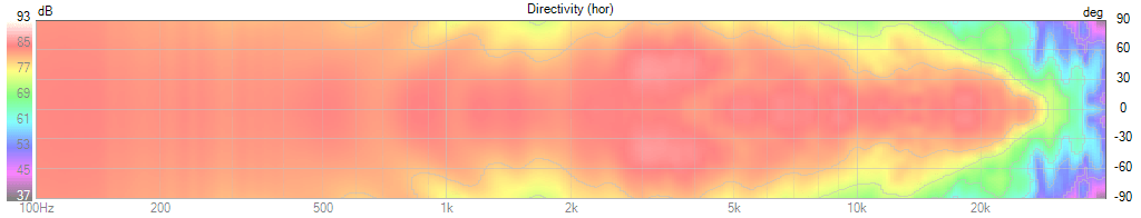

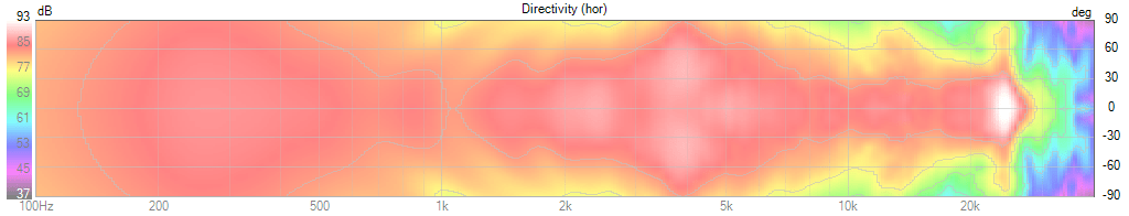

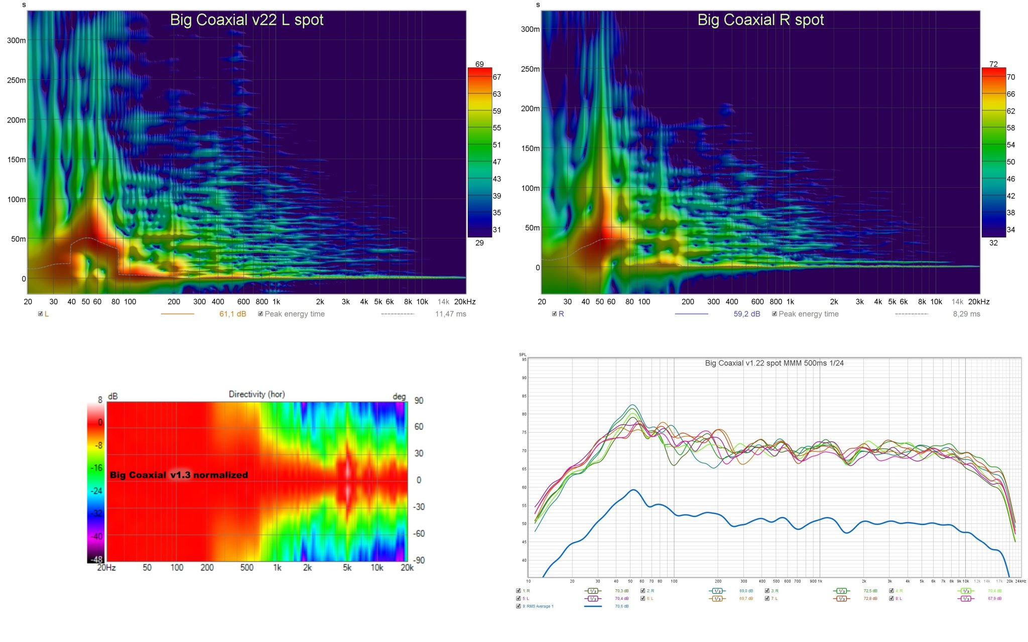

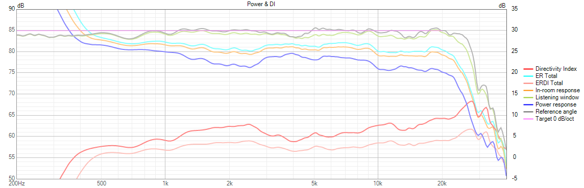

Here two rather extreme opposites of loudspeakers measured in my living room. Both with multich dsp so I can adjust tonal balance to be equal. They sound amazingly similar, biggest difference is in treble "sharpness" and stereo imaging. Can't say about fatique...
AINOgradient is 4-way dipole with monopole bass.
BIG Coaxial is 3-way with 12" PA coaxial with horn.
Dear Juha,
Do you think it one sounds - “more spacious and more 3D” and the other “more precise or accurate”
My question is what sounds like “real music” when you are in a completely different room.
My guess is the AINO

High directivity of big coaxial drivers make stereo image to alter/shift too much with minimal head movement. Starting with very "sharp" imaging, I and friends find this annoying/disturbing. Eg. a female singer (soprano) will move from center to almost other speaker when head is rotated or turned while sitting on a chair!@Juhazi , what the diff in stereo imaging you observed?
Spaciousness is more difficult question, some recordings sound very nice with coaxials, but they are more critical about recording/mixing/mastering than dipoles. I listen mostly classical nowdays, both recordings and national broadcast lives (which are very very well done). With pop music it's hard to say how they are supposed to sound... I have had AINOs installed in another only once during 10 years, at a national diy hifi event (and I won the prize for best sound!)

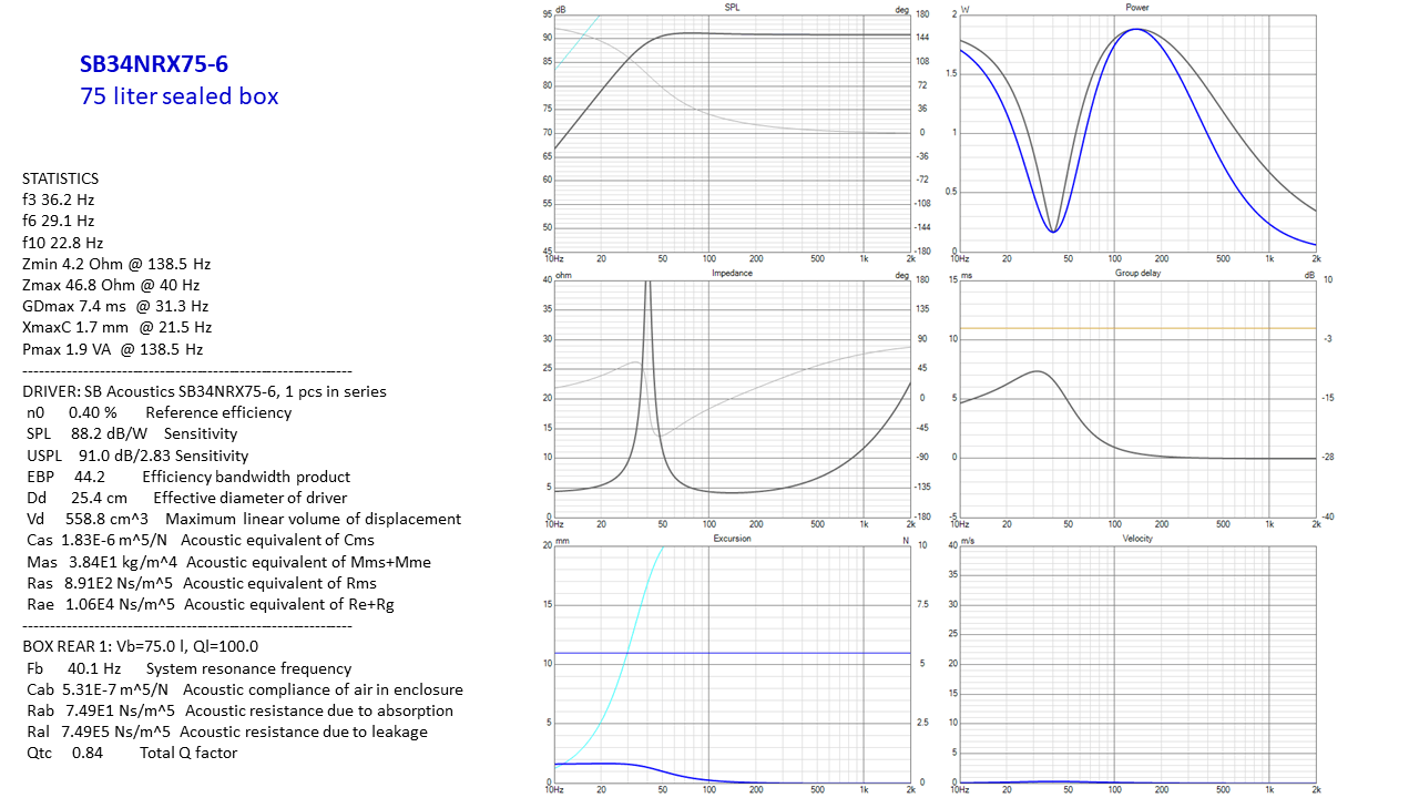

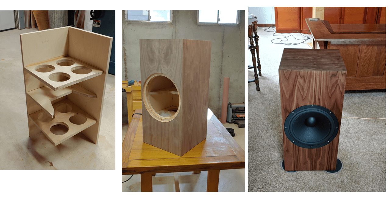

Yesterday, @DualTriode asked (in another thread) that I talk a bit about my woofer cabinets:
https://www.diyaudio.com/community/threads/new-active-3-way-hypex-and-sb.352767/post-7351028
I use the SB acoustics SB34RNX75-6 woofer as my bass driver. I like this driver a lot. The Qts is ideal for sealed box use, the sensitivity of 90 dB/2.83 V is reasonably high for a hifi driver, the Fs is very low, and it has plenty of Xmax.
I knew that my system would be modular, and I wanted to keep the bass cabinets common (along with the speaker stands which contain the Hypex amps), but swap out the mid-tweeter cabinets to explore different options.
My bass cabinets are 75 liters, the internal dimensions are 29” H x 13” W x 12.25” D. I used ¾” Baltic birch plywood for construction, and the front baffle is two layers thick. The external dimensions are 30.5” H x 14.5” W x 14.5” D. I used bulkhead braces above and below the driver, and a partial bulkhead brace behind the driver. Additional bracing was used in the top and bottom panels. The veneer is walnut.

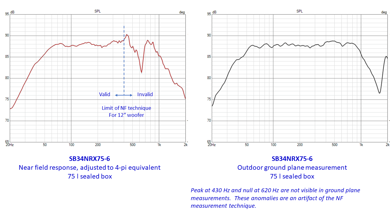

The ideal box volume for this driver is 120 l for a Qtc of 0.71 and Fb=34 Hz. The modelled sealed box performance of this driver in a 75 l box is Qtc of 0.84, Fb = 40 Hz, and F3 = 36 Hz.
The woofer is intended to operate up to about 200 Hz. I have never made gated far field measurements of this box because I did not want to elevate it over 48” high. I always felt it was unnecessary because the polar response would very likely be nearly omnidirectional below 200 Hz, and the polar response below 200 Hz is of limited value due to room modes. For simulation purposes, VituixCad was used to adjust the near field response to 4-pi space using the diffraction tool. I then enabled Vcad to estimate the polar responses.

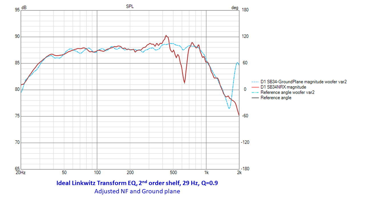

Several years ago I performed an outdoor ground plane measurement to confirm my near field results. The two methods largely agree, although there are small perturbations in the ground plane measurement which are not present in the NF between 30-150 Hz. The most significant difference is in the range above 400 Hz. Given the size of the woofer, the NF method is limited to 400 Hz, and it shows a peak at 430 Hz and a null at 620 Hz. The ground plane measurement, which is valid to beyond 2 kHz does not show these anomalies.

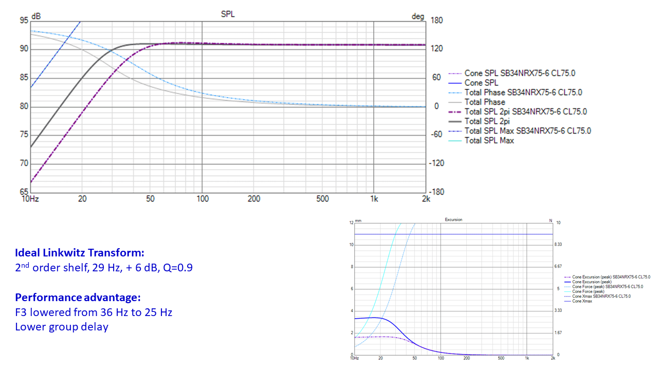

It is relatively easy to simulate the theoretical Linkwitz Transform EQ required to provide an F3 of 25 Hz for this woofer/box. With real world measurements, the actual EQ is a slightly different.
My subjective assessment is that the bass boxes do an excellent job. Upper bass is nuanced and detailed. Percussion is very percussive and dynamic. Deep bass extends way down low. Double bass, electric bass, fretless bass, baritone sax all sound very natural and detailed. Male vocals are convincing. Drum kits sound “right there”. Recently my wife was watching “Interstellar” which has significant frequency content below 30 Hz, and all the windows in the house were rattling in their frames. I have always been open to upgrading my bass system, but anything that might offer higher performance would be much larger, and much more expensive.

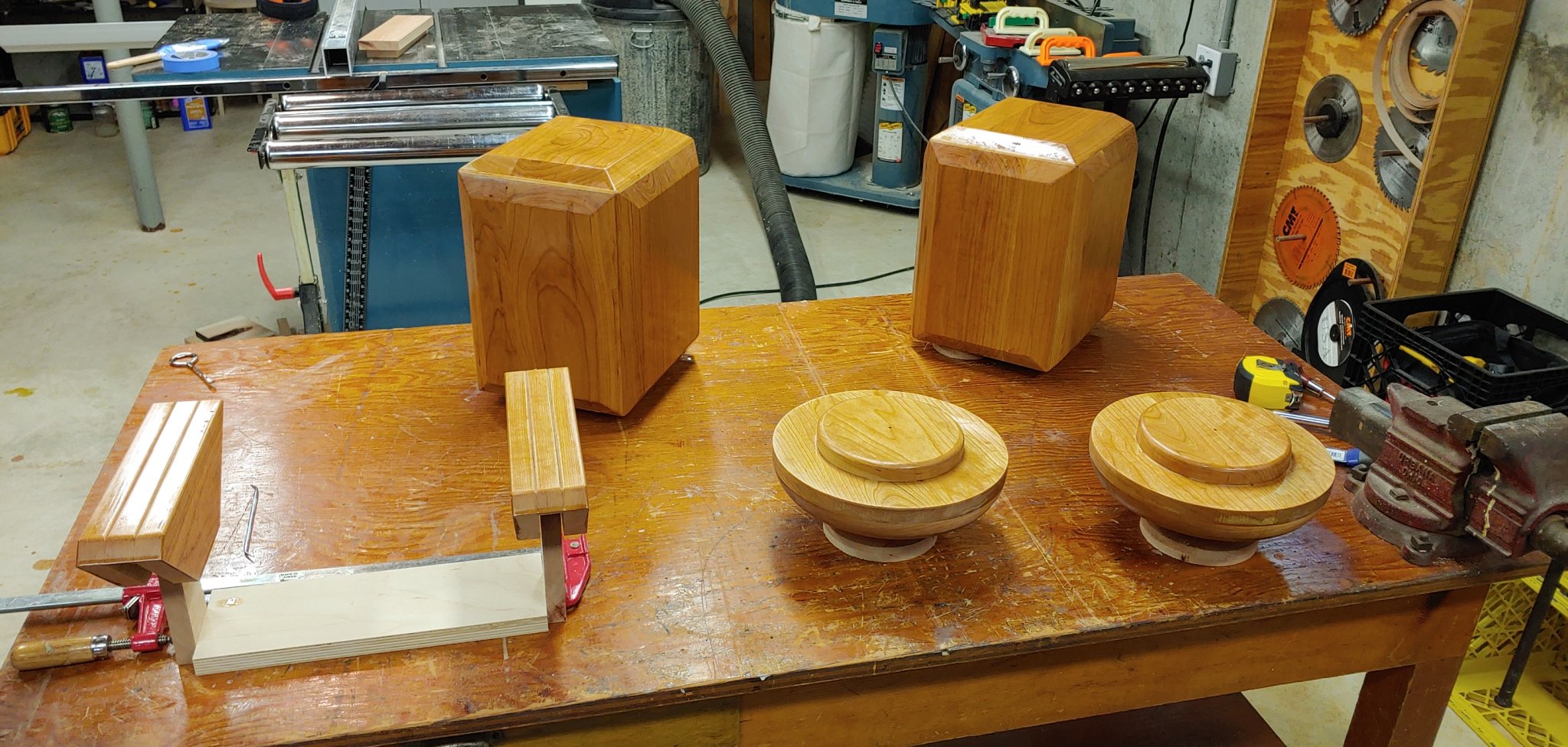

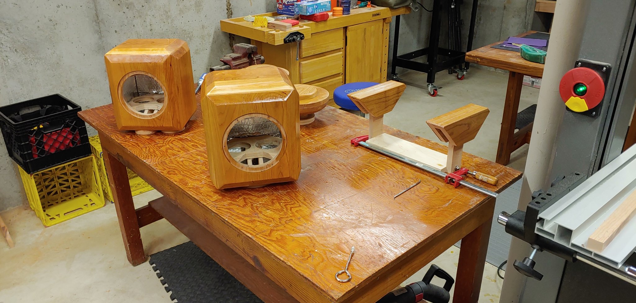

In other progress... Finish work is going well. I use brushed polyurethane, so 3 coats takes 3 days... I have a friend with spray equipment, and he can achieve automotive level gloss finish in a few hours. But I like the simplicity of the brush... 🙂
