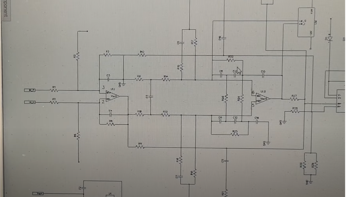

Most of the nc500 kit e.g. Nord etc seem to want to put their fingerprint by "tuning" the input buffer to something they "like". Introducing discrete OP-amps with a "sound" etc. Just so that you are aware of that. Maybe you want a transparent amp and these might not be the best choice in that case...
Interesting. So say I want a transparent or say neutral. Which solution should I go for regarding NC500 and 1ET400A ?Maybe you want a transparent amp and these might not be the best choice in that case...
Discrete op-amps are suppose to be better, that is why Nord is an option I guess.

I just discovered this very interesting thread. I'm not very knowledgeable in electronics but i like so much to do things by myself ;-), so trying to understand what modules to put together in the most propoer way i can.
I'm currently working on a dac/amp box with the Purifi dual mono kit. Don't know yet what the dac will be; soekris 1941 or ak4499 (if i can find a reliable/qualitative module source)?
Regarding the power supply, i was considering the hypex smps3kA400. I know it looks oversized... Do you think it's ok or stupid? Don't be shy ;-)
Shall i consider the Cresnet power supply that id mentionned in this thread? I visited their website, but i could not find any tech data...?
Also, my plan is to directly connect (full balanced) amp and dac. Good idea? Gain and/or other issue?
I was told it's ok, it'll work. Well, if this means i'll get sound, then i know. I would like to do things the proper way.

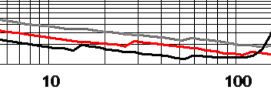

PURIFI 1ET400A
Looking at the distorsion vs output power one can see a pattern of some sort. It looks like the amp is "shifting gears" and distorsion takes a little jump/step. For 8 ohm it's at 15 and 50 watts - as impedance this happens at higher outputs. It seem its not really "monotonic" in its behaviour over as the level changes. Looking at the levels where it happens this should affect e.g. symphonic fortes etc. Is there a mechanism that kicks in more FB as level rises?
Are you worried?

At the moment, there is an uncontrolled rise in the 3rd harmonic at hi level. Multi-loop feedback makes it difficult to understand the reasons. maybe 3rd order distortion correction circuitry gives a 90 ° C phase shift in the operating band, which can result in an increase in odd harmonics.
but it is not exactly
At the moment, there is an uncontrolled rise in the 3rd harmonic at hi level. Multi-loop feedback makes it difficult to understand the reasons....
The third harmonic is at -120db or -130dB, which is not exactly a large amount of distortion.
Second harmonic distortion generation tends to be cancelled by symmetrical push-pull circuity. Single ended amplifiers tend to have more second harmonic distortion.
