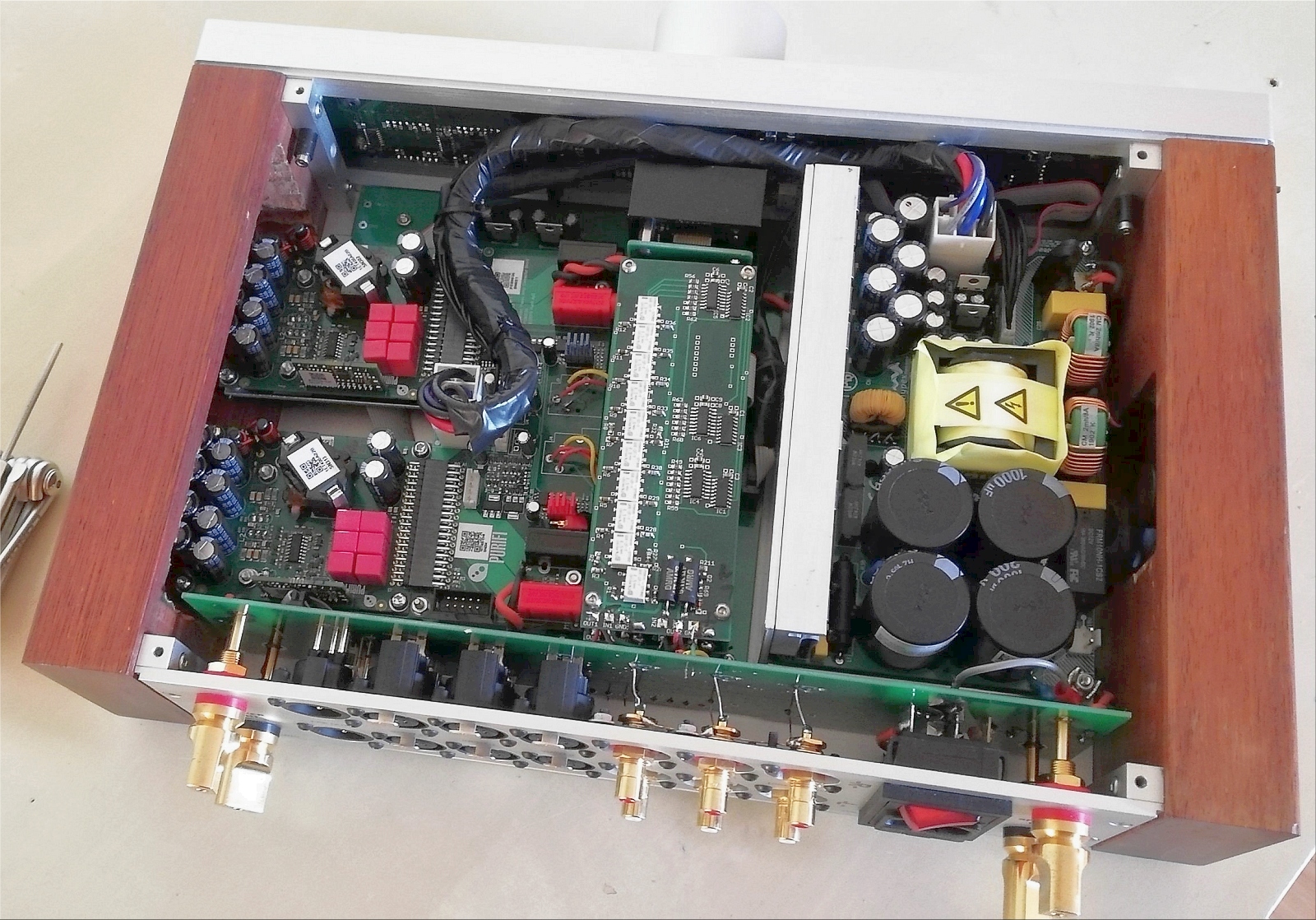

Picture resized, optimized and clarified.By Dudi
Purifi eval board is retrofitted to my previous amplifier, so it has volume control, remote and input selector with RCA-XLR converter. It sounds amazing, but slightly worse than the pure eval board.
1ET400A generates close to zero heat but SMPS1200 gets warm.
(top cover is drilled at SMPS)

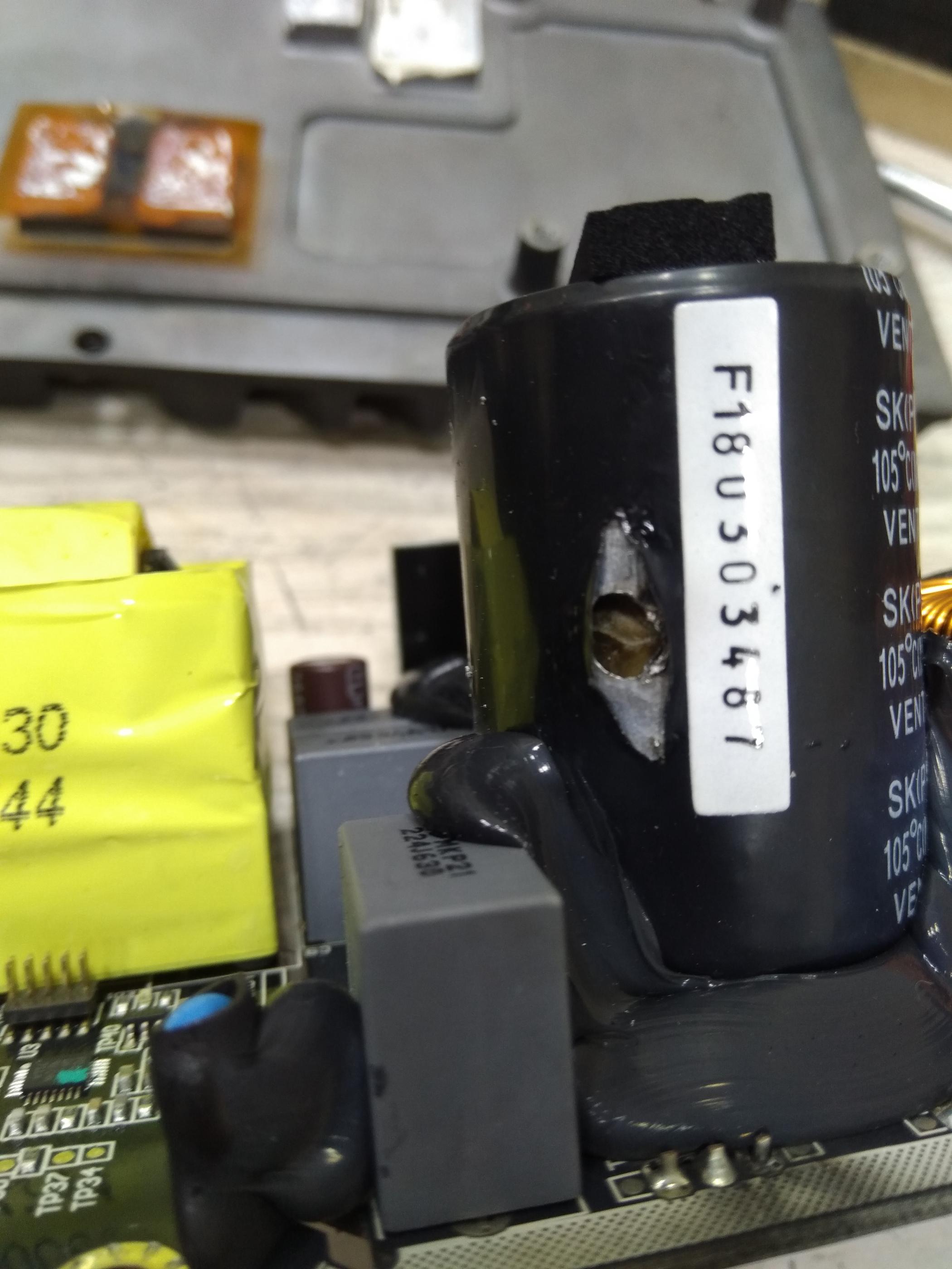

2- If HYPEX SMPS failes, 95% chance is send it to trash, and this is also for most products made by them, I have received countless number of powered speakers uses there modules and SMPS, and they all went to trash. replace full module.

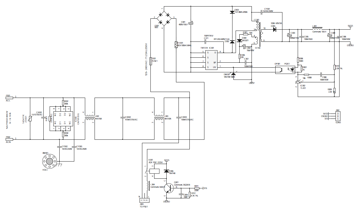

Looking at the Hypex SMPS I noticed that they they using an independent 3.3V isolated logic line to shutdown the the main power supply and for stand-by logic, this is a good technique to command shutdown logic during hard fault conditions (independent from the main supply line) .. I would be interested if your power supplies does this. vie attached an example.
@Reactance
My SMPS has the same thing, except two things
1- The voltage is 12VD not 3.3V, you can regulate that easily to any voltage.
2- I am not using a relay to power ON / power OFF the SMPS
Also, the AUX SMPS is online as long as it is connected to the mains, and that wont affect the main SMPS ON / OFF function.
Also, DC-ERROR, AC-LOSS, FAN
I am not sure if that schematic is from HYPEX even.
Good luck my friend

That is a variant of their SMPS for the NAD M22 schematic. you can find it on the internet.

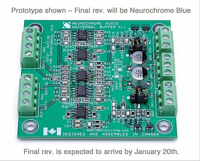

Talking about buffers, just now in my e-mail:
Universal Buffer – Neurochrome
The Universal Buffer is a two-channel (stereo) buffer, which can be configured to provide any of the following functions:
The Universal Buffer offers dramatic improvements in performance over the THAT Driver, THAT Receiver, and Differential Preamp 8x2, which it replaces. Some of the specification highlights include:
- Single-ended (unbalanced, RCA) to differential (balanced, XLR) conversion.
- Differential (balanced, XLR) to single-ended (unbalanced, RCA) conversion.
- Straight-through buffer (single-ended to single-ended or differential to differential).
- Signal inverter.
- Can be configured with gain by adding two resistors.
-140 dBc (0.00001%) THD
< -148 dB multi-tone IMD residual
137 dB dynamic range
> 125 dB channel separation (20 Hz - 20 kHz)
1.7 µV RMS residual mains hum & noise (20 Hz - 20 kHz, A-weighted)
The Universal Buffer requires a regulated power supply in the range of ±2.5 V to ±17 V to operate and draws 65 mA per stereo board.
