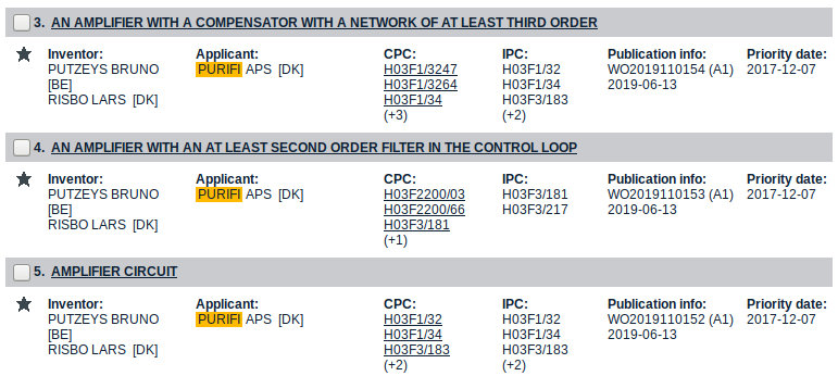

Purifi Patents. EP Register might be more useful but the following might not be complete.

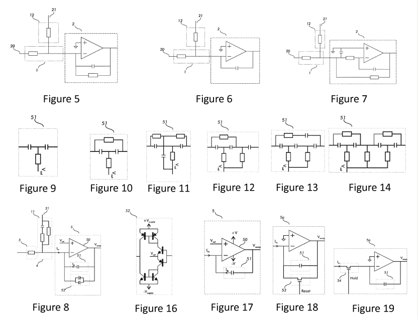

Figure 18: Is that a conceptional sample and hold circuit (used as an example analog to digital converter using the switched capacitor technique)
More like an integrate and hold. Figure 16) looks like the limiter Sous has used in their implementation. You would have to read through the applications, claims and reports to see whether any of them are suggested or accepted as being novel.

Has anybody deciphered those claims? How are the compensator network, gain stage and primary amplifier actually connected?
Register Plus PDF viewer
Then there is an 'operating mode' with the gain stage disconnected??
Jan
I'll be bold and suggest that other than causing your head to implode in an effort to decipher the bulk of it it really is just a cookbook of RC pole/zero networks wrapped around a bunch of amplifiers incorporating various limiters and bypasses dependent and independent of circuit operating modes.
There may be a rhyme and/or reason as to why any particular combination is chosen but it is ultimately just doodling with standard component building blocks. Look at something like average current mode control where switch current is sampled/controlled.
For slope matching the sensed current needs to be integrated. The sensed current comes from the inductor which integrates the switched voltage. You have two integrators, one from the power stage and one from the compensator, which, if both were active at crossover, would result in an unstable system. You introduce a phase bump, RC zero/pole around crossover to the compensator to gain 45 degrees phase margin.
Take any/many SMPS control ICs. You will see that the error amplifiers are designed to saturate/limit just above/below the ramp valley/peak. It's an effort to aid speed of recovery. If you were rolling your own you would start slapping in diodes, zener diodes, transistors around the local error amplifier to achieve the same function.
All these things are known. Practical implementation may/will cause other headaches. According to words elsewhere and indeed in these patents the 'secret sauce' is in the implementation. The loop is apparently third order at some point in its characteristic due to the addition of an extra integrator. Even a second order loop is going to be unhappy if it loses the plot and does not find it again.
As per the white paper elsewhere the circuit with the additional integrator has, unstable, solutions if the loop gain decides to tank which it will when approaching clip. It would appear that is largely down to the modulator gain falling with output level. The chosen solution is to 'knock the integrator out'.

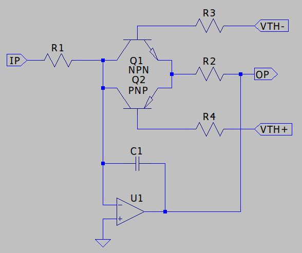

Figure 16) as used by Sous is a limit. Whilst the integration is gone the amplifier is still active in as much as signal is passing through it. Mention is made of transconductance which is the mode in which this limit is acting. It's not a hard, zener/diode clamp so the stage still has a voltage gain. Roll your own version of 16)
Reactance mention Figure 19) which is an integrate and hold. In this case the integrator is taken entirely out of the circuit. It could be bypassed via another route but consider the case when the amplifier is about to or has entered clip/instability.
The integrator output was as a level commensurate with that condition. If you place it in hold then the amplifier will sit just before or at clip. When it comes out of clip the lower frequency, unstable solution, is not present, no integrator. When the amplifier starts operating again, switching above the wrong solution, the integrator is taken out of hold at the, previous, right output level and things carry on.

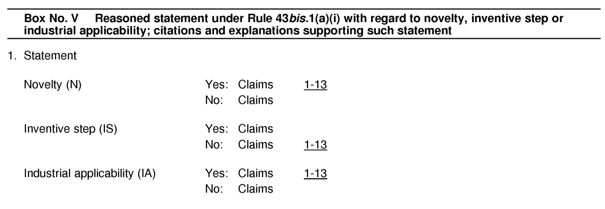

I am uncertain as to how EPO defines Novel and Inventive Step and it would appear that all 13 claims qualify as Novel. However all 13 claims do not involve an Inventive Step. Novel may be application of known solutions to supposedly new situations but if you are using known solutions there are no Inventive Steps.
