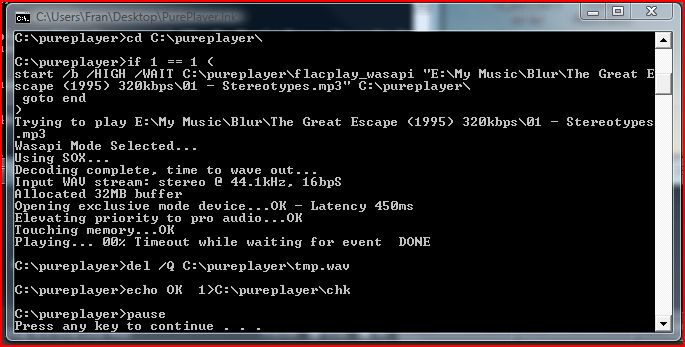

I believe that your soundcard does not directly support 24-96 files (ERROR unsupported format).
Open Control Panel\Hardware and Sound\Sound\Properties of the soundcard\Advanced. Is 24-96 on the list?
I have a M2Tech Evo and works with 24 96 files, the same file plays perfect in foobar, and plays in Pureplayer without Wasapi.
I tried it again with an mp3 file. Basically I get the same problem.....
See the line where it says:
"Playing......00% Timeout while waiting for event"
It pauses here, obviously waiting for something that isn't happening and then it stops.
Untick wasapi and it works fine..... I still think that this might not be anything to do with your player, but more likely something in Vista>>soundcard.
Fran

The Wasapi implementation in PurePlayer is the one that Microsoft recommends.
I believe that problems are related with soundcard drivers and Wasapi.
A new version will be released soon with some workarounds and better debugging features...

Firstly, Great work with the player
I am using Win7 32bit Ultimate
Works fine in waveout and wasapi with the onboard soundcard
With both my Hegel HD2 DAC and Creative XMod (both USB) wavout is fine but when wasapi is ticked I get the "Playing......00% Timeout while waiting for event" problem
Hope this helps a bit

I installed on my notebook with Window 7 pro 32bit. Load file with flac keep getting processing and nothing comes out for a while and stops. I use the build sound module from the notebook for testing first and will use external USB DAC once it is working. Clicked the command window but it keep flashing(open then close..again and again for a short while) and cannot read anything out of it. Same problem with wav files too.
It works great with my Window XP.
Any hint?

This happens with Wasapi checked or not?
Did you copy the folder as c:\pureplayer?
Sounds like you have spaces in the path.
I have check the path and it is just as specified, no space. I didn't have Wasapi checked.
I will try to delete the whole thing and copy it again (re-install it) see if it works again tonight.

Dear npetralias,
I think I find the problem, seems like pureplayer had some issue in opening files with name in Chinese characters under win7, I renamed the file to English and it played fine. The problem files works fine under XP.

It has to do with your Regional and Language advanced settings (control panel).
Chinese characters are not supported from command promt, that's why pureplayer won't work with them. Please try to fix it, if you have trouble let me know. Thanks for the feedback.
