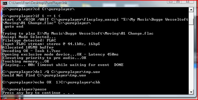

Please edit the pureplayer.bat file and add a pause before exit like this:
:end
del /Q %~dp0tmp.wav
echo OK > %~dp0chk
pause
exit
Then check both Wasapi and Show commands options, uncheck the Repeat All option and play the file. Is some error displayed in the cmd window after decoding?
Just tried that there now and this is what the command window shows:

C:\pureplayer>del /Q C:\pureplayer\chk
C:\pureplayer>set str="E:\Musica\Journey\(1978) - Infinty [2011 Friday Music 180
g LP; 24 bits 96 Khz]\A2 - Feeling that Way.flac"
C:\pureplayer>set ext=lac"
C:\pureplayer>set pre="E:\Musica\Journey\(1978) - Infinty [2011 Friday Music 180
C:\pureplayer>set ext1=lac
C:\pureplayer>set ext2=ac"
C:\pureplayer>if "E:\Musica\Journey\(1978) - Infinty [2011 Friday Music 180g LP;
24 bits 96 Khz]\A2 - Feeling that Way.flac" == cd (
C:\pureplayer\playcdtrack.bat 1 C:\pureplayer\
goto end
24 bits 96 Khz]\A2 - Feeling that Way.flac" == cdall (
C:\pureplayer\playcdall.bat 1 C:\pureplayer\
goto end
C:\pureplayer>cd C:\pureplayer\
C:\pureplayer>if 1 == 1 (
start /b /HIGH /WAIT C:\pureplayer\flacplay_wasapi "E:\Musica\Journey\(1978) - I
nfinty [2011 Friday Music 180g LP; 24 bits 96 Khz]\A2 - Feeling that Way.flac" C
:\pureplayer\
goto end
Trying to play E:\Musica\Journey\(1978) - Infinty [2011 Friday Music 180g LP; 24
Wasapi Mode Selected...
Filetype detected: FLAC
Input FLAC stream: stereo @ 96.0kHz, 24bpS
Allocated 156MB buffer
Decoding OK - Took 2.1sec
Opening exclusive mode device...ERROR unsupported format
C:\pureplayer>del /Q C:\pureplayer\tmp.wav
No se pudo encontrar C:\pureplayer\tmp.wav
C:\pureplayer>echo OK 1>C:\pureplayer\chk
C:\pureplayer>pause
Presione una tecla para continuar . . .
I believe that your soundcard does not directly support 24-96 files (ERROR unsupported format).
Open Control Panel\Hardware and Sound\Sound\Properties of the soundcard\Advanced. Is 24-96 on the list?
