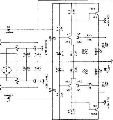

I have one more question for Nelson:
The output voltage for the finals are 2* 39 volts, no load.
The output voltage of my circuit is only 2*49 volts for the preamp ;
I would need a few more
ie :52.0 volts
in the A75 Power supply schema here after
I read that the differential amplifier had 5.5 gain so 9.1 zener diode gives
5.5 * 9.1 = 50.05 volts
How could I simply modify the circuit gain built with the original values to reach 52 volts ?
I don't know any thing about diff's
Alain.

Alain Dupont said:
How could I simply modify the circuit gain built with the original values to reach 52 volts ?![]()
Try to play with R10 (2k2). The simplest way would be adding a parallel trimpot (100K or so) and see what this does.
Also, under the load your rails might go lower than 49V so maybe what you are getting presently at front end is high enough?
Peter,
>Try to play with R10 (2k2). The simplest way would be adding a parallel trimpot >(100K or so) and see what this does.
I appreciate, my knowledge of diff's and digital circuits is near the grass!!
I am here to learn a lot.
>Also, under the load your rails might go lower than "39Volts" so maybe what
In fact they will because of the 0.5 Ohms 20watts of the CRC's
I just wanted a little more security. and 50/52 volts sounds good to me !}
Thanks.
Alain.

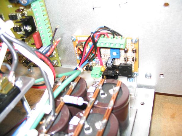

Peter,
The finals 2 power supply's gives 2* 45 volts with "no load",
I had to replace the 6amp fast blow fuses ; they blew up ; but 10 amps are OK now...
I have soldered 75 K ohms in // with R5 and R10
which gives 50 volts for the pre.
Do you think it's enough ?
Alain.

I don't remember exactly, was it 5V or 10V difference between output rails and front end supply.
As to the blowing fuse, are you using any thermistors on primary?
With such big toroids and so many capacitance it's nothing unusual. Even with thermistor, I was using 10A fuses.
Peter,
Thanks , I go with these values. I think the voltage will drop of 4/5 volts under load.
I will install the mosfet's on the front end tomorow,
and let the fun begin...
Now I am willing to finish the cabling of the standby relays
