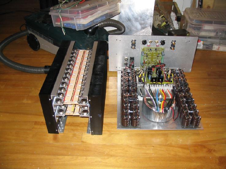

But, at this point in time, why build an A75 instead of an Aleph 2?
Parts on hand? asthetics? ability to drive low-impedance loads?
Works better in your bi-amp/tri-amp setup?
I'm not trying to slagg you off, was just wondering. The Aleph 2
seems to follow the PassLabs ideal of simpler circuits - better sound.
Please don't take this wrong... it was worth it for you to build this
amp, just for the lovely pictures!

Yes, the work is indeed top notch, on equal level with best that we've seen here. So you qualify for DIYer.

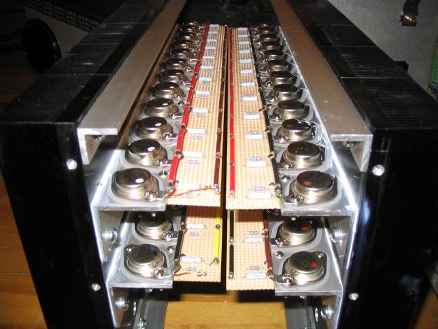

Building A75 brings slightly different pleasure than Aleph. Whoever never did it, don't know what I'm talking about: all those TO-3 devices mounted in rows and there are 24 of them per channel . I'm still using my A75 amp for subwoofers.

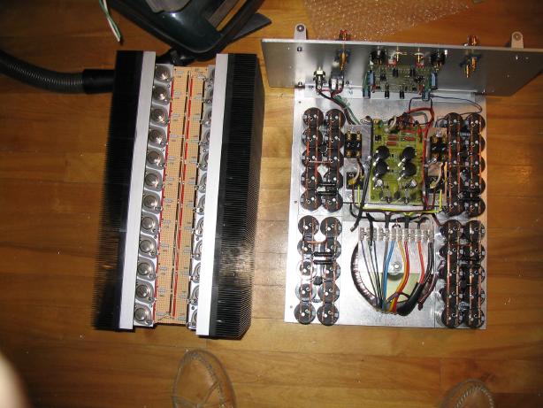

Because the Aleph X was not created at the time of choice, second I wanted Power!
Also I needed to drive my electrostatics speakers, Martin Logan Aerius i go low at 1.7 Ohm >15kHz
This A-75 is built for 80/100 watts pure class A.

Special thanks: to Peter Daniel who sold me the cap's and 750 Plitron transfo's
to Norman Chow who sold me the 48 TO-3 Mosfets lost in his closet !

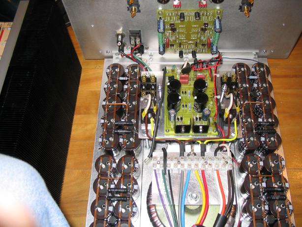

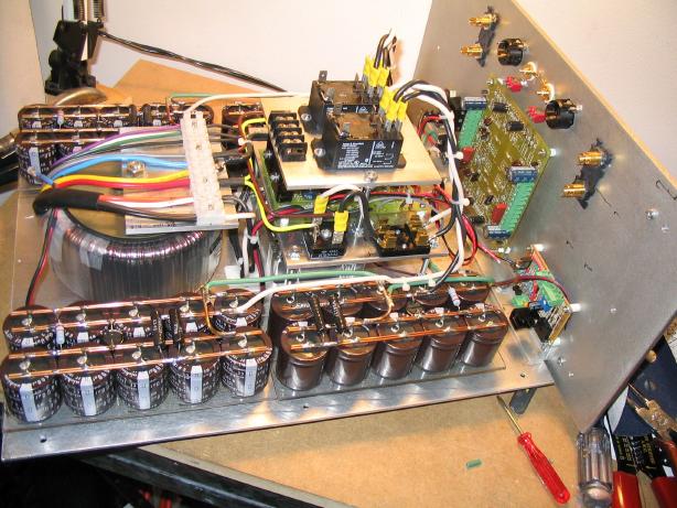

To be done: install the PCb for regulation and temperature security (2 big 24DC relays 30 Amps for standby ) and fan supply
Install the mosfet's on the pre PCb, work the cabling...
Then the fun will start , put the scope on and finish the tests....
Future projects: One X-BOSOZ with CCS and Phono Pre. integrated
with separated power supplies ; 6/7 input's with 2 balanced and Tape in/Tape Out
+ 2 output 1 balanced + 1 for subwoofer...

All taping's are finished ; I bought a new tap, comming from Vermint tools
but not top quality...
The power supplies are already working.
So tomorrow I will install the mosfet on the pre pcb and will see...
