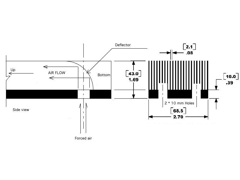

Could you precise your point, please. I don't know anythig about fluid dynamics. I am interested in your idea.
Regards.

Alain Dupont said:
Bricolo,
The air will keep the direction that the reflectors give to it.
So with 45° reflectors, the air will run out of the heatsinks
with a 1/4th round reflector, the air flux will be oriented to run the long of the heatsink

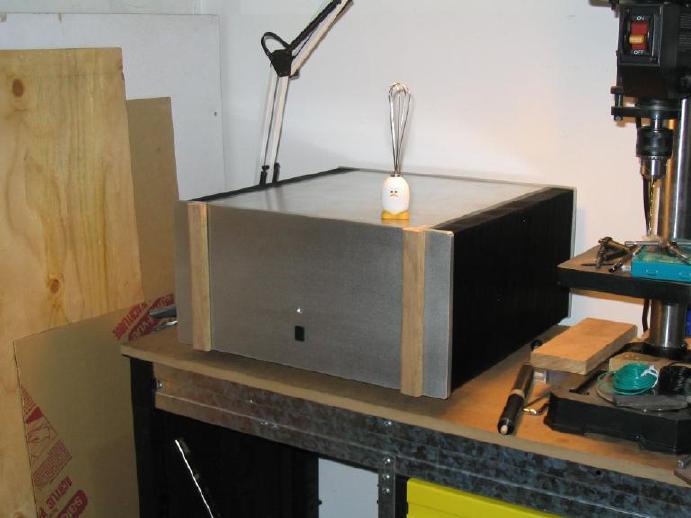

Alain,
In the piccy with the fan in it, are there four hex nuts attached to the chassis to hold that platform up over the fan? I'm just curious to know how they're attached to the chassis if they are. I know it's not really a major question, it just annoys me when I see something and can't work out how it's being done!

eeka,
At this time there are only 4* 10-32 by 1" long bolts to hold the bottom pannel, the future feets will be round aluminium 42 mm diameter and 24 mm height.
the fan is a very silent model with ball bearings ; that will work between 7 to 10 volts (its a 12/15 volts DC model)
