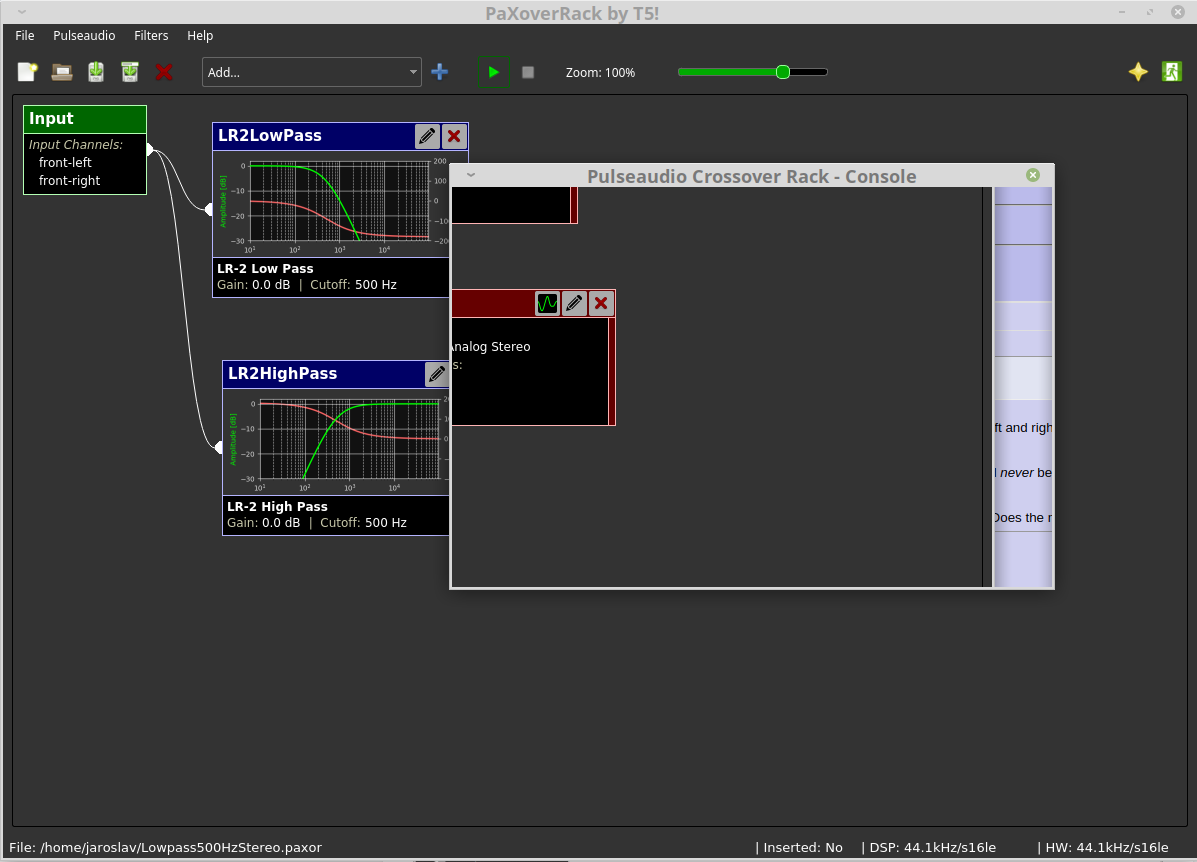

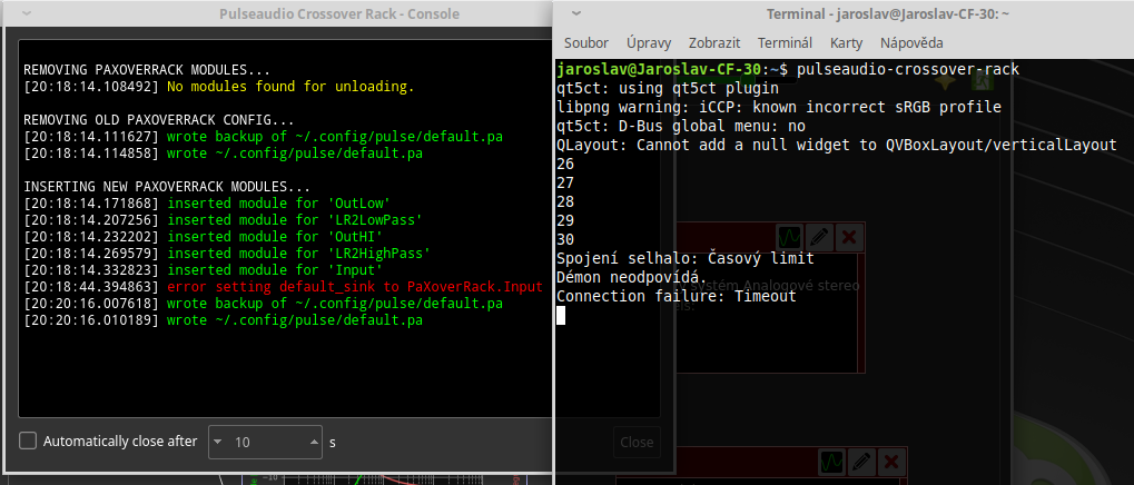

Maybe I was unclear - the GUI tries to display the console, but it is not displayed, it is only a transparent frame and the GUI will stop responding. I do not see why it should not work🙁
Well, I'm afraid there is nothing I can do to prevent this. Never happened to me even once though!
OK, most probably it is the computer sound card - it is an old one - Toughbook CF-30. I actually have another PC with the same Mint version, I will try that if it has the same problem or not. I am also waiting for another soundcard to arrive. If I find out something else, I will post it here, otherwise I will consider it as my HW issue.
I cannot imagine a GUI problem is caused by a sound card. That laptop uses Intel HDA (PCH) with a pretty stable driver.
IMO the problem is a combination of the GUI stack version + some error deeper in the UI/PA stack on this particular machine. Supporting wide range of PA + window managers + pyQT versions + all the other dependencies is very difficult, without having access to the actual problematic machine. Hats off to Tfive but problems like this are almost impossible to iron out. We all know how e.g. source code of games looks like, with workarounds for all the software stack/graphics hardware bugs.

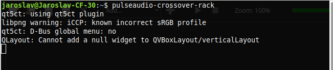

Strangely enough, it fails in the same way on my other laptop (HP-8530W). I updated everything today, still the same. There is a picture on how the failure looks like and a log from pulse-audio - not sure if it is correct - but it should see trying to load the scheme and then a restart.
The log file does not show any traces of module insertion by PaXoverRack. So i presume the GUI crashes when opening the console window. This should not happen of course but there are no exceptional components on that dialog window, it's just a QTextEdit with rich text enabled, a QSpinBox, a checkbox, a label and a button. Nothing fancy. You can try starting PaXoverRack in a console window, make sure the output is visible beside the GUI windows and maybe you'll get some meaningful output there...

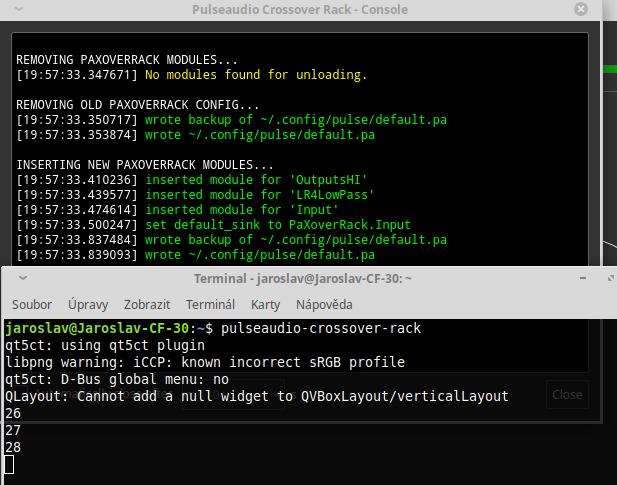

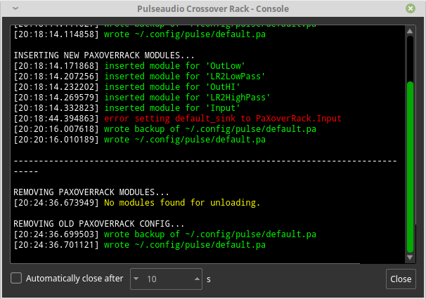

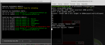

Here are some screenshots with the console.
1. Startup of the program
2. Single stereo filter loads OK and works
3. Loaded problematic filter
4. Larger screenshot from above

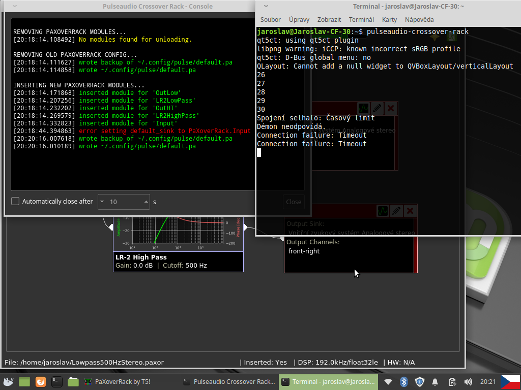

The two Czech lines are:
Connection failure: timeout
Demon not answering
5. Error messages while trying to play audio
6. Stopped and unloaded
Edit: Added log from this test - the log actually comes from the test before I repeated it and took the screenshots.

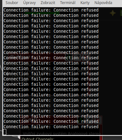

The log still shows no traces of whats actually going on. You can contact me via email, threema or telegram for a debugging session some time. Be warned that this will require full access to your machine via teamviewer...
I have finally found out something! The only thing that the two computers had in common was, that I installed the CZ version on them. I have just tried the live USB in default English and the file that crashes in the CZ version works without any problem in the English version. Maybe it could have the same problem in other language versions (could it be the decimal dot/comma issue?). However for me the problem will be solved by installing the English version.
No, i have a German locale set. I completely ignore l10n stuff and always use a dot for decimal values. But I suspect a Unicode issue with the rich text edit. Will see of I can reproduce this in a virtual machine with locale set to Czech...
Just prepending LC_ALL=czech to the binary with having pre-generated czech locales with locale-gen with the cs_CZ.UTF-8 UTF-8 line uncommented in /etc/locale.gen could IMO suffice for testing.
The same for switching all the messages to english instead of czech which would IMO fix the problem for Jaroslav:
LC_ALL=C pulseaudio-crossover-rack
