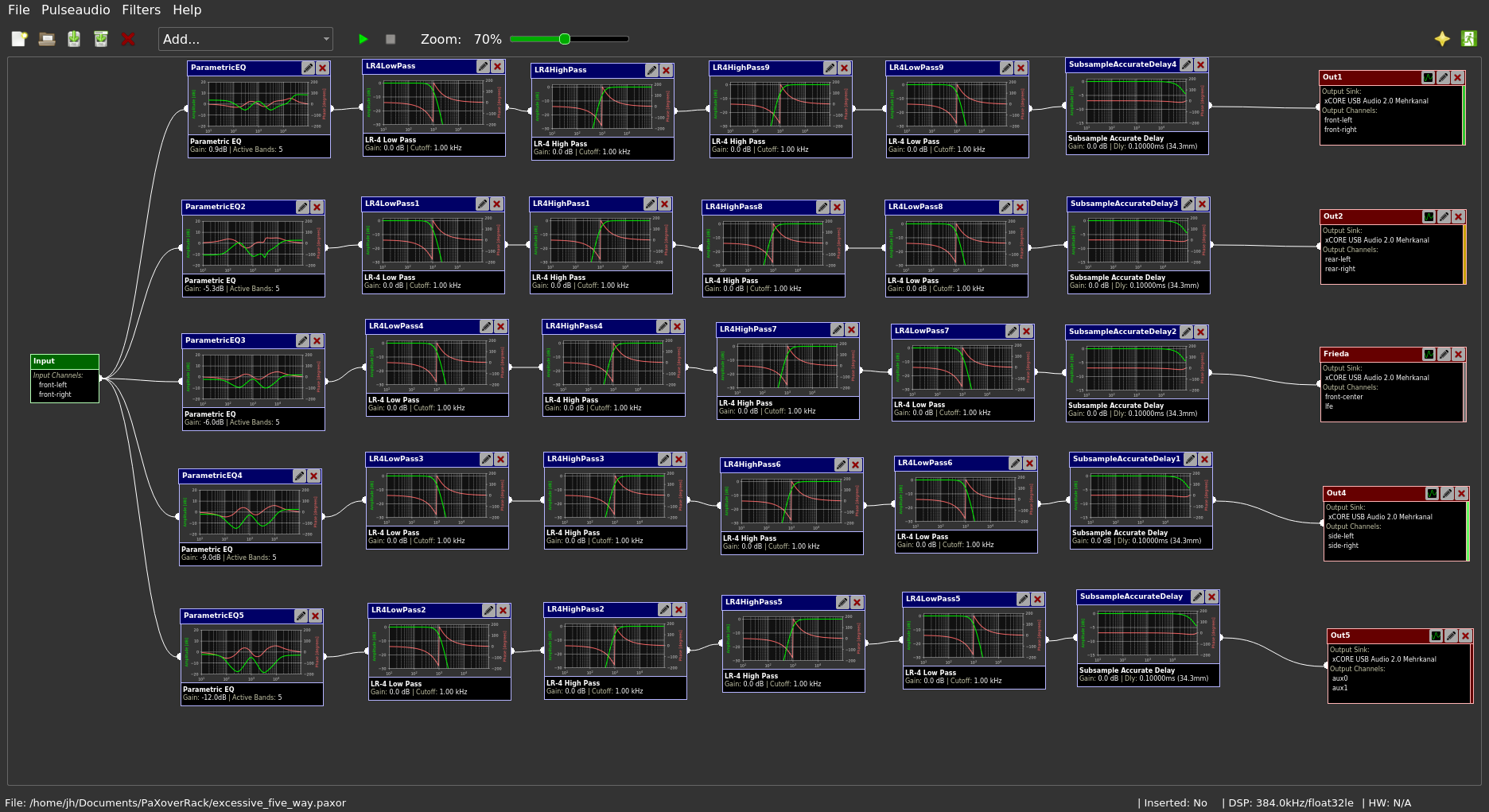

Performance testing...
For all those who have asked about performance etc.:
The other day at a friend's we did some brute-force performance testing with a modified DIYINHK multichannel XMOS USB->I2S converter with our custom firmware, using 5 I2S lines, i.e. 10 channels running at 192kHz (The screenshot says hardware not available, as I made the screenshot at home where the device was unavailable to me). The pulseaudio backend was running at 384kHz, sample format was float32le.
The file packs five ways of stereo output with each channel using a fully activated 5-band eq, two LR-4 low- and highpass filters each and a subsample delay.
The CPU usage varied a bit, depending on the current boost clock of the CPU, which is a Intel i5 8250U laptop processor with 4 cores, 8 threads, base clock of 1.6GHz and max boost of 3.4GHz. As I recently was made aware of the architecture of pulseaudio makes all the LADSPA plugins run in the context of the ALSA output thread, so only one CPU core is used for DSP stuff! Keep that in mind when designing a crossover PC...
So, after rambling on quite a bit, what were the numbers? Using the speex-float-1 (default) resampler the CPU usage peaked around 45% on one core. When using the soxr-vhq resampler performance peaked around 55% on one core (had to recompile pulseaudio from source to do that, as linux mint 19.x still does not ship with SOXR enabled 🙁)
Please don't ask about specific processor combinations and do the math yourself... 😀 But what I take away from this is: even a medium range, low TDP processor (15W in my case) should pack plenty of power for even a sophisticated crossover setup!
