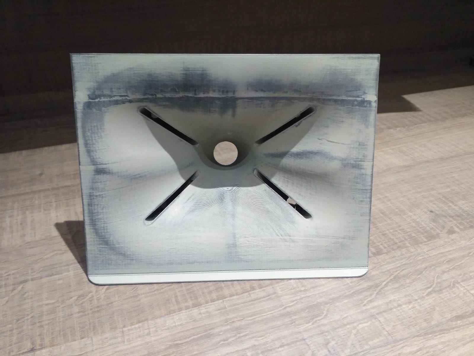

I do use VNC for remote desktop. Not for everyone, but OK for me. I am a loudspeaker diy-er. I change loudspeakers once a year at least. And tweak the filter/diy for at least 6 months (on and off).
My 3D printer guy had some problems with head hitting the print, first one around half abd second one at 80 %. He printed and glued the rest, did some filling and sanding and here is the result. The second one will be printed in two pieces from the beginning.
