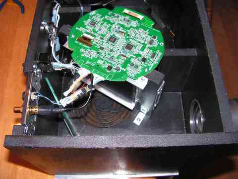

can anyone tell me where/how to wire a av/rca cable to the psone and video/audiolike aad1972 did on his

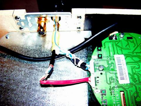

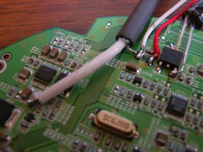

I have attached a picture of how i added a "monster" cable to use for my video input.
I soldered it directly to the board and the picture is much clearer then going through the 3.5mm jack.

for the audio you use the smaller white and red wires which are the signal or + wires, use the black again as the ground.
the sound sucks on it though! I would recommmend a seperate amp for audio.

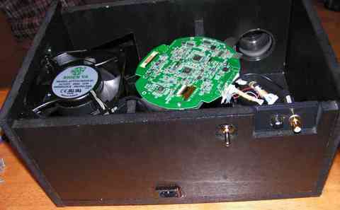

if i decide to just wire the second plug on the right to video like in that pic i posted to a rca male do you know what wires to use theres 6 on each plug not sure what one is video to the rca male and what i do with the other wires. only need 2 blue 2white for left / right audio and 1 for video right?
What are you going to do with that huge halogen lamp in the first picture.
That lamp will not work :whazzat:
You need a "point" light source like a flood bulb or a par 30 bulb.
That halogen will cook your lcd in no time :hot:
just my opinion though
