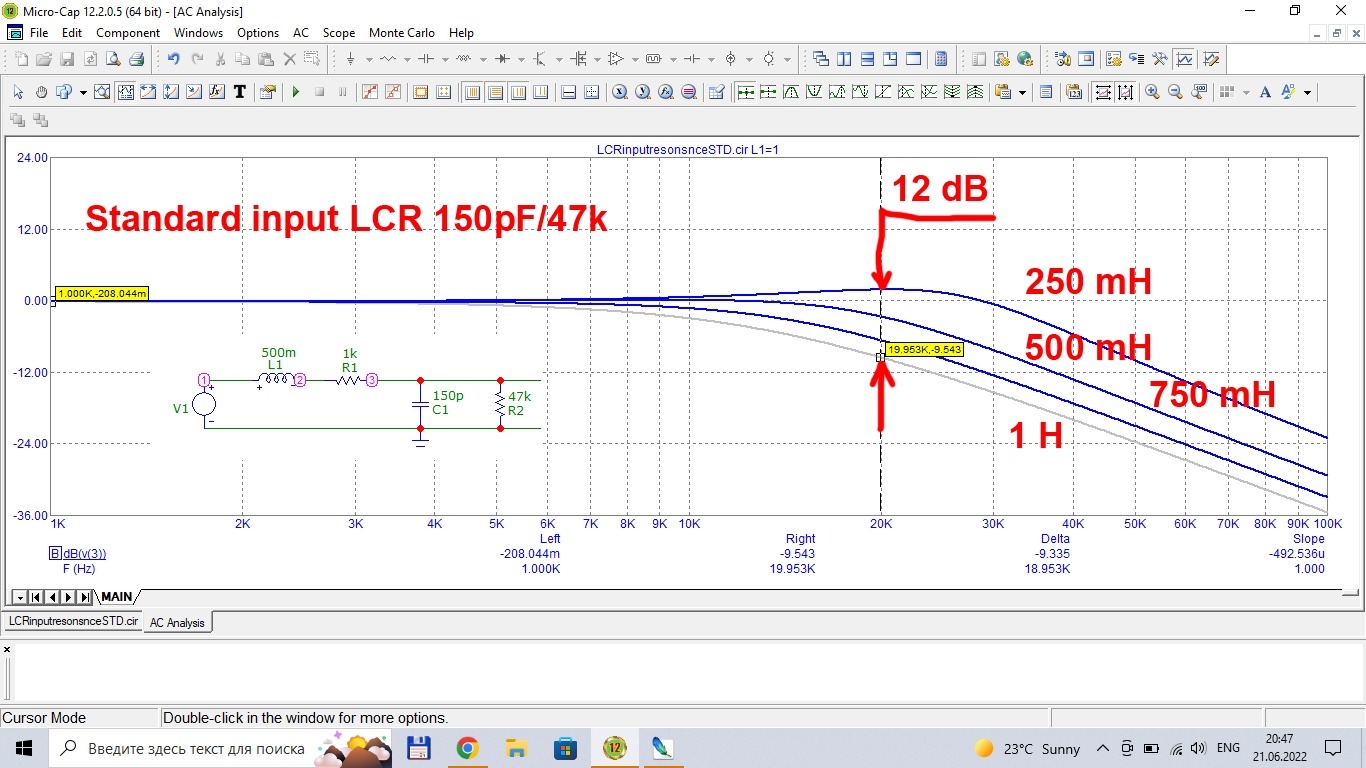

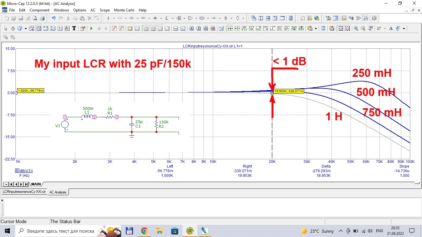

Yes, it is really useful to not needed adjust C for different carts, because 99% audiomelomans have no 50 kHz sweep test LP (but I have!Benefit - there is no need to select C.
I use Ohm`s as well as Kirchhoff/Johnson/Nyquist laws, Microcap12 sumulation, standard metrology and real measurements using Ortofon/HFNRR/JAES/DIN test disks [Nick uses his own definition of accepted terms and principles

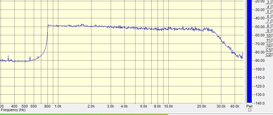

Goog Cart has no mechanical resonances. I have measured dozens of modern cartridges and have not found any significant mechanical resonances in any of them. Of course, there are old cartridges with an overweight cantilever and a large stylus mass, but if they create mechanical resonance, you should simply throw them in the trash and not wear out the grooves of the records too intensively.You heavily disappoint me in pretending that a Cart is only composed of Lcart and Rcart.
Everything is clear with the "electrical" FR, here the 150K load has a clear advantage. But it is not clear with complete frequency response, including the mechanical properties of the cartridge. I do not have a test LP up to 50 kHz, so it would be interesting to see the real frequency response of different cartridges with a load of 150K.See attaches: mine delta 1 dB, standard 12 dB.![]()

See my video @ #141, I have almost all test disks with 50 kHz sweep and made hundreds of FR measurements of a dozen modern carts like Ortofon, AT, Benz micro, Sumiko etc. Noone has any peak due to mechanical resonanceI do not have a test LP up to 50 kHz, so it would be interesting to see the real frequency response of different cartridges with a load of 150K.

The only real difference between MC and MM is a LCR resonance of MM. With my proposed 150k\25pF input instead of "standard" 47k\150pF the MM-МC difference disappears, except 20 dB more EMF with MM. I focus on the fact that MC cartridges do not suffer from “mechanical resonance” despite the fact that their cantilevers and needles in modern models have the same equivalent mass as MM cantilevers and needles. But MM has 12 dB/octave rolloff upper LcartCinput resonance while MC has not resonances at all.MC cartridges give this response, and we've come to accept it as normal. For MM cartridges the choice between LCR loading optimized in the classic way, to flatten in-band response at the expense of a four pole ultimate rolloff, or some other loading

Do you like to listen to sweep tone? Please, Ortofon test disk sweep 800 Hz - 50 kHz through a cartridge with a spherical stylus and my phono stageWe need graphs, not listening 🙂
