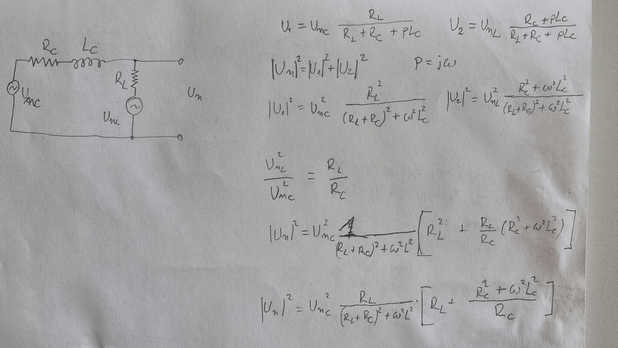

But in your analysis in the video you multiply the noise curent only to cartridge impedance ignoring the input resistor (47k or 150k). This introduce significant error at higher frequency.The noise current generator of 47k resistor is located in parallel with 47k resistor, and noise voltage generator is located in series with 1k cartridge resistor. Don`t you know Thevenin/Norton + Kirchhoff ?
You have to include the noise current flowing through the load resistor. This gives the total Enoise + Inoise integrated over 20Hz to 20 kHz of (0.5H + 1k)//(47k + 100 to 200pF) of circa 3uV. The higher the load resistor value, the greater the noise.
This is the inescapable noise. You can use a JFET input stage to minimize the noise current contribution but you can’t get much better than 3uV noise.
I made a quick and dirty analysis of the Johnson's noise at the phono input. Excuse me for bad handwriting.
RL - load resistor (47k or 150k)
Rc - cartridge resistance
Lc - cartridge inductance
Unc - noise voltage from cartridge
Unl - noise voltage from load resistor
It superimposes voltages from two sources of Johnson's noise by summing modulo squares of two contributing voltages at the input. U1 is noise voltage at the input coming from cartridge, U2 noise voltage from input resistor at the input.

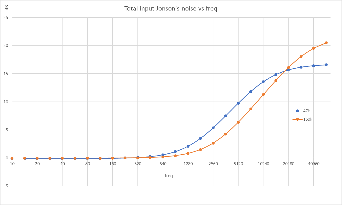

Using the final expression, I got these charts showing noise power referenced to Johnson's noise just from cartridge resistance Rc.
For the sake of simplicity I didn't included input capacitance in calculation.
Diagram shows that 47k input is somewhat noisier (2-3dB) at mid frequencies. At higher frequencies, 150k takes the lead.
