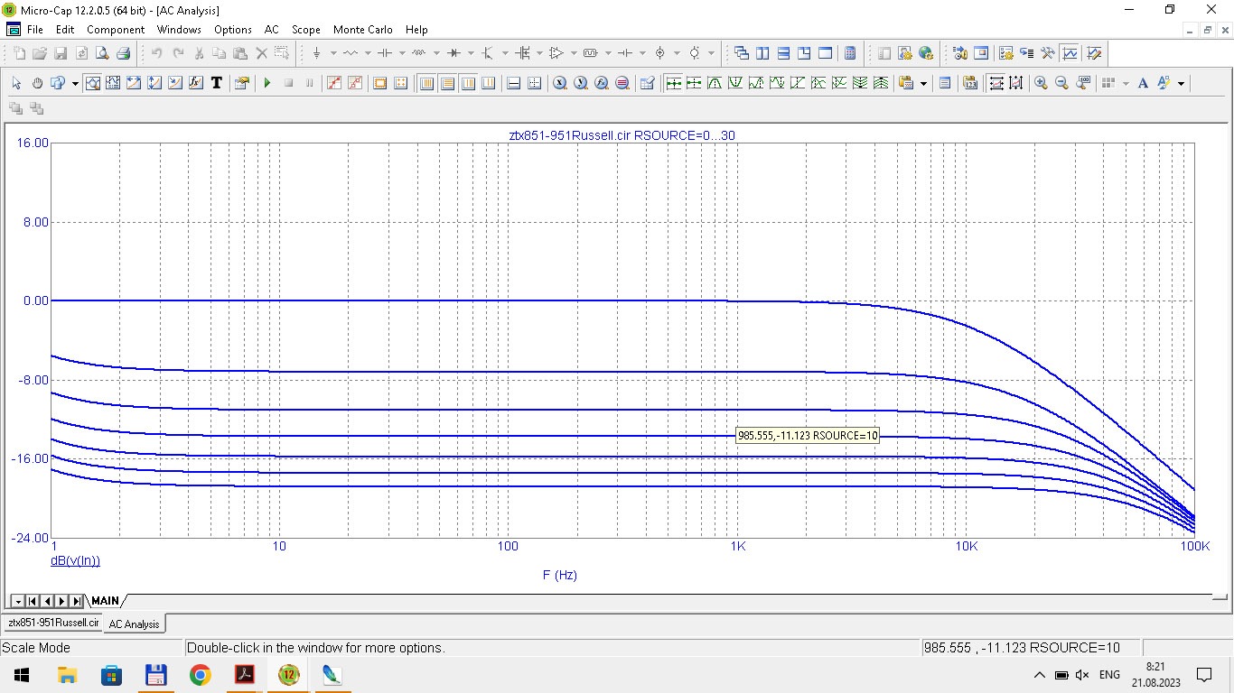

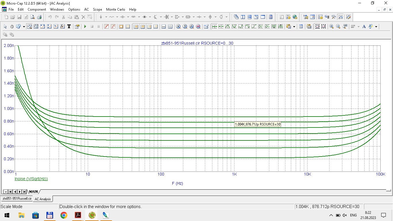

Using the final expression, I got these charts showing noise power referenced to Johnson's noise just from cartridge resistance Rc.
For the sake of simplicity I didn't included input capacitance in calculation.
Diagram shows that 47k input is somewhat noisier (2-3dB) at mid frequencies. At higher frequencies, 150k takes the lead.

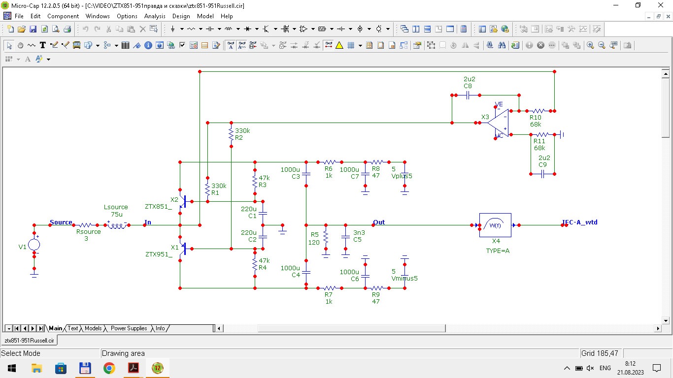

My circuit has transadmittance output stage with overall NFB RIAA loop to the input stage. Therefore I have not any problems both with linearity and headroom (the circuit has almost constant loop gain 40 dB from 0.2 Hz to 80 kHz) as well as noise. If you dump 75 uS from input NFB you reduce the HF overload margin and at the same time revive the Miller input capacitance.
