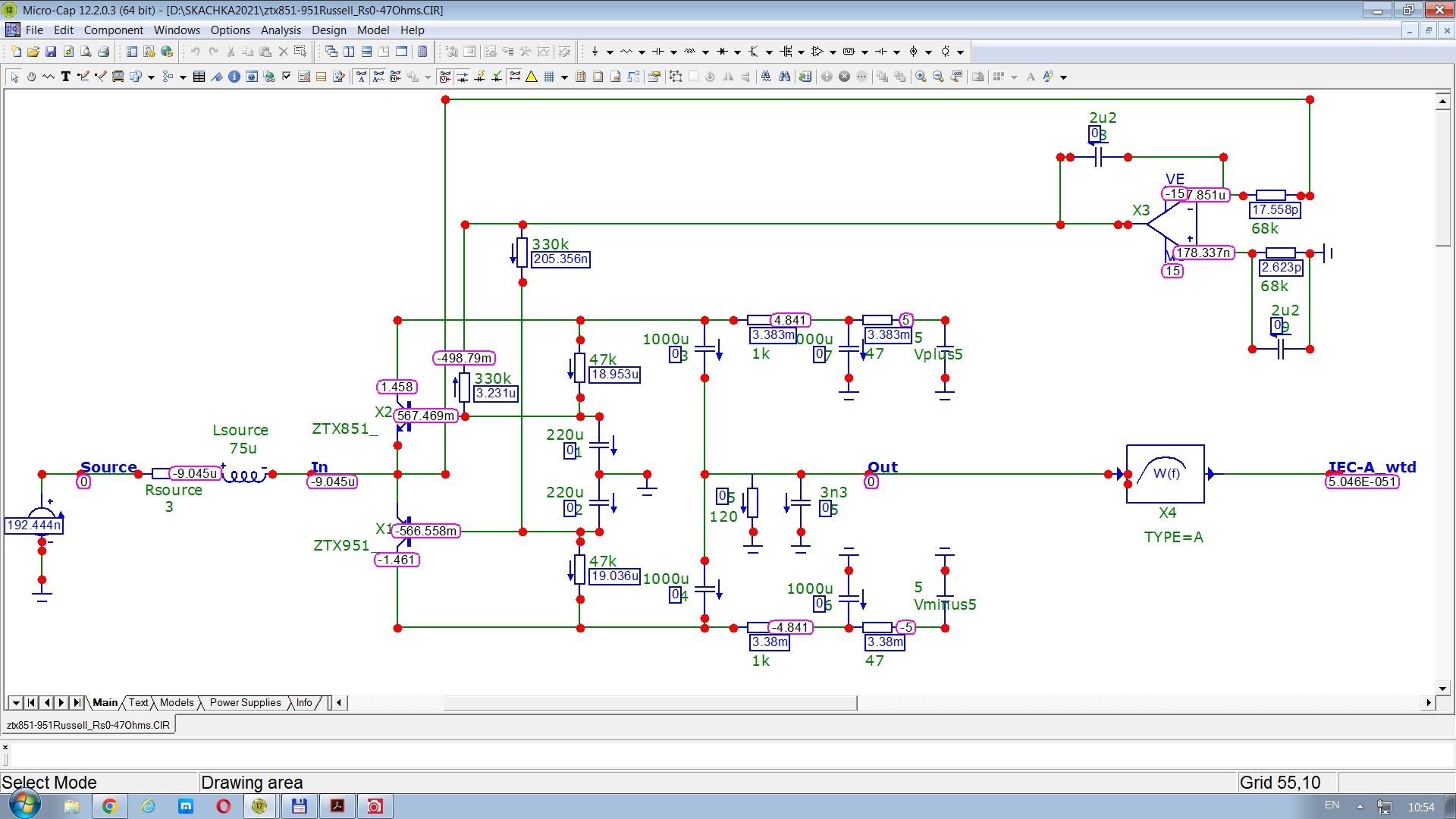

I use for Microcap sumulation MC preamp circiut published in AXpress Feb 2021 page 64. I only add @ input Rsource=3 Ohms and Lsource=75 uH as typical for MC cartridge (as mine Benz Micro Glider M2), because "input shorted" condition is not a real, particularly for noise definitions.is it last one? With or wo input defender?

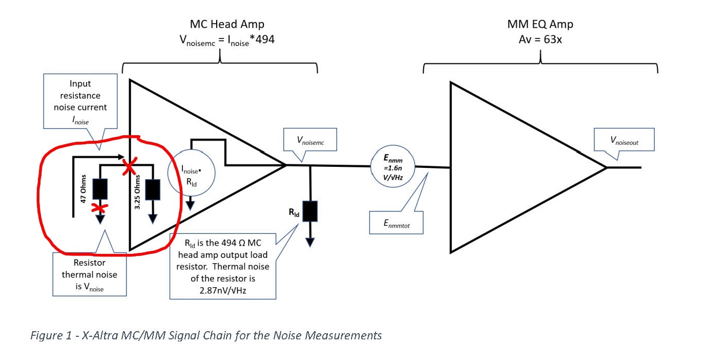

on the X-Atra MC/MM MC input, the input is responding not to voltage but to current. You have to convert any source resistance thermal noise voltage to an equivalent noise current and then do the calculations. The equivalent thermal noise contribution of the MC input stage was calculated, simulated with LTspice and then measured and the result is <250pV/rt Hz RTI contribution from the amplifier. As I explained in the document below, to verify the equivalent thermal input noise, the measurements were done at two extremes - one with Rsource = 47 Ohms and the other with the input shorted so Rsource = 3.5 Ohms (this is 0.5*re'= 0.025/Ie). Since the MC stage gain is dependent upon Rsource, by taking this into account, the measurements accurately reflect the total signal chain gain and thus output measured noise. This allows the measured output noise to be accurately referred to input (RTI).
With a transimpedance input like the X-Altra, you have to model Rsource as a voltage generator in series with coil resistance, not just a voltage source.
Please see the document below for how I did it. For low Rsource generators like MC cartridges, there isn't any lower noise circuit than the transimpedance stage. You can use JFET's, but then you have to parallel many of them (with attendant instability problems - see Scott Wurcer et al on this forum) to get anywhere near <250 pV/rt Hz. Opamps work well, but the best available types are 10 dB more noisy; diff input bipolar stages are 6-9 dB more noisy. The Leach circuit remains the best bang for buck for MC inputs.

Andrew, of course I have model MC cartridge as a voltage generator V1 in series with coil resistance Rsource and coil inductance Lsource [ https://www.diyaudio.com/community/attachments/ztx_russell_cir-jpg.1204711/ ]. You can download my circuit file here [ https://www.patreon.com/posts/detalno-endriu-o-88013121 ] and make a detailed simulation in Micrcocap 12. Or simply see my video:

(The noise calc doc drawing is s conceptual overview of the measurement approach - it is not meant to be a precise input circuit representation).

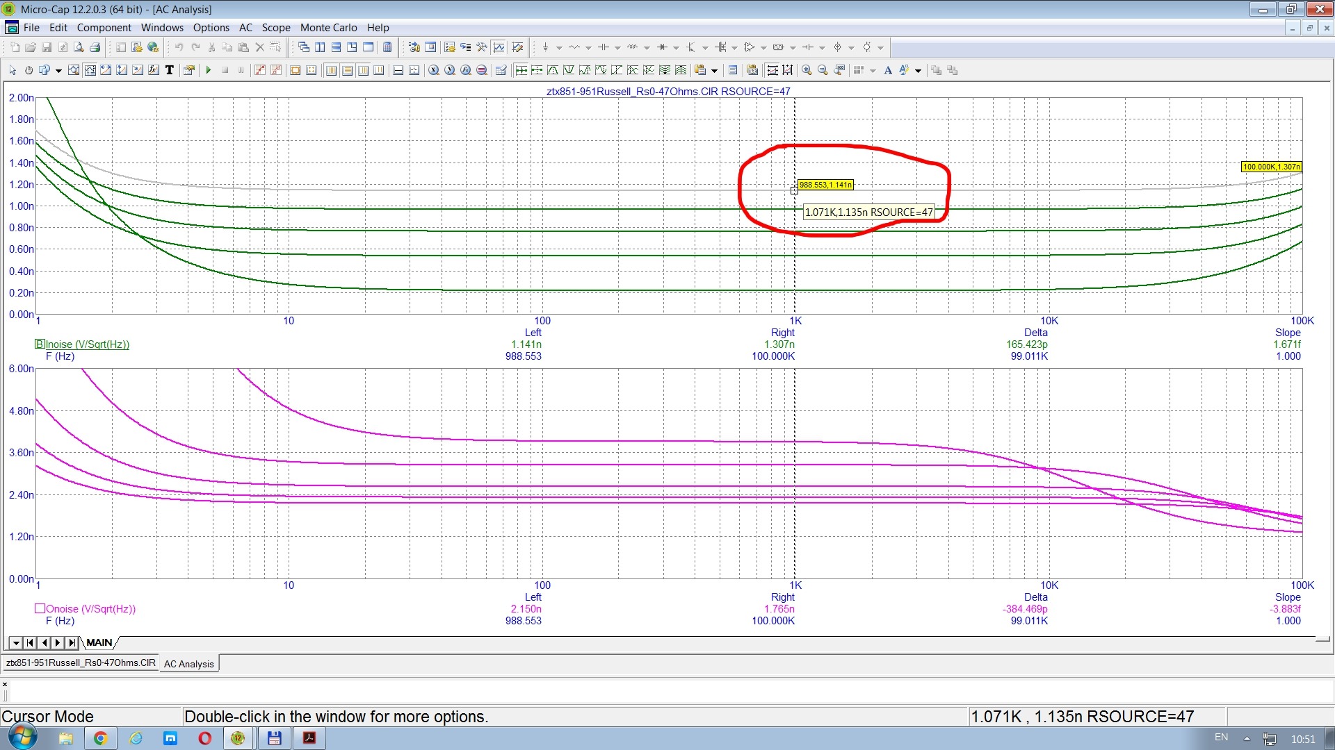

‘With correct input node RTI of ZTX851\951 with Rbb=1.2/1.5 OHms are 217 pV\rt Hz with shorted input (unreal condition), 538 pV\rt Hz with Rsource=12 Ohms and 1.141 nV\rt Hz with Rsource=47 Ohms.’
You have included the source resistance noise. Rsource will always have thermal noise. This does not tell you what the amplifier noise is. It remains at c. 250 pV/rt Hz no matter what Rsource is. No one is arguing that higher Rsource will result in higher generator thermal noise but it tells nothing of the amplifier only noise contribution.

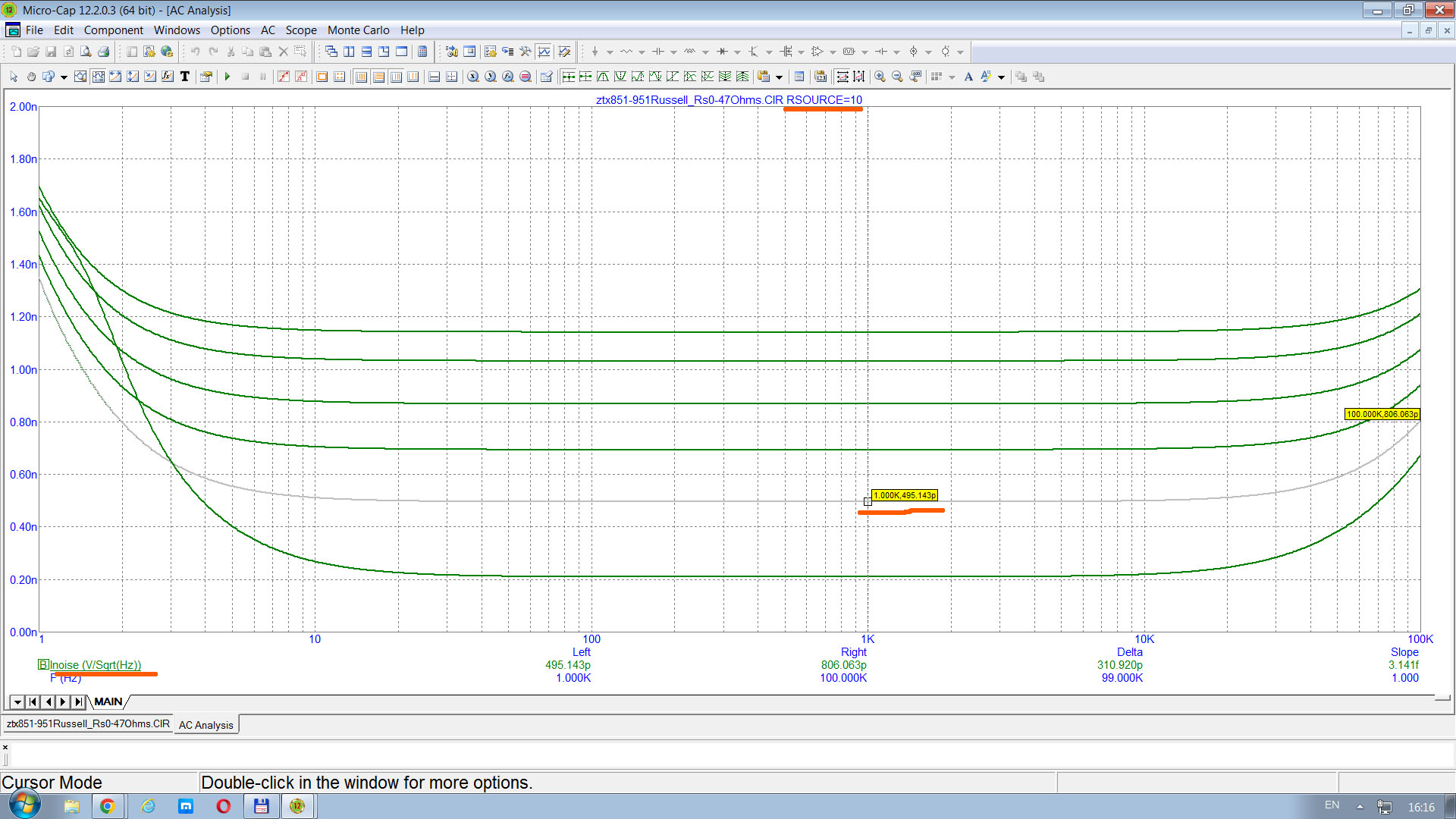

495 pV/rt Hz , Integrated noise @20kHz 495x141=69.8 nV, SNR ref 200 uV 200000/69.8=2865 = 69.1 dB - my simulation @ Microcap 12. Run AC Analysis and see Inoise @ Rsource=10.What do you think the 1kHz spot noise is on the X-Altra MC/MM?

Circuit file with .cir extension is not allowed as attaches at this forum, therefore is here: https://www.patreon.com/posts/ztx851-951-po-ms-88618453 . Free Microcap 12 installer is here: https://www.patreon.com/posts/podstrakhoval-12-84096514
