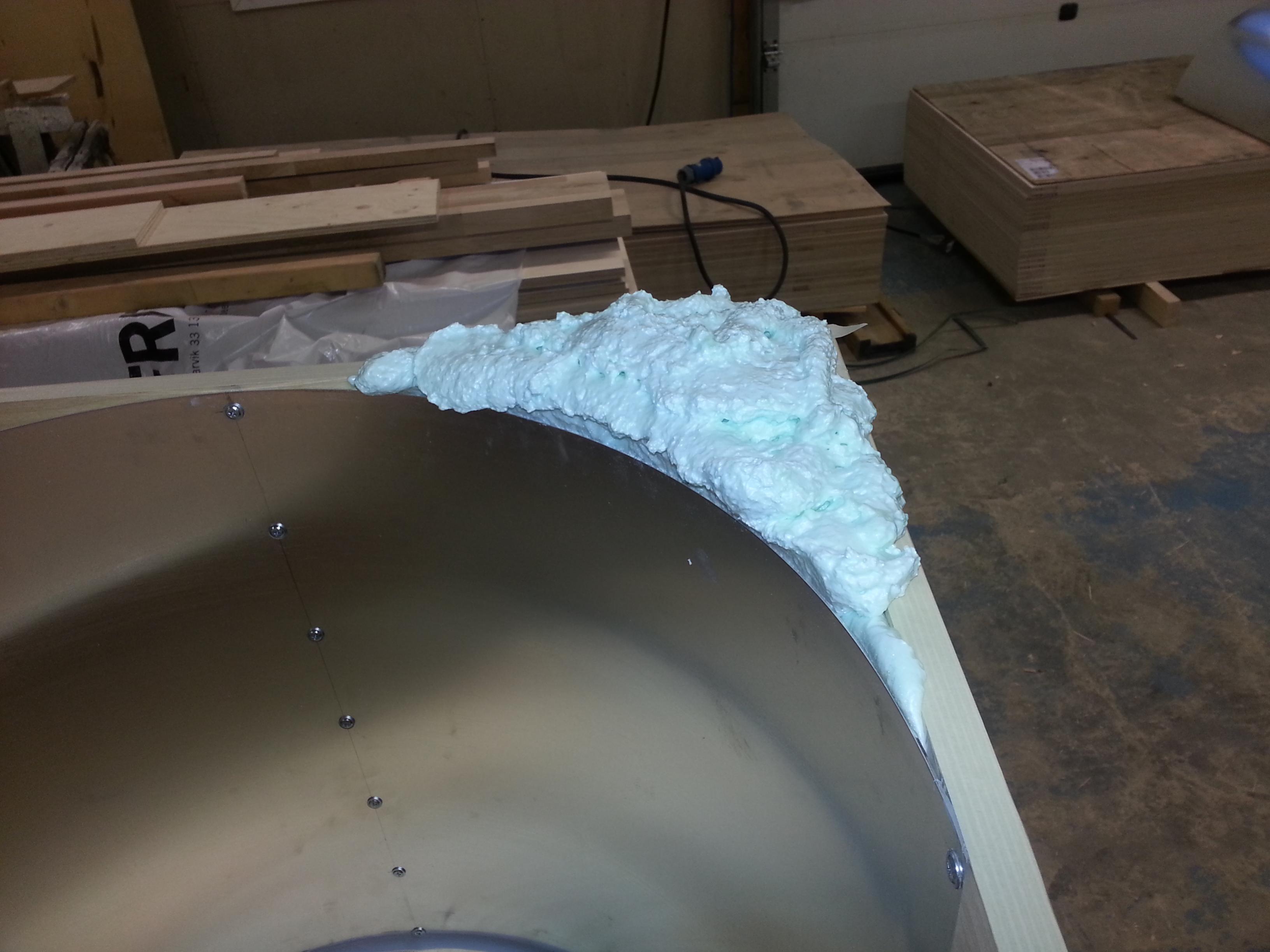

Nice build.

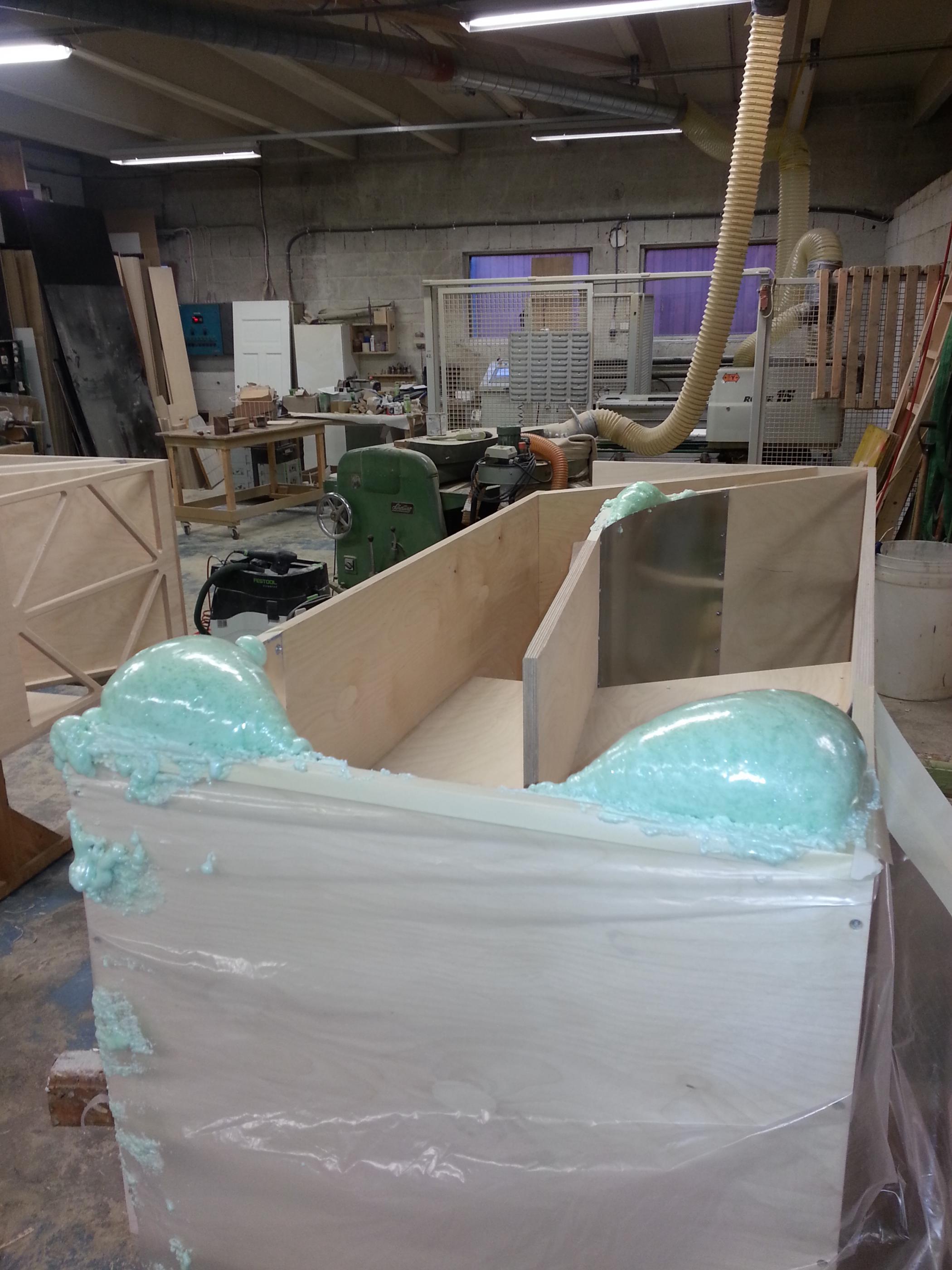

I agree, that is quite the impressive build from the fella in Norway. I love the multiple thicknesses of plywood, as I have always felt the use of single piece construction too flimsy to support the very difficult and powerful mid bass. Can we assume the term 2pi for a mid bass horn mouth exiting very near to the floor, but NOT close to a corner? If so, and using 4 square feet as the reference for 100Hz, then how much for 80 Hz, and then again 60Hz ?

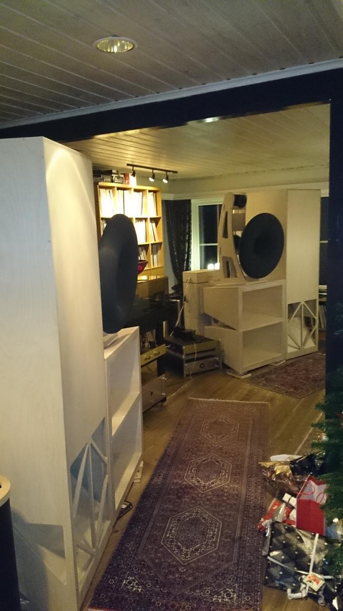

How does this compare to your 4x15 BD set up?
Yes, I saw from your blog that the 100Hz horns actually do go lower than 100 !

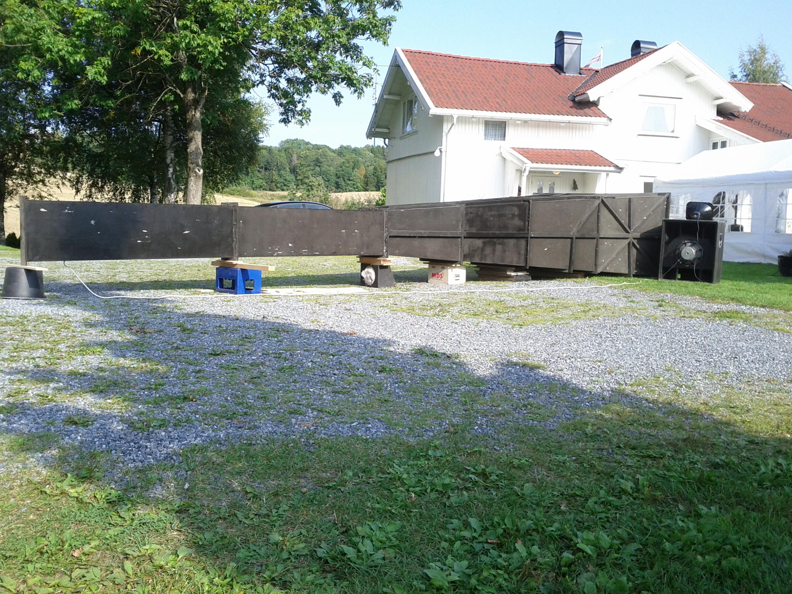

btw the Bert Doppenberg 4x15 vented cabs are replaced by these hornloaded Eighteensound 21" LW1400 to cover the range from 75Hz and down
sensitivity@20 is 92db
best
Leif
these subhorns are in another league all together and eleveted the entire system to new hights!
enormous capacity! continous 135db@30
like a V-8 engine on a perambulator cruising along...
just breathing the deeper frequencies
semivented rearchamber makes easy load and dipole advantages in the room
they´re designed by a well known guy called Rune Skramstad who did these
he designed them as a custom job for me and a friend
best
Leif

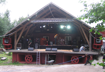

😀I like the photo 2... I can't see it from my seat but can hear i from here in the middle of France !

I saw your article in Watt (Norwegian hifi magazine). I have been looking for articles about horns for a long time. I thought it was great how you managed to make two midbass horns so compact. I have one similar midbass roundhorn on each sice, and I do feel it could use an extra midbass horn to push more air. But then the smaller horns would hit the ceiling if I keep them vertical.
Does the horn sub sound cleaner than the 4x15", or do you hear some anomalies because of the long horns? Some people are very against sub bass horns (i.e. The Cat).
I use a 12" Eminence LAB12 sealed sub, and I think it is good for now, but it is not very musical. I get more of a home theater type of sound.
remember I came from 12 years with Avantgarde Trios and realised the FLH had to be square.....D´Appolito with two round tractrix 100Hz horns is plain impractical
the stacked FLH measures much smoother than a single with better extension....a guy nearby with same horns and drivers get extension to 60 in smaller room
also the stacked gives me the sensitivity to almost match the TAD 4001 in JMLC270 with 112db...only have to take down the TAD by 2-3db and the 2001 in JMLC1400 is dead on....making passive filters simple...only Northcreek 8awg coils and Mundorf silver in oil caps
yes the sub is a lot cleaner, but some people claim the BD towers to have had more funfactor, but I feel that was more of a colouration..
the Eighteensound 21" LW1400 is very musical and differentiates bass harmonics very detalied and relaxed....just breathing under 75....and the 92db sensitivity at 20 is exceptional....
the alu curved reinforcements are cruisial though...Rune said he´d tried with curved baltic ply, but they coloured the sound when exposed to the pressure inside the curves
delay and phase is no problem under 75 Hz .if you lie down with your nose against the joint between the FLH and the sub opening with one ear against each opening, and your extremely experienced, you might sense there´s some fractional time difference, but it´s nothing you ever think about when you listen to music
and you won´t miss the 10K cables either......
best
Leif
