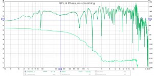

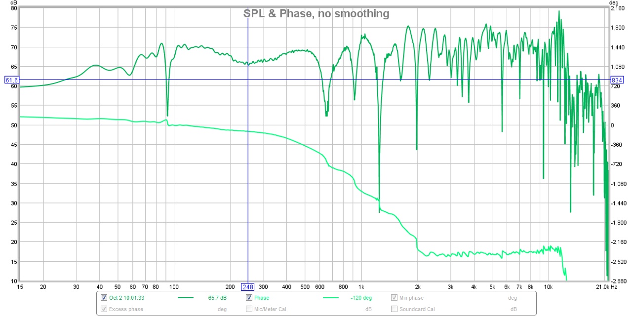

Wow, just like that, it won't work...except that the OP said nothing about ripple - you did.

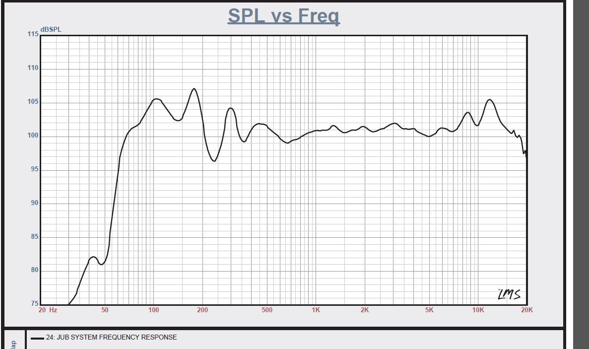

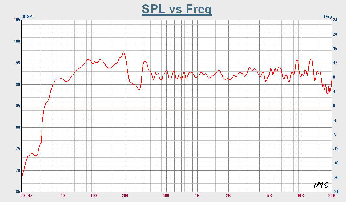

Nothing would be better if the Jub bass bin measures really well. Like you say, it's compact. And I would have the option of corner loading later it that becomes a possibility.
However, looking at the two measurements I've seen of Jubilee, I don't see an even response or something that should indicate a similar directivity at the crossover.
This certaintly doesn't look well. This is anechoic also (at least one is) if I'm not mistaken. How can this compare to a conical/hyperbolic horn?

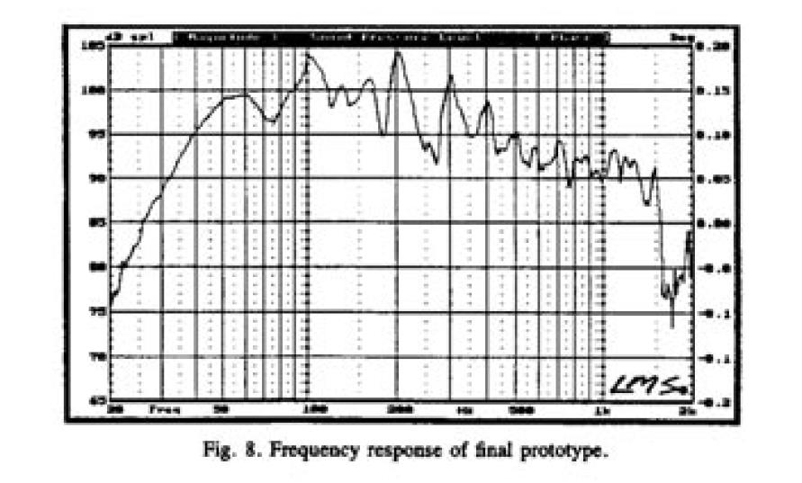

And here's a measurement of the final Jube bass bin prototype from the AES paper earlier posted in this thread. Not exactly stellar.
attachment.php
For me it seem the folded horn hasn't been chosen because it's the best midbass horn or matches the K-402 in the best way, but because it's compact, can be corner loaded and gives output lower in frequency. The latter being absolutely vital when you have a commercial product. No one would build and sell a speaker system in those days where you're required to use a subwoofer from 80-100 Hz.
