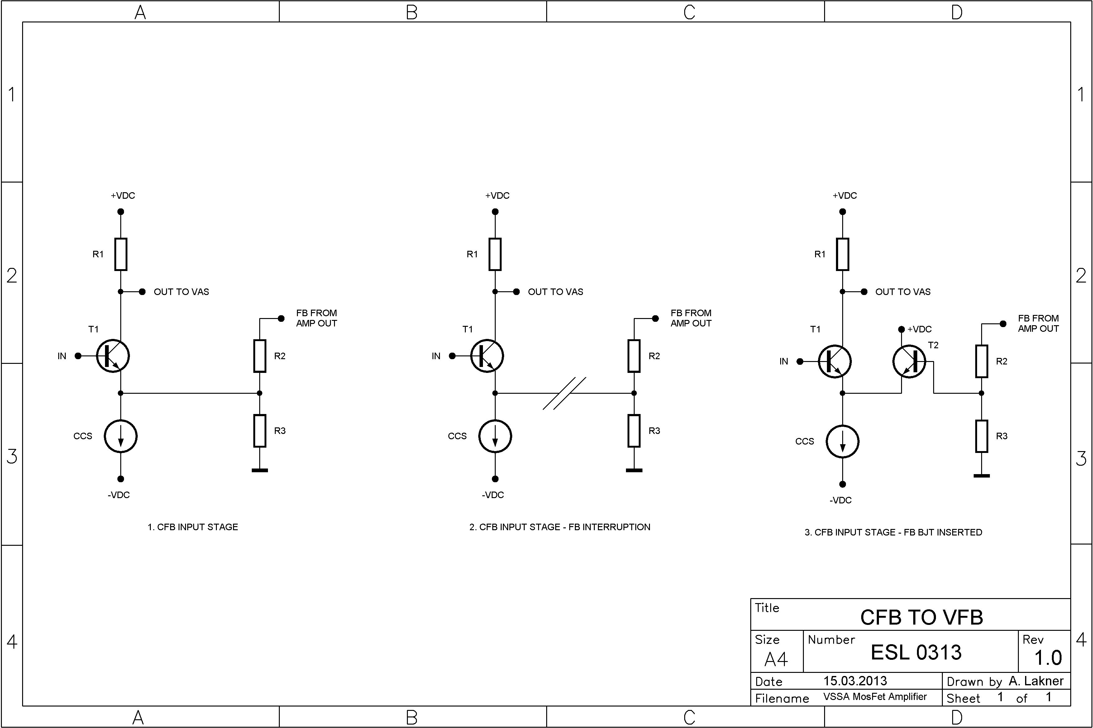

I like CFAs mostly for the (nearly) gain-bandwidth independence. The abiility to preserve low gain stability, while still pushing up the unity loop gain frequency is unique to this topology. It is very hard to build a wideband VFA while having it stable at low gains.
Firstly, there is no need for an excessively large closed loop bandwith (say, greater than 2Hz~200KHz) in audio applications.
Secondly, the appearance of constant bandwidth in "CFAs" is an electronic sleight of hand.
It's due to the fact that the gain of the first stage is roughly equal to its load impedance divided by the effective impedance at its emitter.
Because the feedback network is connected to the input stage's emitter, it has a direct impact on first stage gain, and, by implication, on forward path gain for the same compensation element.
If the Thevenin impedance of the feedback network, as "seen" from the input stage's emitter, is reduced by, say, reducing the value of the feedback resistor connected to ground, this has a effect of simultaneously increasing first stage gain and the closed loop gain of the amplifier.
It is this increase in first stage gain, and, therefore, increase in forward path gain, that causes the bandwith to appear constant even as the user attempts to increase the amplifier's closed loop gain by reducing the value of the feedback resistor connected to ground.
