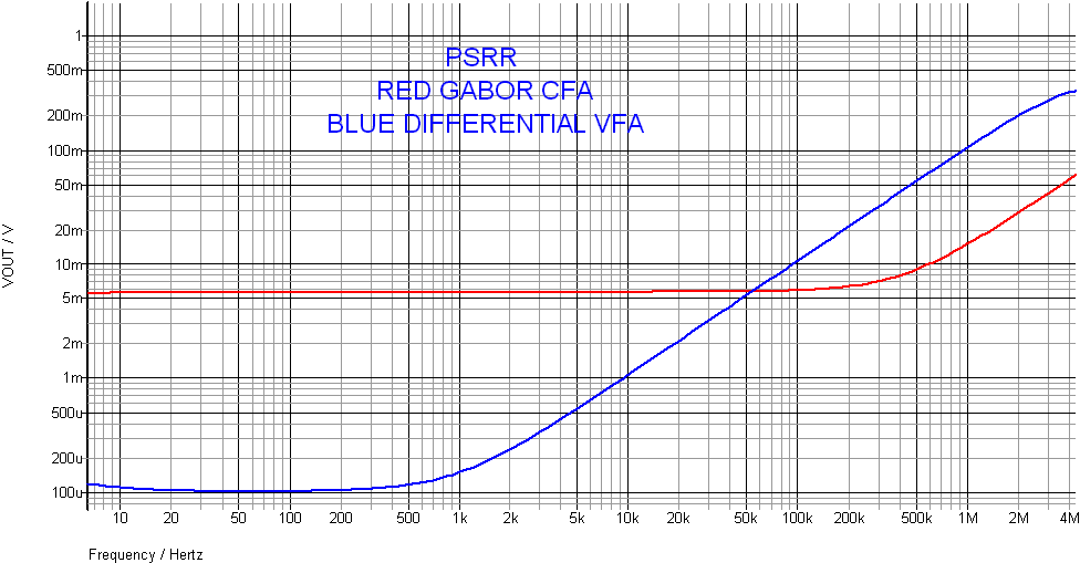

Start using CFA with CCS and PSRR is leveled with noise floor.![]()
Not true , wether you re using resistors , basic current sources
R + zener + R , active sources or even perfect sources (in simulators)
the PSRR will be the same +-0.5db.
Taking Gabor s design as workhorse , it has basicaly 34db worse
PSRR that an equivalently biaised symetrical differential VFA ,
and your VSSA , wich is the same design , has the same mediocre
PSRR , the current source argument being just wishfull thinking
but has not the slightest technical ground.

Real circuit measurements are the ones to trust. Modulation of DC rails resulting in lower than noise floor suppression of the output voltage modulation in VSSA, in both cases, observing the scope-analyzer screen, as well as listening to speaker noise. Usually VFAs I ever tested had more problems with the same rail modulation signal (DC+AC). Simulations are so approximate that I trust only the real world's measurements results. 😉Not true , wether you re using resistors , basic current sources
