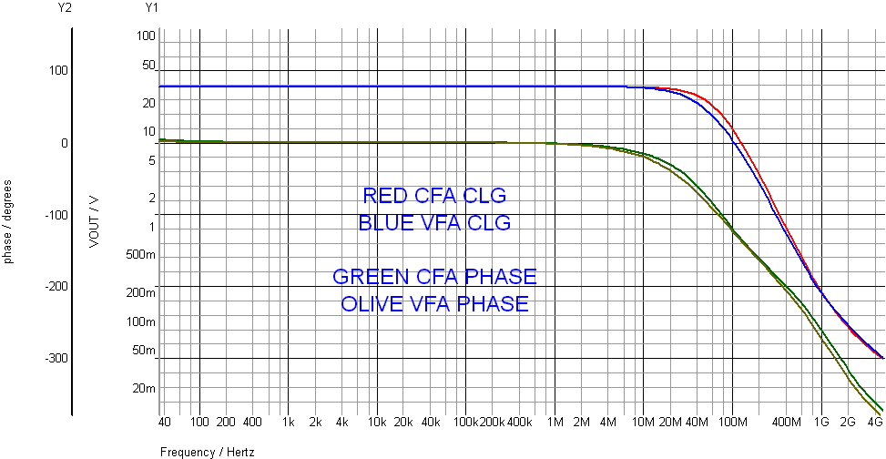

Wahab, Michael, when you have a chance (if not already), please read through these Texas Instruments application reports:
http://www.ti.com/lit/an/sloa021a/sloa021a.pdf
After reading these do you will still believe that there's no difference, on technical ground, between VFA/VFB and CFA/CFB?
Of course that using a common base inputs scheme will
yield some differences in caracteristics but neverless
theses are stretched VFBs , and particularly the TI exemple
is not usefull for audio unless its signal input is bufferered ,
who wants an audio amp with 50R input impedance.?..
Besides , in the topologies at stakes here only the negative
input is at low impedance.
Doing some simulations using Siemens 5Ghz devices
with a VFB and a "CFB" biaised such that the critical
standing currents are the same there s not that much
difference in caracteristics , gain/frequency of course , but also ,
surprisingly , phase response that is not worse with the VFB ,
slew rate being 50% higher for the CFA, from 500V/us to 800V/us ,
both numbers being totaly useless in audio applications.
Linearity is about the same but as expected PSRR is 25db worse
for the CFA , a value that itself make theses designs irrelevant
for audio in their simplests iterations.
Great investigation Wahab 🙂
It confirms what I said in the very beginning of this thread.
It is a short sumup of the differences:
What is good in CFA is the slewrate.
What is less good is sensitive to the power supply. Lower PSRR.
