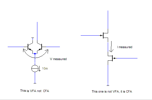

Those so called CFA are genuine VFB topologies , the difference
with a differential is just buffering of the return signal , nothing
that can be qualified as different on a technical ground.
The alleged low impedance of the inverting input of thoses "CFA"
doesnt hold since the transistor that buffer the said input in a differential
works in common collector , hence its output impedance is very low ,
in fact it can be even lower than the one provided by the FB network
in said "CFAs"...

"Expressions VFA and CFA should apply to amplifiers where it is either the output voltage or the output current which is under control, and should not describe the way the feedback is achieved [if we admit that the feedback applied to the emitter(s) of the input BJT(s) is of current nature which is fundamentally wrong]"
You are forgetting what the middle letter stands for: feedback
We are talking about the feedback quantity and not the output quantity that is being controlled.
Voltage output amplifier
Current output amplifier
Voltage feedback amplifier
Current feedback amplifier
Get it?
And that is the change that has occurred. Over most of the last century, we WERE talking about the quantity that was controlled. And in feedback and control theory, we STILL do. That makes sense. Because if you make it refer to what you feed back, THEN you better define what is current, what is voltage. Is a feedback signal of 1mA and 5V a current or a voltage? How about 10mA and 6V? Or 100uA and 2V? See what a mess you get yourself into forgetting what it was all about in the first place?

I read those references a long time ago, and, of course, there're differences between VFAs and "CFAs": forward path gain, slew rate, etc.
However, my contention is that "CFAs" are, in fact, nothing of the sort, and are merely deeply compromised VFAs.
This because of the deterioration in perfomance that accrues, in audio terms, when you use a common emmiter amplifier to subtract the feedback voltage from the input voltage, instead of buffering said feedback voltage from the input transistor's emmiter with an emitter follower. The later combination gives rise to a differential pair.
Please ask Jan Didden for a copy of Cherry's paper on feedback amplifier configurations for the correct way to analyse the so-called "CFA".

Loudthud, you are talking about 2 different things here. Separate voltage and current feedback from voltage output and current output amplifiers. Maybe it's clearer if we say voltage defined or controlled output vs current defined or controlled output. This is not the same as voltage or current feedback.
You can use VFA or CFA to make a voltage or current defined output amplifier. One is about the output controlled variable and the other about the way the feedback works to deliver the controlled output.
I thought a bit more about this discussion, and I realised that many here feel this should be called 'current feedback' because there is appreciable current flowing into the feedback node. But it should be clear that that is not the case except for some error current due to finite feedback!
If there would be infinite feedback (implying infinite loop gain) the current in to the feedback node would be exactly zero.
