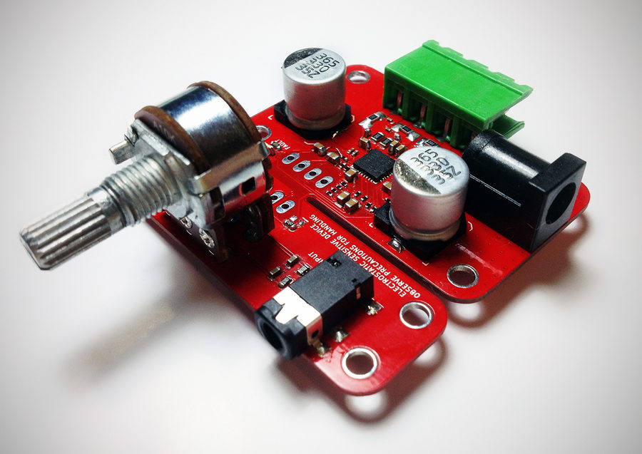

"Proper" TDA3116 PCB
- Twiddle thumbs until everything comes in, I'll probably use Seeed Studio or dirtypcbs for the PCBs, so it'll take a few days to fab and a week or two to arrive.
Please go for Elecrow, NOT for dirtypcbs - their boards are really low-q.

And please put a warning into silkscreen to not run the board without load.

I've ordered easily a dozen different things now between Seeed and DirtyPCB (whom I suspect use the same fab) without any major issues, occasionally you get a board with a misaligned silkscreen/solder mask but considering the price, you're still well ahead even if you discard some boards. I'm planning on ordering way more PCBs than I actually need and doing my own inspection, discarding any boards with obvious silkscreen/soldermask alignment.
They do 100% e-test and I'm not pushing the limits of their process at all, their limits are 5 mil trace/space, my minimum trace is 10 mil and my minimum space is 13. Their minimum drill is 12 mil, my minimum is 16 (under TPA only) and 20 elsewhere.
I'll add the 'don't run unloaded' text to the PCB, if I can find room to fit it 🙂 thanks.
INR/L- (negative input) is coupled to GND via a capacitor, not straight down, because the inputs are biased.
So you wont connect your signal-GND straigt to the negative inputs in no way.

Yes that seems how Dugs and this future ampboards are, no negative input to ampgnd but to source gnd, it should have best noise performance according to many datasheets, however not so here, not with any source or connecting wires, with transformers to inputs the same added noise is there. And pictures in dug gb thread show other people connect ampboard gnd to negative input too, dug terminal is + and - input and gnd, gnd terminal is ampgnd. So I am guessing more people have same added noise when negative input isn't to ampgnd. It occurs with all pbtl 3116 ampboards I have here, not just dugs have added noise, none of the stereo btl chinese amps have option, they connect negative through cap to ampgnd near chip all the time, they do not have the added noise option.

I know datasheet tells me to put gnd for negative SE inputs at source, but that always seems to increase noise here, so I connect negative to ampboard gnd. Would r37 and r43 reduce/prevent that noise? (btw same added noise here with inputtransformers)
Do these 4 resistors affect inputimpedance and attenuation, I mostly use passive log pots, do they look like the loglaw resistors too added to linear pots? I don't remember clearly.
R36/37/42/43 do put a 30K (single ended) / 60K (differential) load on the output of your pot, which will mess with the taper slightly. If you use a 10K pot it won't make much of a difference, 5K will be even better.

In a conventional pot (whatever law) the worst piece of resistance is the wiper-track interface. Therefore you want as little current as possible through this resistance, so any resistance variation does as little damage as possible. Adding a law-changing resistor to a linear pot does the very opposite. OK in an emergency if the right pot is not available, but I would avoid it when possible.
There are some other posts referencing to this popular method mentioning increased distortion, but nobody can stop people saying they think it is best or a good thing. They stop saying that after posts like the above in these other threads so I guess the people saying it isn't advisable are correct here, it is a bad thing. I don't want bad 😉
yes avoid high currents on pots. that's the job of its application not a general do n don'ts check list.
use high input impedances, use low source impedance, and by all means avoid DC current on signal lines.
a wiper shunt resistance is not bad, if it is a problem you're probably using it in the wrong application> on inverting inputs is a common mistake.
Yeah, don't run significant current through a pot/trimmer wiper if you can. The contact area between the wiper and the track can be very small, causing localized heating/oxidization/etc at the interface.

I was going to do my TPA3116 design in 2-layer. Although I was planning to use a TPA3116 with the power pad on the top of the pkg with a HS.
I did my portable media player in a 4-layer from Imagineering, 2 of 30 sq in pcbs for $100, which was the new customer deal. I had too, it was way to dense for a 2-layer. 4 layers allows you to have a dedicated supply and ground layer, so it does make things so much easier and has other advatages.
The boards from Imagineering were excellent. I used a 16 mil fhs for the vias and 8/8mil line/space.
If you chose 4-layer, I won't complain about the modest cost increase!
