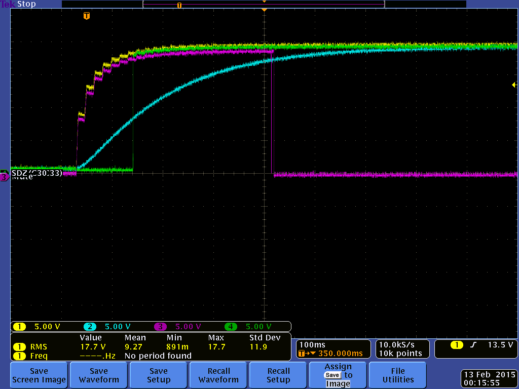

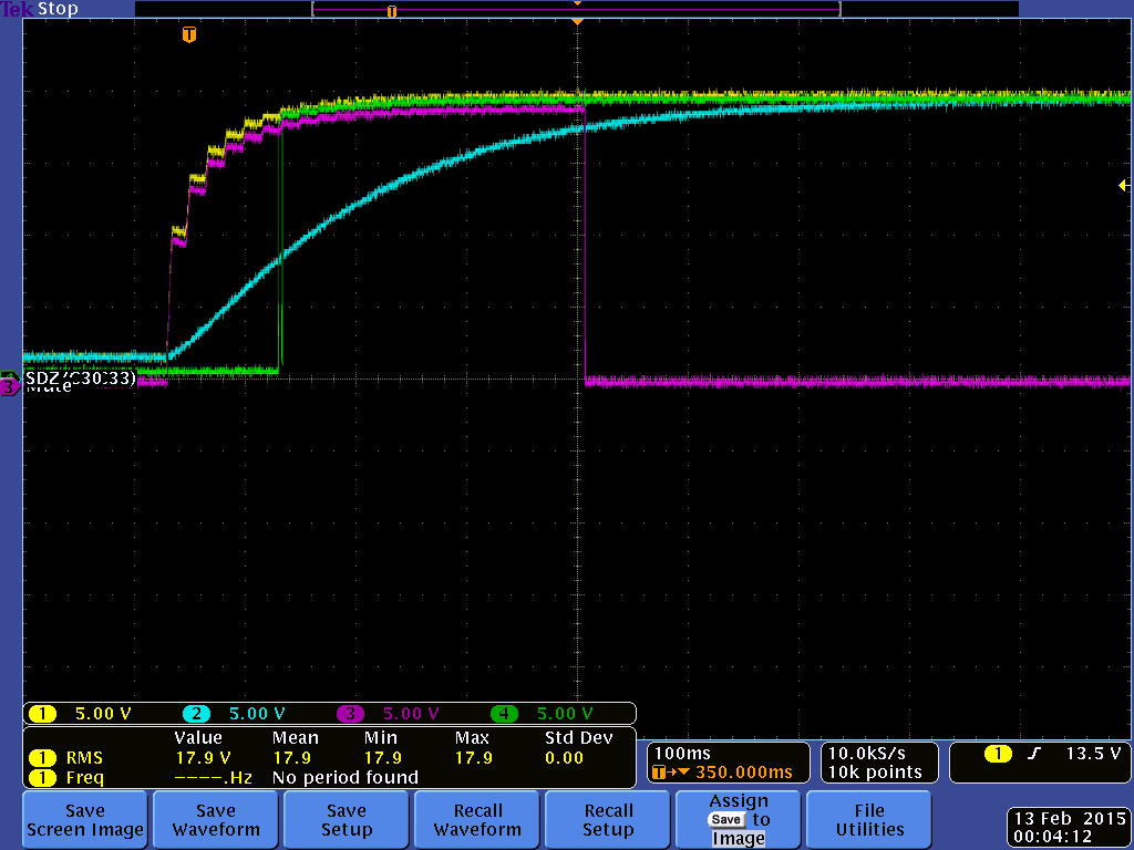

Done, see attached, 2 traces of a power up cycle, showing some glitching. I only had a 20V supply, used 100K r's in place of the 150K & a 27K for R19 = close enough for this test.But definitely do the bench test
1) yel: D1/C33
2) blu: R25/C30
3) purple: mute
4) grn: sdz
For the power down cycle, I am thinking that R19 should be connected to the anode side of D1 instead of the cathode side which is being held up by the charge on C33?
I will make the change a capture another trace with this setup change.
1) yel: D1/C33
2) blu: R25/C30
3) purple: mute
4) grn: sdz
Power-down is not covered in this configuration. Btw. Did you limited VCC risetime?

No, this is just the way my home made power supply starts up. It is a LM317 based design, for that output, which is variable.Did you limited VCC risetime?
It makes no difference!!I am thinking that R19 should be connected to the anode side of D1 instead of the cathode side which is being held up by the charge on C33?
