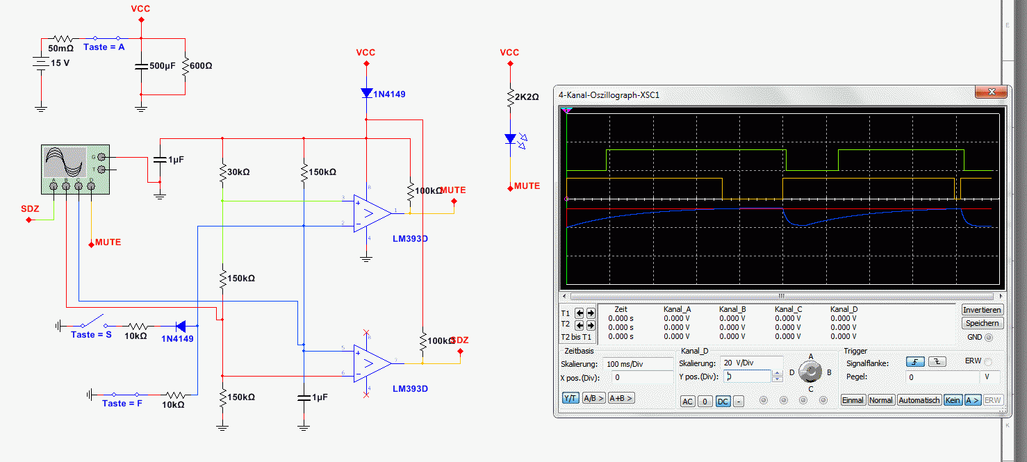

my reasoning,
U2B: flip pins 5 & 6. In normal operation you want "sdz" high (pullup to PVCC) as it is active low.
At power up, pin 5 (+) is grounded, as C30 has no charge. pin 6 (-) is higher (your ref), so output pin 7 is off (open-collector bjt) or a high due to the pullup R11(75K). SDZ is active low, outputs hi-Z.
Once C30 charges up ( 1t=150ms) and crosses the pin 6 threshold, pin 7 goes low.
I looked at the TI DS, 8.2.1.1 & 8.2.1.2, to get it straight, I think 🙂 !!

rsavas: LM393 +/- are correct in the schematic to the best of my understanding - if +>- then output is open circuit, if +<- then output is grounded. If this wasn't the case then half the examples in the 393 datasheet wouldn't work - note the 'comparator with hysteresis' example in this one:
http://www.onsemi.com/pub_link/Collateral/LM393-D.PDF
Looking at adding hysteresis now, gonna mess around in LTspice for a while.

Fig 12 in TI LM339 d/s is bugging me now, it is contary to
Got to like the new disclaimer,
that is good use of your hard efforts.Glad I'm getting lots of interest in this project though, profits from assembling boards will be paying off the vet bill.
Or am I all messed up?7.4 Device Functional Modes
A basic comparator circuit is used for converting analog signals to a digital output. The output is HIGH when the voltage on the non-inverting (+IN) input is greater than the inverting (-IN) input. The output is LOW when the voltage on the noninverting (+IN) input is less than the inverting (-IN) input. The inverting input (-IN) is also commonly referred to as the "reference" or "VREF" input.

Well, it should work like it said.
Verified earlier but did once more to make sure. 🙂
