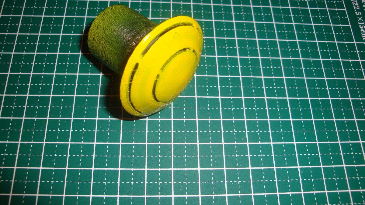

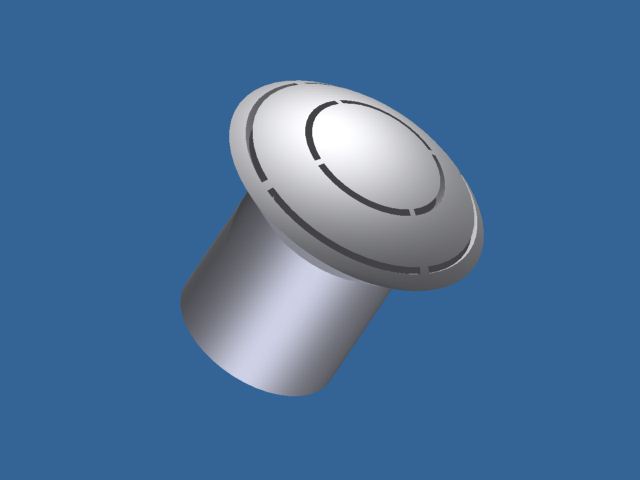

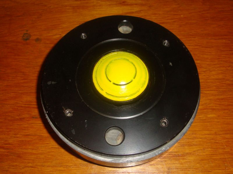

On another note, i mentioned i will be starting to play with compression driver. While it takes longer than expect, i am making some progress in this regard.

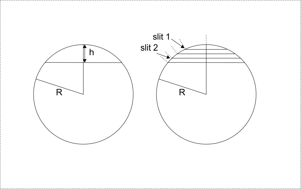

Guided by Henricksen's paper "Phase Plug Modelling and Analysis: Radial versus Circumferential Types" I made a spreadsheet to calculate the phase plug parameters. You can see it attached even tho its not really arranged but keep in mind only the blue cells are user inputs.
The excel shows data to draw the piece and also baffle input for AxiDriver. It shows only Reflector side so you will need to draw the baffle according to your compression driver's profile.

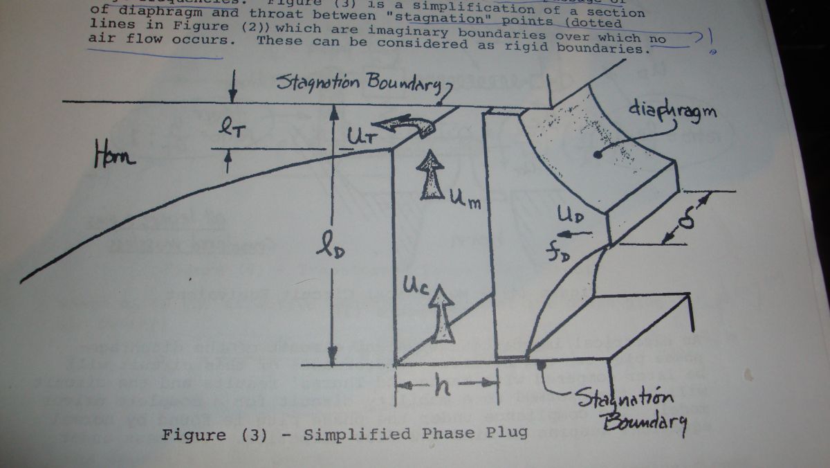

You will find attached o picture showing figure 3 from the paper. That is basically a section through the phase plug representing the acoustic path. The air trapped between the diaphragm and the phase plug has a volume and mass defined by length Ld and width (delta). Considering a 2 slit circumferential phase plug you can see how delta will vary for the 2nd slit as circumference will be higher.
For the first phase plug i decided to keep this mass of air constant by keeping the diaphragm surface area acting on each slit constant. This is what the spread sheet will do . knowing that the surface area of a spherical segment is 2*pi*R*h with R being the radius and h the height between the upper and lower segment planes, we can see that we will satisfy the initial condition by splitting h in equal parts.

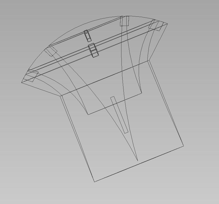

As you can see in the picture with the 2 circles, h was divided into 4 egual parts corresponding to the 4 acoustic paths in a 2 slit phase plug. The arc length between the dotted lines correspond to Ld. Keeping surface constant will cause Ld to vary, you see. According to Henricksen you can determine a cutoff frequency based on Ld and it states that f0=c/(3.63*Ld). How much will this apply to a varying Ld design will have to check experimentally.
At low frequency we know all the air will be pushed through the slits and at high frequency some it will just compress. Because of this the air has mass and compliance which can be modeled as inductance and capacitance. In the paper we have f0=1/(2*pi*sqrt(LC)) a known formula. When compared to the Ld based f0 something goes wrong as i dont think i interpret it correctly.
Anyways based on this i had my phase plug design parameters for a first try ready. There is one more thing that was on my mind. To me most of the circumferential slit phase plugs dont terminate smoothly. The slit throat grows to the point where it meets the other slits and then boom right into the large exit of compression driver. I thought i should have unite in pairs to make a smoother transition.

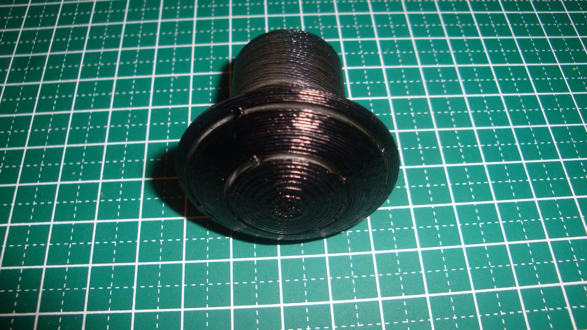

In this first try i didnt look for equal path lengths it is something i will try next.
You can see from the pictures tho how the middle section extends to provide a smoother transition. How good it will be, if any? i will test it soon.
You can see some already made PPs, Need to smooth them out and put them in a driver.

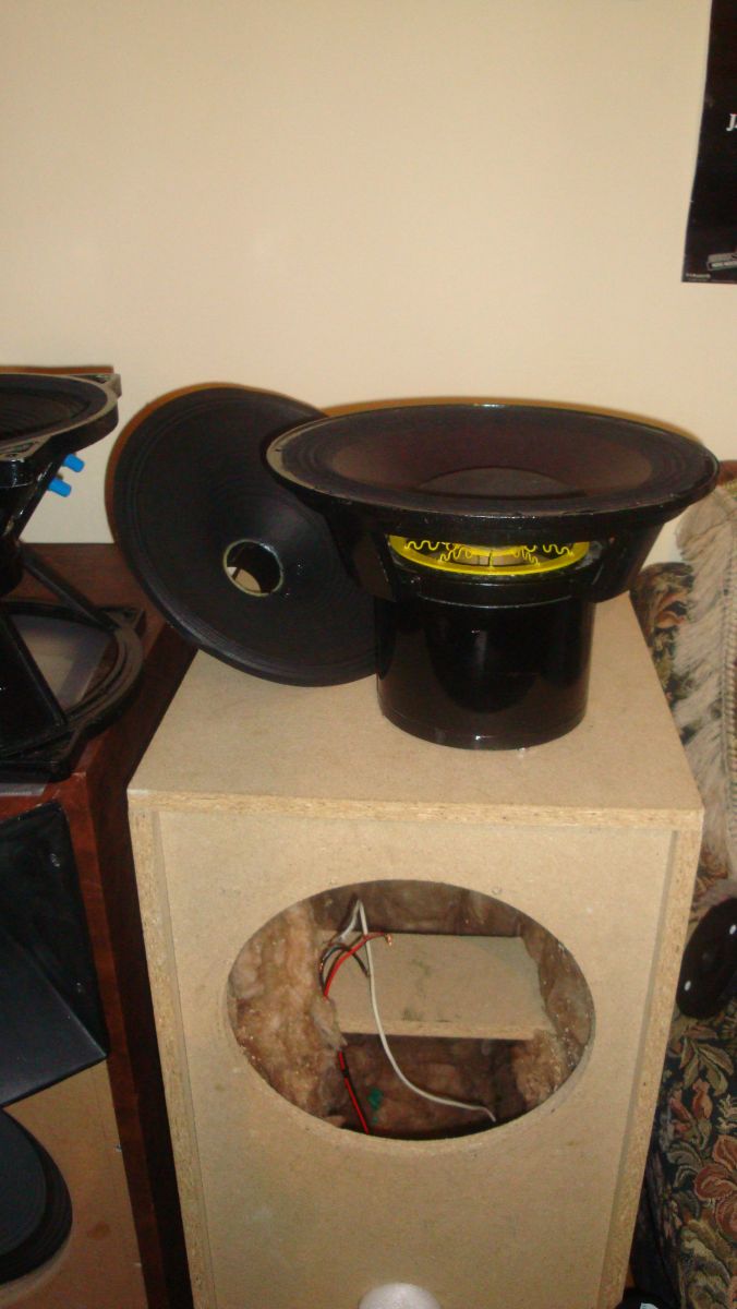

Anyways i got to play the high Qes cone. I put it on you tube cuz i listened Hugh Masekela - Stimela from Hope. Just the speaker not tweeter or drivers. On top is the midbass cone i removed.
Voice coil is a single layer 0.15mm ECW, 52mm diameter 6mm height. Rdc= 5.9 ohms. Qes = 0.9. Havent measured the cone's weight but its heavier about 30-35g to lower fs as well which is 37Hz
Some of my equipment is rented out so i had to come into sound card with balanced signal. Not sure what caused it but it picked up some noise. In that room i got not earth connection on mains so could be it. Even so, i think you can get a vast idea on its timbre.
Its not mounted on OB its in the reflex enclosure with the port stuffed shut.

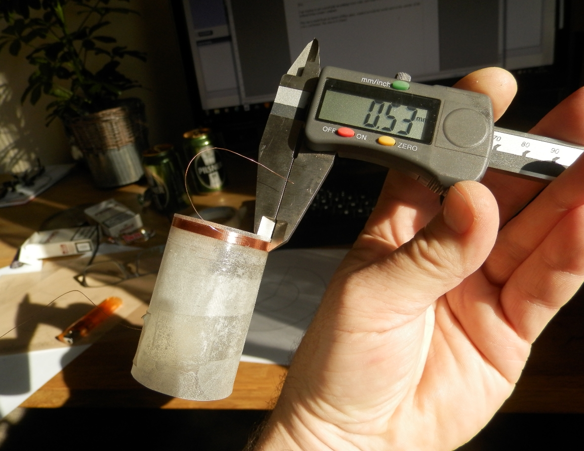

I am starting to get a good grip on making voice coils, just want to show you that it can be done without being a major company.
This one is made from six layers of fibre glass, winded on both the inside and on the outside of the voice coil former. The wire is 0.15mm.

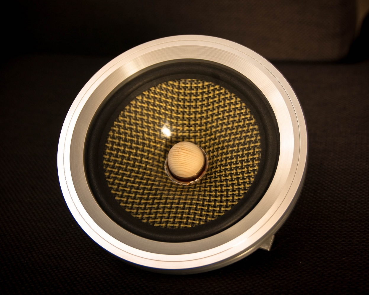

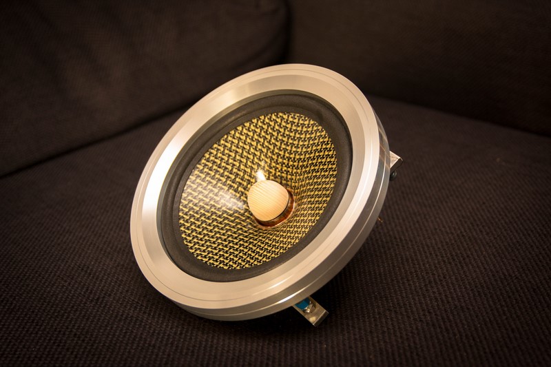

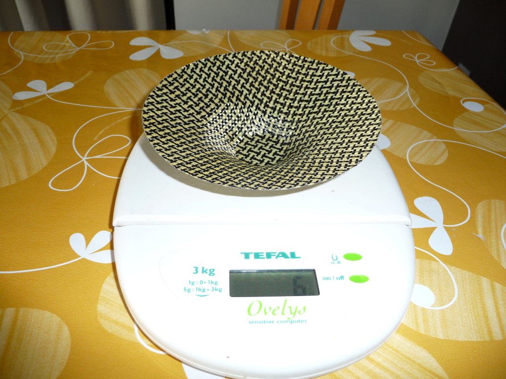

Have made a light cone (6 gr) suitable for full range. I wonna copie the cone of B&W mid-ranges. Light and rigid but not the sound of epoxy.
Going to test the cone soon.
This is the procedure:
Take a kevlar sheet and put it on a mold. Spray it with varnish (i used motip heat resistant varnish) on both sides. Press it with foam to the mold till it is a little dry. This will fixate the kevlar textile and keep it in shape. After this put the cone back on the mold after full cure of the varnish and put a layer of thin glass fibre on the back. For minimal use of epoxy put the glass fibre on cardboard and apply, with a little paintroller, the epoxy on it. The cardboard will absorb the epoxy so you have just enough. Put the glass fibre on the back of your cone and wait for full cure.
looks great
btw, kevlar does not get very stiff, but mostly used for 'tear strength'
also, epoxy on its own is much more flexible than polyester resin
but can be 'hardened' by baking it at around 50 degr for 12-24 hours
I don't know the exact numbers, and may also depend on how strong you want it
anyway, I would try non directional 'surface mat' fiber
its thinner and lighter
two layers would probably work well

Hey Jeff, i got to say its a beautiful looking cone. I love the texture.

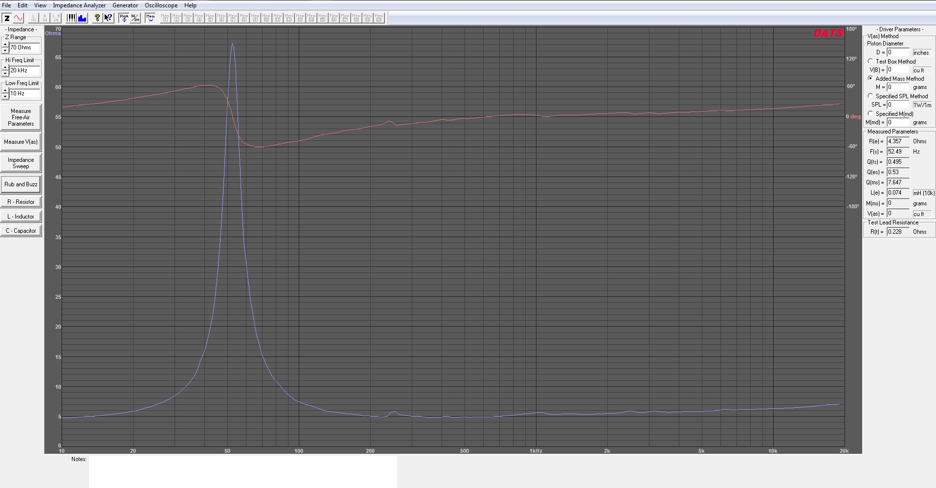

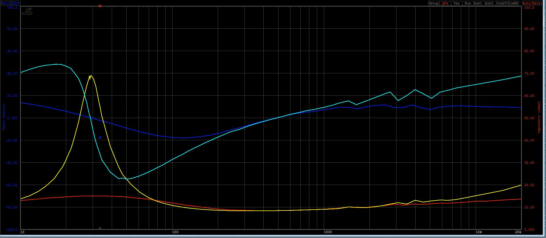

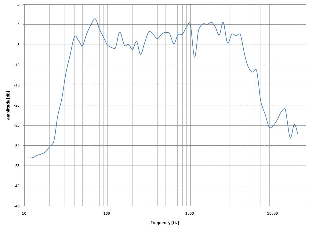

I will take down the high Qes cone tonight so i did a quick FR measurement and took a picture before that. I have my SPL meter at another location so the y axis on FR shows relative level not SPL.

This old saying that turned almost into an axiom that breakup occurs when sound wavelength reaches the diameter of a cone comes from the era of paper cones. Granted like you say you can move the coincidence frequency upwards ( this frequency where the bending wave's speed matches the air speed ) higher than the once matching the cone's diameter. I remember in the first kevlar cones, many had that 3-4 kHz peak.
But there is also the matter of exciting bending waves and as you mention damping plays it role here specially for wave traveling circumferential to voice coil. For radial wave cone termination has a big role.
Also we need to take into consideration that once we hit cone breakup we dont have only bending wave radiation. The effective diameter of the cone just gets smaller with basically a smaller portion of it still acting as piston.
On another note i tested the phase plug in a comp driver with a 44mm Ti diaphragm.
It does have a big dip around 8kHz, i dont have the measured data on this computer but i will show it soon.
This indicates that indeed Ld, the distance between the acoustical boundry and the slit dictates first cutoff frequency. Maintaining a constant volume of air between slit sections doesnt help much after this first test. Im preparing a sheet for constant Ld and will also repeat the measurement with one more constant volume phase plug to make sure.
Hi Hentai,
such a membrane which reduces the "effective" radius with frequency rising,
needs sufficient inherent damping.
I know it can be done, but you won't usually achieve that e.g. for the radial waves just by proper termination due to the surround.
Since the (wave) impedance of the membrane (for bending waves) changes with frequency, you can IMO optimize the surround just for a small bandwitdh to be "really nonreflective".
Above that range the only chance is sufficient inherent damping.
@ Frank,
No the suspension has nothing to do with it. I can shift Fs with it but not suppress like this.
This is when i shorten one coil. Btw i don't use a shorten ring that's the next step so the impedance would drop again a bit.
Your plot looks great! Very lineair till 20Khz. Do you use a copper shorten ring?
What are the TS parameters?
cheers,
cheers,
