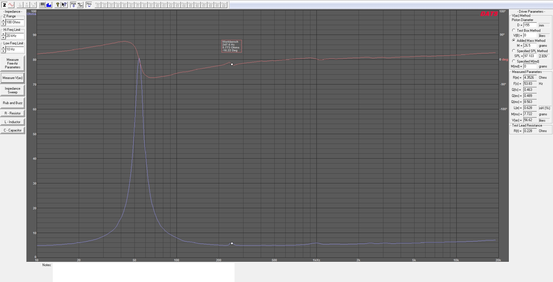

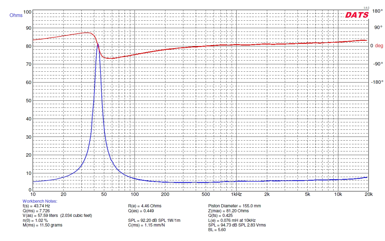

It seems you guys ended with very different drivers 🙂
From the DATS/WT2 plots, it seems that Frank's cone starts breaking up around the 250hz mark, while Jef's first breakup is around 3.5-4Khz...

Impedance deeps and peaks are not caused only by breakup. So it wrong to say a cone breakups at frequency x only from impedance curve.
Frank can you set DATS to measure inductance at 1k?
Does someone know what the peaks causes in the typically 2-3Khz region? A time ago i red this is the resonance of the spider and surround but since i have no spider it is incorrect because i have also two peaks. cone material resonance or maybe the coincidental frequency, break-up? This is important to know otherwise you can't eliminate them without a filter.

Hi Jef, its hard to tell just from impedance plot. Could be very well from the voice coil position.
Try to measure impedance with the voicecoil blocked and see if its a motion problem.
You need to measure frequency response onaxis and from other angles too to check cone related impedances.
Or CSD would help.

Just ordered a mic so going to to try this next week. thx

Here is the new measurement Le at 1KHz. I do use a shorting ring in the magnetic system.
The rise at 250Hz is due to the spider I can remove it just by placing my finger very lightly on it, the rise at 1 and 2.5 KHz seems to be coursed by the surroundings... but I am not 100% sure on that one.

No not yet I am making new cones and voice coils. I forgot that the voice coil former had to bee wider, when I started to winde inside and outside..😱 It was to tight a fitt to my taste.
By the way Le seems wrong @ 1KHz, 0.628mH translate to 78.5 ohm @ 20KHz??
