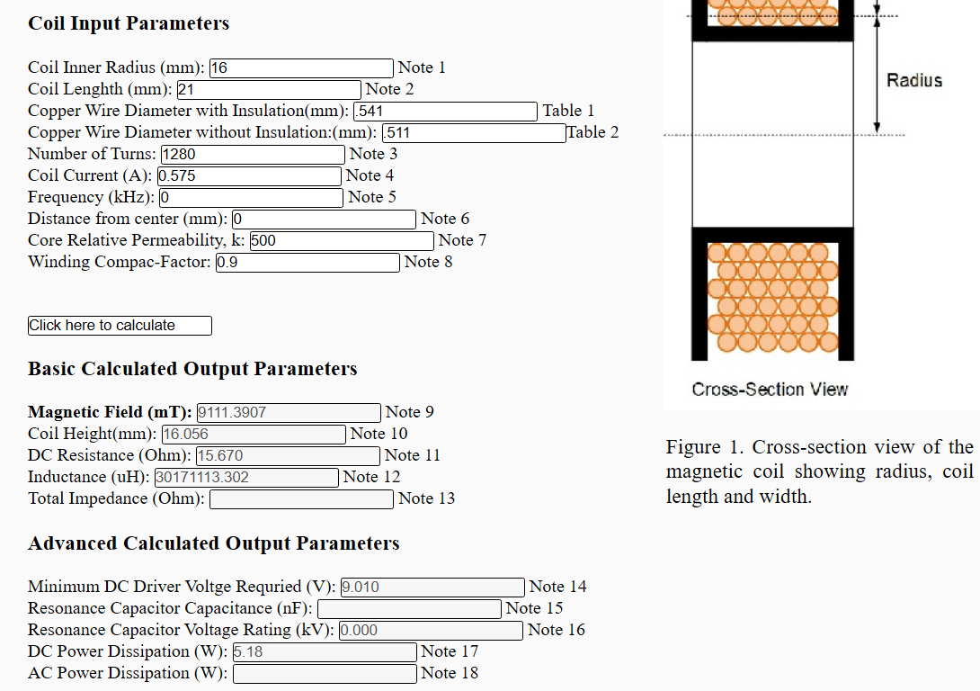

Hello, I scanned all 43 pages of this thread. Very interesting. I am in the process of building a set of converted 6 1/2" Isophone alnico speakers to field coil using the same method shown in this video of a converted Diatone P610. I'm just waiting for my 30mm diameter mild steel bar to replace the magnets with and then ill wind new field coils for them. For estimating wire gauge, and supply voltage, has anyone tried this calculator from Accel Instruments? Some values are just guesses but some are not, and it is a good starting point. I can keep the field coil dimensions the same and vary the wire gauge to see what it does to an arbitrary magnetic field. Arbitrary because we are not calculating a solenoid, but a magnetic circuit in a speaker motor and the permeability factor is just a guess. I repeat the permeability factor is just a guess, and can really be any non-zero number. The results can be used for comparison to one another, but not for definitive answers. Inputting the field coil inner radius, length, and wire gauge will give you a calculated coil height. Excellent when you're dealing with a fixed space. I tried many wire gauges and I think I've settled on 24awg copper and a 9V supply. This results in an estimated 1280 winds, 0.575 Amps, dissipating 5.175 watts. All this is experimental and certainly won't deliver a state-of-the-art product but for the cost, it's an awesome way to get started.
