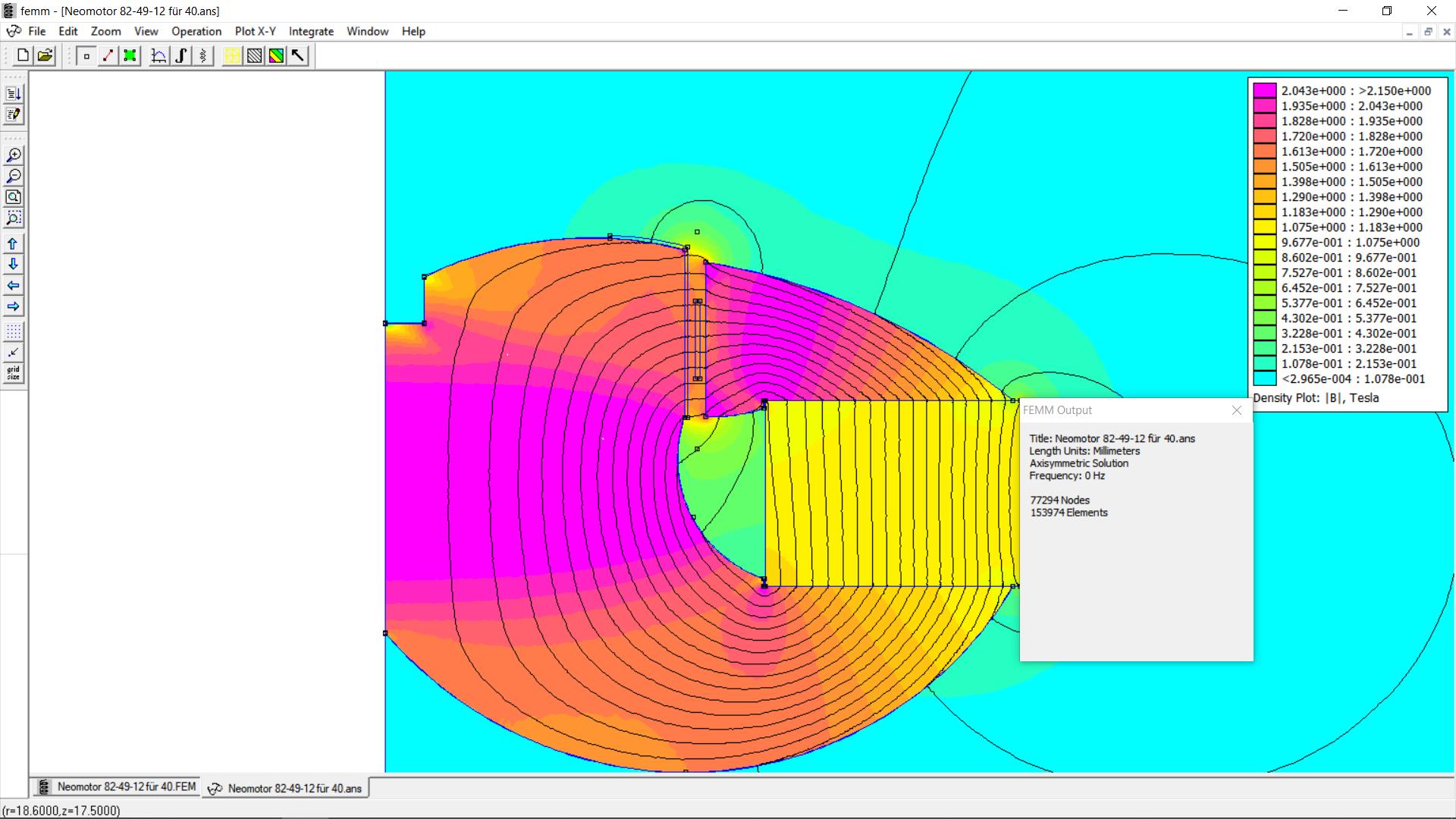

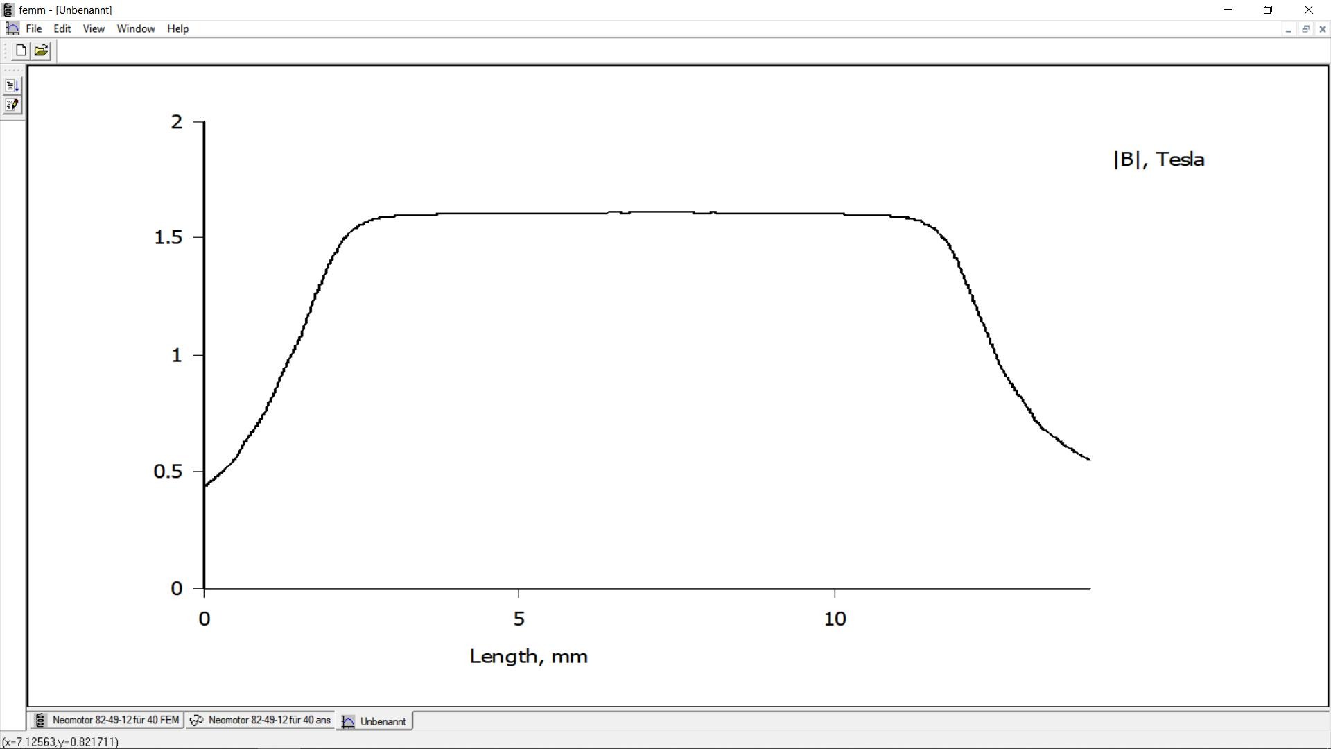

Yes, Permendur is the the best material with the highest permeability. Checking further you´ll notice that it´s extremely expensive, and on top you´ll need to find someone willing to work with it, or try yourself. With FEMM, it´s very easy to simulate different materials - in the case of my motor for an 8" FR driver (no FC, but custom N52 magnet) with an airgap of 40mm diameter, 10mm length and 1,2mm width (1,4mm without the copper cap) Permendur would only be a small percentage better than Pure Iron, an available material with a permeability of 2,14T. But the Pure Iron is quite a bit better than 1010 steel, so I choose it for a compromise. Even so it´s an expensive compromise, the motor alone is nearly 300€ in parts, per piece, in small series. But it has, with a 5mm voicecoil, 1,55T in the airgap, symmetrical across +-2,5mm of travel, with an airgap wide enough to be practicable even with a copper cap inside.

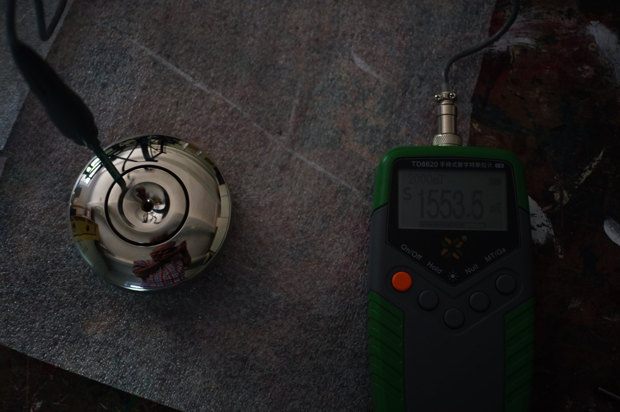

Interestingly, FEMM simulation results were always surprisingly close to measurements in real life (and my cheap gaussmeter was, even if maybe not correct on absolute value, sensible enough to measure differences between different designs).
Interestingly also may be that with an airgap of practicable dimensions, the force in the airgap is of course lower than the max. permeability of whatever material, and I see manufacturers advertise they have 2,4T in the airgap... physically impossible! FEMM will show this as well easily and cannot be praised enough.

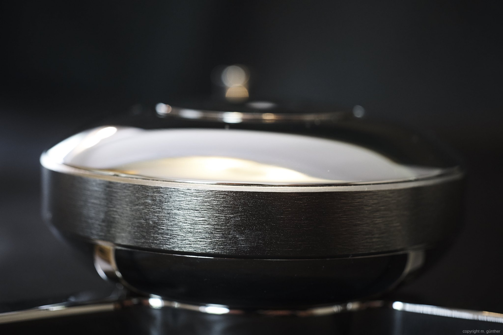

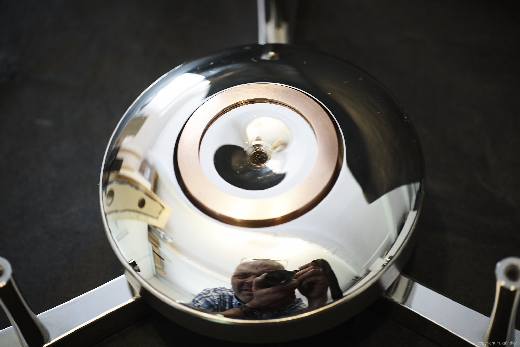

That's a work of art, Mattes! Chrome plating?

Thanks! Nickel plating, partly for function, but of course looks don´t suffer... Lots of work and money went into the motor development, and it has been optimized to a point where every single aspect (or most often dimension) is in balance with all other aspects. Or the other way round: couldn´t find any detail no more which makes things "better"; any change above this design will have negative effects in performance. It looks a bit strange, though...

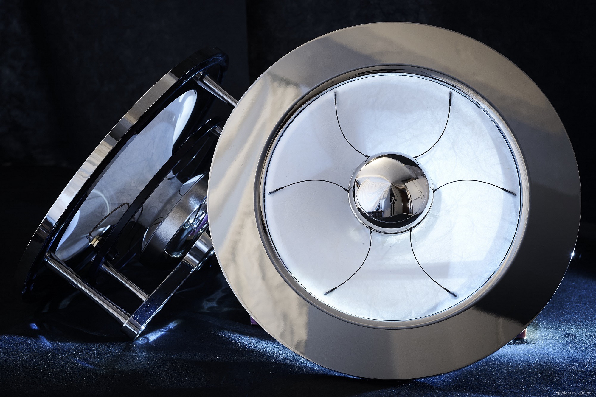

Hi KenAbsolutely incredible work, Mattes. Can't wait to see more details, when you're ready to share.
Thanks!
Although all details will be available on my website (footnotes from the old forum are gone, must renew them soon...) in a few weeks, of course I can share details here as well, if there´s interest.
All the best
Mattes
