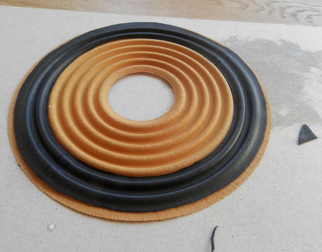

I did try a cloth surrounding. It was one that I removed from a unit, it was softened by adding some de solvent to remove all glues and resin. After removing the access glue the weight was 2,6 g, but it was still to stiff resulting in a to high resonances frequency...The foam surroundings was way better.
When using cones that are as light a 1,6 g I need a surroundings with a very high compliance, and this lead me to try leather. I got a small piece to play with, it had to bee joint due to the small size but it turned out OK. As you can see it is totally durable, one thing tow It increases in size when it is socked in water....So it is actually big big now. 😱

After making a full circle from two sheets of leather, I let it sock in water for about 30 min. For moulding the shape I used some nice big 8” spiders (as you can see in the picture), I put the leather in between the two spiders and added pressure and let it sit for 3-4 hours.
The leather I used was from a lam, and is about 0,5 mm thick. Hope this is the info you are looking for, other vice please free to ask.

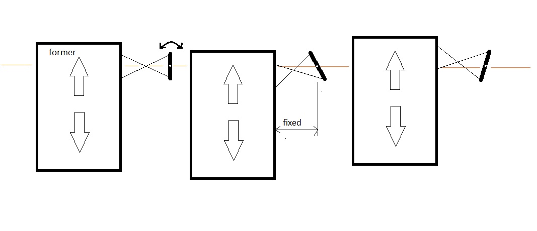

Indeed I feed it with a stabilized current source till 20-22Khz with a LM317 chip. This wil stabilize the eddy currents in the former wich will neutralize the effects of it.
For the radial centering going to try this one (fixed distance but no counterforce when moving, except mass offcourse), don't know if this will work:

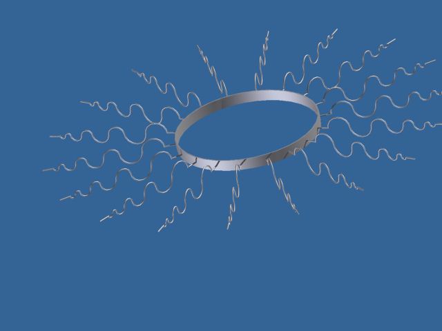

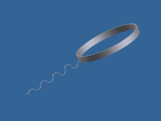

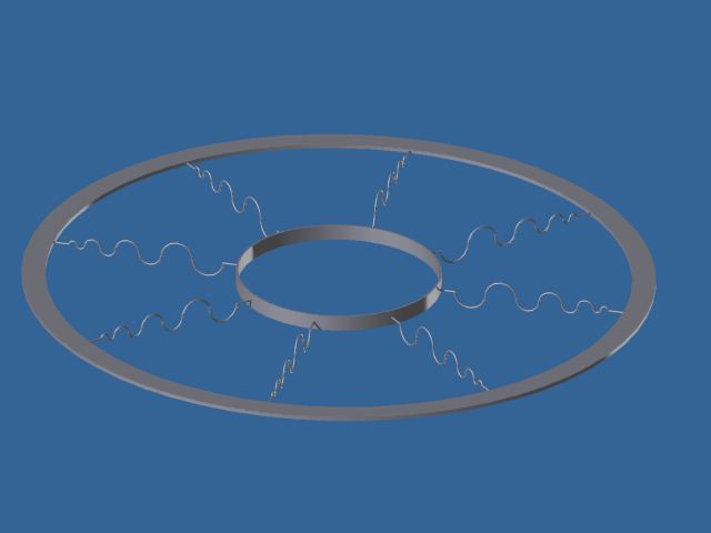

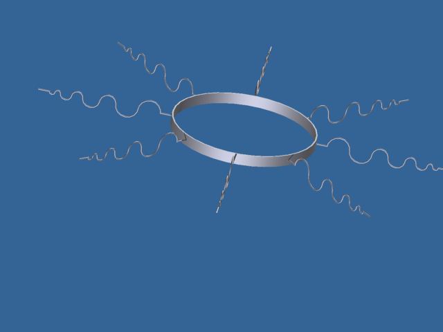

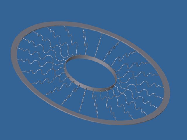

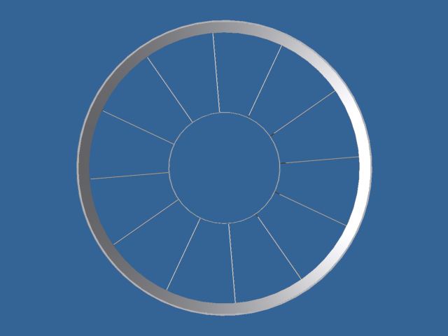

My idea of a spider has always been in the line of something like the below. Ofcourse each spoke can be made to provide a better flexibility and can be made with the desired progression.
Im planning to 3D print a couple of these (various spoke number and progressions) to see how it goes. Material used is PLA plastic.
You may find that it is difficult to get the accuracy you want due to the support material that will be built into the design. Take care during the support addition stage and you should be OK.
EDIT: You should remove those sharp contours. They are stress risers.
Perhaps an ideal solution is to use a helical double-start or triple-start machined spring as a spider replacement. They can be designed for low spring rate in the axial direction, which is nice for getting your desired Fs. At the same time, they can also have high spring rate in the radial direction, which is great for centering. Finally, they have no stiction which is a problem in slide-type assemblies (e.g. Adire Audio Parthenon).
Nice spider.... but I'm sure it is hard to make, if you make it of plastic I think it will break over time.
I like the fact that the areal is small this will produce less sound and interfere less with the sound that the is cone making. I am still confused to what kind of spider I will be using, I need a very soft one due to the low cone mass.
