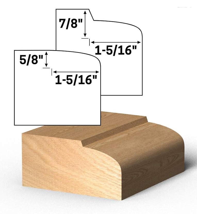

think you cold mimic atc mid wave guide profile ? or the dome is too small

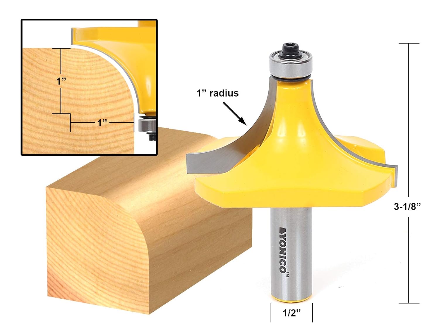

The ATC mid dome guide looks very simple. Looks like the profile of the quarter round bit I'm using. Probably 3/4" radius or thereabouts.
The trick to making it is to cut a perfectly round hole of the desired diameter (dome + a few mm more), then use a quarter round bit with a guide bearing against the inner wall of the hole you made to cut the contour. I used a 80mm hole saw bit (or blade or whatever you want to call it) on a drill press to cut the 18mm BB plywood AND the same hole in another 10mm board. Because the bearing guide has to ride below the depth of the radius, the hole has to be deeper.
Not sure if that last portion makes sense. If you are a wood router user, it will makes sense.
But to answer your question, yes I could replicate that wave guide.
The one I made first had a quarter-round shape like this --
But then I sanded the top portion of the "exit" hole so that it ended something more like this -- a longer contour curving more gradually to the baffle plane. Not like the wood with ledge shown but the second outline.

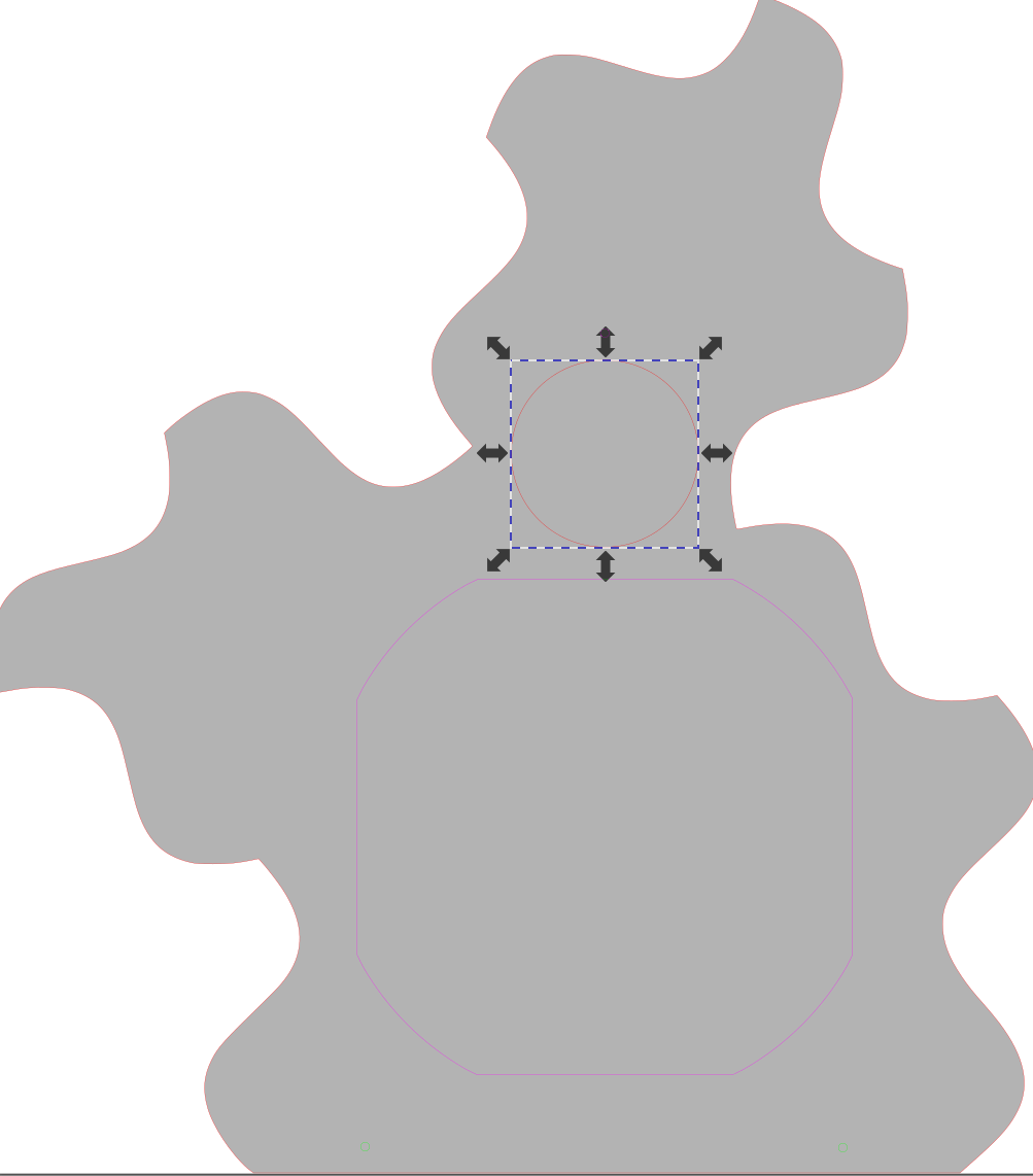

Because of the risk of damaging the 68mm beryllium dome during mounting, I would not make the starting hole any smaller than 73~75mm. I suppose if you could shape the backside of the waveguide with a template that provides a safe secure guide to mount the waveguide to the dome faceplate, you could get closer to 68mm. Not sure if any gain from that is worth the time & effort. CNC would make it easier. Or 3D printing -- but for this project, I want a smooth, all-BB front baffle, no plastic.

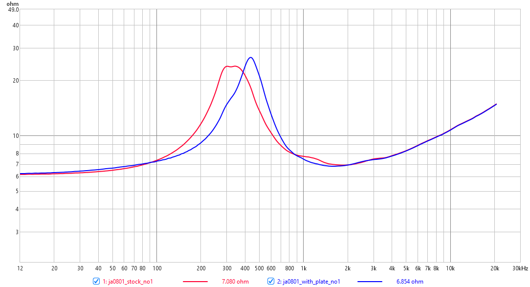

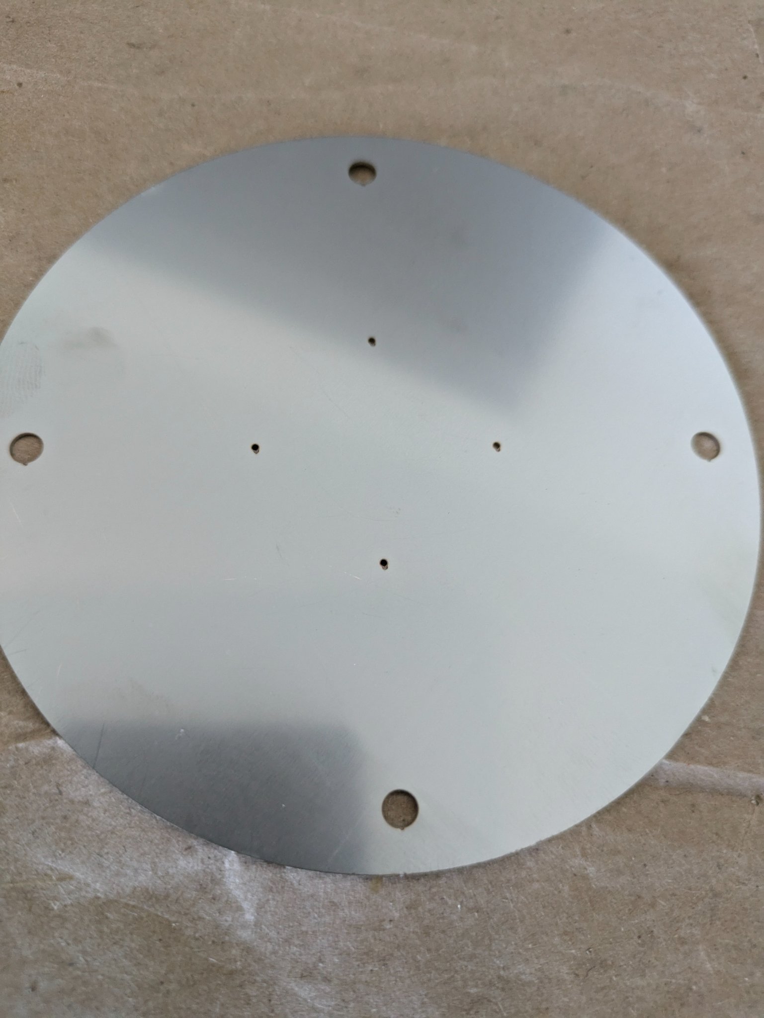

after 7 mo I finally ordered the parts. The wait enabled me to make a 0.6mm plate that I'll test out on the back of the ja0801 (the plate size did not exist 7mo ago). It could be a flop... only one way to find out.
The monotile will be 1.9mm thick stainless steel.

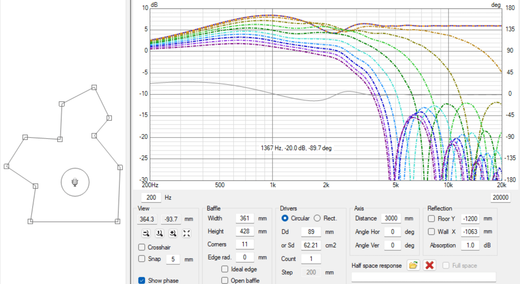

Baffle sim is done with an rough ideal driver sim. Looks like an lr12 is ideal.
It will be a week before the baffle parts ship. I noticed Troels used a LR4 a bit higher than me. I do remember liking the t25b being -6db at 2200hz.

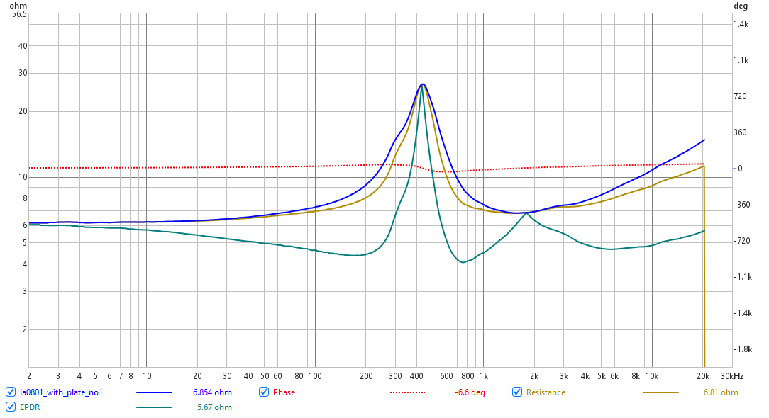

More to come. Next up should be a DATS test to see if the plate does anything and some other real measurements. I have two dayton mics to use.

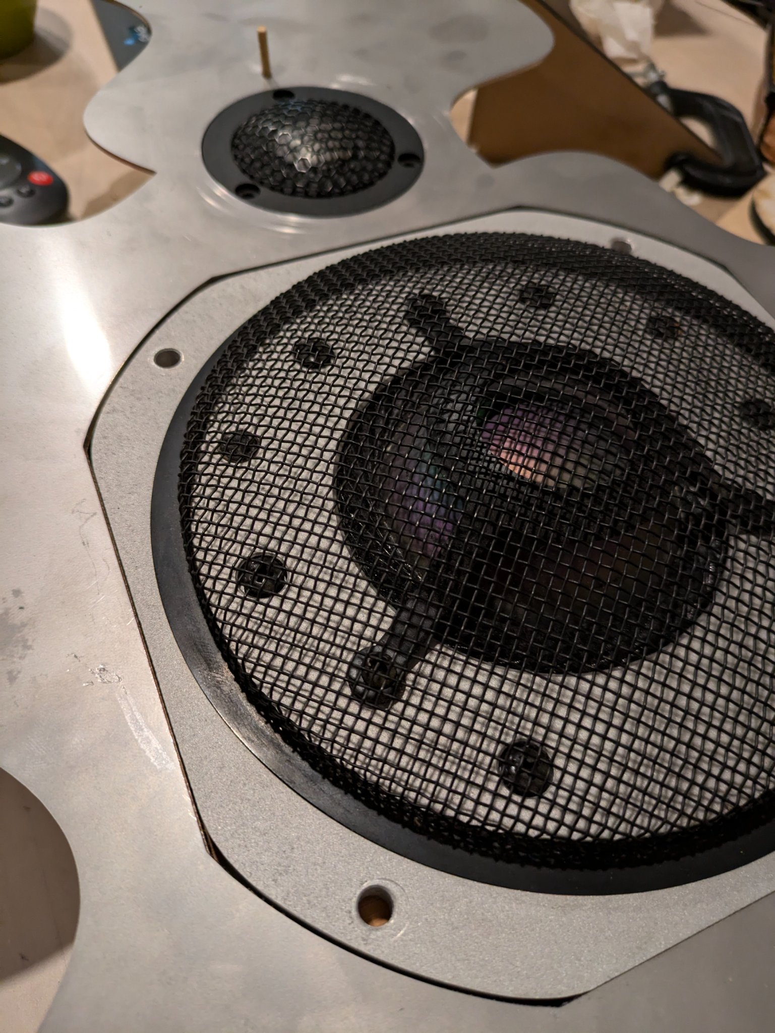

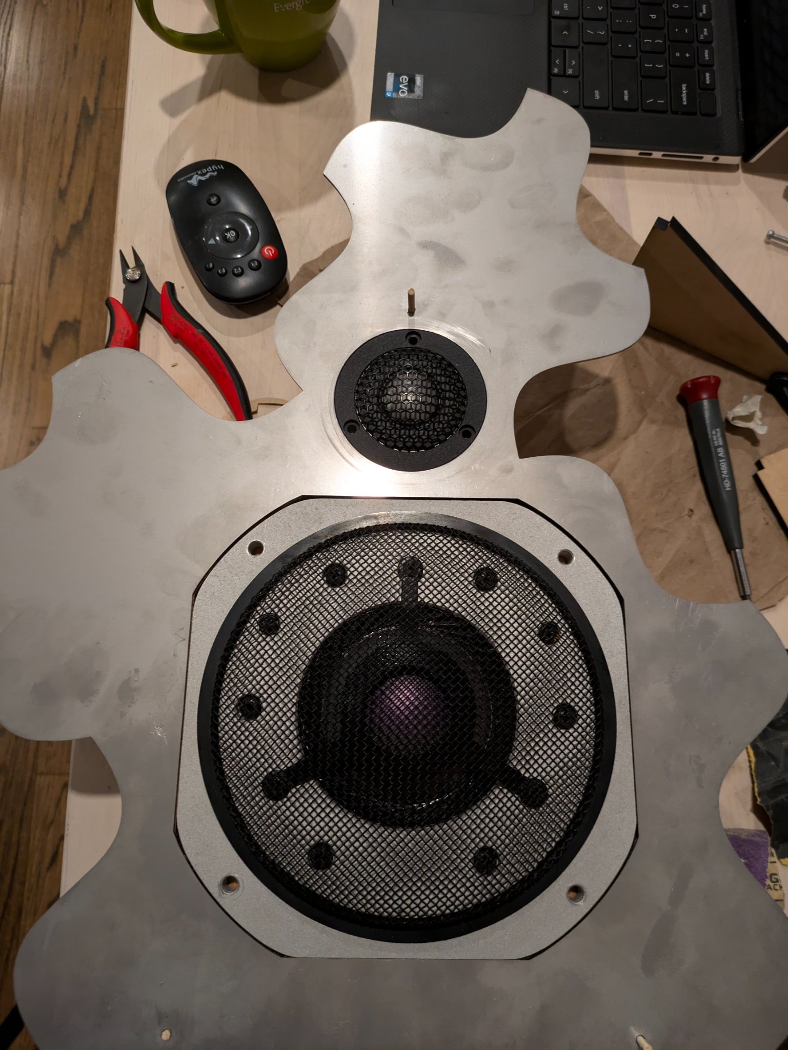

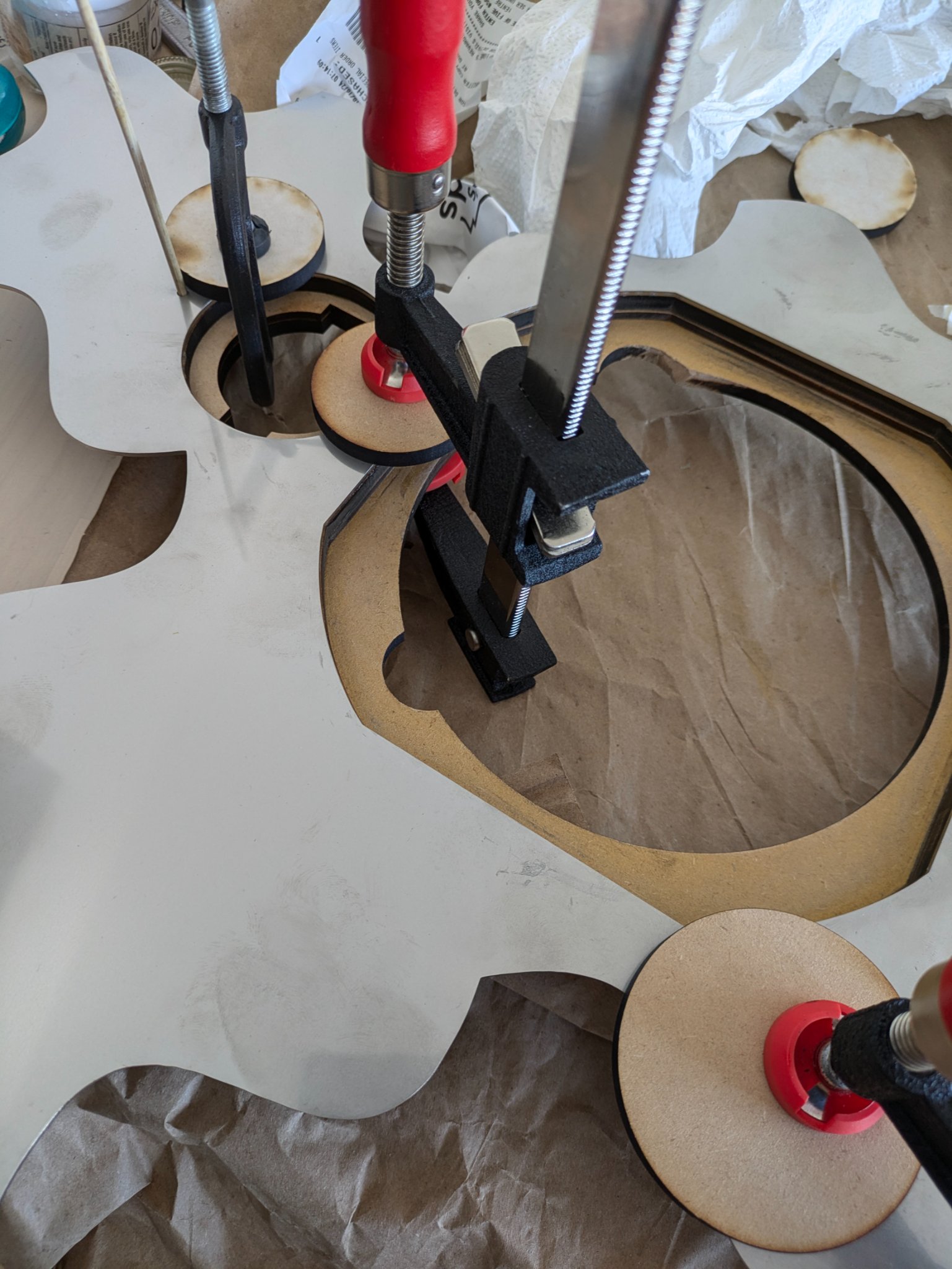

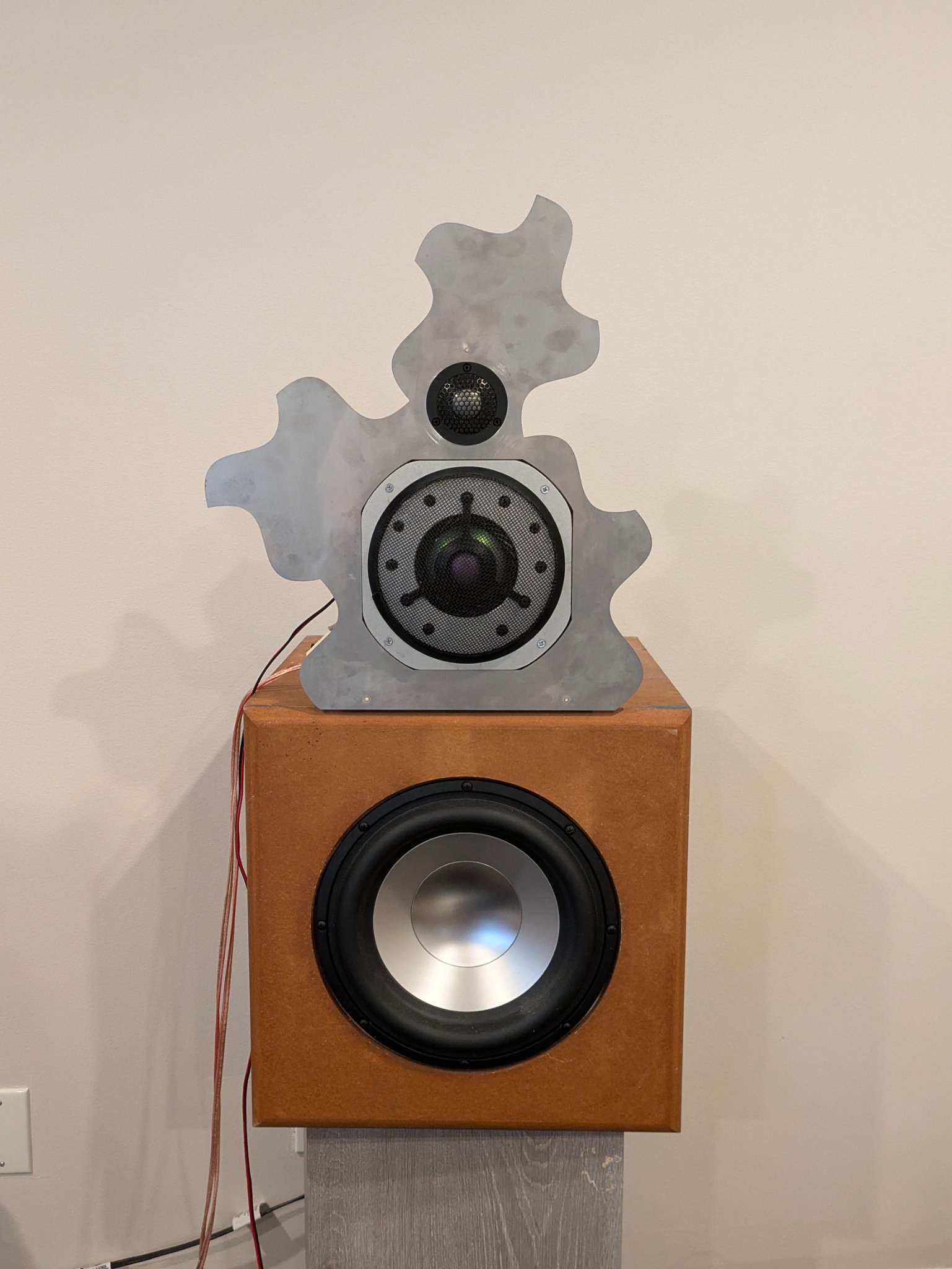

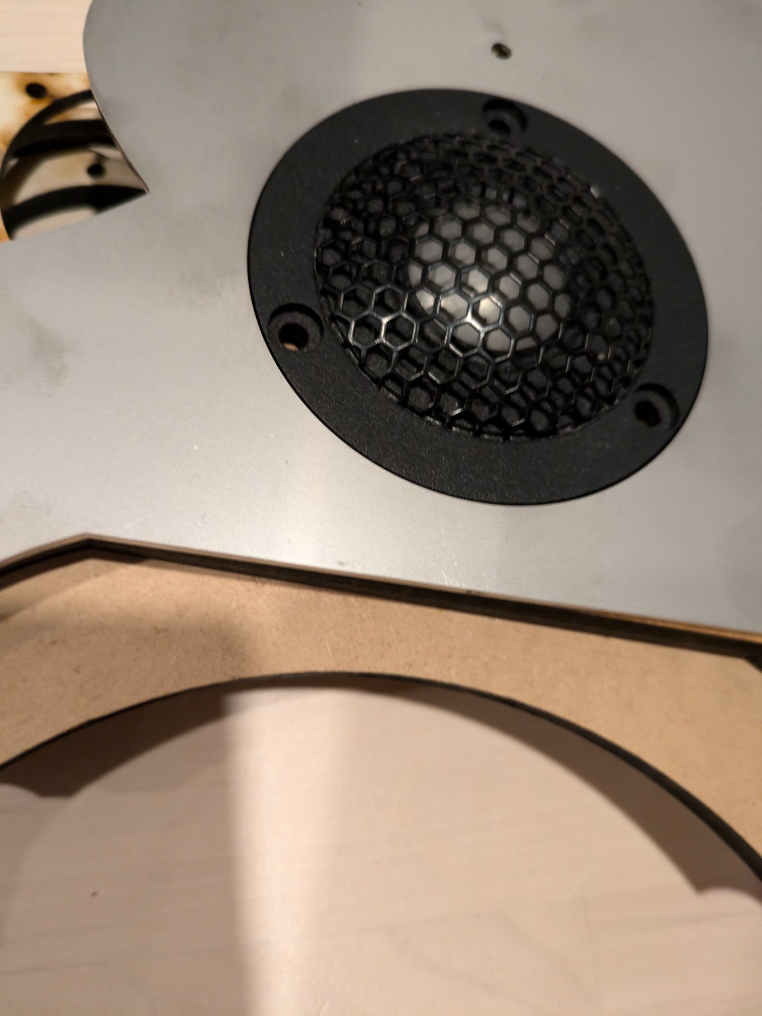

Waiting for the loctite power grab to sit for 24 hours. I did an pretty good job at estimating the ja0801. I am a little bit off in the corners- like 1-2mm. It looks crazy with the stainless baffle.
In a little bit I'll see what the tiny plate does behind the yammy.
Reactions: mikessi

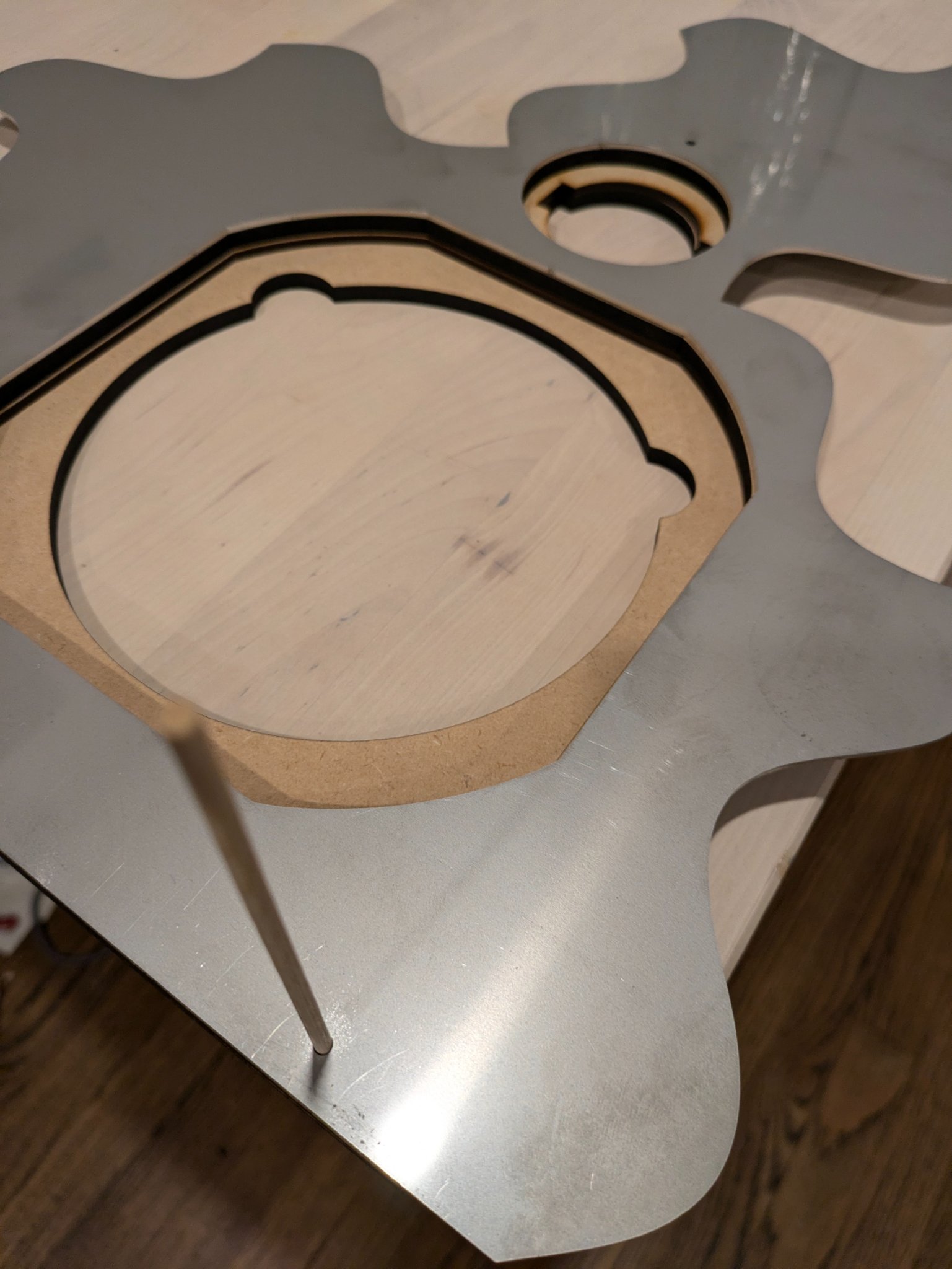

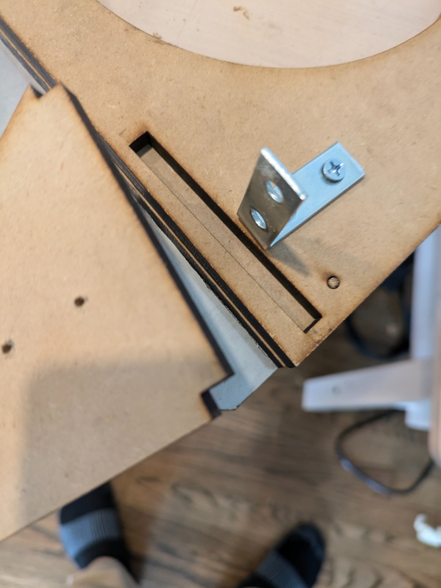

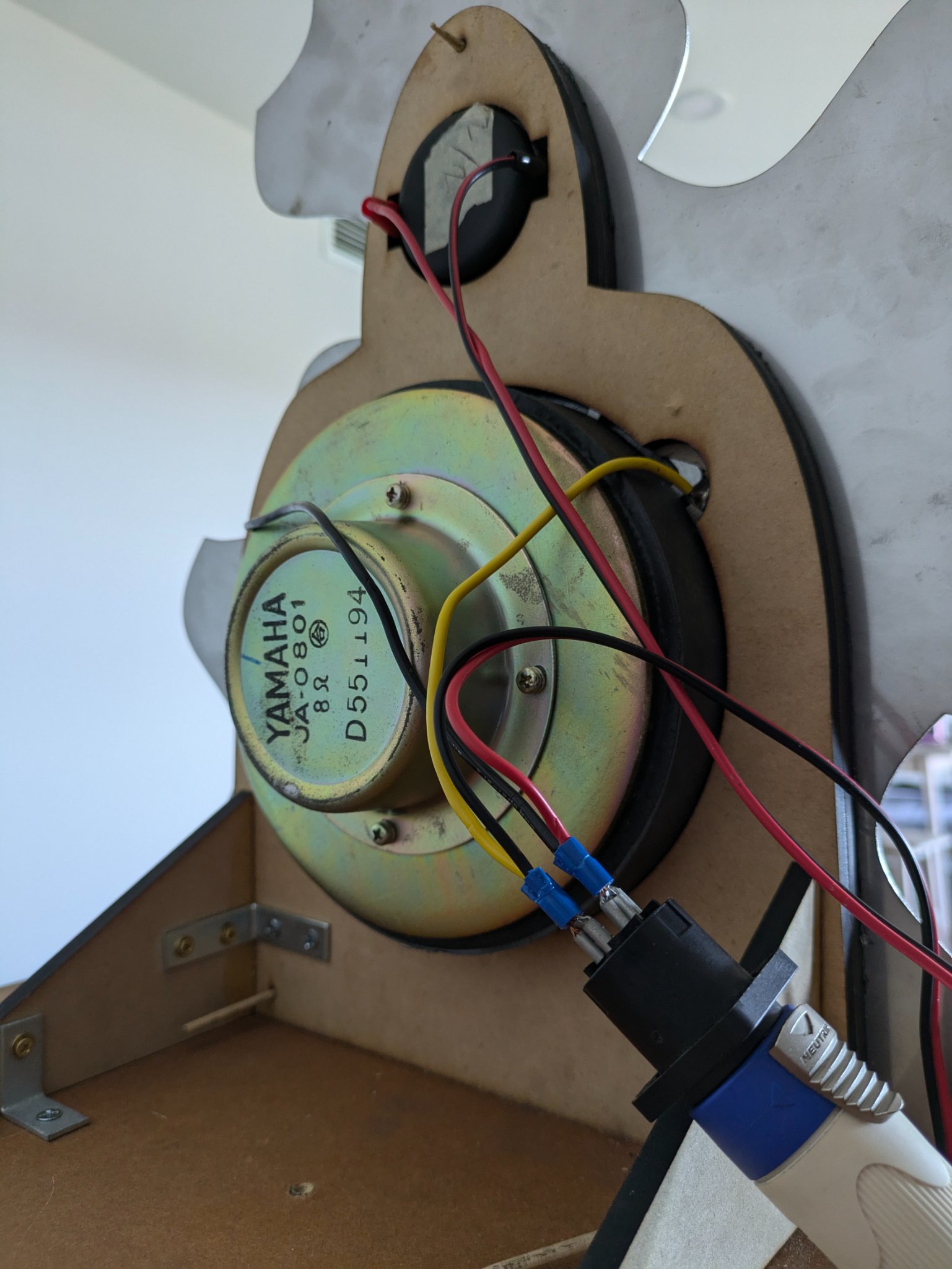

The baffle is mostly glued up. The only thing left to glue are the rear stands. I also need to put in some metal braces to hold it to my bass box.

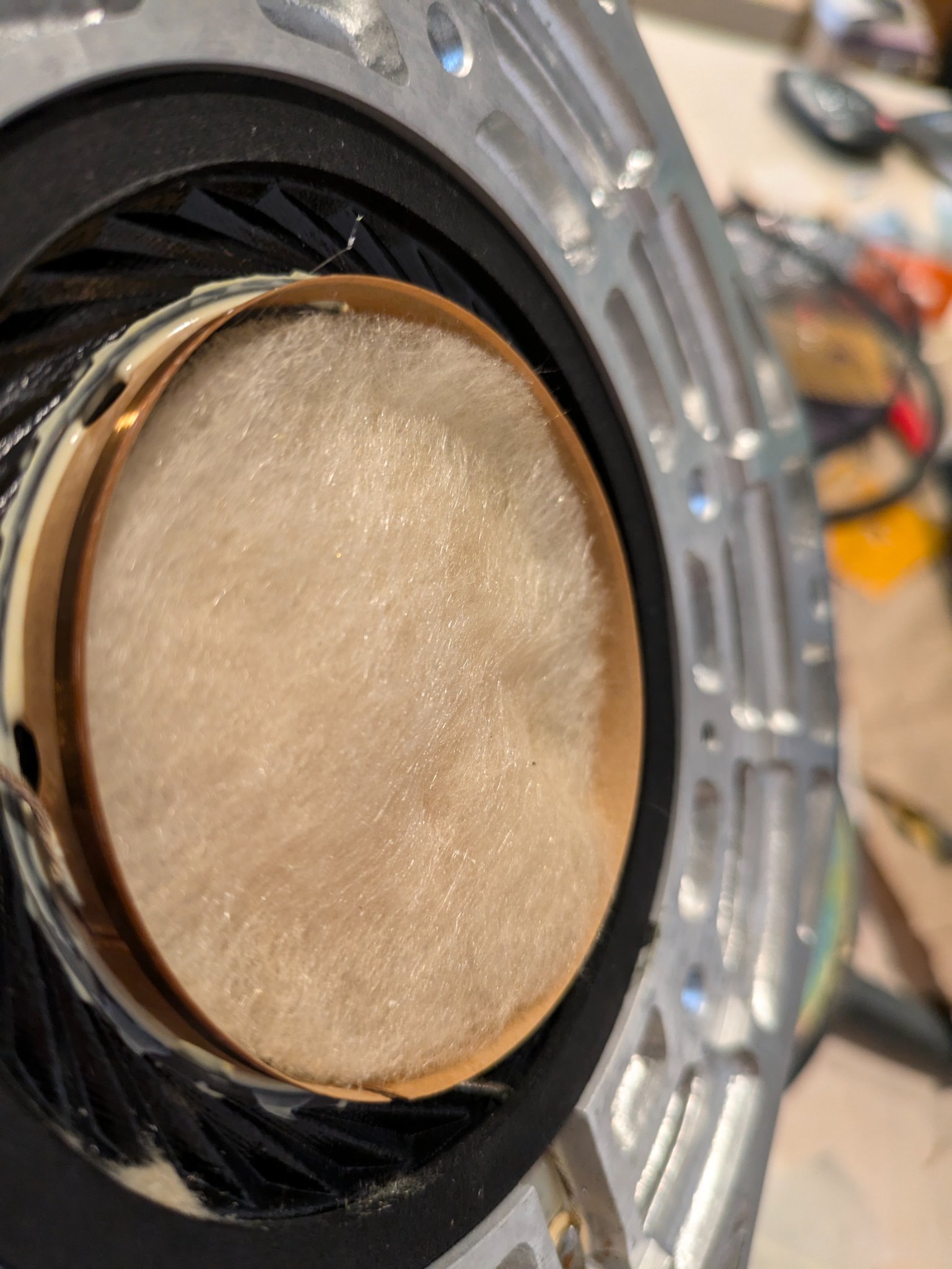

I got the baffle all put together, hooked up the amps, played some music:
And then the amps went into a red light power protection... AAARGHHH!

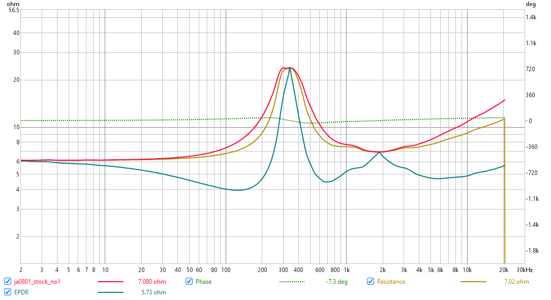

Glad the hypex amps did something to protect the driver but WFT I tested this driver when I got it? I once purchased a driver off ebay and it did the same thing: as the volume went up the fault protection would go off more.

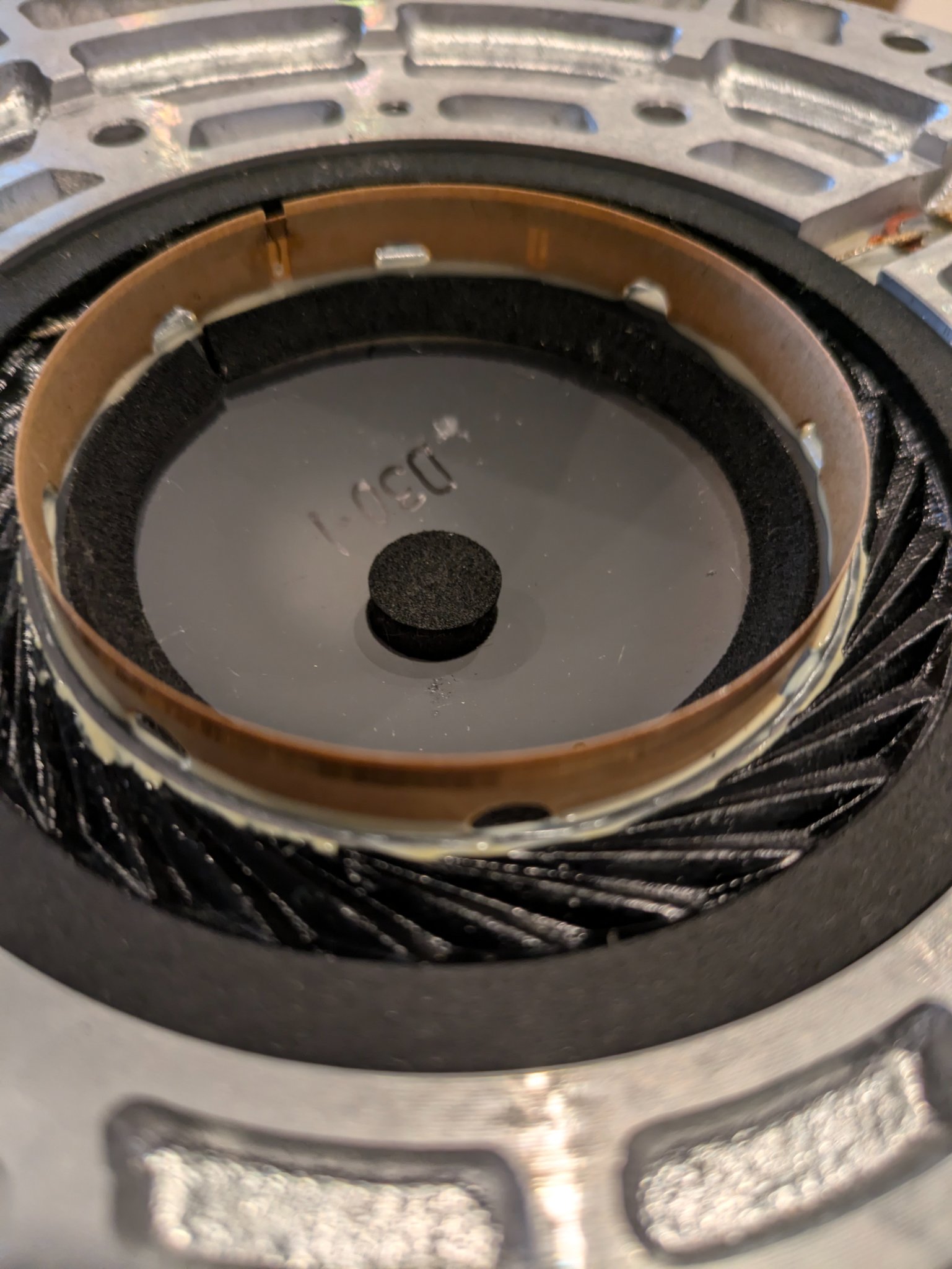

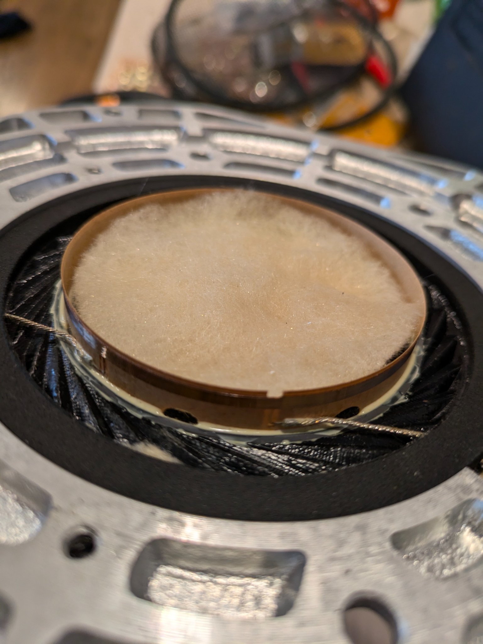

After watching a video on how to clean the drivers:
I took the JA0801 apart and was hoping to see a messed up voice coil.

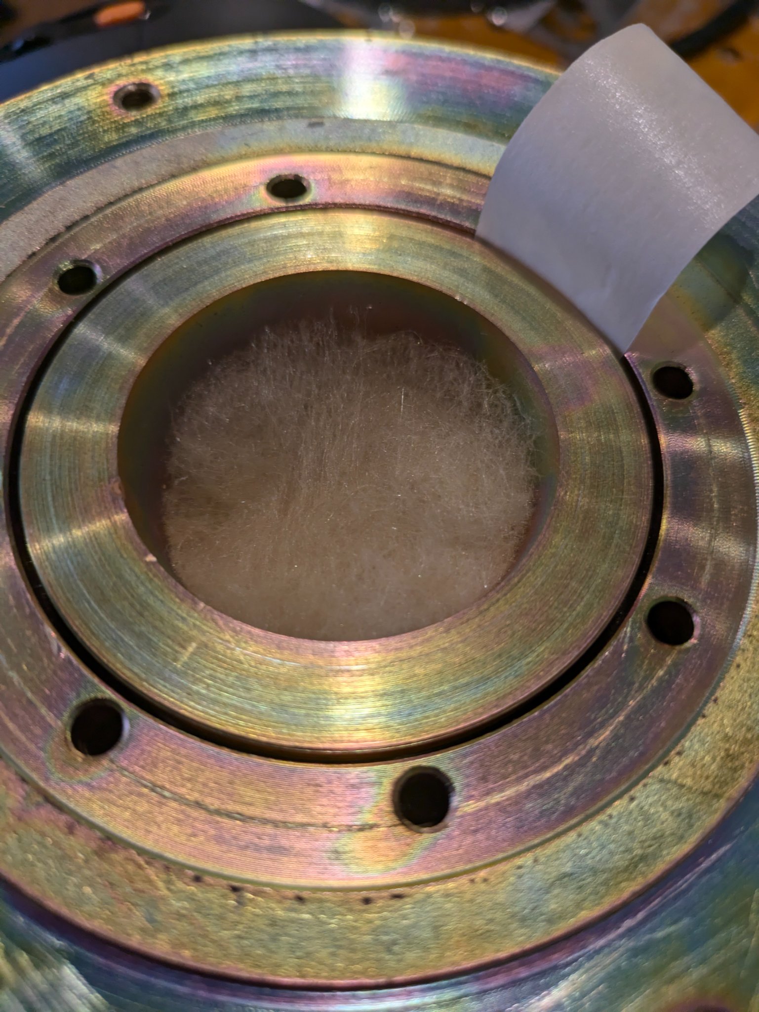

The coil looked fine?!?! The cleaning video gave me the idea of cleaning the magnet. So I stuck some tape in and there were some small chunks of something in there. The coil must have rubbed up against it because it all worked after cleaning.
Tape was used to grab anything stuck in the gap.

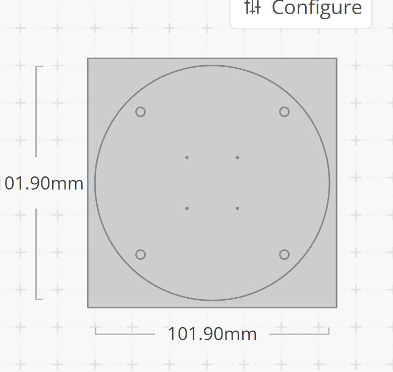

I did learn that the holes between JA0801 are not quite aligned the same. So each baffle is made for each driver once the holes are drilled.
I might make a felt layer the goes on top of the baffle but wont decide until a test on a smaller baffle. The stainless is a fingerprint magnet.

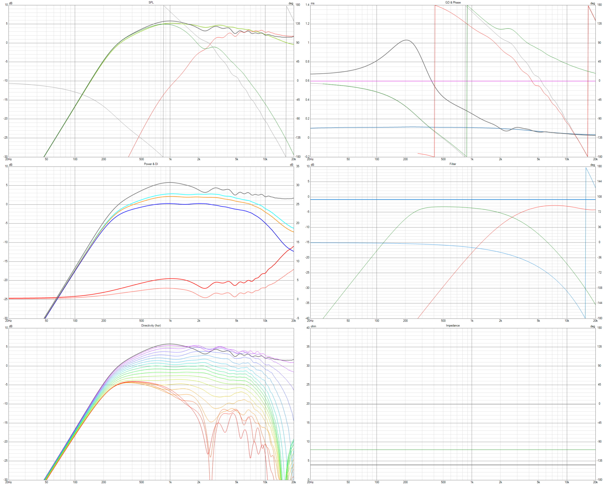

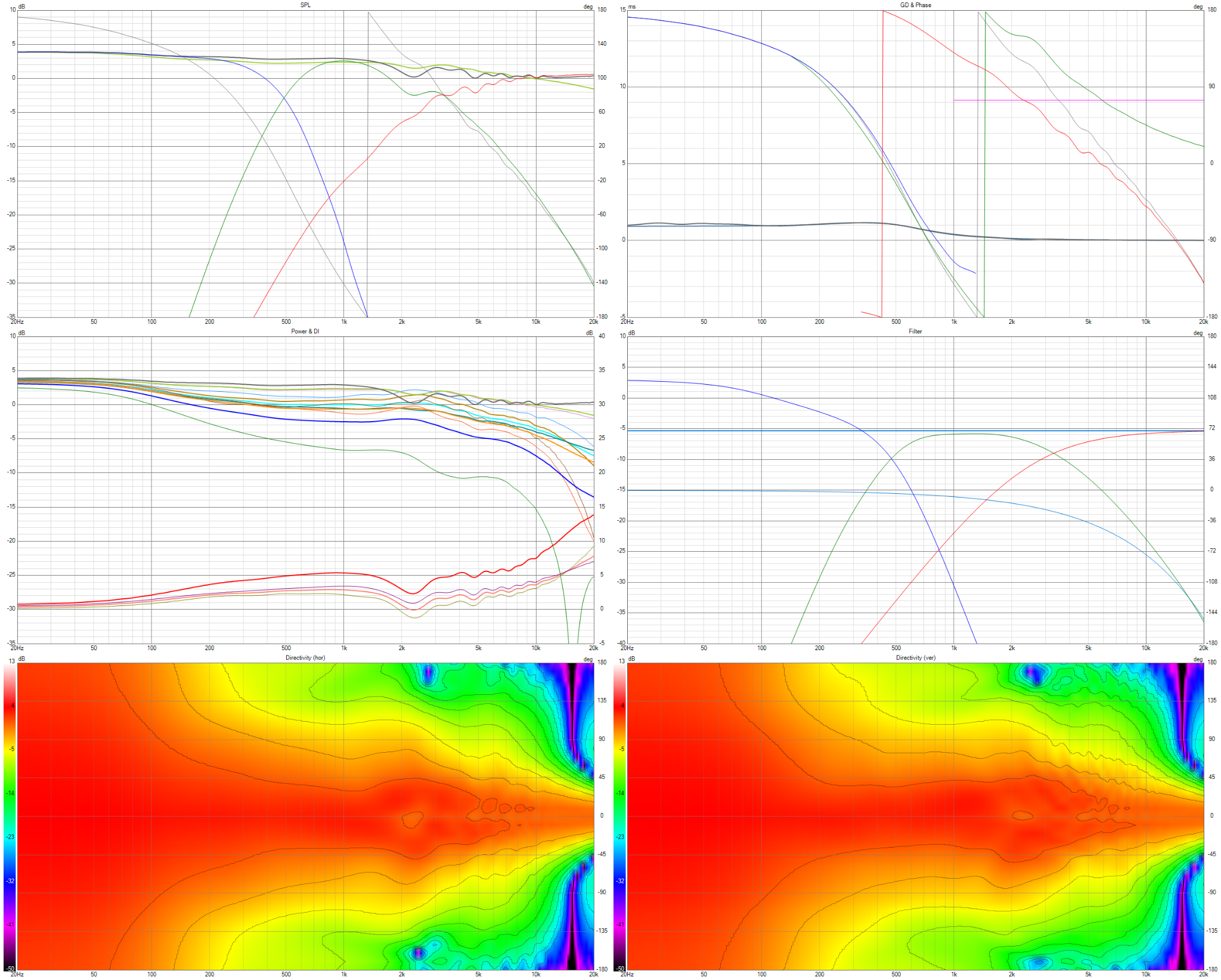

Ok, I have a rough XO for an ideal sim:
This xo is based on nothing more than the SD and baffle so reality be different.

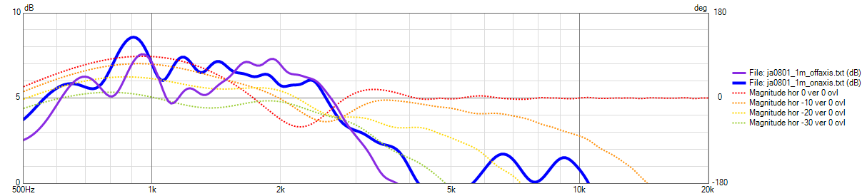

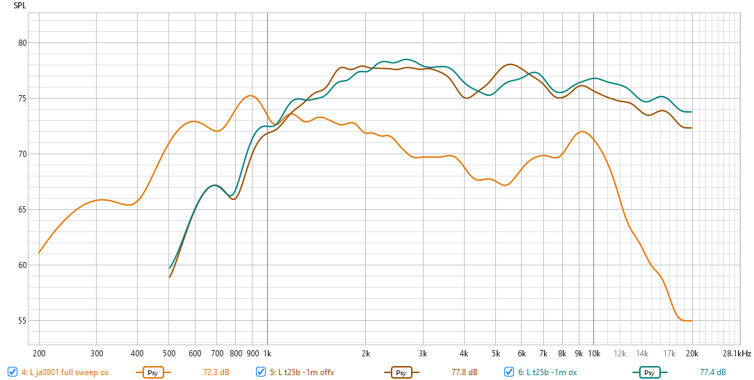

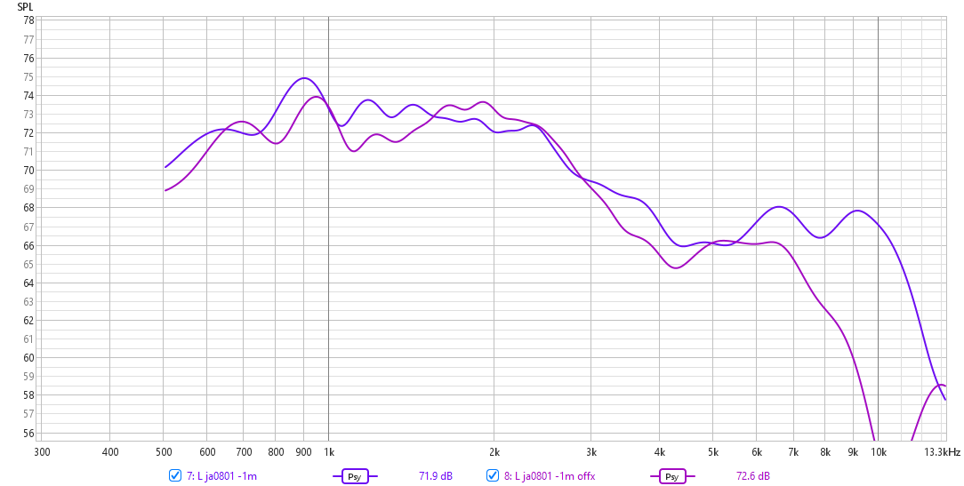

Now some real measurements:

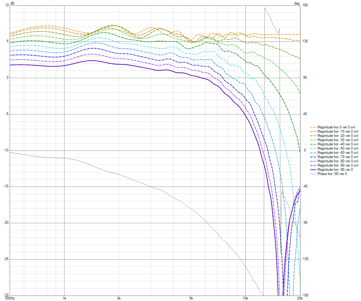

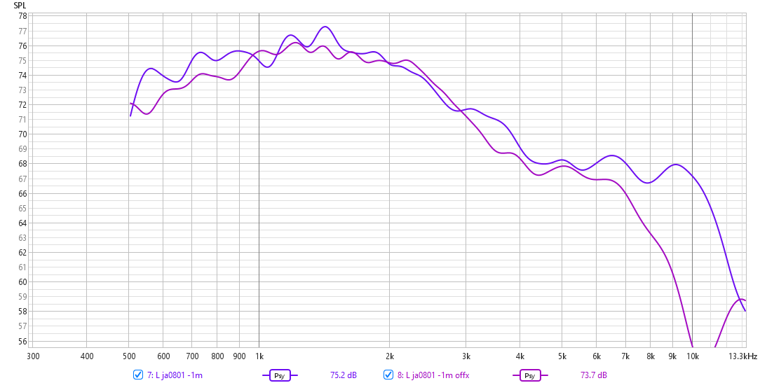

Reality vs sim for the ja0801:
The above shows a sim polar vs an on and off axis measurement with a 5ms gate. The sim=dots, real=solid.
I am not as experience as many of the designers here but I think this is odd. As the gate goes up, it seems more flat:
The t25b and ja0801 both calibrated separately. There was a 1db difference between them. The t25b was louder.
I never expected this to be a design that is shooting for a flat response. My main interest is a chaotic decay. It seems to be doing that so far. EQ'ing will be interesting.

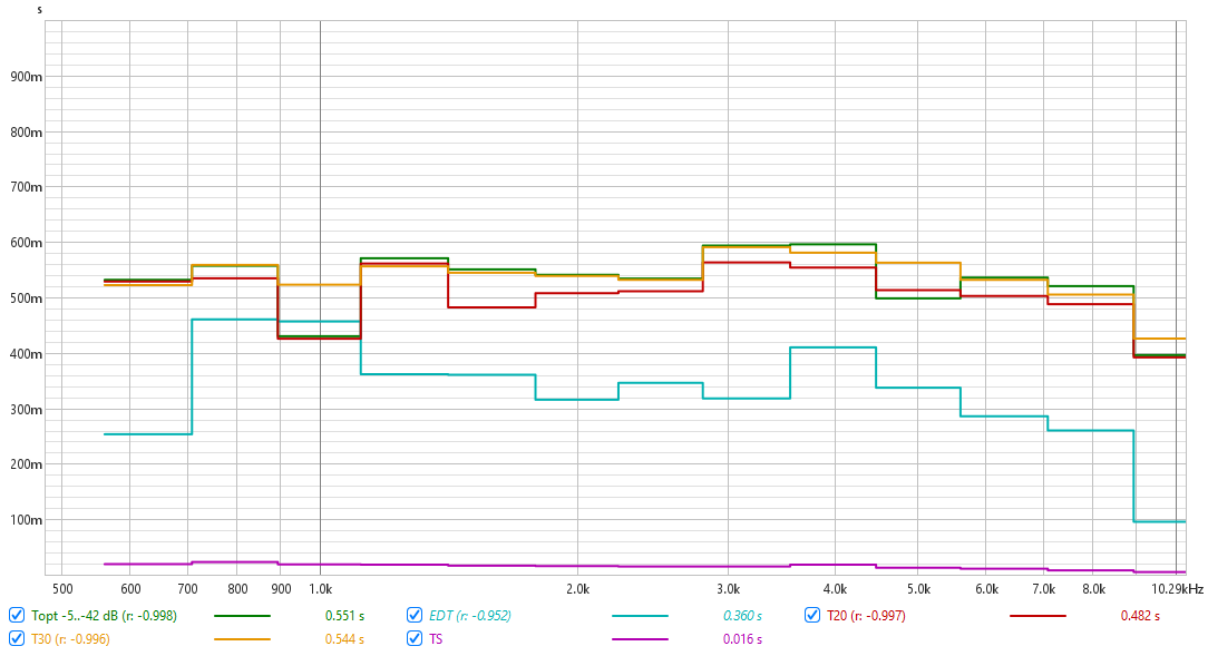

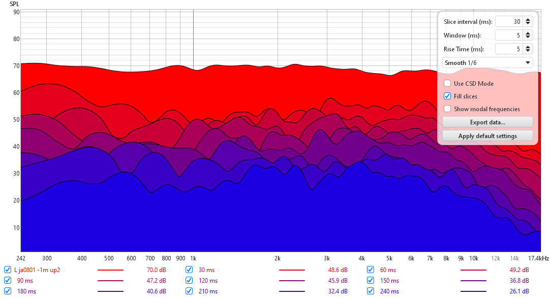

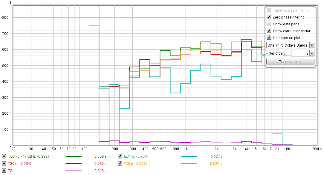

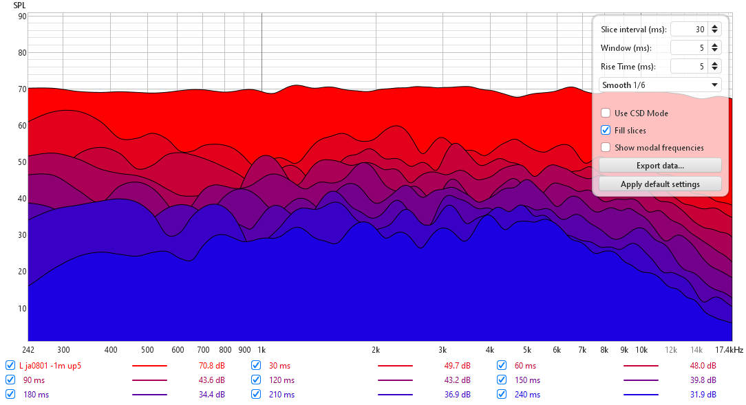

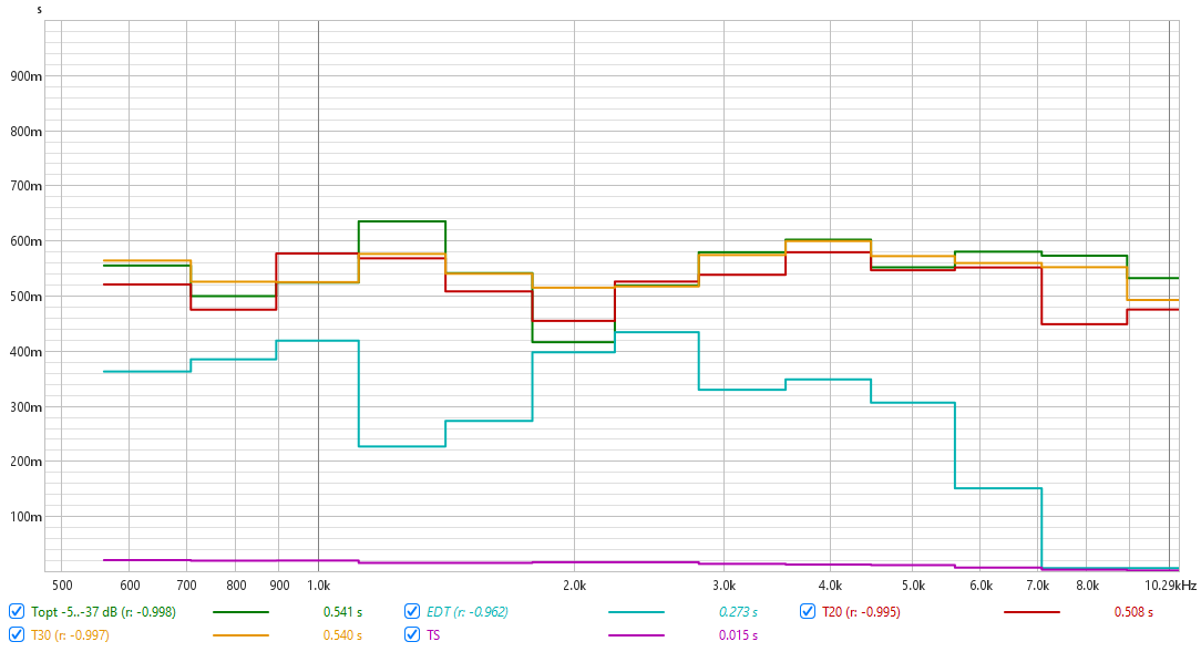

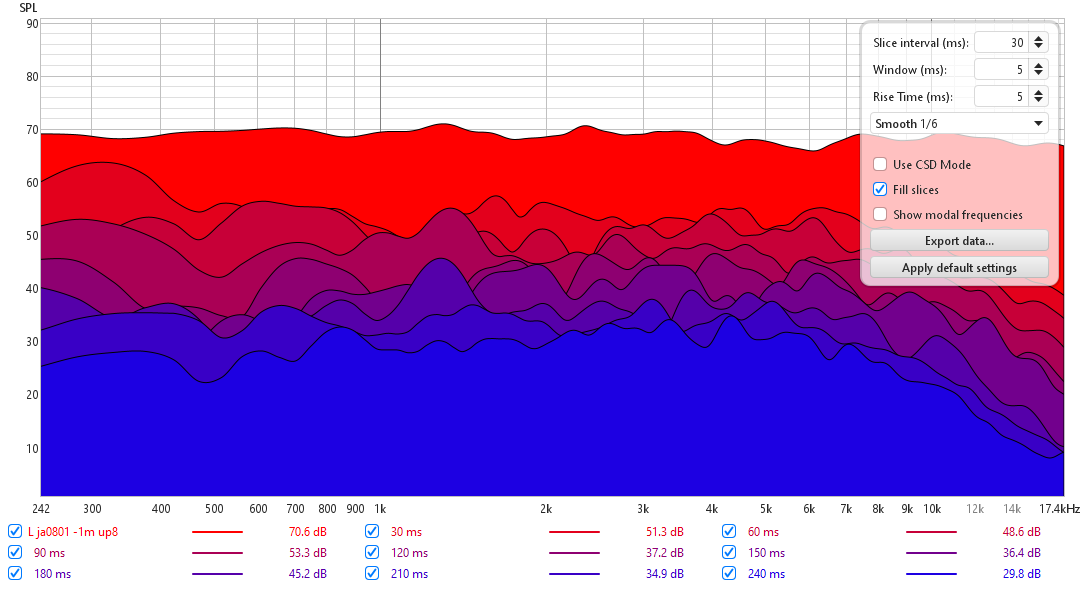

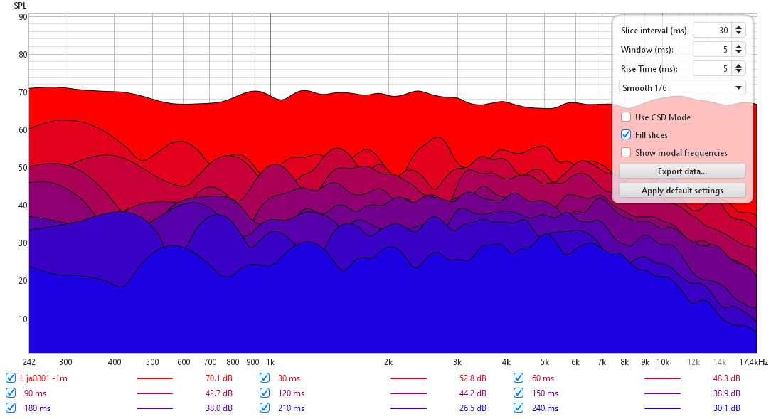

The decay was something that interested me about the shape. The foam baffle had this decay at 1meter on axis:

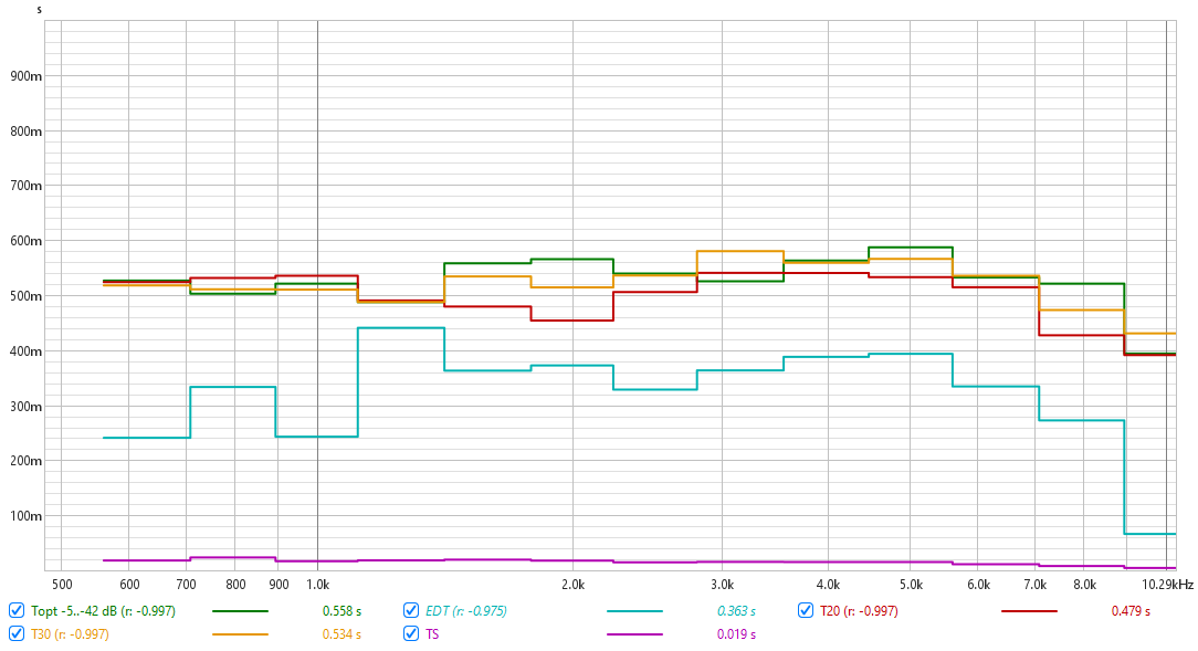

The new baffle has this decay at 1m on and 40 degrees (or so) off axis:
It is a 500hz on up sweep.

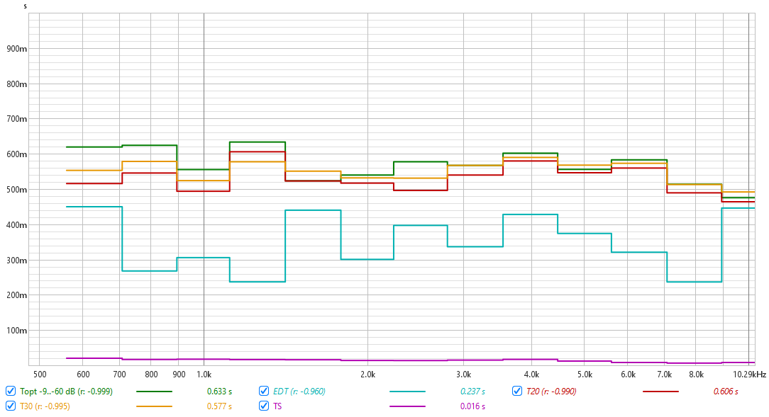

The t25b at 1m on and off axis:
Also, a shot of the back of the baffle:

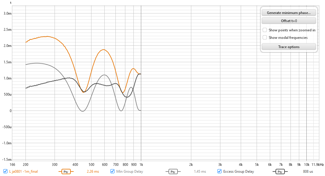

It looked ok but I need to review the timings on the XO. Right now there is no delay on the ja0801 and there should be to match the L26ROY. This might account for the odd GD.

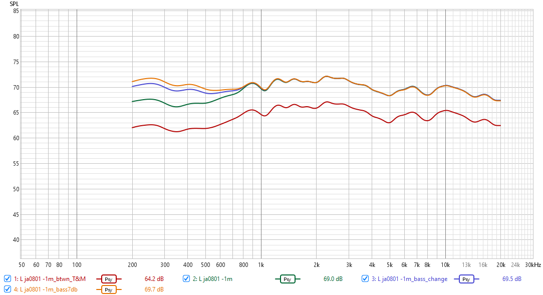

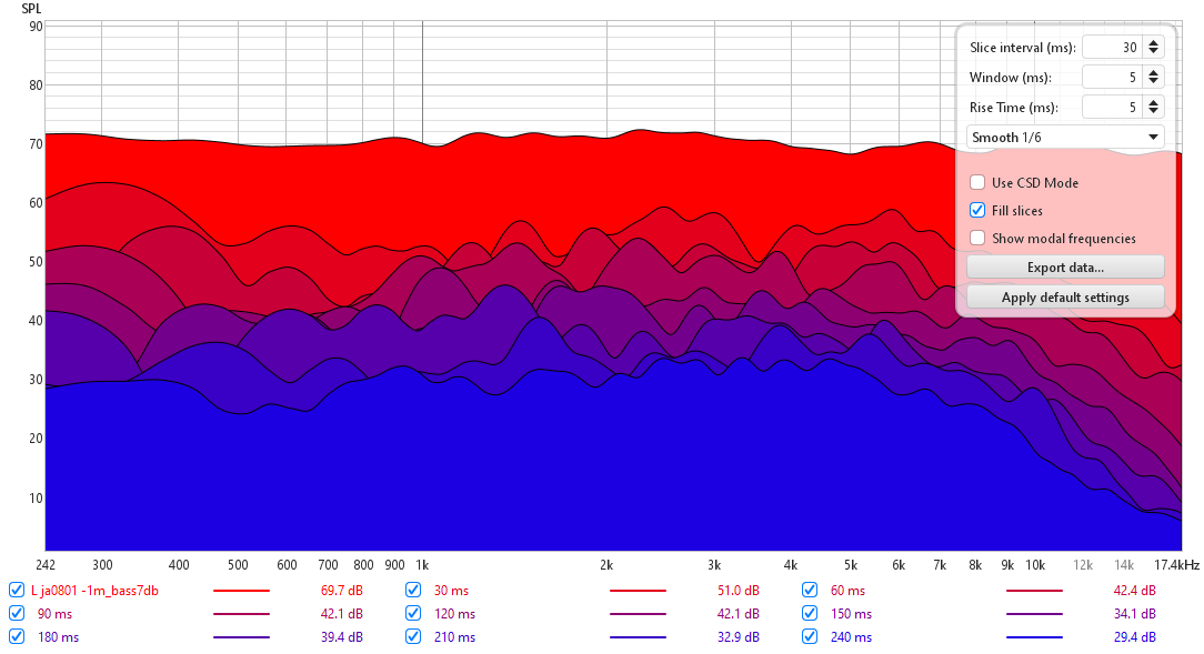

All measurements were taken at 1m and between the mid and tweeter.
Bass needed a boost. I will need to do things the right way to get a better look.
The decay looks pretty good. My previous designs all had some mess in the decay. This looks pretty good.

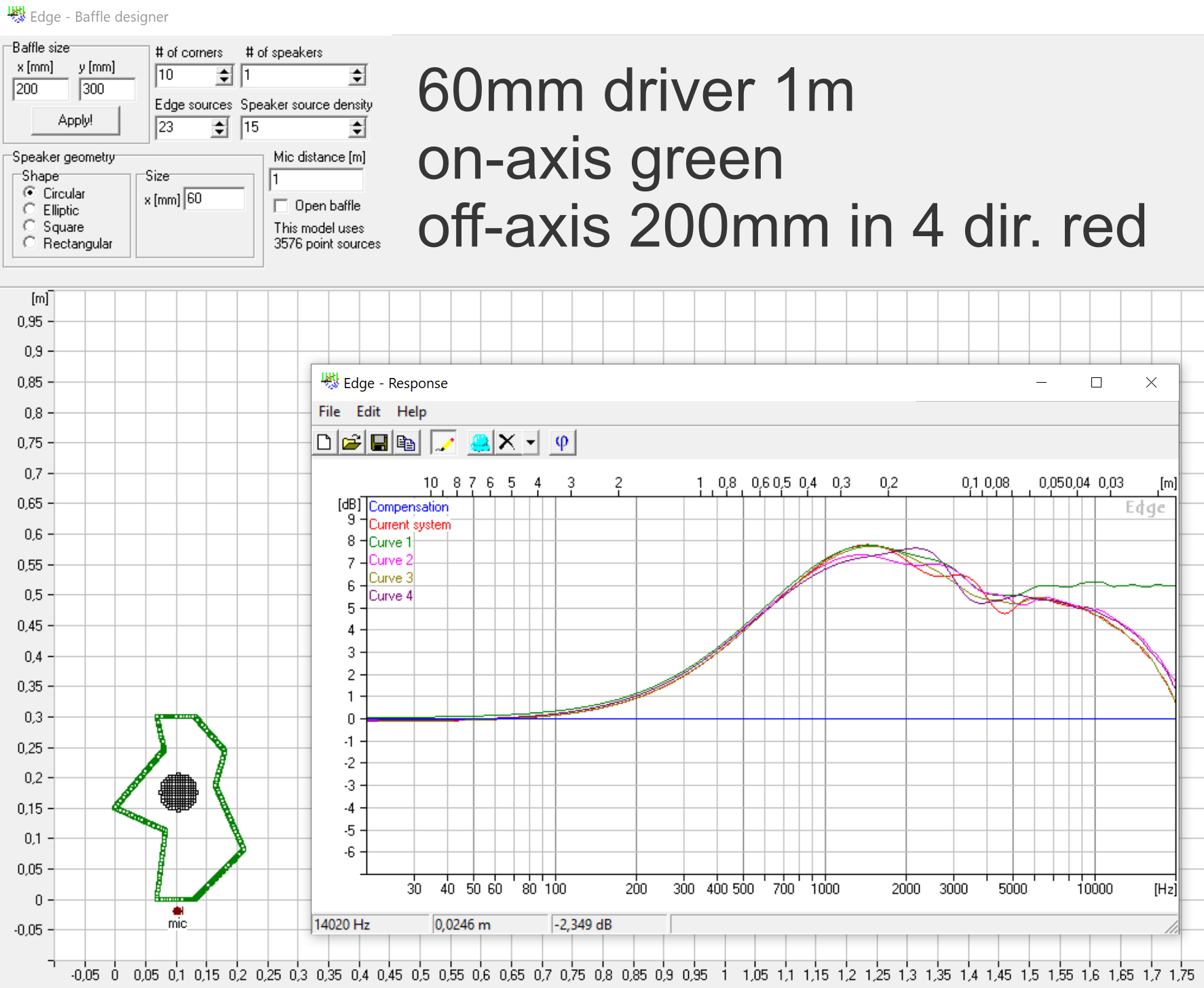

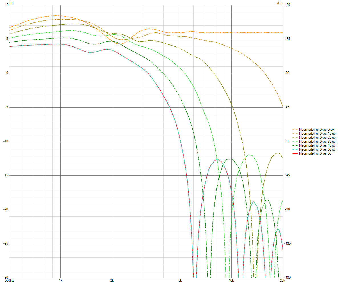

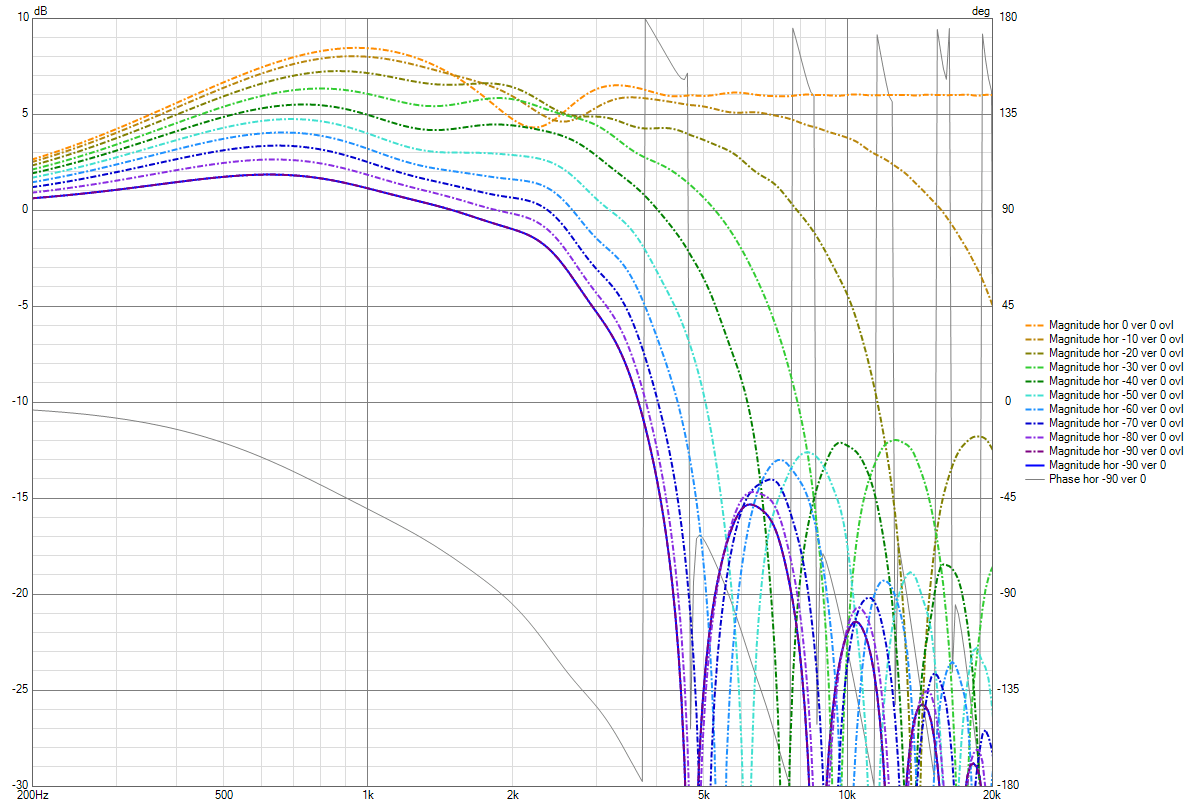

Seems like the major issue still is directivity widening 2-3kHz in hor. plane. It influences decay too, most prominently in a room at listening listance (instead of anechoic chamber).
Have you measured or simulated vertical off-axis behaviour? Does vertical off-axis spl have a dip where hor has boost?
Edge sim of asymmetric baffle off-axis in four directions below. VCAD2 can sim multi-driver directivity too, but it takes more time to do...
Reactions: HeadShake
Hey! There is some extra power in the decay for the range but it is not ringing like my smaller rectangular speaker. (although the issue was baffle + pushing a driver lower than it wanted to go).
The vert sim has a dip. I actually wanted a dip. But the phase plug on the JA-0801 is the monkey wrench.

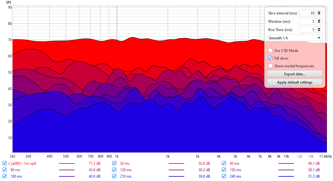

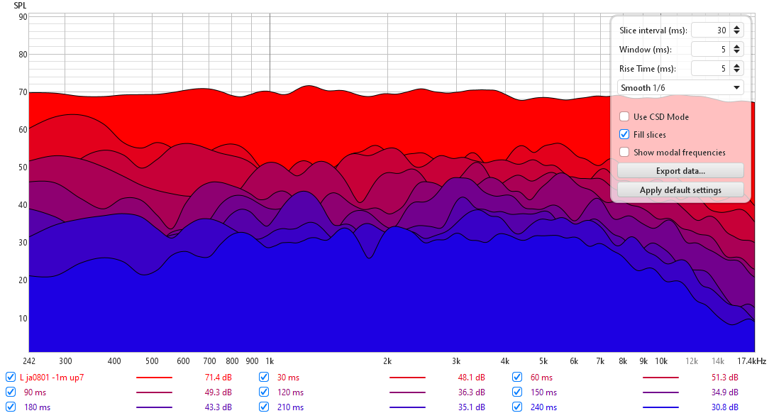

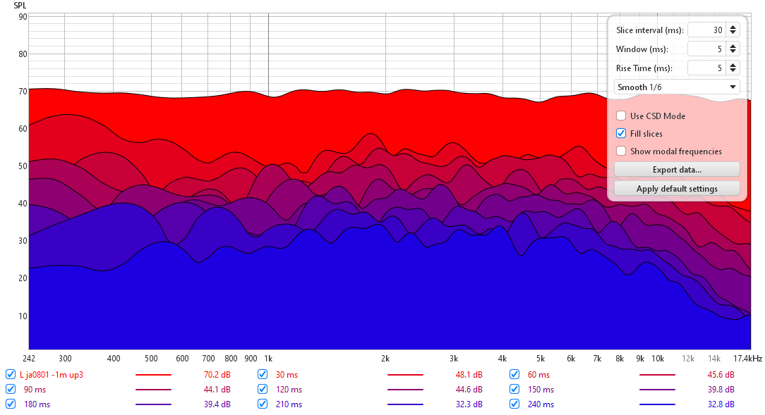

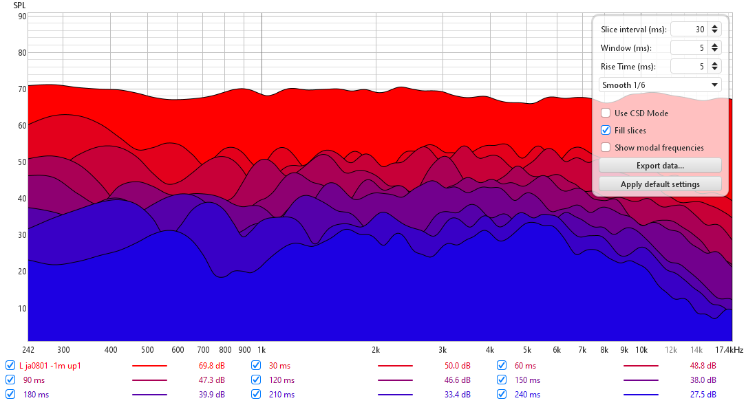

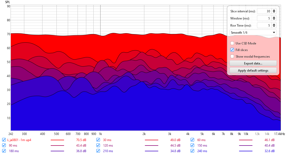

I did a quick vertical series of measurements. They starts at the mid and move up the baffle at 1m. The last measurement is just past the baffle.
emperorL26ROY_1m_5ms_vert0.pngemperorL26ROY_1m_5ms_vert1.pngemperorL26ROY_1m_5ms_vert2.pngemperorL26ROY_1m_5ms_vert3.pngemperorL26ROY_1m_5ms_vert4.pngemperorL26ROY_1m_5ms_vert5.pngemperorL26ROY_1m_5ms_vert6.pngemperorL26ROY_1m_5ms_vert7.pngemperorL26ROY_1m_5ms_vert8.png
The noise floor is around 30db. It looks fairly random to my eyes. My ears don't find it sibilant in any way. If this was my other design, the ringing would show up in more than one measurement.

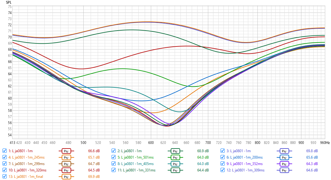

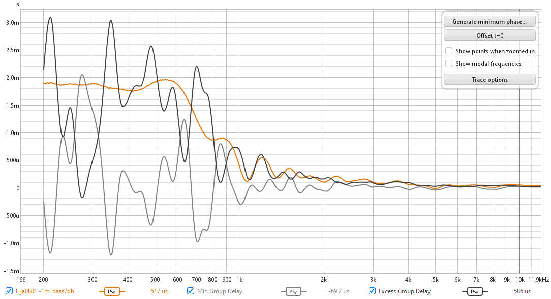

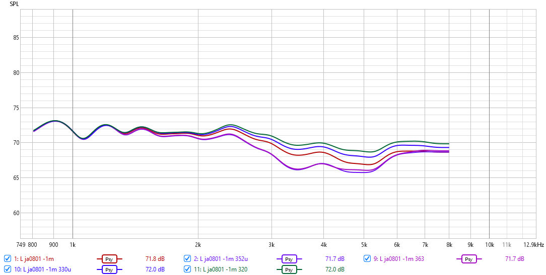

I did some alignment of the bass to the mid. It liked 320u.

I am happy the LR12 was what stood out from the ideal driver sim. The reality looks better than what was predicted. I do have some eq on it though.
Determining when a LR12 is at its best spot seems to be another matter. I will need to balance the on-axis and off-axis to determine if I am using enough delay. Listen to music and flipping between settings is also something to try. I wish an LR12 w as as easy as an LR4 where you can invert and look for the lowest dip.
