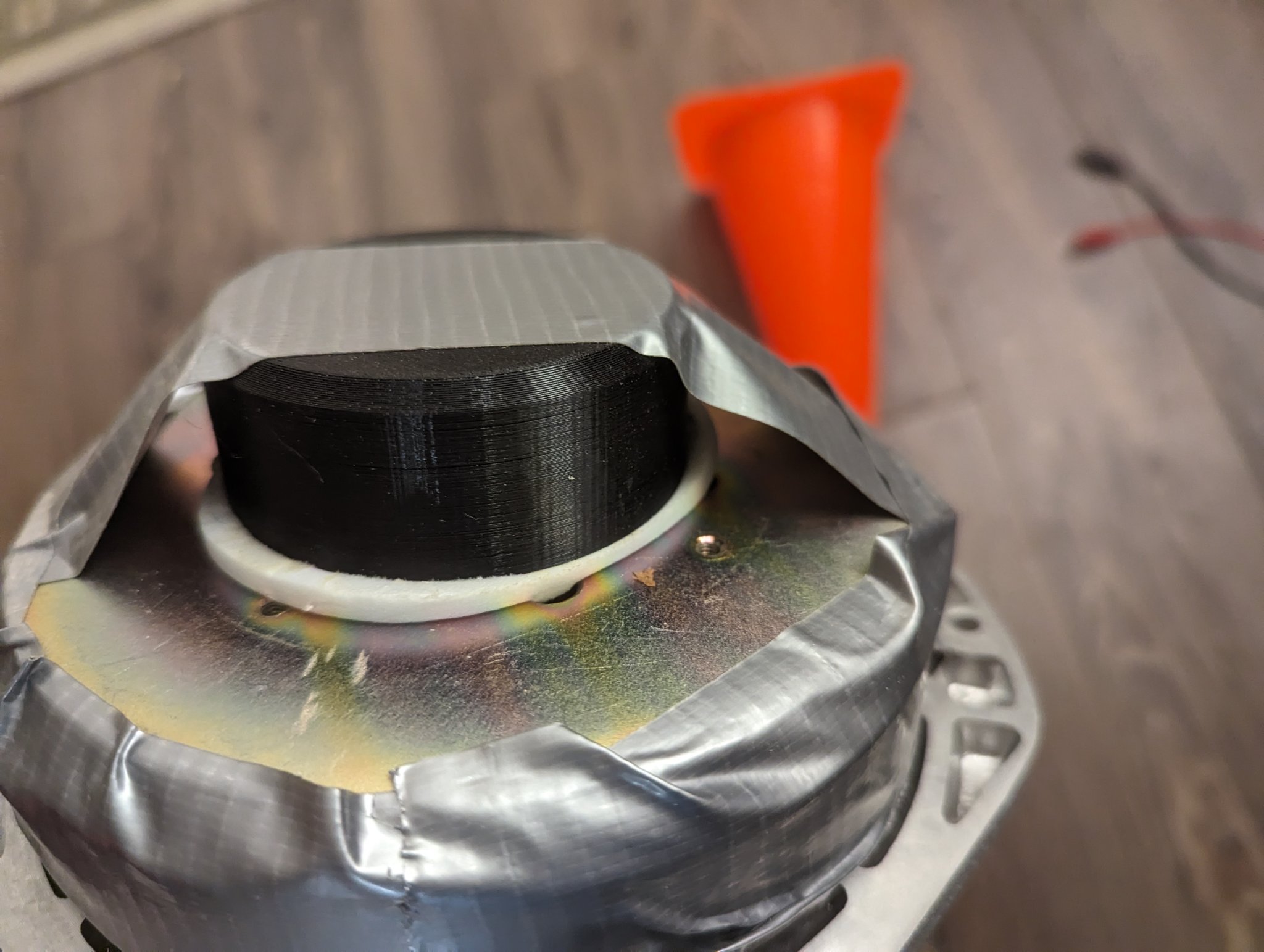

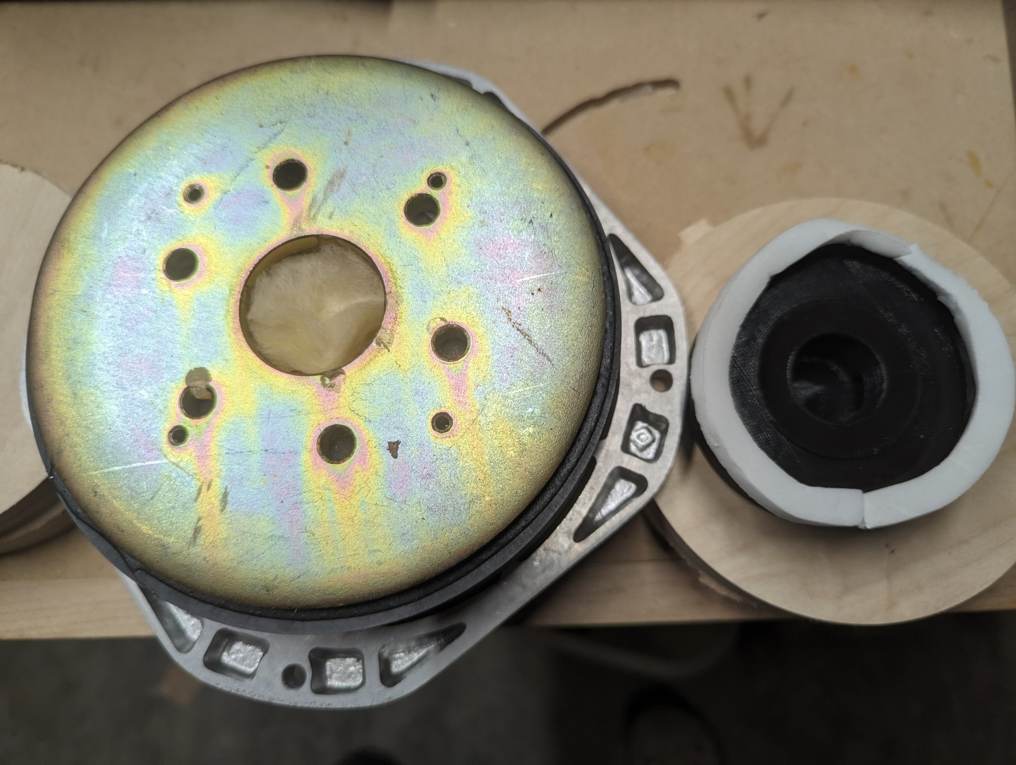

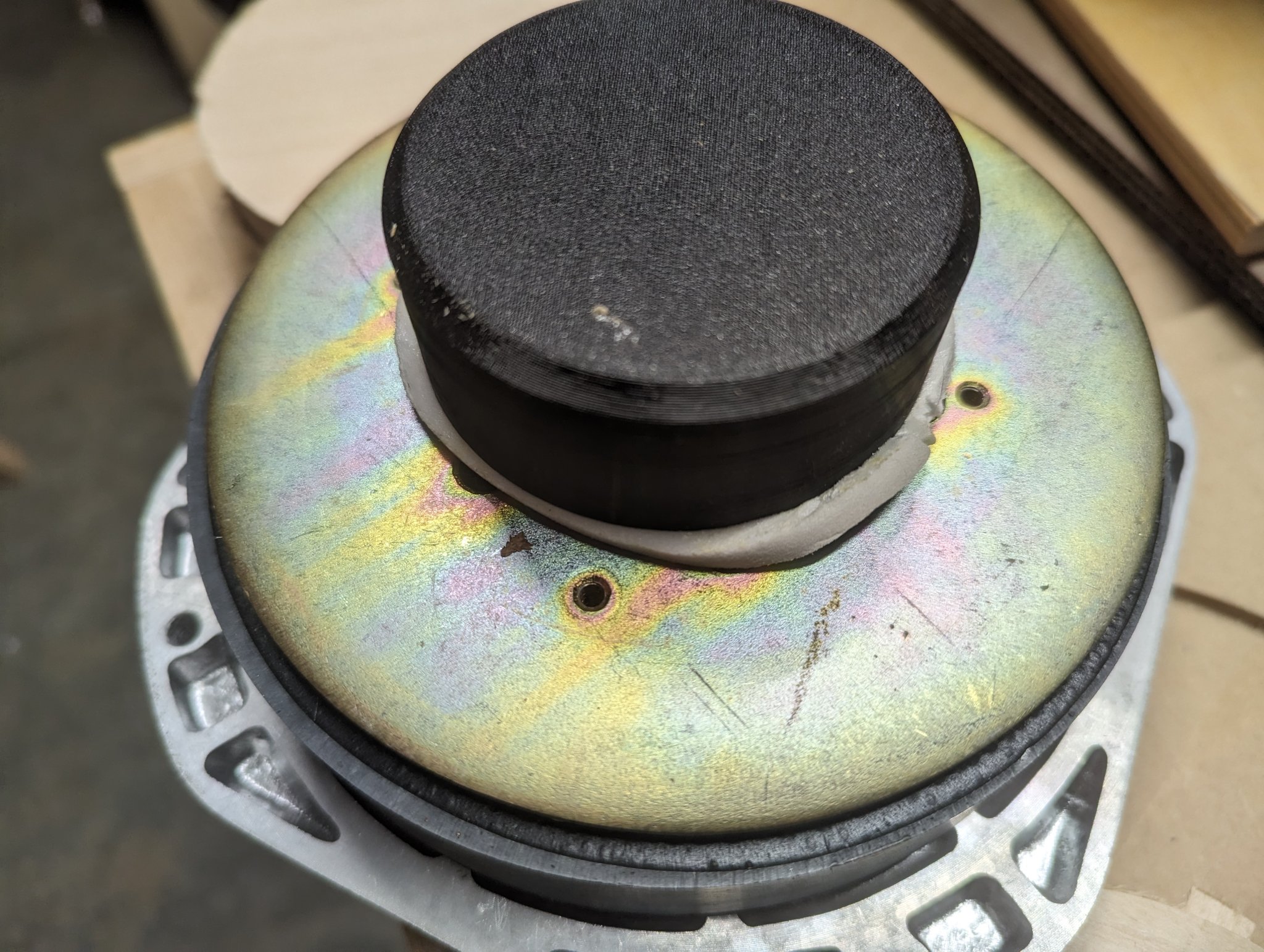

Squeezed a bit of time this afternoon to mess with the 3D printed meta-puck ( :LOL: ) for the SB26 on the Yamaha BE mid dome.
Didn't trust myself to remove all the fiberglass out of the center hollow w/o damage to the dome so left it in place. Lined the edge of the meta-puck with weather stripping foam.
Used duct tape to seal around the mating. Not perfect, but probably good enough for a quick test. (In the background, you can see the "traffic cone" used in previous tests.)

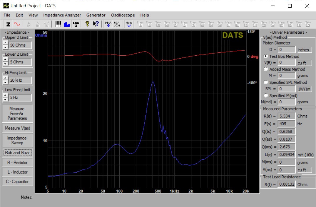

The results were not great. Fs went up in frequency to 405 Hz, and a secondary peak appeared at 90 Hz as well. Obviously, the resonant frequencies of the meta-puck are not ideal for the Yammy mid dome. Will have to ask @Patrick Bateman about the specifications of his SB26 puck.
And get one designed for the JA0801
Reactions: 1 user

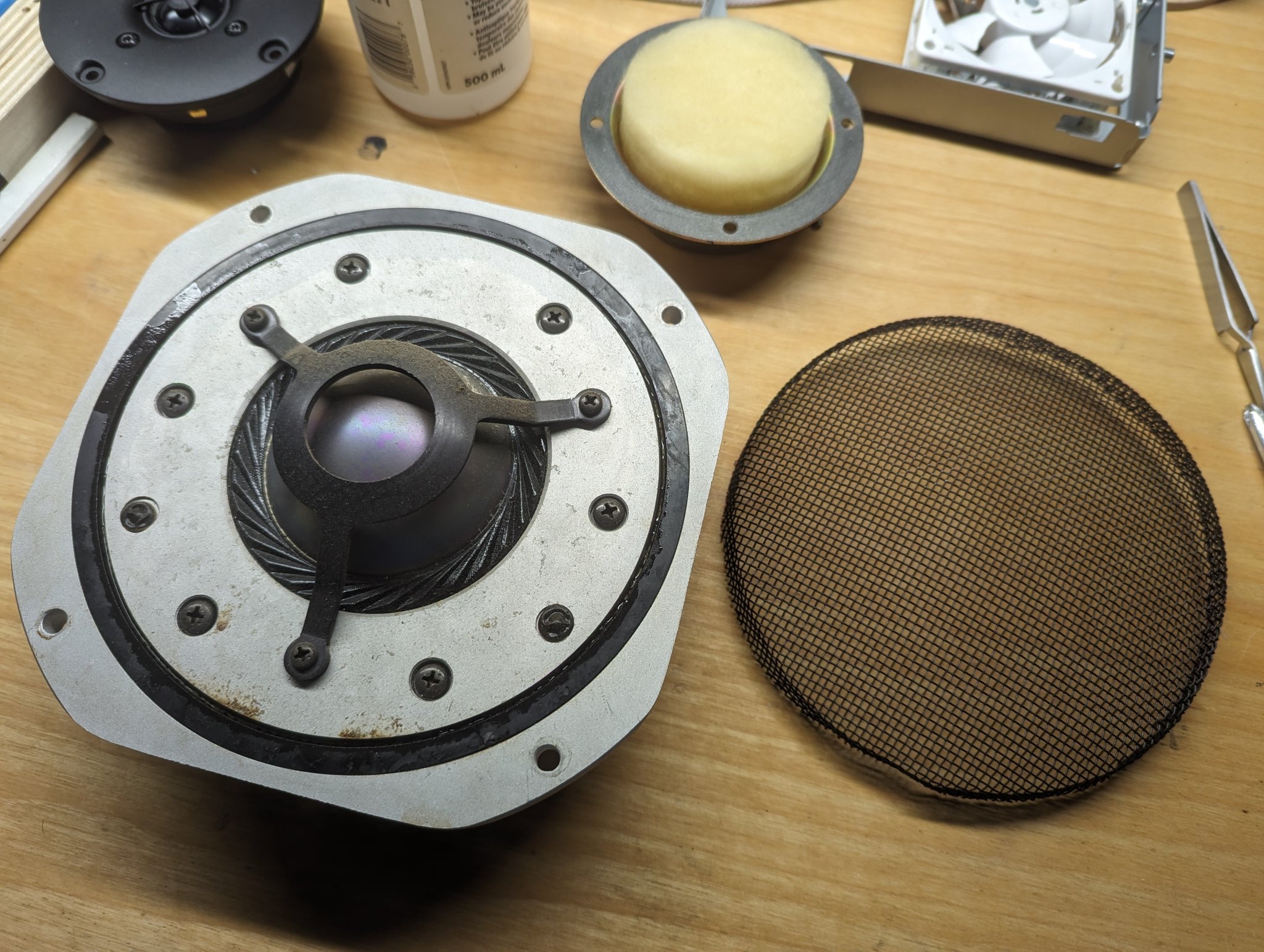

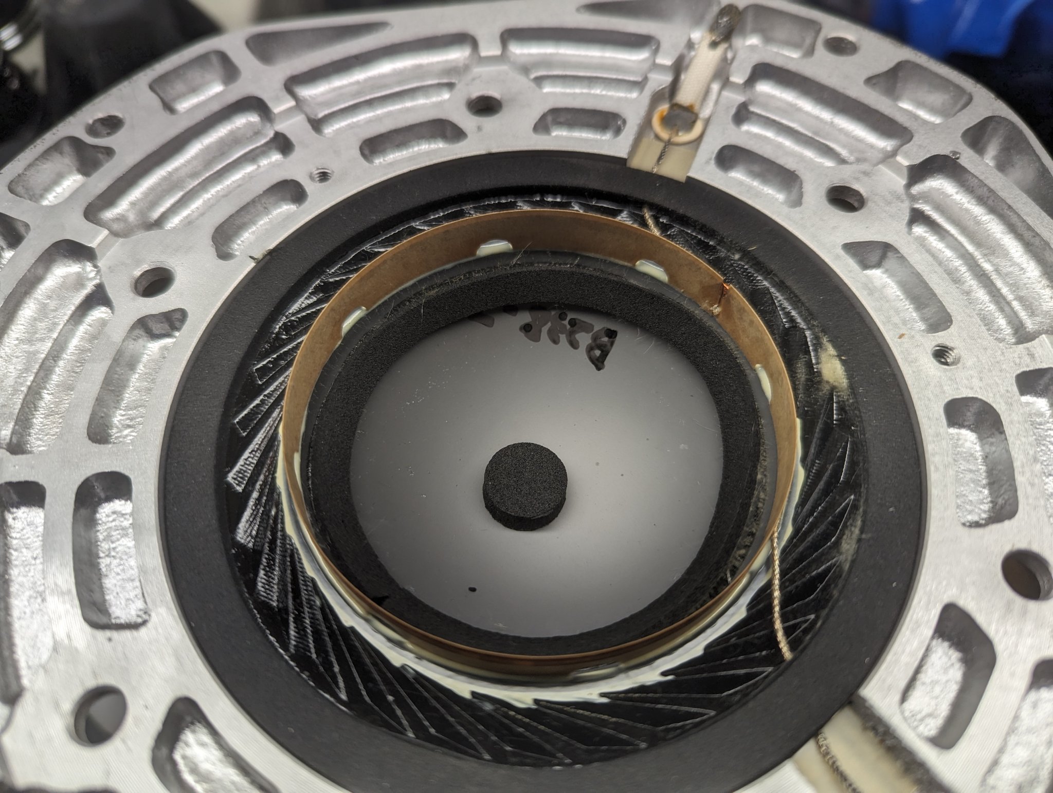

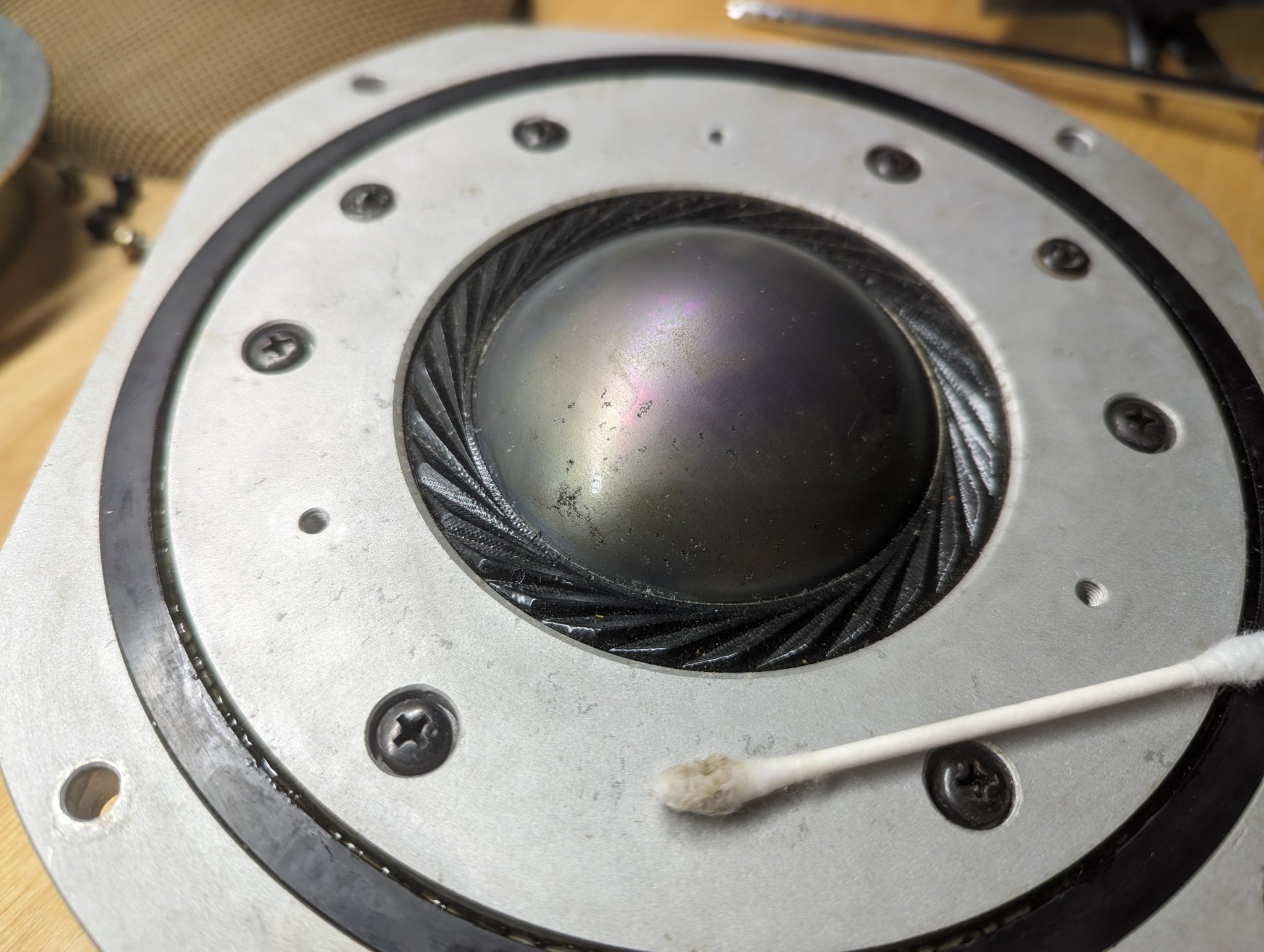

Since I already had the back off this JA0801, I decided go all the way. Used 99% isopropanol to soften the seal around the grill, then pried it off, like this fella on youtube. The rest came pretty easily. I figure these pics will help anyone else who's pondering what to do with their JA0801 -- whether to repair or mod.
Used alcohol on a shop paper towel & cotton swabs to clean off grime on what must have been the top side of the dome. Still some left but... Then took the rest apart. A medium Philips head screwdriver was all it took.

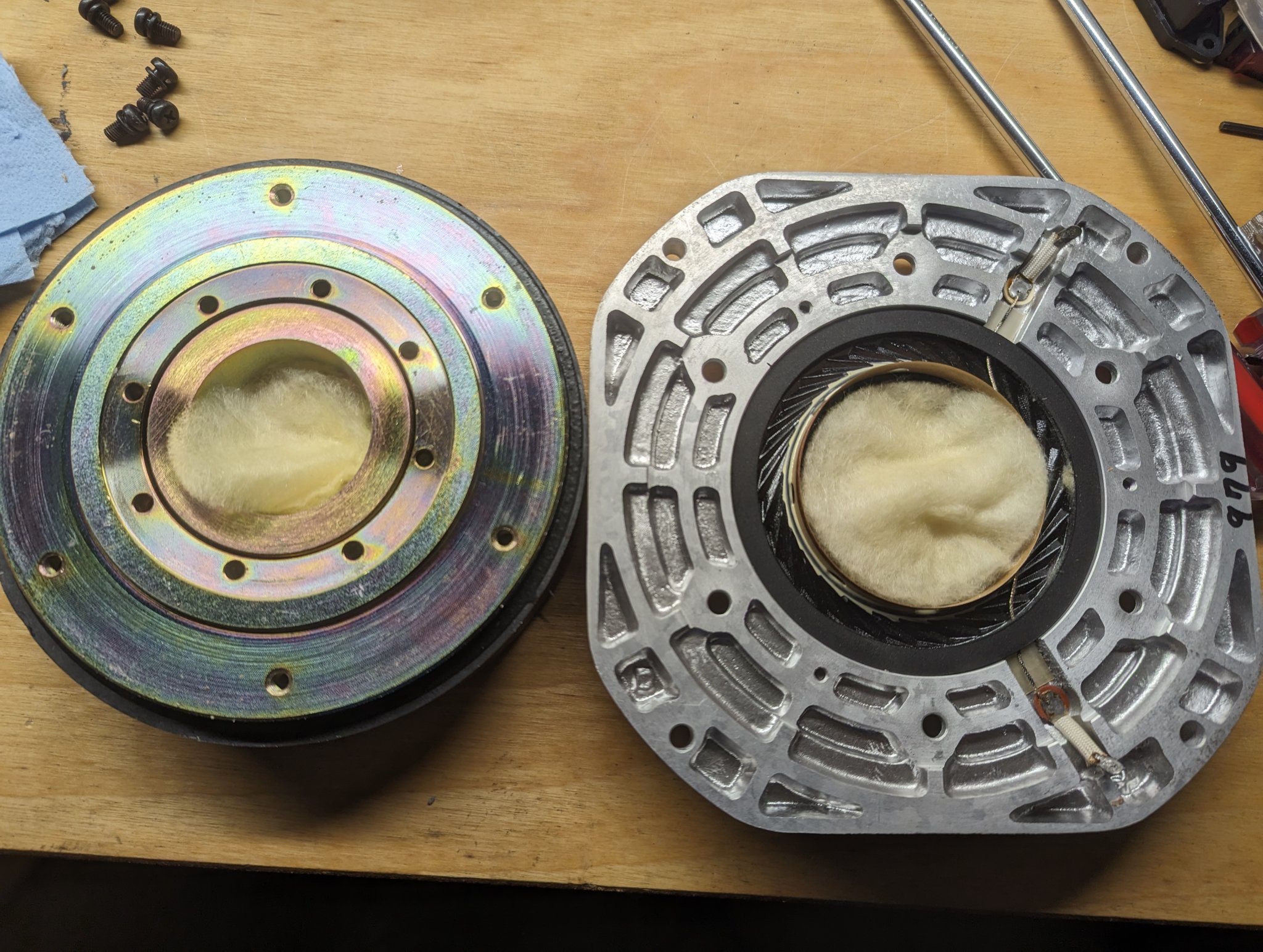

Several noteworthy items:

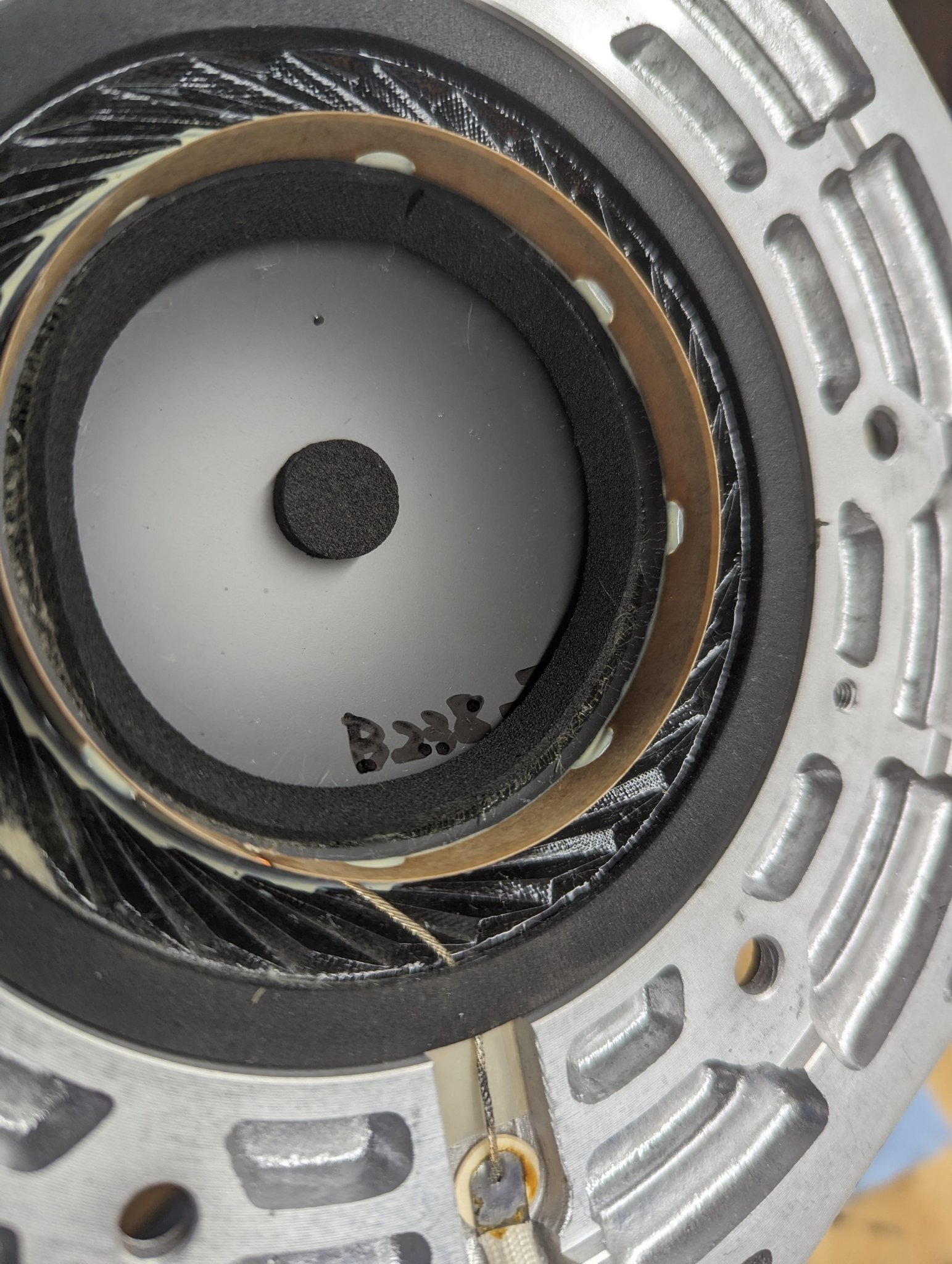

1. The diaphragm, VC, surround, faceplate & terminals are all one assembly. The dome is numbered. It is not the same number written on the faceplate.

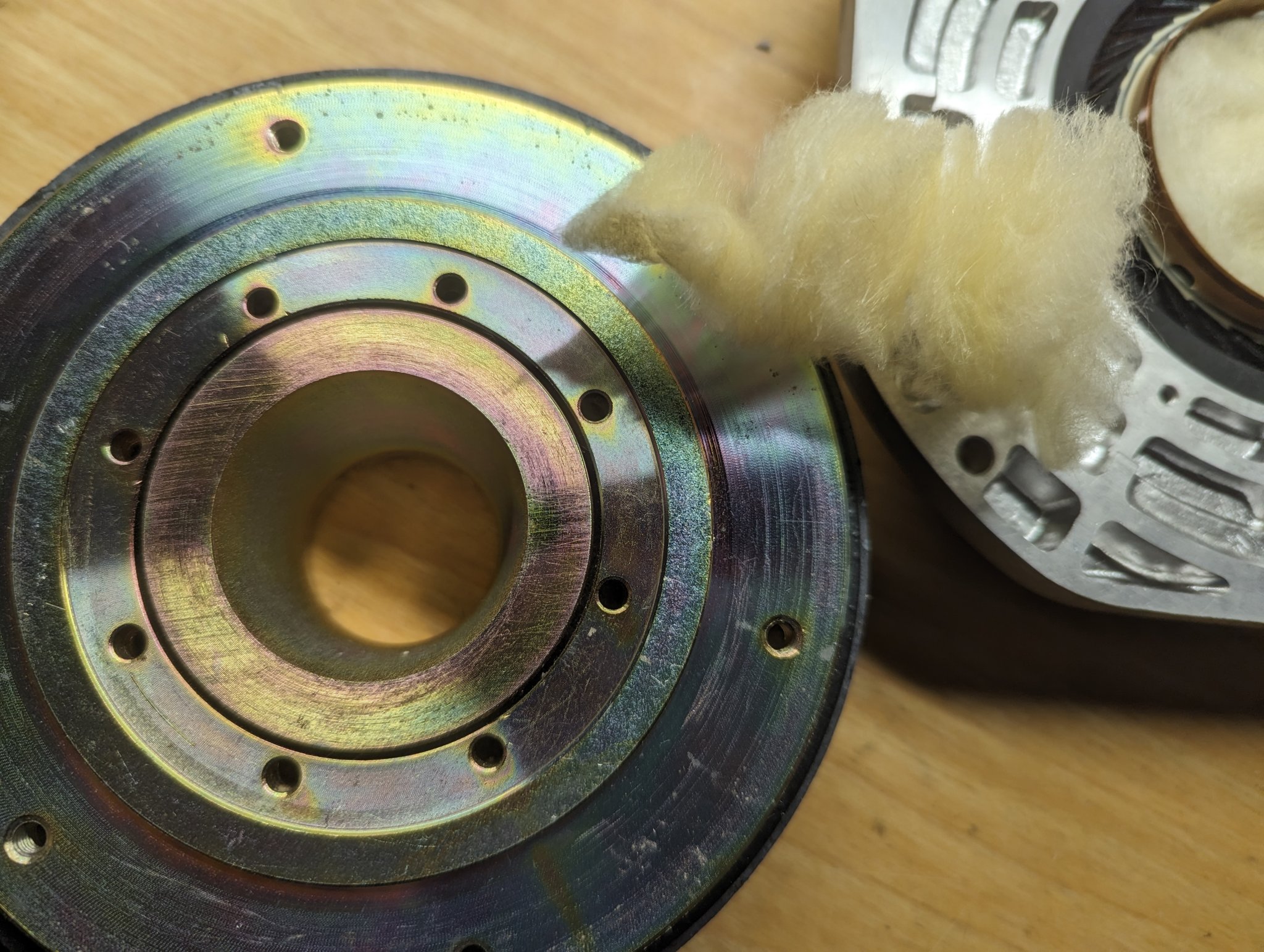

2. Light fluffy fiberglass fills the entire cavity, including directly under the dome.
3. There's a foam ring glued on the underside of the dome, near the perimeter. That's starting to separate & fall away.
4. A single ~1/2 cm dot of the same foam is affixed to the center of the dome underside
5. The cylindrical cavity is tapered, getting smaller as it gets farther from the dome.
Tried gentle pressure on the dome to roughly gauge its excursion. It did not move much or easily. Not sure what that might mean about Xmax. Surround looks clever, like it should allow for some reasonable movement.
I didn't apply much pressure when I swiped the dome with the paper towel or cotton swab. A gentle but not butterfly touch. Tried even a bit of scrubbing motion on some of the sticky parts which did not come off. I did not feel I was risking damage.
Any thoughts on how to repair the foam ring that's slowly ripping off the dome? I don't think I'll try to replace it but maybe a few drops of super glue? Or runny silicone?

@silent mike Neat! There is not much too these things.
I am sure on some level all of these different resonant plates/chambers/mazes work the same.
Today I am going to take the back off again and re-measure the cup for a small plate near the top or maybe inside of the magnet. Having it right at the top wont work with the hole size I am using.

One thing I forget to mention in my list of notables is how surprisingly light the faceplate assembly is. I will weigh it today, but it seems lighter than it should be. Maybe it's the labyrinth/honeycomb pattern on the backside that's minimizes the aluminum material... and my expectation of greater weight given its perimeter thickness. The magnet structures seems to comprise ~90% of the total mass.
Quick observations:
1. The stock 365 Hz Fs is pretty low, but impedance is higher than I'd expect. Perhaps it's because all current tweeters I've measured have ferrofluid.
2. Open back Fs is lowest at 235 Hz. This would seem the lowest Fs we can hope for when the back is closed.
3. With the 12" traffic cone over the open back, Fs rises, as expected, but only to 265Hz, which is less than I expected. Multiple aux peaks above & below look bad.
4. The poly fill helps tame the multiple peaks, brings Fs down to 250 Hz, but peak amplitude is only down a dB.
5. Long teased wool has similar effect to poly, but I did not weigh either, so it might not have been exactly the same amount.
The "seal" between the backside of the driver & the cone was far from perfect -- just placed with a bit of pressure.
Admittedly, a 12" cone on the back of a driver is impractical. I would probably reduce this down to maybe 8" if I decided to use an expanded cavity back.
The big question for me is what an array of varied length thin straws (1/16" to 1/8" depending on length) packed and closed at the far end in such a cone might do. Yeah, a broadband multi-resonant absorption array akin to KEF's "metamaterial".
That experiment will have to come later. Probably best when I have the JA0801 in some kind of viable speaker system.
