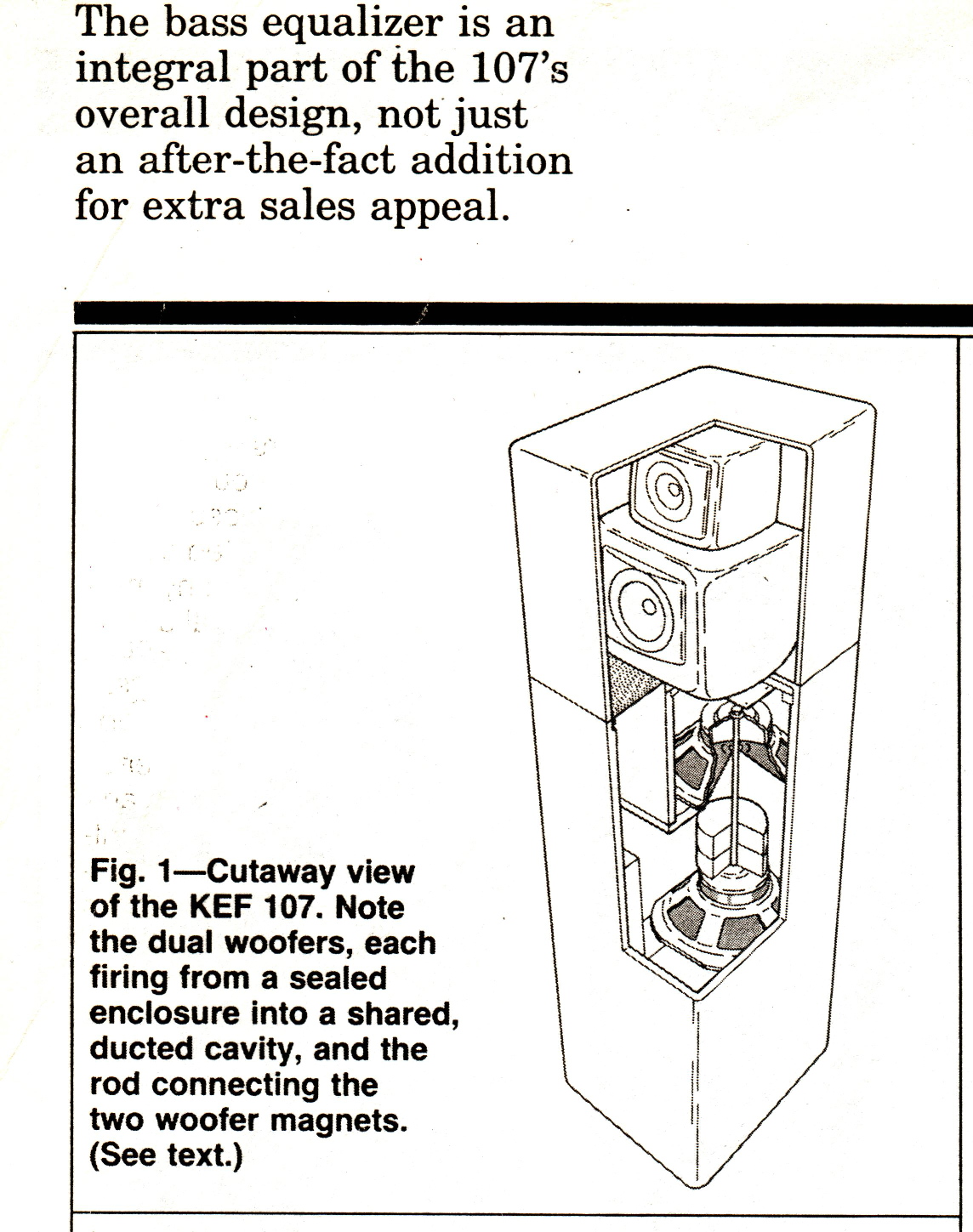

KEF 107

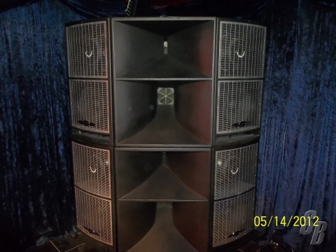

EAW
More EAW
https://www.soundbroker.com/dynImage/?listingPicid=67193&cacheBreaker=1392640083

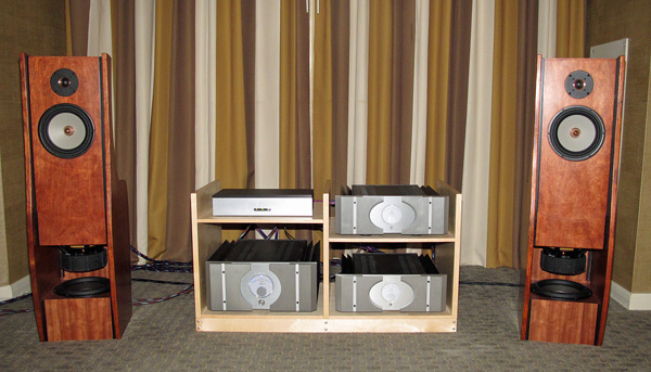

Linkwitz (of the Linkwitz-Riley crossover fame)
Another shot of the KEF 107 showing the slot.

Another Linkwitz loudspeaker
