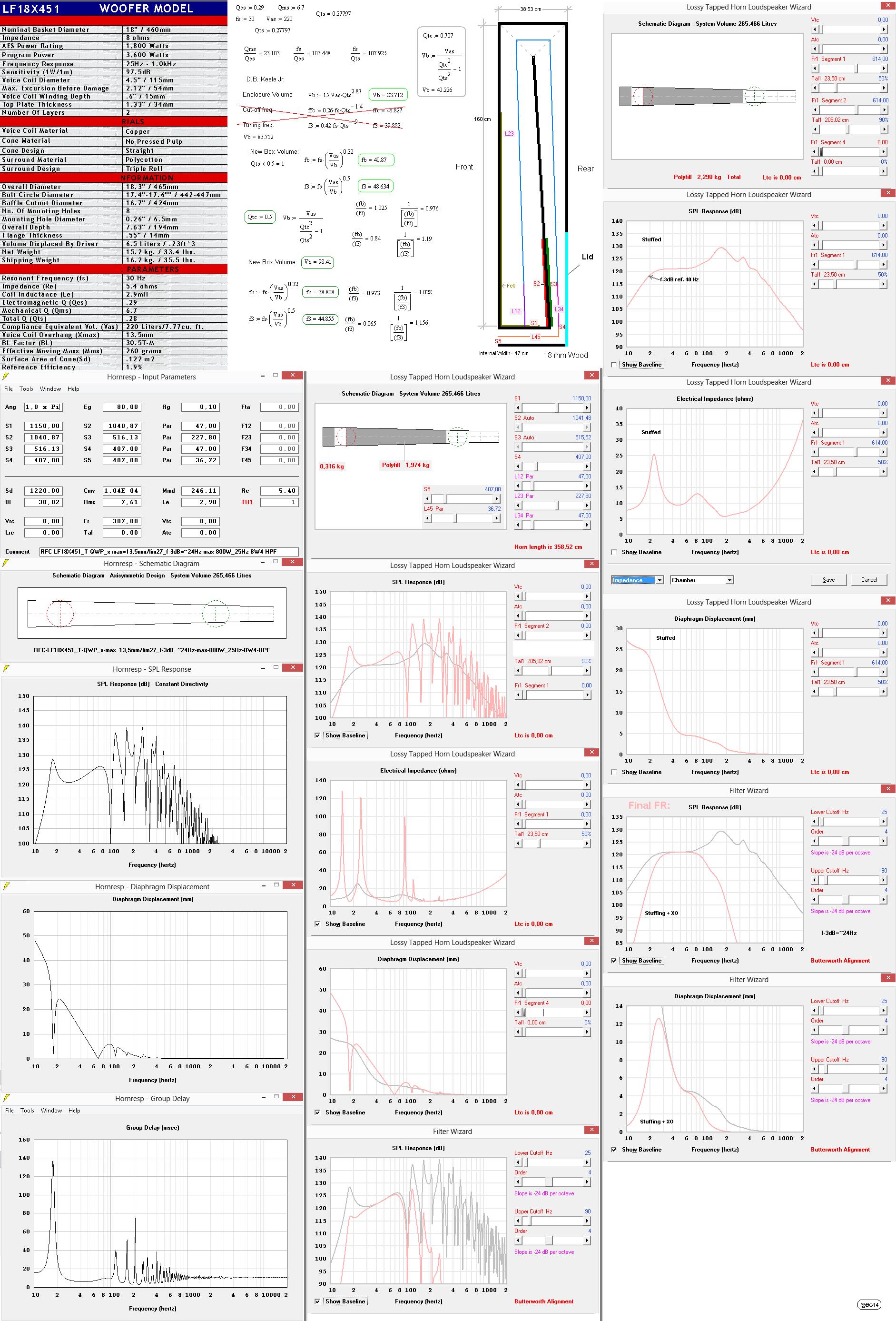

FYI. If in case someone have this Driver:LF18X451...
b🙂
I presume you noticed that the top plate thickness and coil height are reversed on that data sheet?
It's a great driver, with a great (high) price to go with it.
121dB with +29dBW in 1Pi translates to squat at 1W/1M in 2Pi, probably makes a great home sub pushed up against a wall though.
