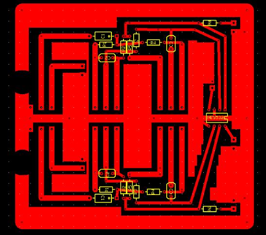

Hey,
I made pcb using this circuit.
Pre Tone Control Stereo by IC NE5532 -Audio -Electronic Circuits Diagram-Elecpod
When I fire this thing up there is voltage difference between pins 2 and 3 ( and 5 and 6). So there is voltage in the output even there is no input at all and volume is turned to zero. When turning knobs it affects voltages. The lowest voltage is achieved when Volume is anticlockwise, Bass is in the middle and treble is fully clockwise (15mV at the output and 70mV between 5 and 6) . Even then there is BZZZ sound coming out of the speaker. My meter isn't pro one, so it might be that those readings aren't exactly right, but it gives direction.
I think there is two things which could be wrong. First is that my pcb design is not right. Second is that the schematic is wrong.
Can you see or guess what could be wrong?

You might want to put a capacitor from pin 4 to ground and from pin 8 to ground.
The Opamp might be oscillating.
Make sure that your +12 volt and -12 volt supplies are delivering clean voltage.
I once designed a circuit using 5532 IC's. I had a similar problem and discovered that my batch of IC's was bad. I temporarily installed 1458 IC's and the problem went away.
I ordered a new supply of 5532's from a different manufacturer and they were good.
Good luck.
You may well have oscillations. Neither the layout given on the same page as the schematic nor your layout are close to ideal. In particular having a long track connected to pin 2 (and pin 6) is asking for instability when an opamp is used at low gains with fairly high resistance feedback as here.
You can AC-couple the output, i. e. put a capacitor in series and a resistor to ground after that. The resistor should be in the range of 100k to 1meg. The capacitor should be chosen according to your desired high-pass filter roll-off.
Or you can look for a better schematic.

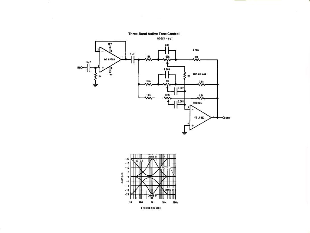

hello.
found in an old national datasheet (lf353) a tonecontrol.
if you omit the unity gain buffer at the input and the midrange control - it is similar to schematic post one (swap lf353 to ne5532). but this schematic does not show psu decoupling caps (e.g. 100nf per rail),grounding res, et cetera..........(should be built in).
