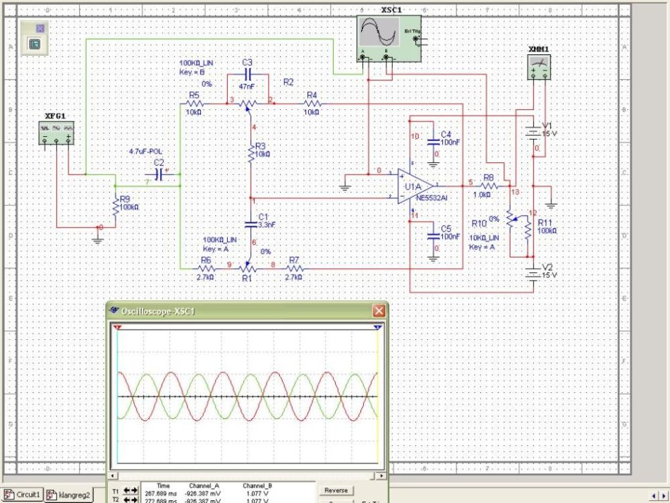

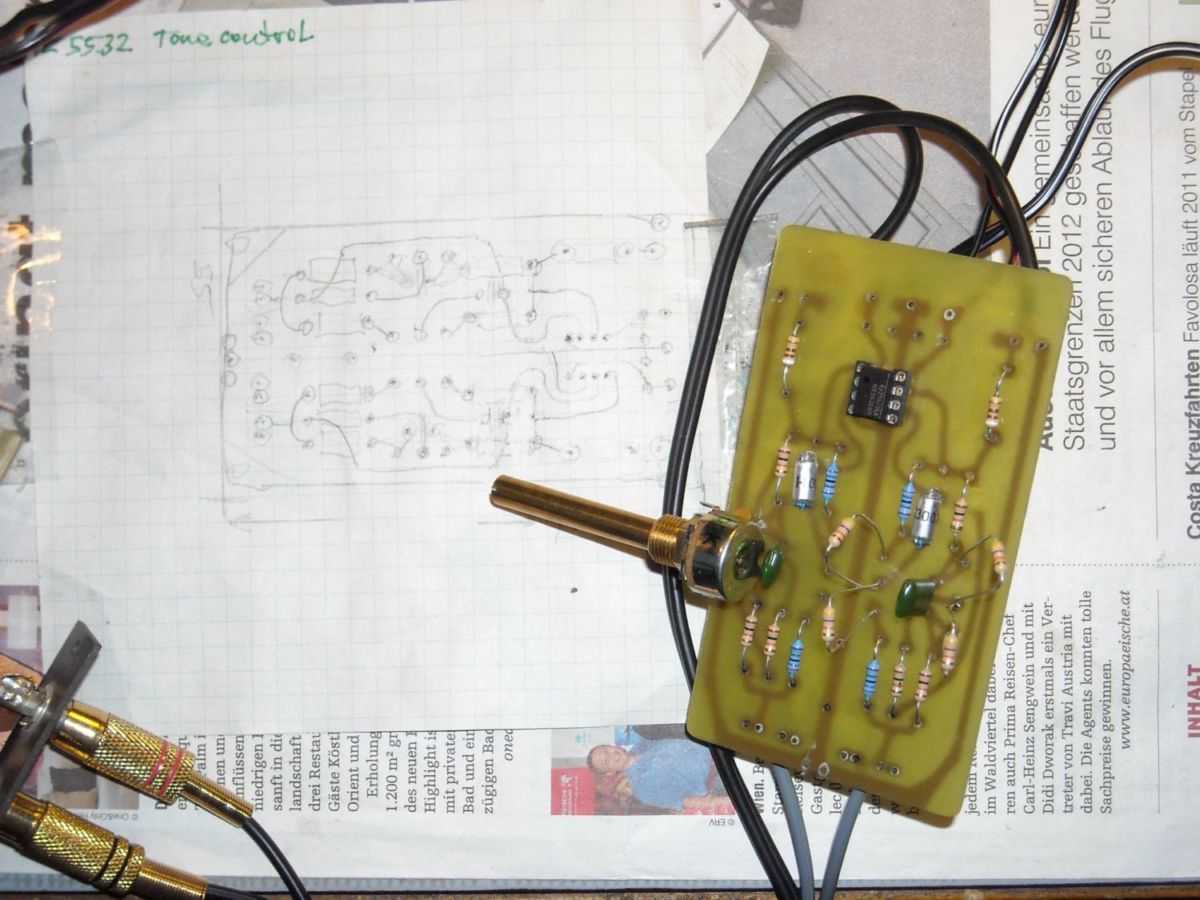

i have built a tonecontrol with parts i had on hand. one channel with pots,the other one with res as substitutes.tested it with ne5532 and lf353,both work........even without psu decoupling caps (but i will not recommend this.....).psu was +-15volts.volume pot 10k at the output.
made some sim's.............
the volume pot (big res,100k) has an influence on the gain and frequency response of the circuit (it is an inverted design,the source impedance is added too........).
i think using a buffer amp in front of the input (as shown in post 14 datasheet,or perhaps a b1 ) or a volume pot with a lower res (10k or so) should improve this design.

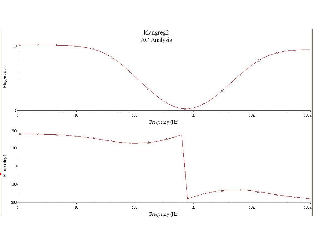

left picture shows the frequency response with the pots fully turned up........
right pic. the schematic.

if I read the graph correctly it looks like midband is just over 1V and the extremes are at 10V.
That's a gain of +20dB for the bass and treble.
That seems very high.
......indeed,this kind of tonecontrols (post 1,post 14) have a big gain.

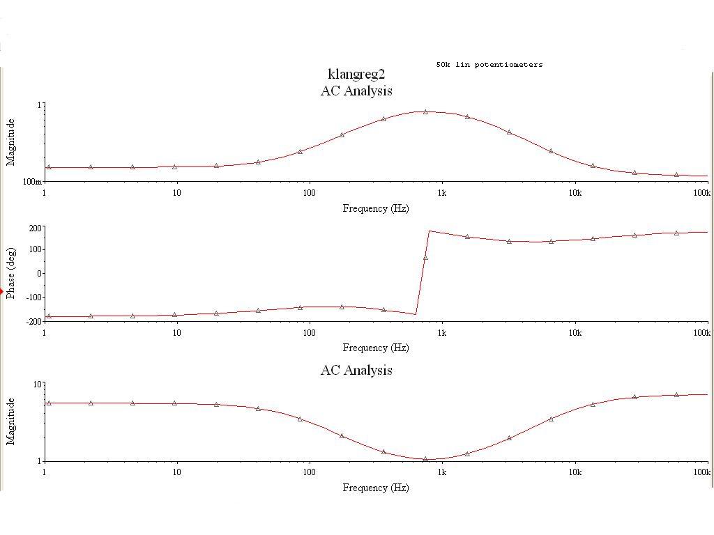

i reduced it by using pots with lower resistance (50k,25k,....),here is an example with 50k lin pots.
upper curve fully turned down,the lowest curve was pots fully turned up.

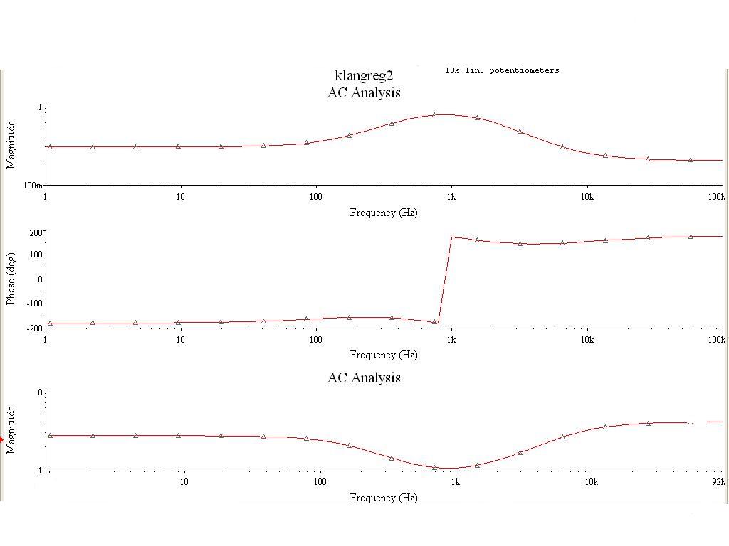

or in hifi gear,chip amps,with reduced gain, here is an example with 10k linear potentiometers (and treble - res r6,r7 increased to 3,3k instead of 2,7k).

probably i will use 10k pots and fetopamps with this tonecontrol.

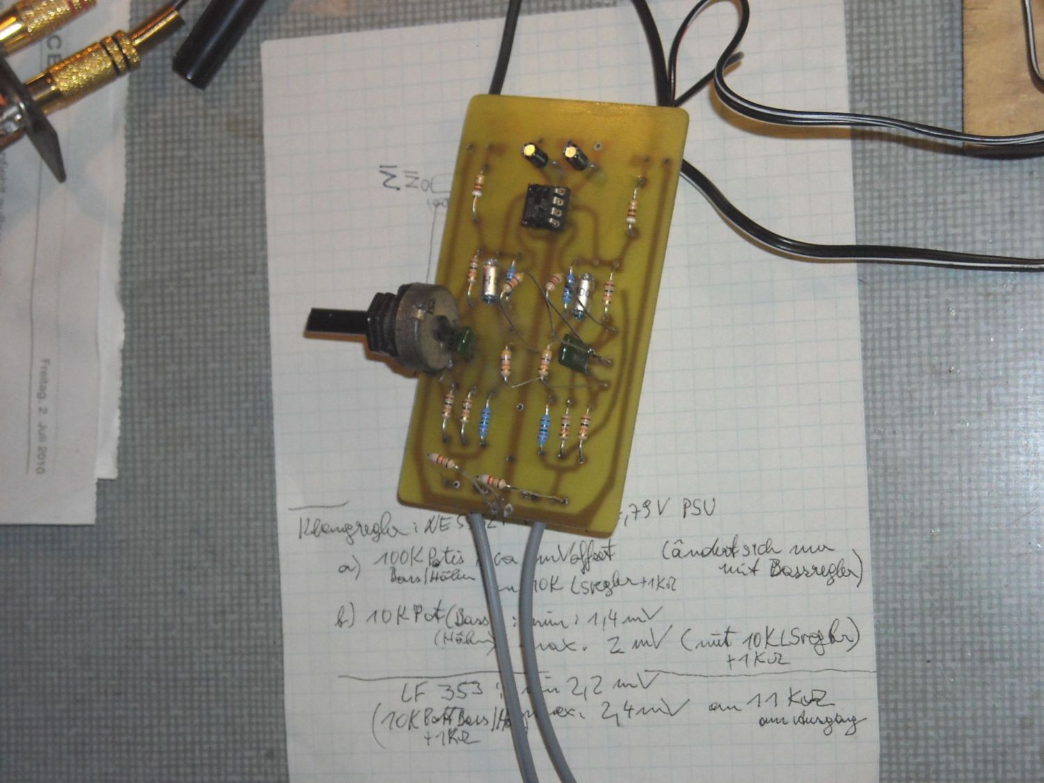

changed the 100k tonecontrol pots to 10k: offset at the output is significantly lower,..........e.g. with ne5532 and 100k it was around 8mv ,and with 10k around 2mv;
changed the ne5532 opamp to lf353 (with 100k pots version) ......and the voltdrop at the output decreases.............;
dc-voltdrop changes only if the basscontrol is turned up and down;
the pots are connected to the -inv input of the opamps,so they are a little bit "humm sensitive", i will keep the wire short to the pots.
