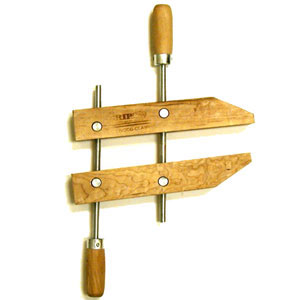

sploo said:
When I made the current test blocks I stacked a load of weight on them - probably not as good as a decent clamp, but the glues were dripping out the sides.
Depends on how much wieght is put on. A screw clamp can apply massive pressure, and really that's what is needed. When it's said too much glue makes a bad joint, it's true, when the glue dries in the joint. You need to reduce the thickness of the glue joint.
If the parts fit tight together, the resulting joint should be next to invisable.
When I was much younger, I made a bunch of wood clamps that served me well for several years. They are fairly easy to build with any hardwood and some threaded rod, nuts and washers.
Well worth your time to whip a few up.🙂
Here's a pic of what I'm talking about:
